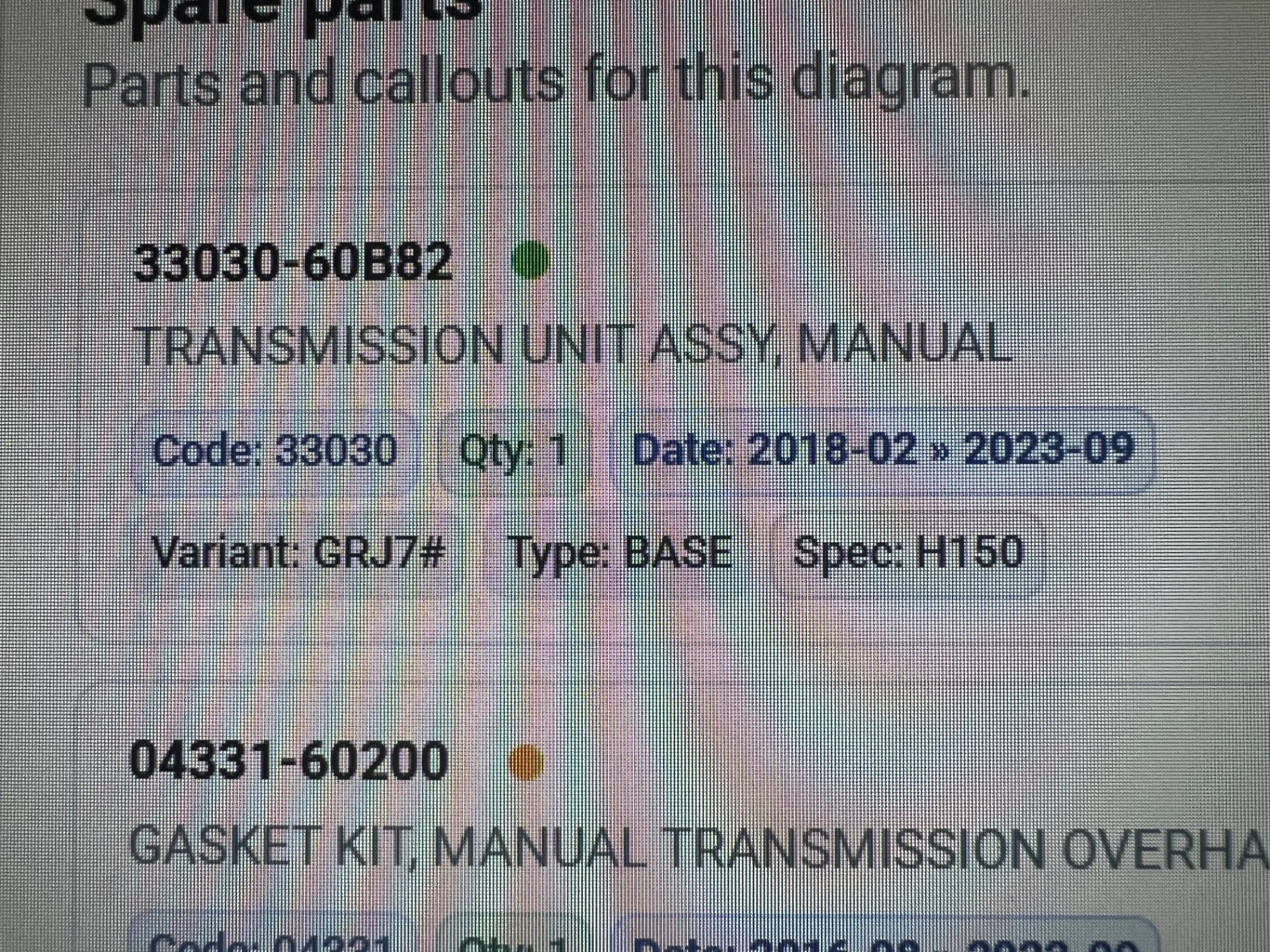

No H150 also came in GR79’s, that is the newest version.
