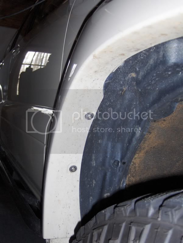

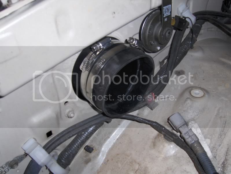

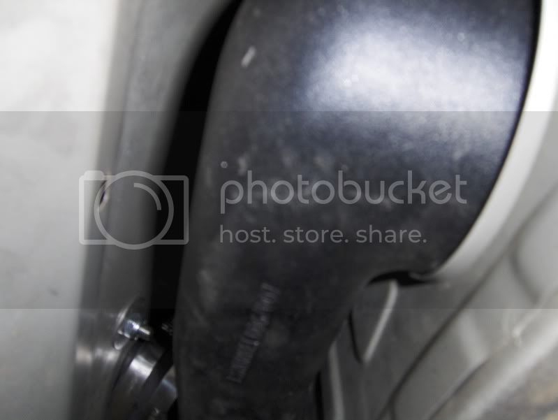

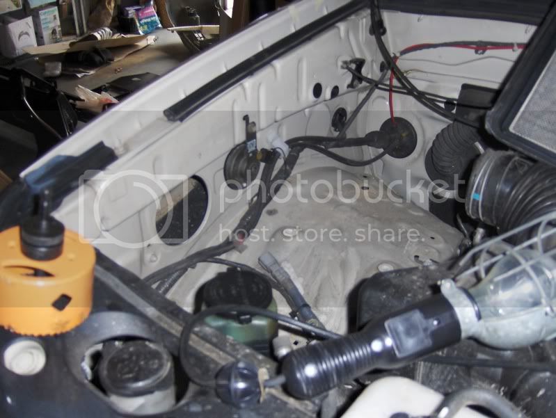

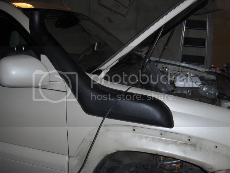

Snorkel is on. It is a VERY tight fit but it does work and has 0 tolerance for mistakes and no wiggle room (also results in a very nice finish and super water tight.
NOTES:

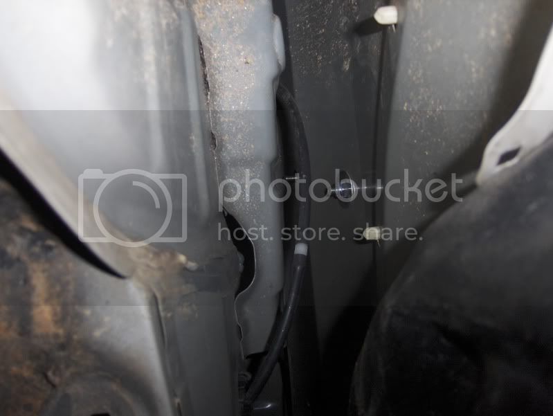

- The top bolts are impossible to put on. The GX has a metal panel there and there is no way to get the washers and nut on...I am using the bottom three, the tightness of the holes, and the top screws and it is very secure.
- The snorkel to air box junction is VERY interesting to put in. I had to put it in, situate it, then slide the snorkel into the rubber skirt. Not easy, another set of hands would be handy.
- The inner fender is a BITCH to get out, the clips are tricky. Pliers and patience ruled the day. I would probably just buy another liner and clips from the dealer if I had to do it again and replace it all as I go.
