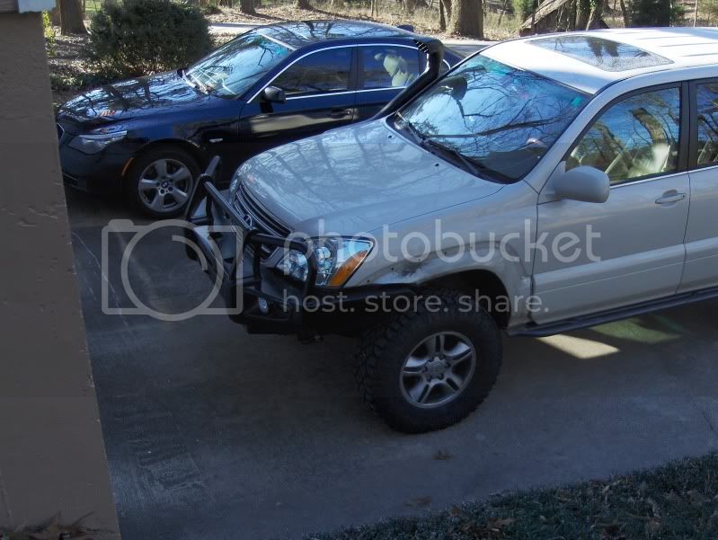

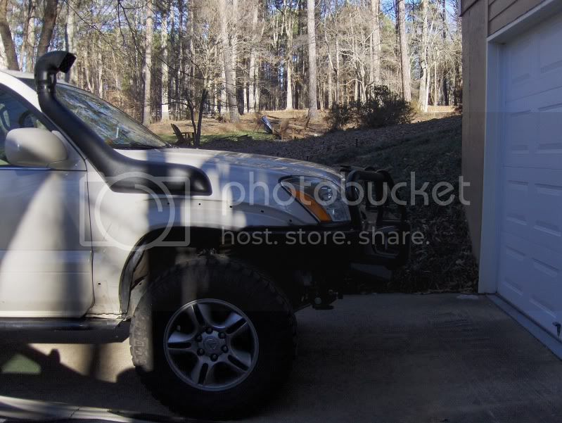

Bumper is finally on, with the winch in it. I haven't wired the lights or the winch. It took a long time to figure out how much to cut and where.
I had to trim the following:
- ~3 inches off of each fender lip
- most of the forward headlight mounting bracket (outside)
- A good portion of the inner fender rubber (expected)
- Will still need to trim ~3 inches off of the fender flare to remount
- ~1 inch off of the inner upper lip of the bumper (right by the hood) to clearance for the Lexus style hood. I worked it in then out to make it look nice
The winch is simple...crazy simple. I noticed some of the bolts in the kit were not the right length (long), but I just got the right length and no worries.
Here are some pics:
Semi-finished product:
Another shot closer in:
Clearanced hood:
Side View:
Other Side:

237 measurements later and I can confirm it is on straight, it is level side to side, the hood works, and the weight from the new stuff actually squatted the front down enough to spread the IFS back out and it is no longer 1/4 narrower at the tire on each side.
WIN
Looks even better with the flare on! I'm not trying to pick, but I saw there was a gap between the bumper and the fender without the flare...but no gap between the flare and the bumper. When the bumper flexes it will push against the flare, but it's at least just the flare. It's amazing how much the bumpers flex.
Your rig is looking great!
There is a gap there, it is hard to see since I painted the underside of the fender. The gap is smaller, but the flare is actually flexy right there due to the cuts I had to make. I am going to use some silicone and bind the top of the flare to the body a bit better and it will be fine. I drove it hard this AM and hit as much as I could (bumps) to see if I could hear or feel it hitting and nothing seemed to have a problem. If I see more problems I can always just zip a new line across using the dremel to increase the gap.
