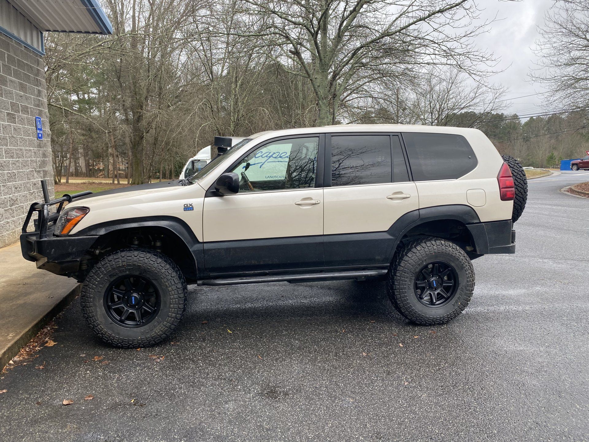

They look great! Your truck is so understated considering the serious hardware aboard and the serious use it is put to.
Thanks! I always go for the sleeper look.

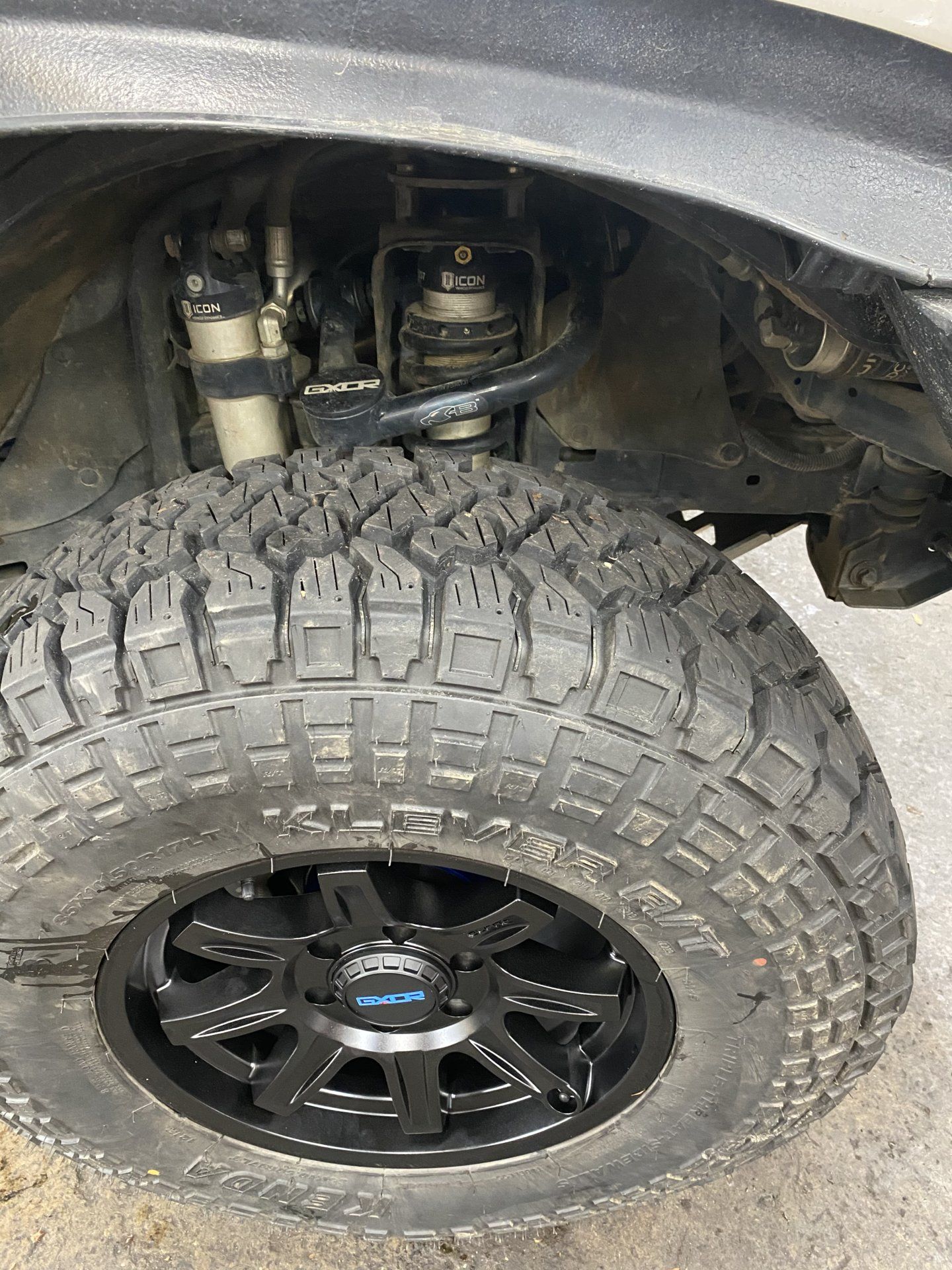

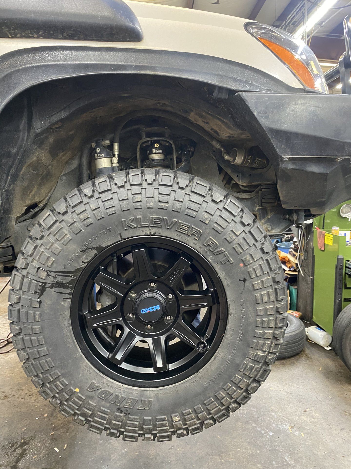

I've been really interested in those Kendas. Looking forward to you putting them through their paces!

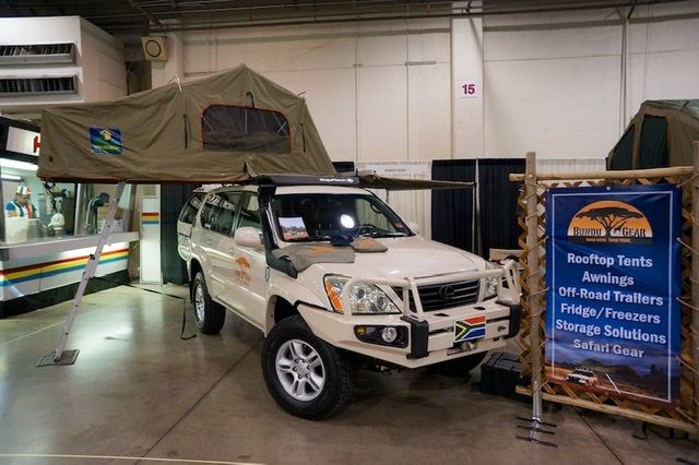

Time to post an updated side-by-picture of it currently next to one when you drove the truck out of ACC with the 2” lift (pre-bull bar days) :bounce:
These two trucks sealed the deal on me acquiring a GX. Took me long enough, but it was down to a RHD BJ70, LX470 or the GX. Dan’s contributions just pushed me over to the right one
Dan, thanks for all of the insight, input, research, Guinea pig work and help all of these years!
(For those that don’t know, Dan’s original build is on top, the lower image is the GX built by BunduGear after their 100-Series was totalled). The Sand Dollar Pearl twins :D

Where'd you put the specs on thos rims?
Also, do you have a GXOR-bits list consolidated somewhere? UCAs, the slinky suspension kit (is that through treaty oak? I can't remember)?
What GXOR aftermarket upgrade bits currently exist out in the marketplace, and is there a comprehensive list available?
The wheels are 8.5 hub centric and +6.9 offset (inside joke in GXOR). 17”. We will probably do another run. These are a unique hammered powder coat. Gxor.org has all the vendors I work with on permanent stuff with, the drops and group buys are on FB in the group. Done about 18 shirt designs, stickers, trasharoos, etc as group buys. It’s a wild ride and takes a lot to keep organized
