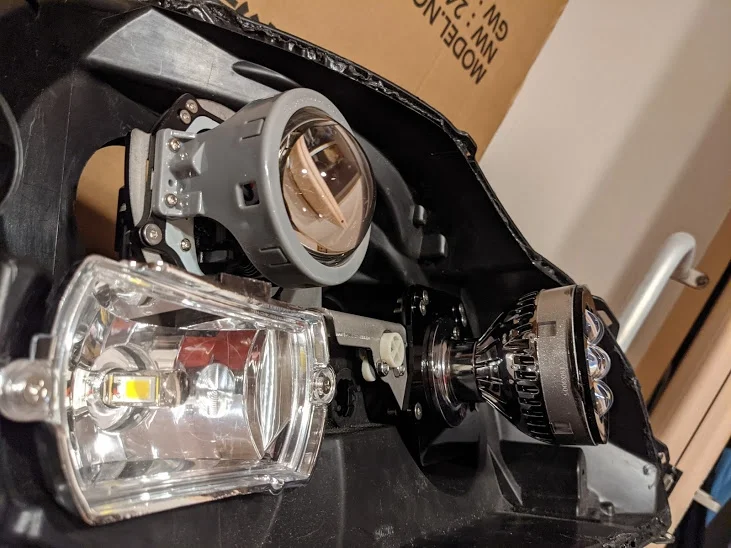

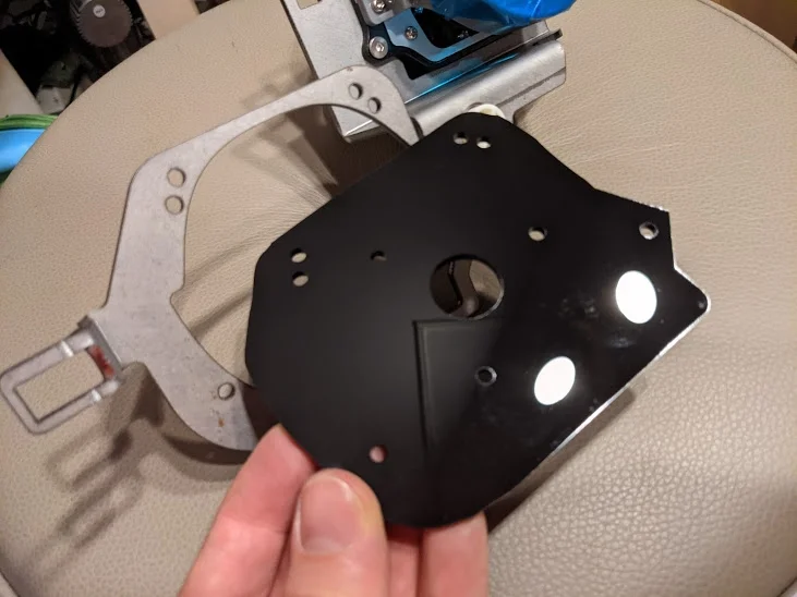

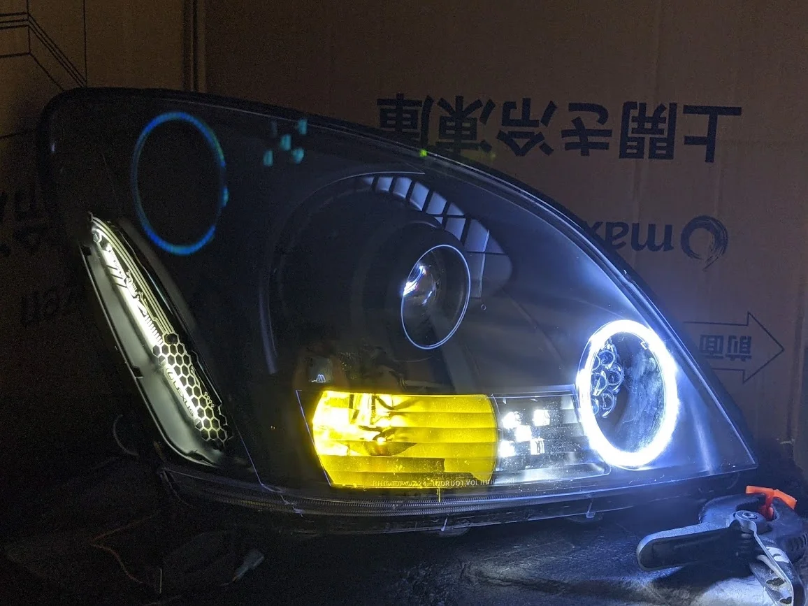

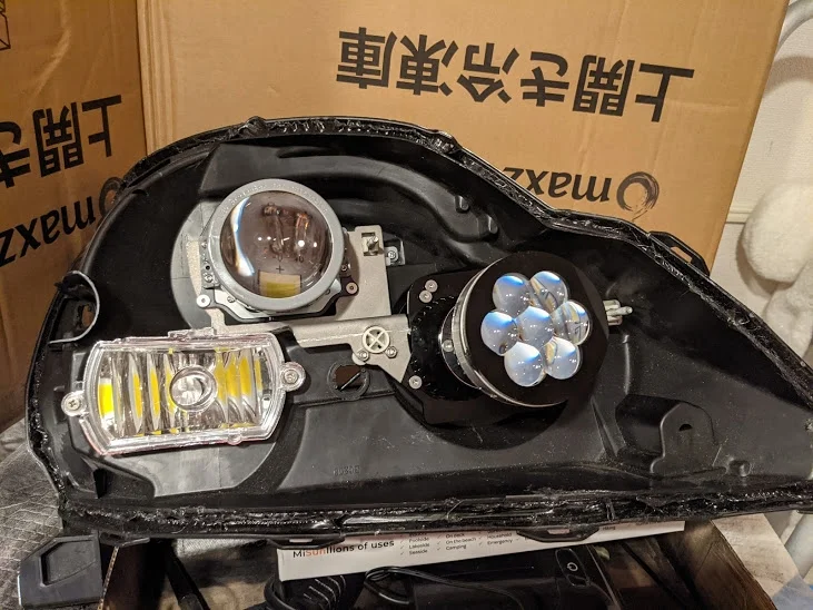

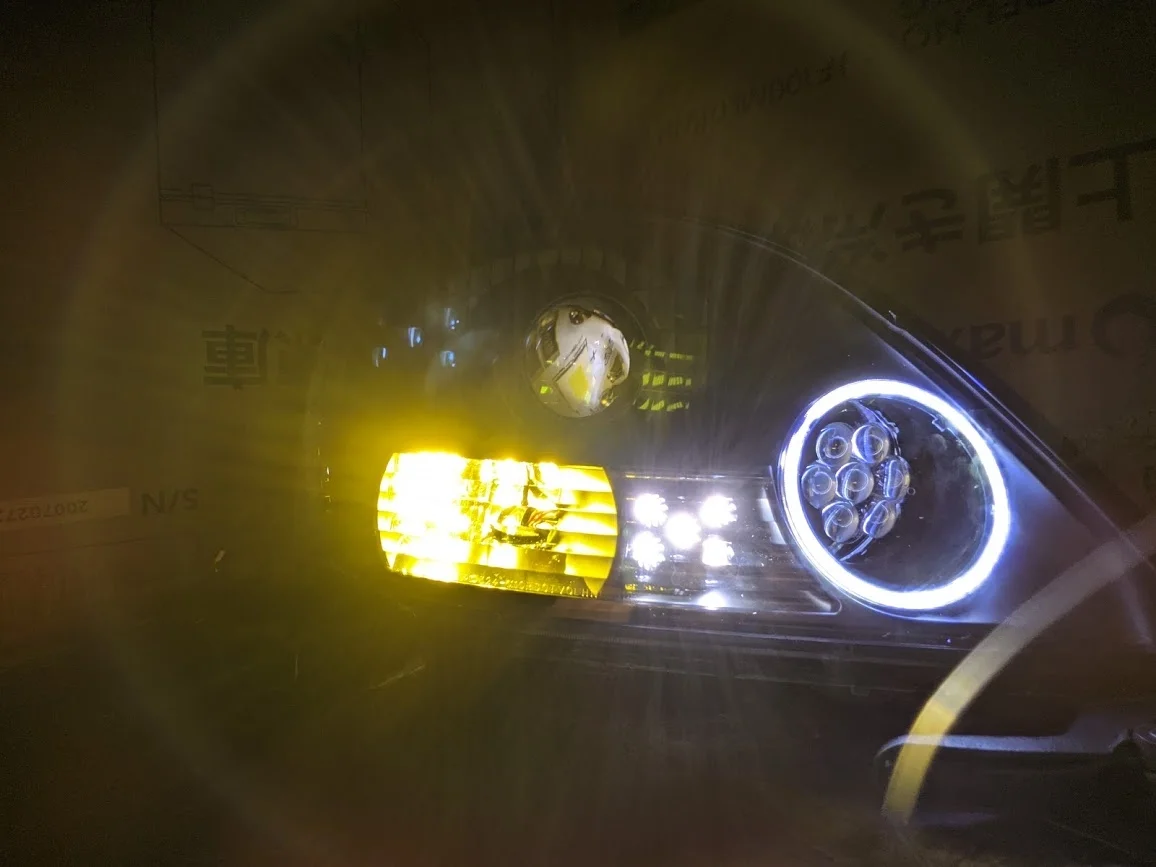

I'm about to fab up an acrylic plate and a riser to mount the high beam LEDs using the brackets. I hope I can get these things together by next week.
So.....I laser'd an acrylic adaptor for the Highbeam LED, a frame for the LED (I hated the glass/metal look it came with), and found towel rack mounts to use as risers for the high beams. Decided on 5 pods in that small section and adapted some H3 Yellow LEDs into the reflector since I didn't want it going to waste. I'll have it all together shortly but you get the idea...

I don't think you can use threaded aftermarket projectors with projectors. Or at least not with the stock GX setup. Below is a pick of the stock projectors. The adapter plates replace mount to where the stock setup mounts and allows for adjustment.
