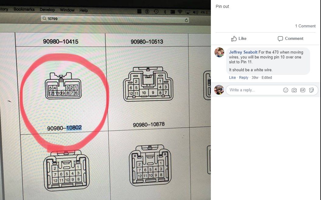

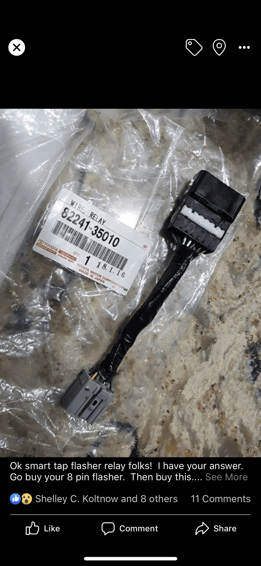

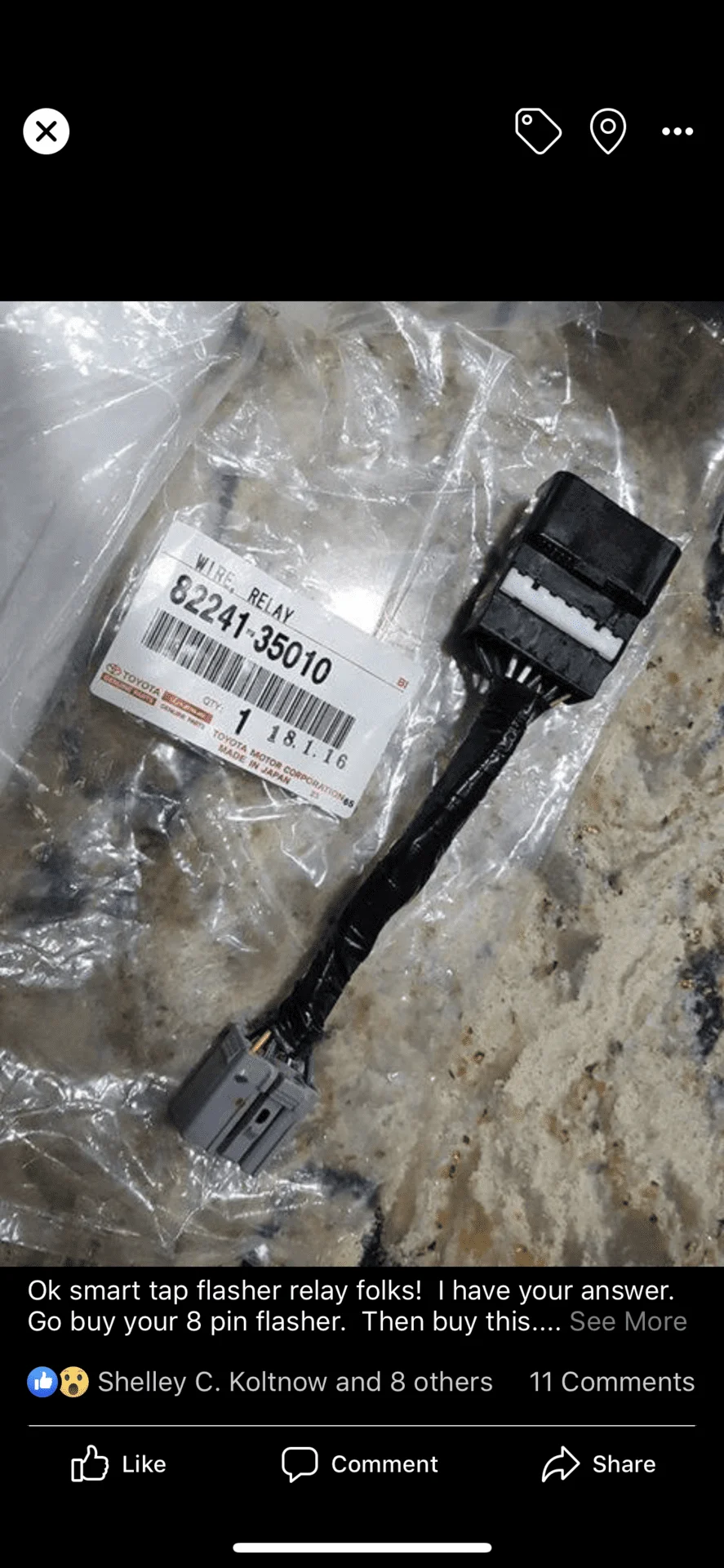

5. Install a SmartTap LED relay module. You will need an adapter harness from Lexus to plug the 8 pin relay in. You will also have to lightly modify this harness. This method disables the DRLs. Thanks @GXO for the details in the following posts.

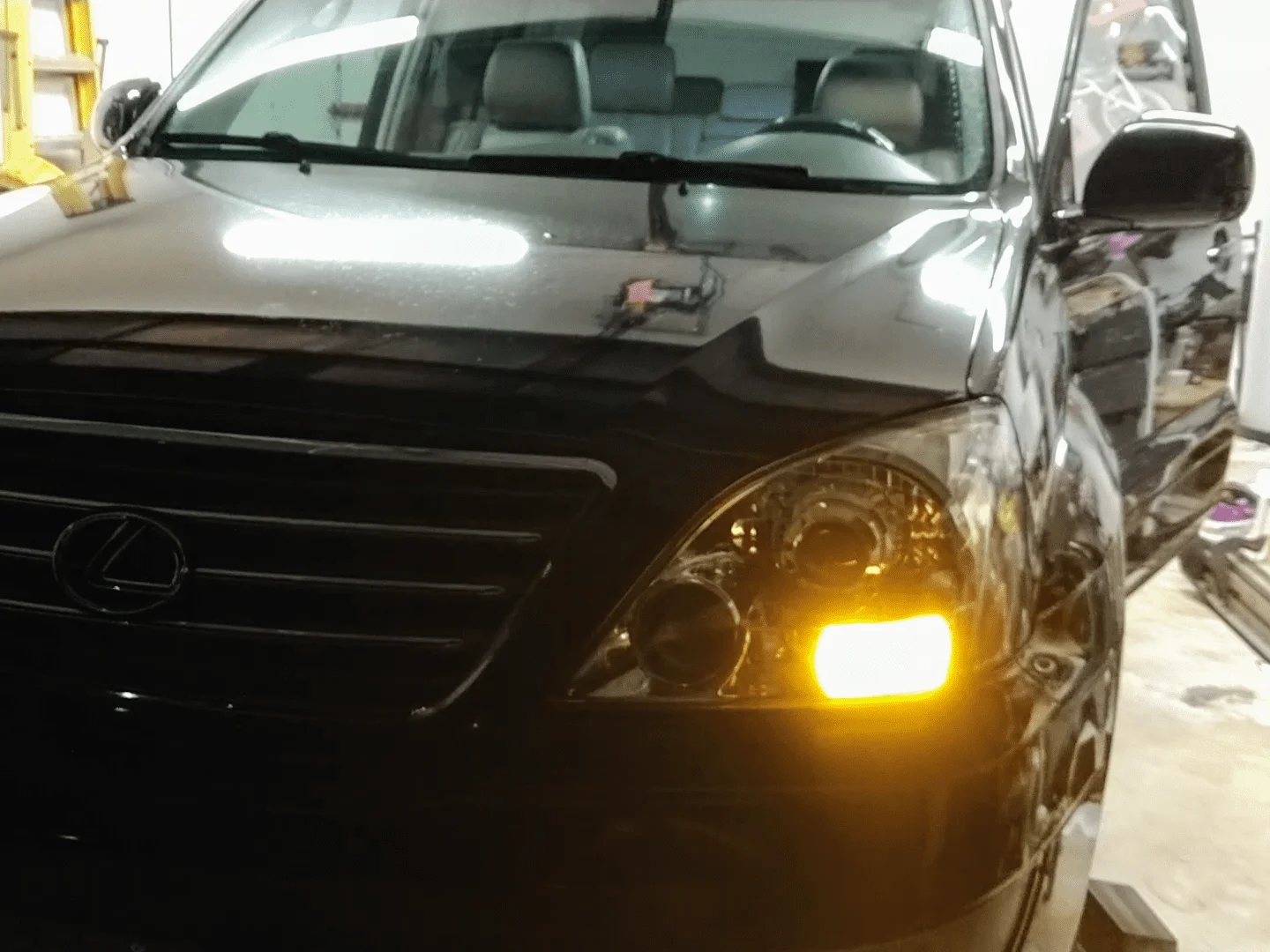

Tough to tell from picture ^^^ but its blinking at normal speed haha.

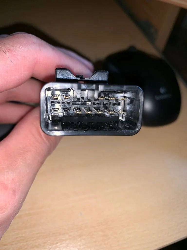

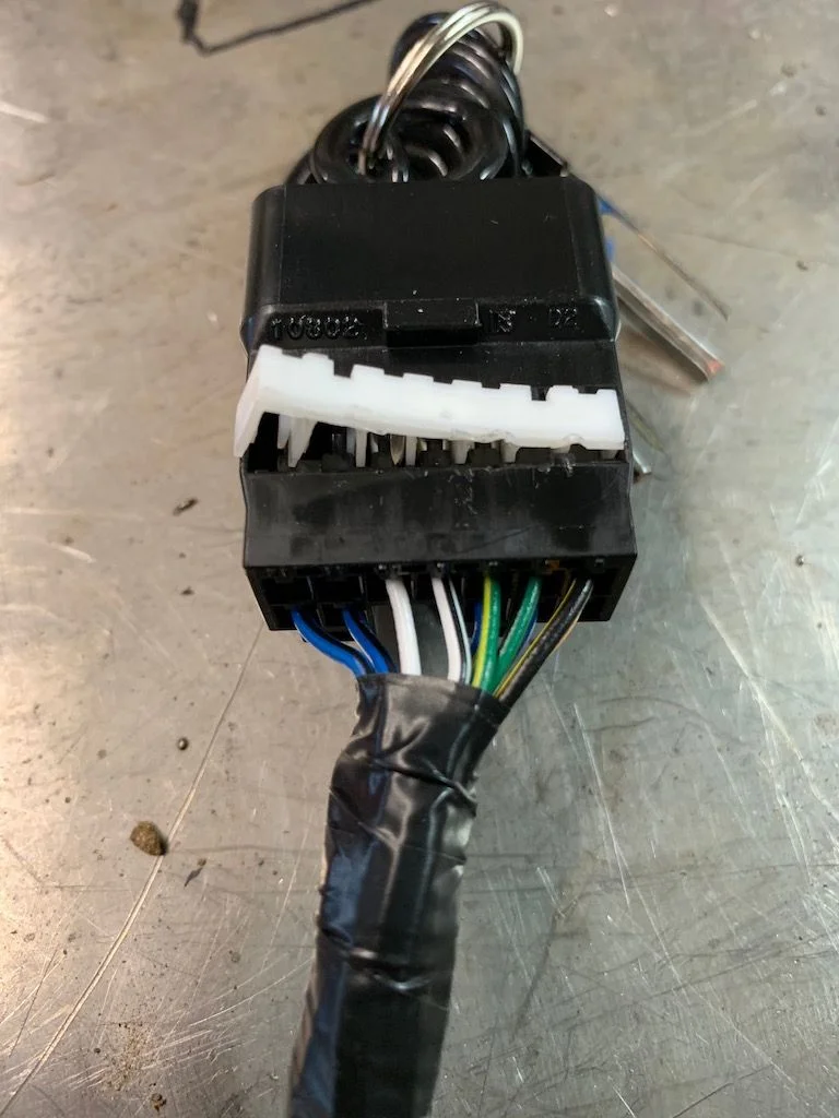

Now, I get to remove the harness and move the pin. I love doing things twice
