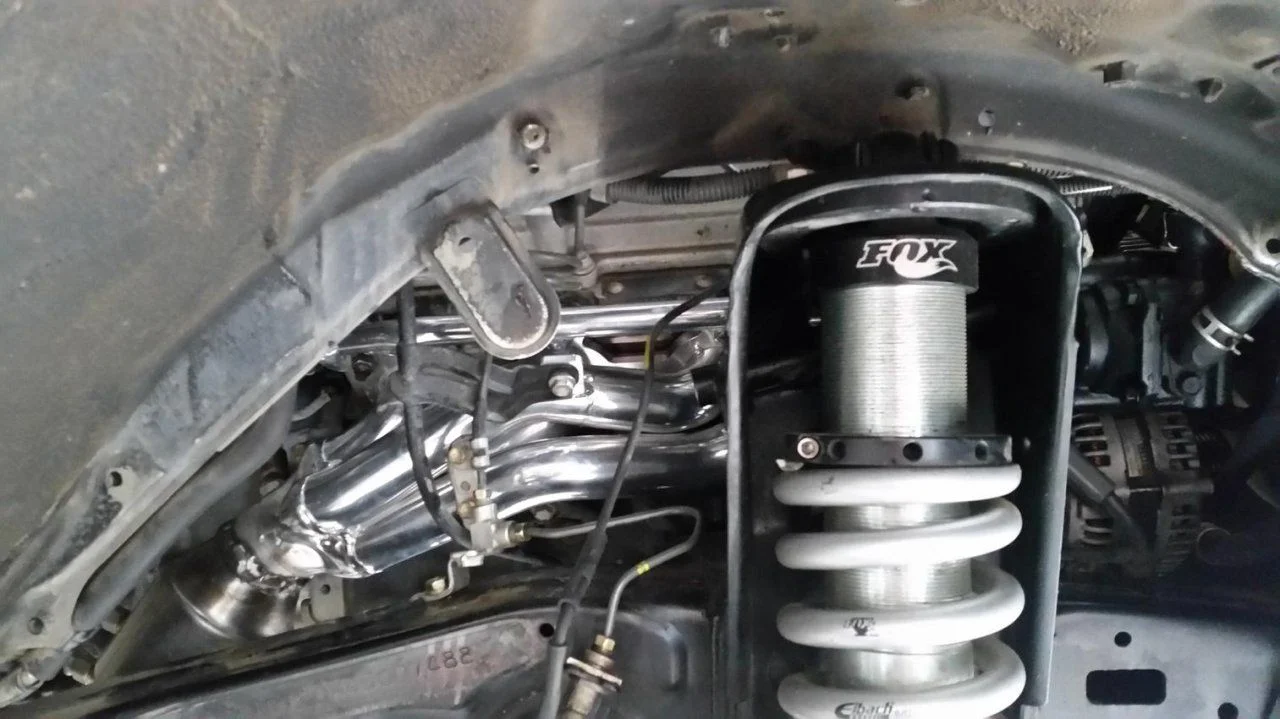

They do in fact fit about 7 hours per side on a clean non rusted GX. I did my own install as I have a full shop to work in, with the air injection on the 05 and up the air tubs are right in front of the upper bolts, If I were to do it over again I would use the 03-04 without Air injection and use the Injection delete kit, I understand it can get expensive to replace the air pump anyway. Depending on your state you may not be able to do this. Alot of patience was required. I also have a Modified Volant intake and AFE catback exaust, I used Flowmaster high flow cats, at idle its as quiet as stock and no drone on the freeway. I purchase the Headers from Burtman on a group by, it was a good deal. Doug Thorley are a great quality product and I would recomend these to anyone not wanting to replace with the stock exhaust.

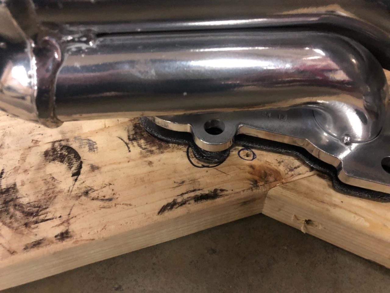

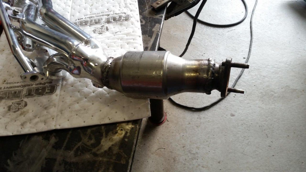

trying to install these headers on my 2007 GX470 AWD and I have maybe 1.5 inch pushed into the stock cat (so much its into the catalist) (passenger side) and they are still too long. I also set up a jig based off the old one I took off and the new header doesn't sit flush. the rear sits up when front is flat. Any ideas?
