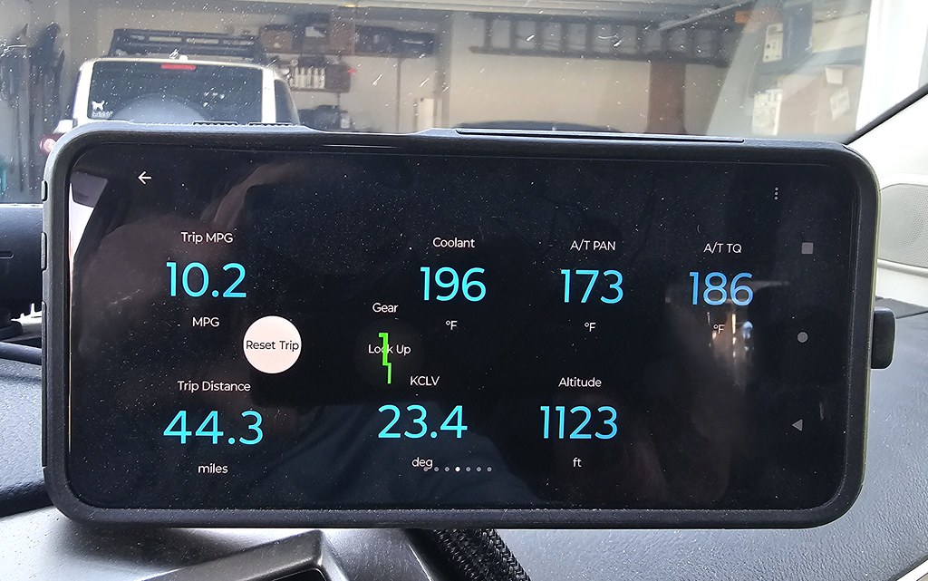

At zero and below I start the GX and run it for ~10 minutes before I go anywhere. After 10 minutes the ATF does warm up even without operation and no load. Didn't really think it was through PFM (Pure Freaking Magic) and now know why.
After 10 minutes idle

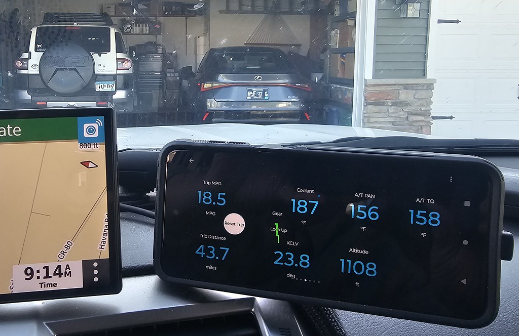

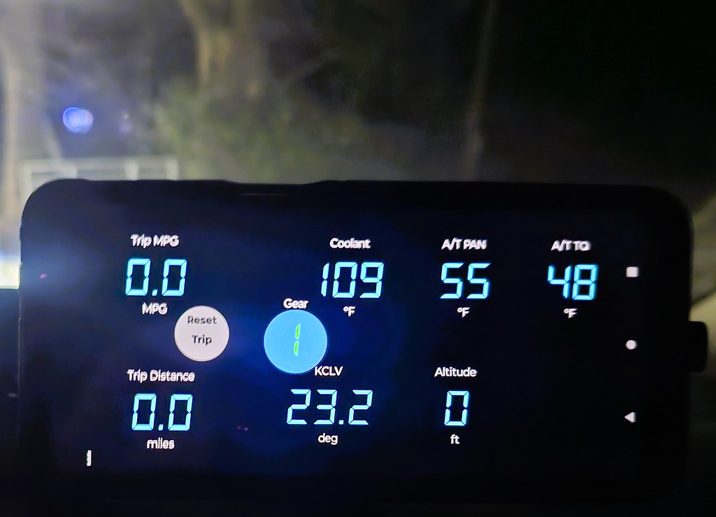

Bumping for some updates. It hasn’t been that hot here yet, so I’m going to be considering temps relative to ambient.
On a longer interstate run when temps were 20C (68F) and speed was at 74mph, the coolant temps are 89C and the trans is running <80C with the converter locked. On the entire trip, I only saw converter temps briefly flash to 92C and that’s always only when passing through the 30mph-40mph range where the converter is unlocked and you’re accelerating. Stop accelerating, the converter locks and temps fall instantly to 86C. In stop-and-go low speed driving I am seeing converter temps flash briefly as high as 95C, but they immediately fall again once you let up and attain steady speed. Pan temps are consistently right around coolant temp and seem never to exceed it.
I’ve never seen converter temps over 95C in a moving vehicle. Only when parked and brake torquing can I spike temps above that, and of course that’s an abuse condition.
It will be interesting to see how hotter ambient temps affect things. On the one hand, the engine cooling fan isn’t even clutching in and the radiator seems to have a LOT of reserve capacity, it’s barely breaking a sweat to keep the coolant temps right at thermostat setting. The trans itself takes a long time to slowly creep up to the temps it does hit, and I wonder how much of that is the trans stat heating it up.
I can’t say how much the CSF radiator helps trans temps, but for now I’m holding off on any thoughts of a trans cooler. I don’t tow and my initial data collection suggest I don’t need a trans cooler— all it would do is have the trans stat constantly trying to warm fluid as the cooler is trying to cool it.
