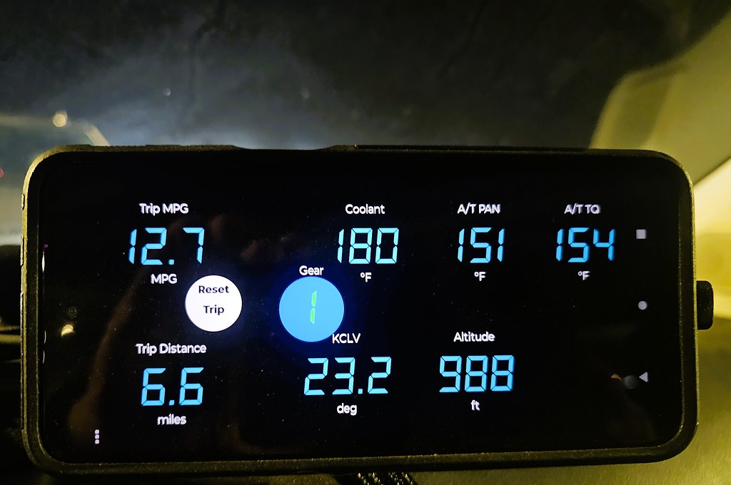

My 4x4 shop installed the Hayden 698 with T-Stat on Monday on the Mountain Passes bracket. Plus coolant flush, tranny drain and fill with new filter and brake pads installed all the way around with brake fluid flush. Bypass is pinned open for the summer. $495 was well worth it to me. Over the next week the diffs and transfer case all get drained and filled.
Only a couple of days for data points but so far I am very impressed. Ambient temp this morning was 45° and I compared temps to screen shots from last year at this time with air temps on the display as well. I never got over 165 and that was only briefly pan went back down to 160 quickly. Previously in same location was 191, 193 and 195. 30+ degrees cooler. Forecast is showing temps breaking 70 next week for the first time in 6 months so will see. And the difference while towing soon. But I'm very optimistic.
Pan comes up to 145 pretty quick then slowly works up to 160 after 10 minutes or more at 72 mph.
Engine Coolant temp dropped as well, at least 5 degrees cooler. I wasn't expecting that but will take it as a win. 189-190 instead of 195-198 which was previously the normal.

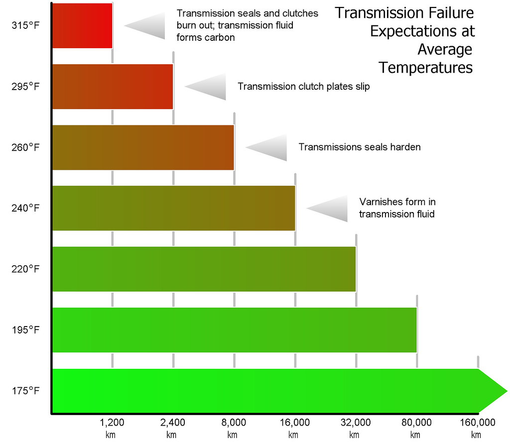

Higher ATF temps are bad that has been proven time and time again. Here is a shot of ATF temps on a typical Mn. winter day at 14 above zero, 14 below zero is about the same. After idling and 10 minute warm up then driving for 15 minutes to town. This is after another 15 minute trip back home. Stock setup and bypass in normal operating condition and no transmission cooler.
