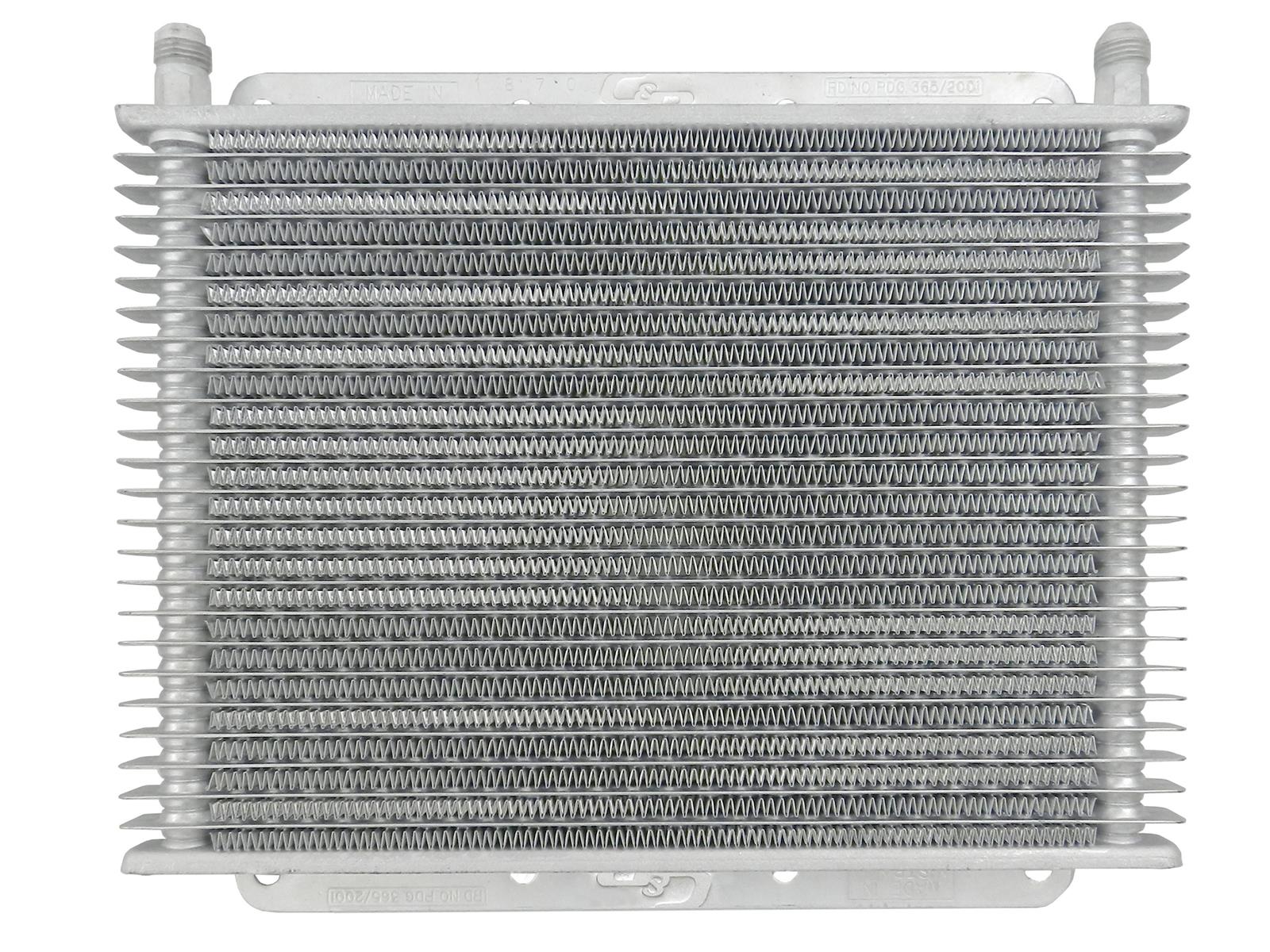

I'm in South Florida but I installed a 678 runs at 160s cruising down the highway 70F outside.
Thermostat line is bypass flow, its typically not even open until the thermostat opens. Pinning it just keeps fluid cycling. This can be beneficial especially if you have an external cooler or inline filter which I do in my GX.
Fresh fluid is best doesn't matter the mileage, what gets you into trouble is sending crap through the valve body.
I concur. I'm in Central Florida and have the 698. Interstate I am in the mid 160-170's with a pinned thermostat as well. It has only gotten to the upper 180's - lower 190's when I have made trips to the mountains with extended elevation climbs.
Hayden claims the 698 has a 180deg thermostat; I consistently see temperatures lower than that.

I removed the Mountain Pass Offroad cooler bracket and got the Goliath Offroad bracket installed this weekend on one of my GX. Spraypainted black enamel to blend in as well.
VERY, VERY nice fitment. It is recessed and much closer to the condenser versus being 6"-8" out. I feel the mountain pass bracket is significantly more durable and heavy duty, however the Goliath Offroad bracket is very strong and rigid as well.
Goliath has a cross brace that X across the back of the cooler where as the Mountain Pass does not. Mountain pass cooler focuses on incredibly strong sides and mounting points. Mountain pass comes painted with a heavy duty black paint; Goliath offroad comes zinc coated metal.
Either cooler bracket you can NOT go wrong, both are built very, very well. I prefer the Golith as it sits closer to the condenser and is much more recessed. Both function exactly the same and both provide no difference in cooling ability of the Hayden 698.

Prepping the Goliath Offroad bracket for another GX install:
Painted with flat black enamel, cured it with a heat gun and mounted the Hayden 698 cooler.
will use the OEM piping through the core support to complete the connection and pin the thermostat. This will ensure cool(er) temperatures and a nice long service life for the transmission.
