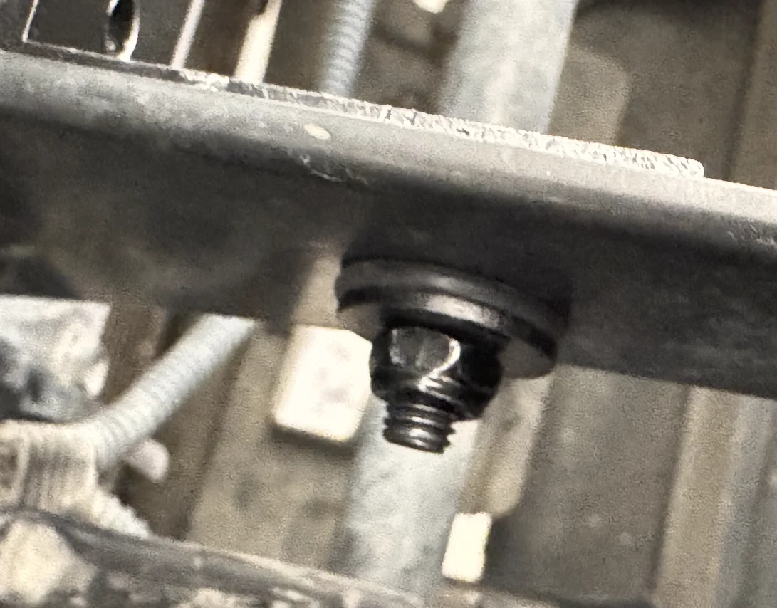

A few notes: Found it easier to remove lower hose clamps by removing the hard line brackets that run under the front cross member. Also, should have listened to Paul and dipped th hoses in hot water for a 30s instead of try to wrench the hose onto the cooler with my hands... for 30m, until my hand had a bruise. Used hot water on the replacement hose and it went on in 10 seconds. Typical Jake s*** ; )
All hardware is m6 various lengths (get a kit like this) and locknuts.
Install location with horns removed. Used right hole for z channel mount made from 2" aluminum bar.

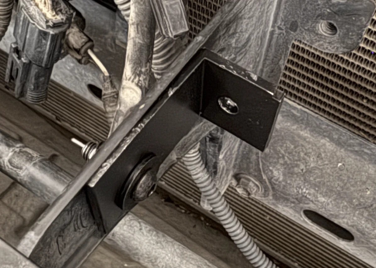

Lower center mount from 2" angle (trimmed to 1x1 on the short side). I forget what the center grommet size was but I used one the same size on both ends that fit snuggly through the hole pictured. Any Truevalue or Ace...

Mounted Upper passenger mount to the hood latch screw which already was grommeted. Added a flat rubber washer between the mount and bolt washer.

Upper L side mount installed with flat rubber 2" washer

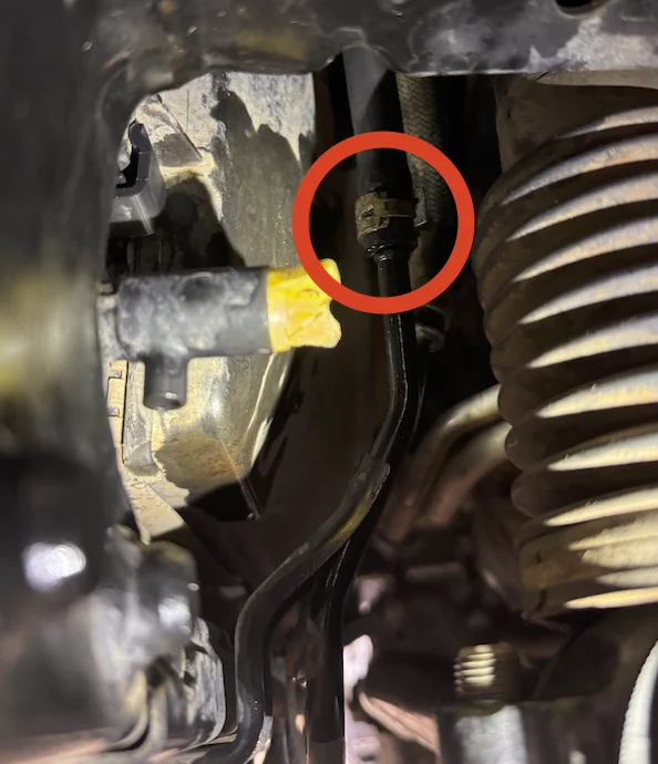

Bottom hard line to trans return (lower cooler hose to this). Mine had the clamp facing the radiator shroud, and I could not get a needle nose in there, so I unbolted the hard lines. There are hoses on the other end of the cross member, so they're pretty loosey-goosey after, and you can drive a truck in there to get the clamp. I used hose clamps on the cooler and OEM clamps on the truck's side of the equation.

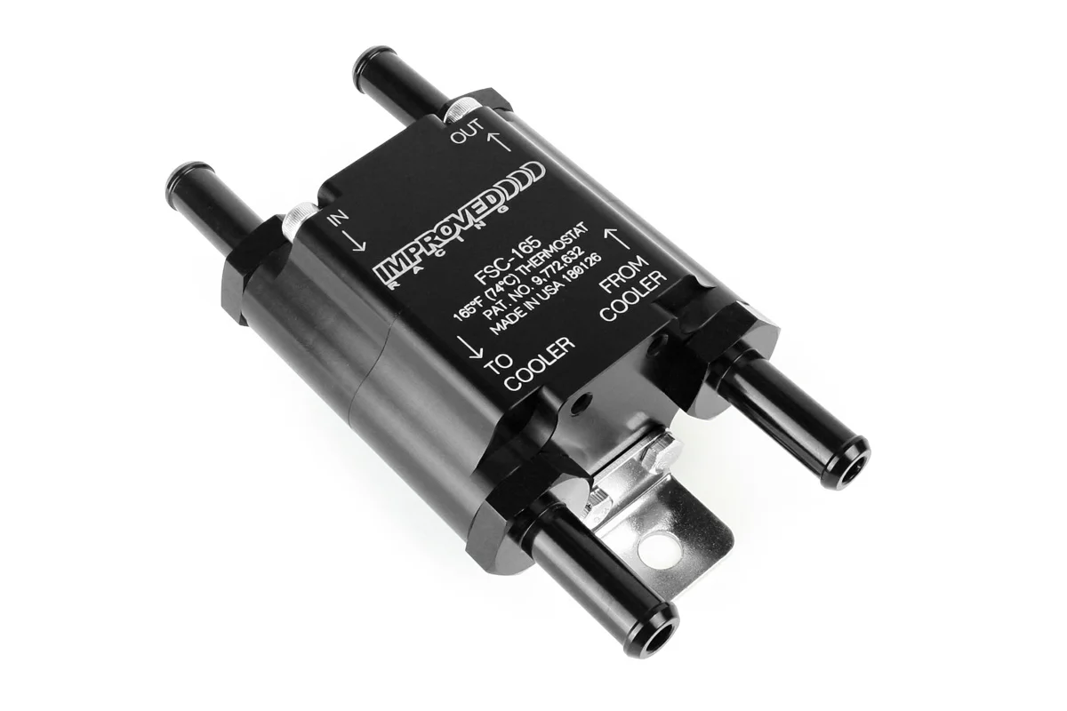

Improved Racing seems to offer a few options that I think would solve a lot of issues, and they have plenty of temperature options to pick from.
This is their "compact" version that flows up to 5 GPM. They also have a larger version that flows up to 20 GPM. Based on my phone conversation with one of their employees, the 5 GPM should be perfect for the use case we're talking about.
Their inline thermostat also keep fluid flowing to the cooler at all times, even in "bypass" mode. It lets a small amount through to insure there are no air pockets in the cooler, which is an awesome feature.

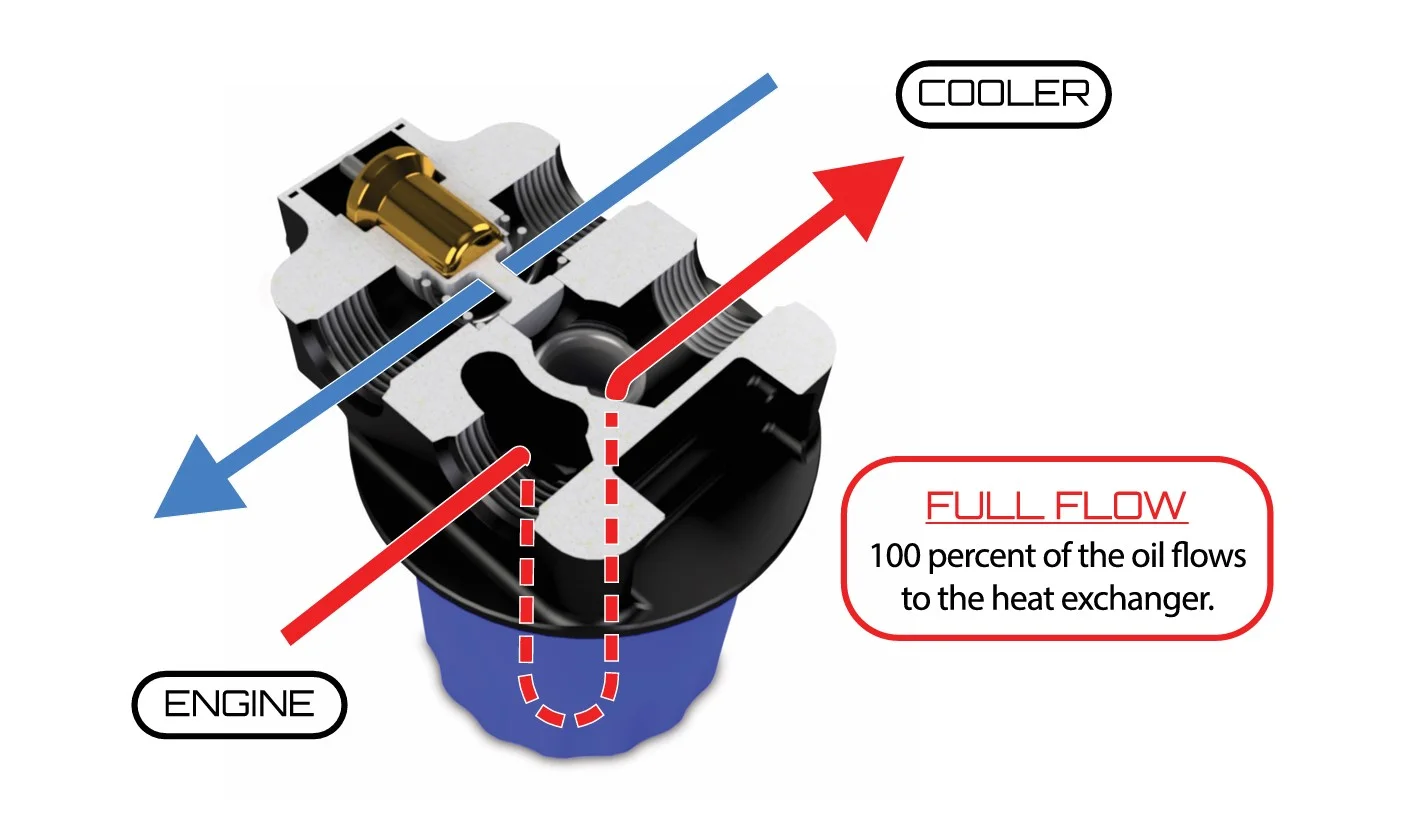

They also make a version of their thermostat that includes a spin on filter mount as well. Honestly, it may be overkill, but I think this is the route I will go If I can find a solid place to mount it. (I'm thinking somewhere in front of the radiator support and behind the bumper/crash bar on the passenger side). Paired with a Wix 51269 filter, which filters down to 10 microns, has an 8psi bypass valve, and has a max flow of 7-9 GPM, it would do well to keep the valve body clean. Change the filter every 30k miles with a pan drain/fill and you are set.
The filter mount with thermostat functions just the same as the non-filter version. Also, it too can be rebuilt with any temperature you want and allows a small amount of flow to the cooler in "bypass" mode to prevent air pockets.
