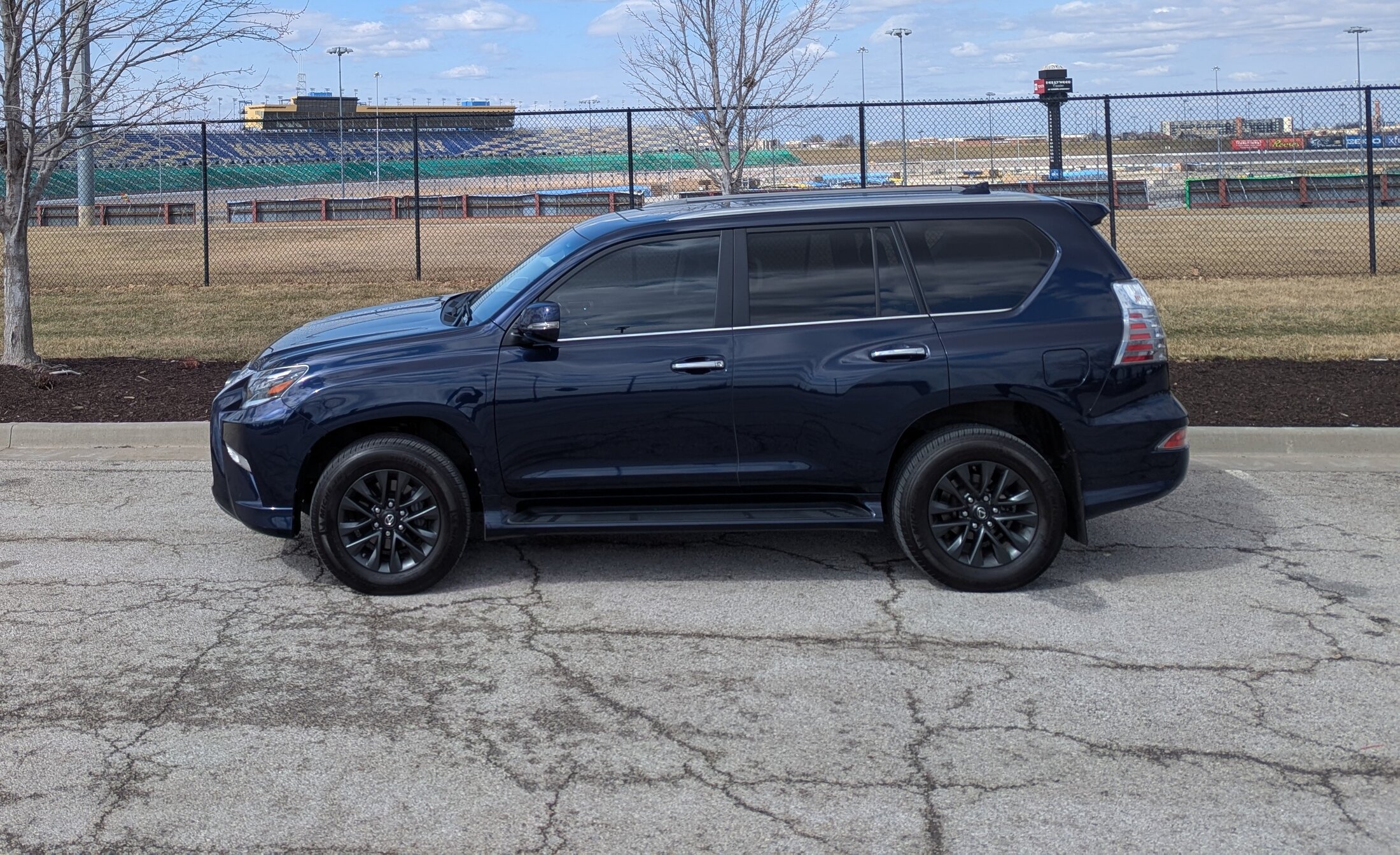

I am very excited to join this group after picking up a new to me 2021 GX460 last weekend in Kansas City. I am still jealous of you Nori Green owners, but Nightfall Mica is still pretty good. 7hr drive home was flawless, such a comfortable vehicle. First things first, needs all new fluids, then a mattress platform before summer.
