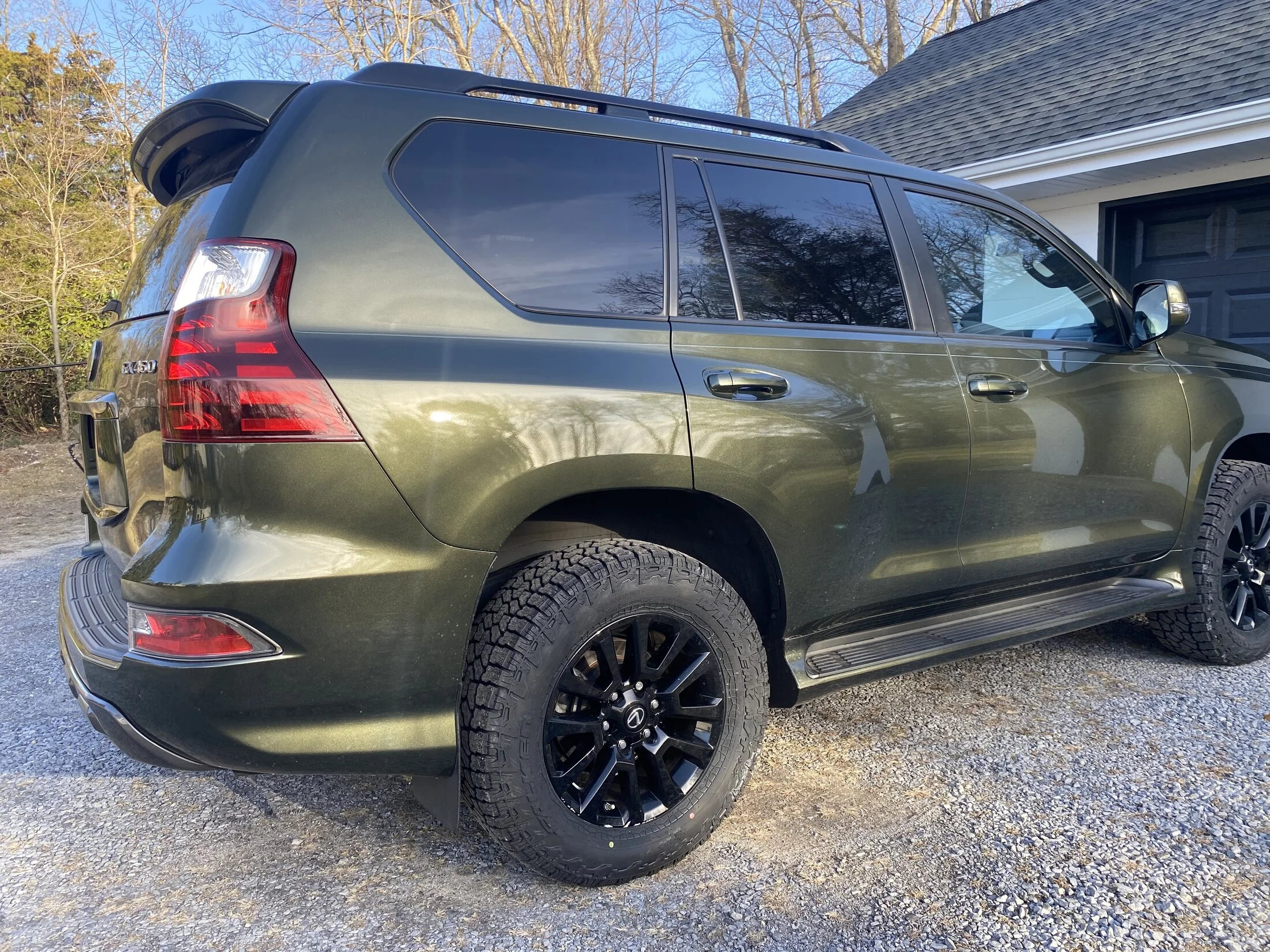

Love that color! You might want to consider woolwax or fluid film for inside and outside of the frame, since you are in salt country
I am starting with a wire wheel and rust reformer for any corrosion on the underside, then I will go with a lanolin-based undercoating (I think). I need to re-watch the Project Farm video to make a decision. I know he also really liked the CRC undercoat.

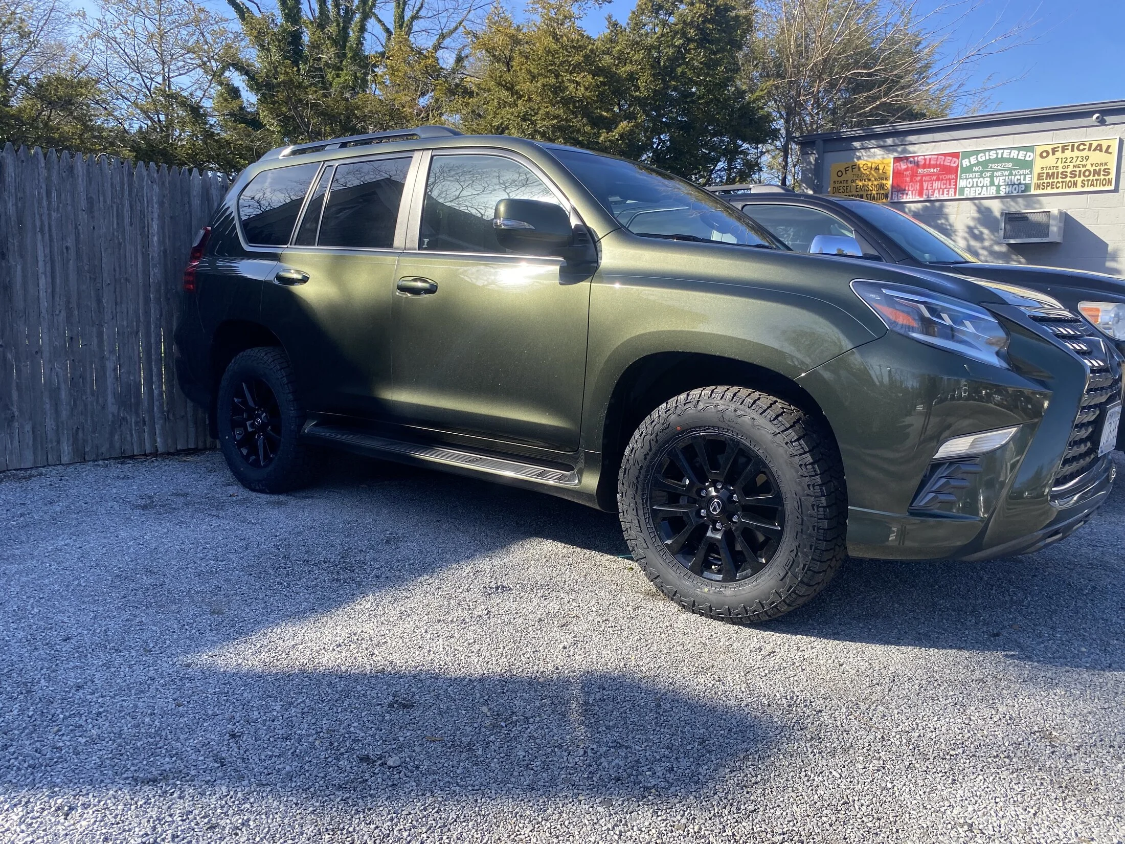

Hi yall, I recently trimmed the front bumper on my 23 GX and was wondering if I can now fit bigger tires. I trimmed about 2 inches to bring the line to the bottom of the grill.
Currently I have 265/70/17 Wildpeaks At 3 on OEM TRD Pro wheels. I had to change out the bolt and do a little message to the fenders, but otherwise no rubbing. Stock height.
I was wondering if anyone has trimmed the front bumper and been able to fit bigger tires without having to do additional modifications, like body mount chop and at stock height.
I was hoping I could move up to 275/70/17 or 285/70/17 with my front bumper trimmed and no additional work.
Any feedback from others on if either bigger size would work?
The TRD Pro wheels might work with a proper alignment. Just depends if the tech can do it and if your particular truck has the room to, but ultimately the front isn't normally the problem. I did a BMC on mine because I knew I was going to eventually, and I fit 285/70s on stock height for quite some time with -10 offset wheels.
