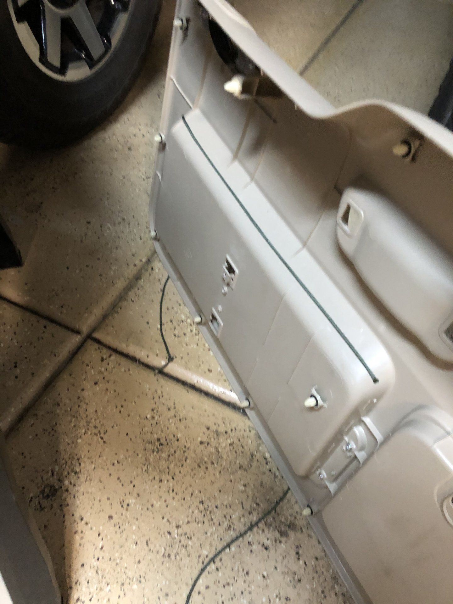

Just a heads up, I am regretting using a plastic coated cable for the emergency pull. It keeps getting hung up on the hole inside. This can probably be fixed by drilling a larger hole but when I go back in there I will probably just replace the cable with a non-plastic coated cable.

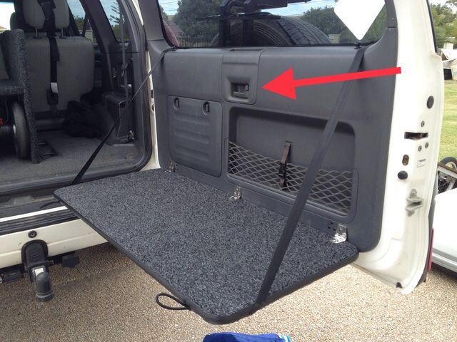

Thanks for the update. I’ll keep brainstorming. I ran across this photo and a lot of folks comment on the table...but if you look closely, it appears the Prado comes with an inside handle. I wonder if we can use those parts and make it fit in ours?

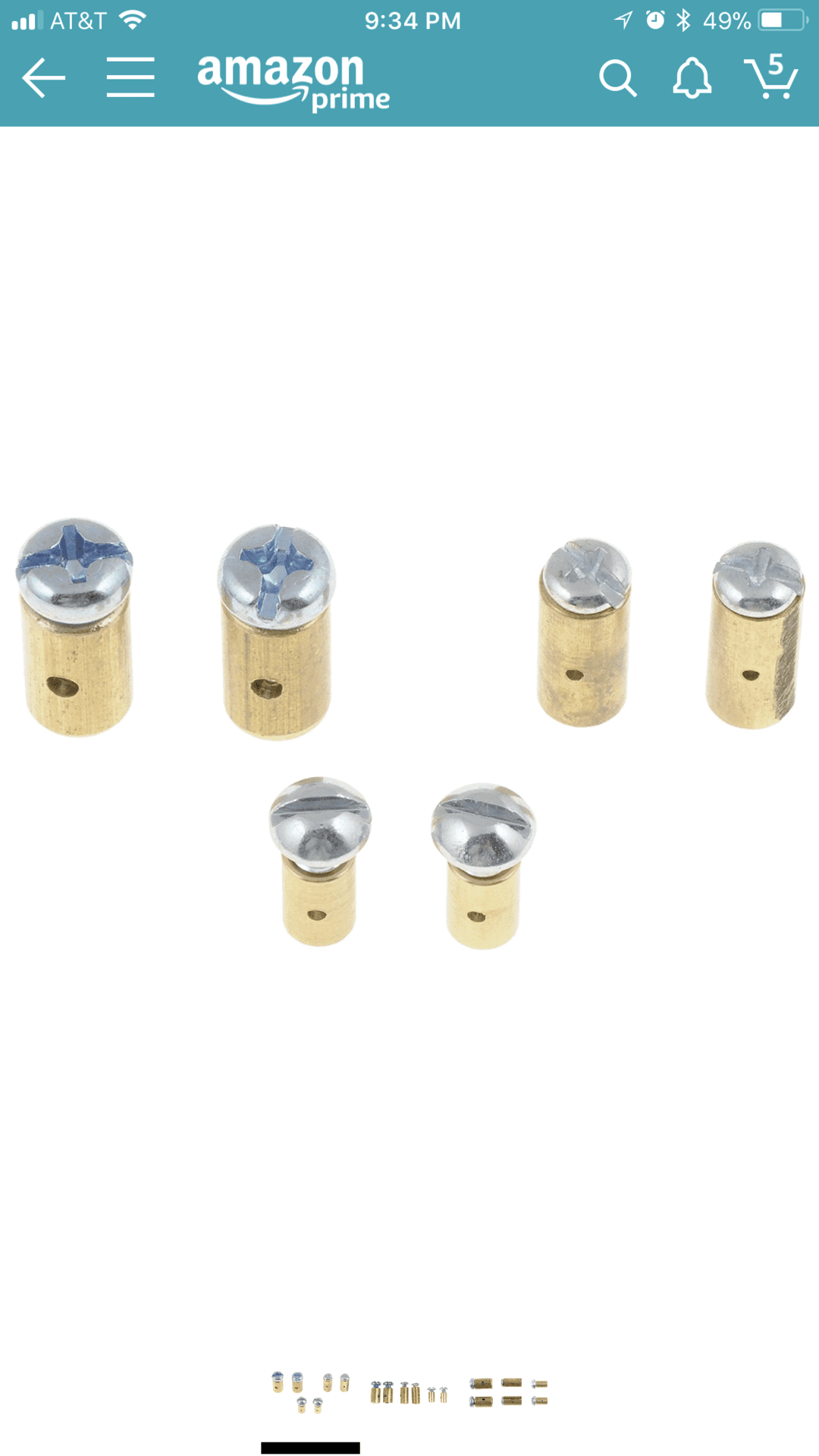

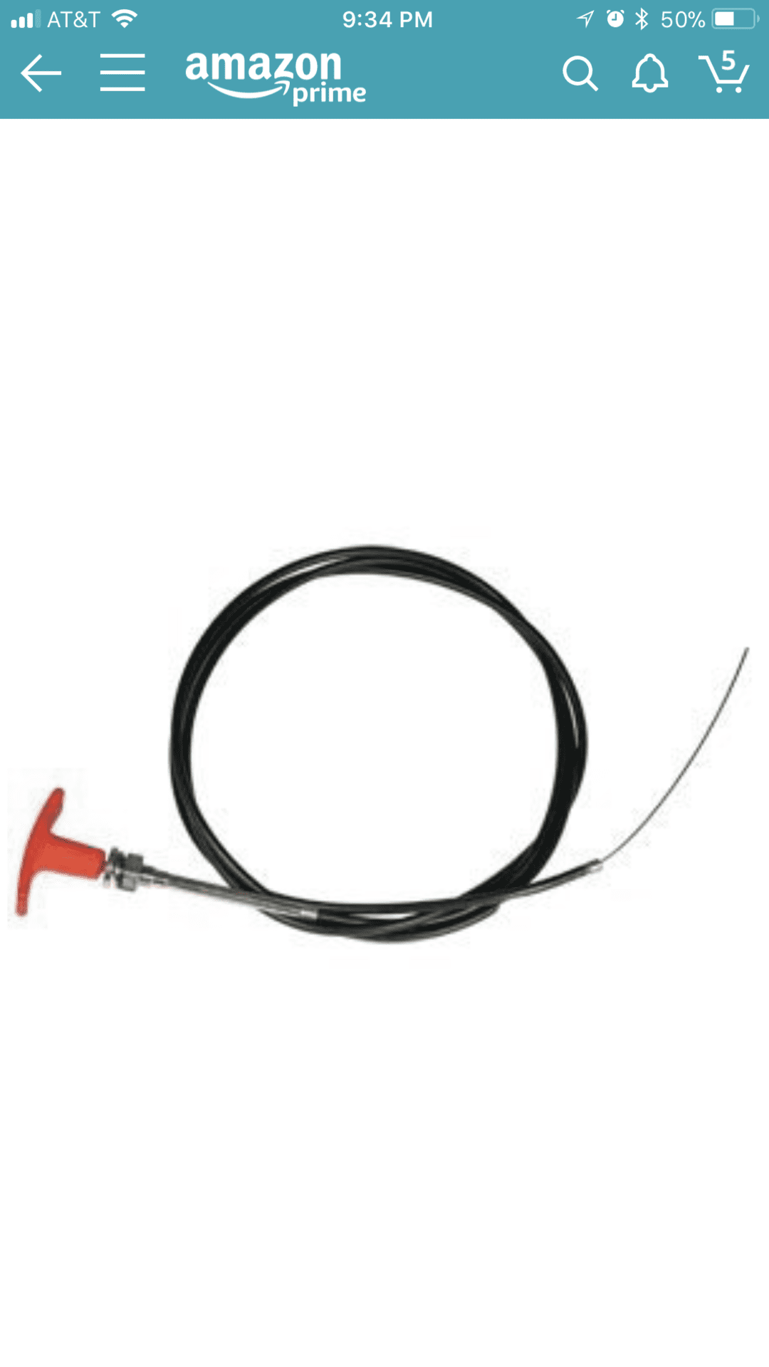

I started thinking about how I wanted to do it and was wondering if this T handle cable would work. I would drill a smaller hole for the cable to go through the plate and then put the cable lock on either side of the plate. The handle part would be similar to the OP’s except there would be a more finished look.
Thoughts?
Have you tried using this T handle yet?
I know this was a while ago but I also had problems with my release hatch. I went the eye bolt method and since my hole was a bit to the left above the release plate, it would always get hung up once everything was reassembled. Did you ever swap out to non plastic coated wire? I ended up just using paracord for now and it works fine now but I’d like to do an actual handle.

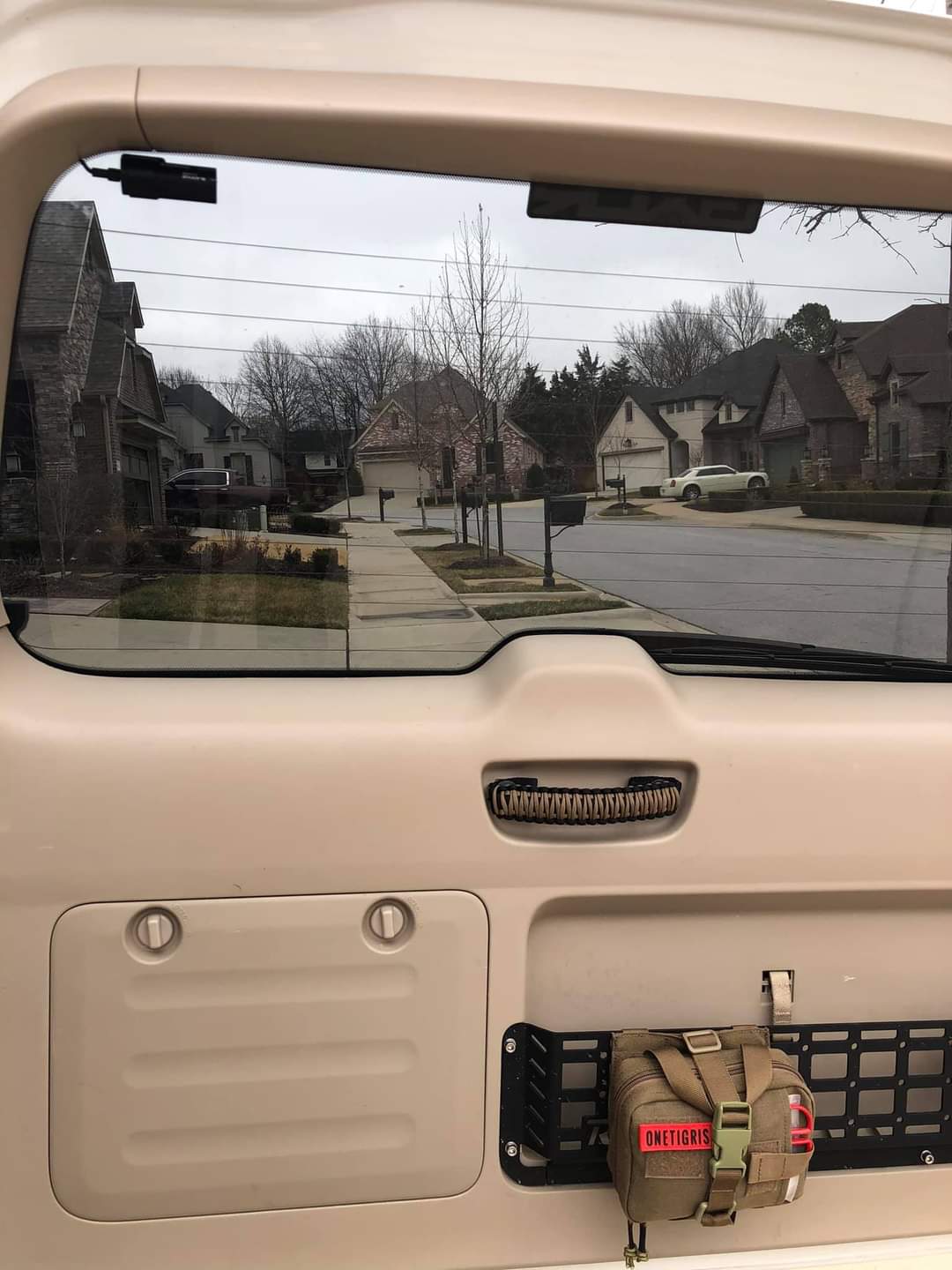

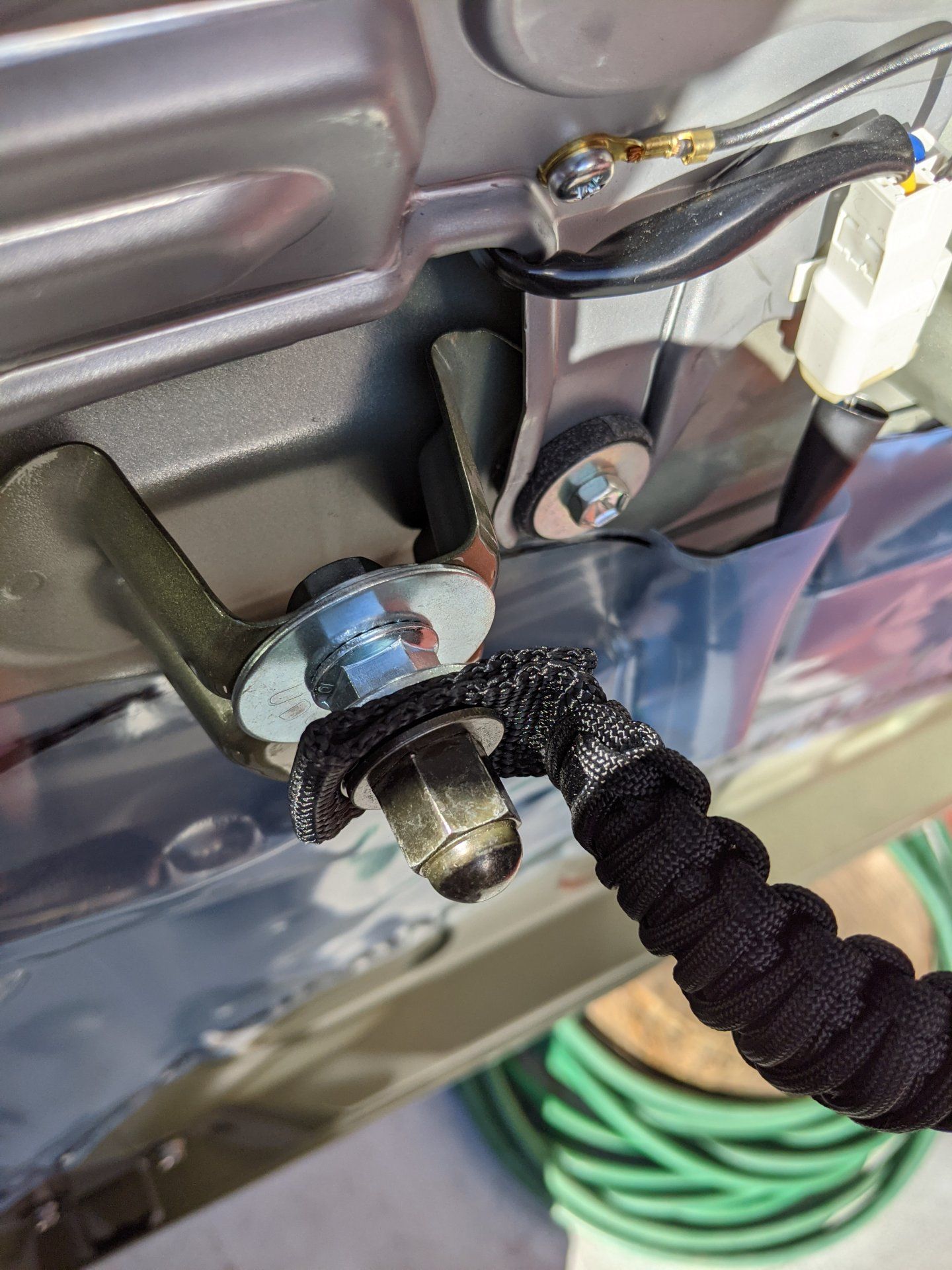

I did the cargo door pull first. BARTACT paracord handle. I looked in my bag of nuts and bolts and found that I had a set of m10 x 1.25mm cap nuts. these were from the seats of an s2000. they are blackish in color. due to this boon, I sourced some 1.25" m10 x 1.25" stainless bolts and flange nuts. I used a couple different sizes of 3/8" fender washers to capture the factory metal posts.
the backside of the post restricts the size of the washer that can be used.
I do wish I could have used lower profile nuts and will be searching for those in the future. that modification can be made without removing the plastic door card.
in the end a 1.25" stud offered a little more than a quarter inch of thread engagement with everything tightened.

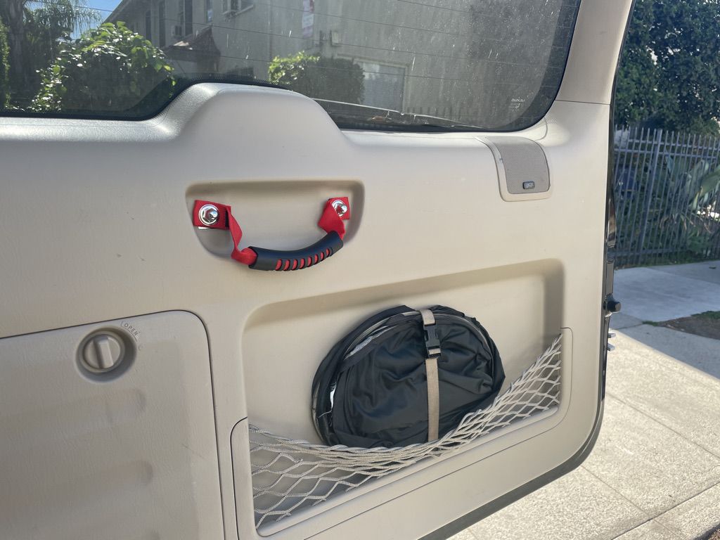

I did my rear handle replacement today. Used slightly shorter bolts than those recommended in the original post. I didn't want to mess with cutting them down. Worked just fine:
Awesome dude. I broke my stock handle when installing my fold down table and have been meaning to do this. Do you remember the exact length of the bolts that you used?

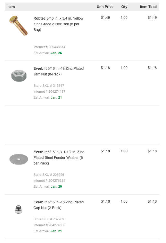

Looking back at the order, I used 3/4" bolts. OP recommended 1" and then cutting off 2 threads of length. Seemed like a hassle to me, so I just ordered shorter bolts. Worked just fine. Here's what I ordered:
And these handles
And these handles
Sweet, I’m just gonna get 3/4” long bolts then as I don’t really feel like cutting either. Thank you for sharing. Looking forward to getting the new handle in.
