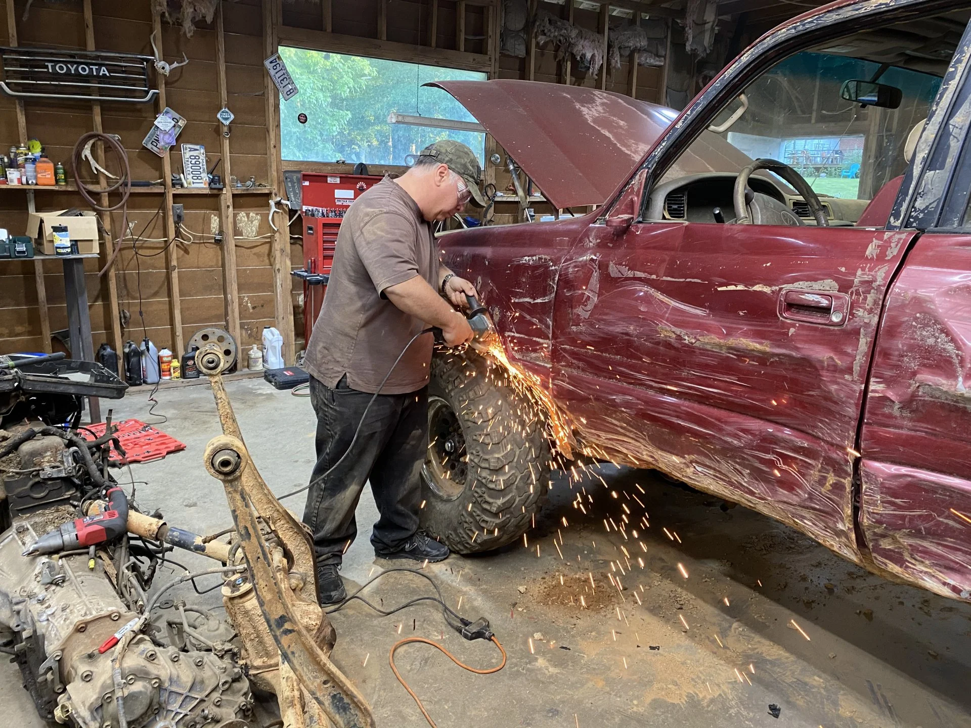

Had a blast this weekend boys. Thanks for having me over @AJR , and KILLER new rig @IcutYourCruiser
Good to hang out. See you boys at gsmtr.
And thank you to Adam and his family for preparing a great dinner, then the boys drinking by the fire.

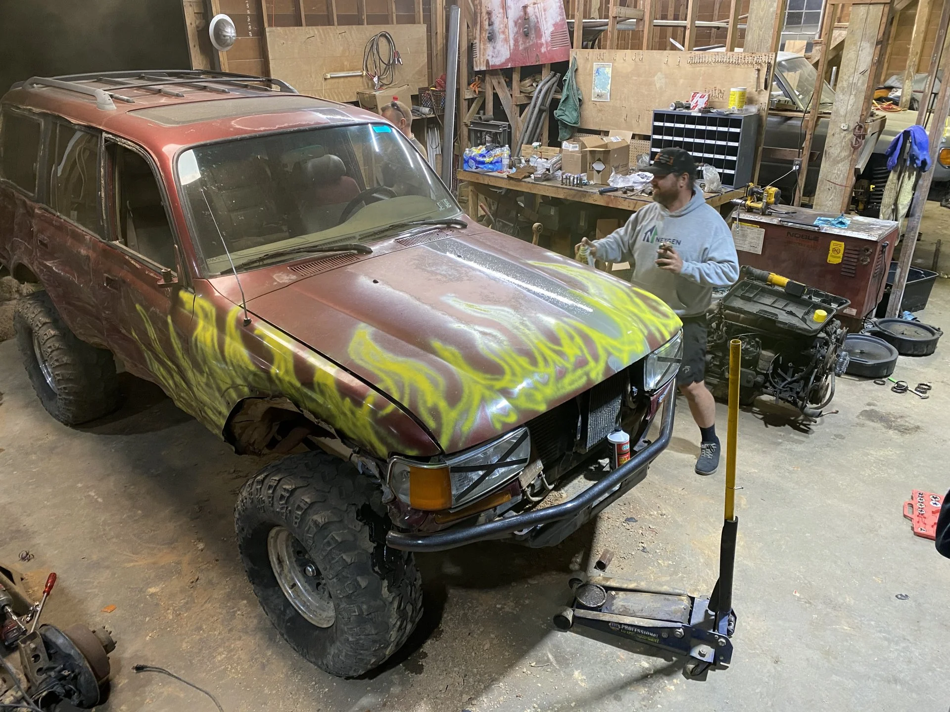

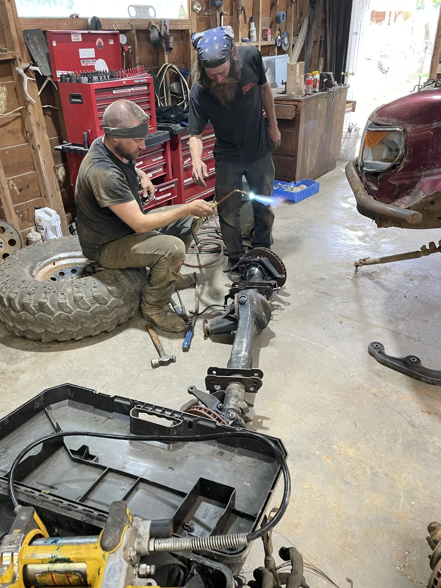

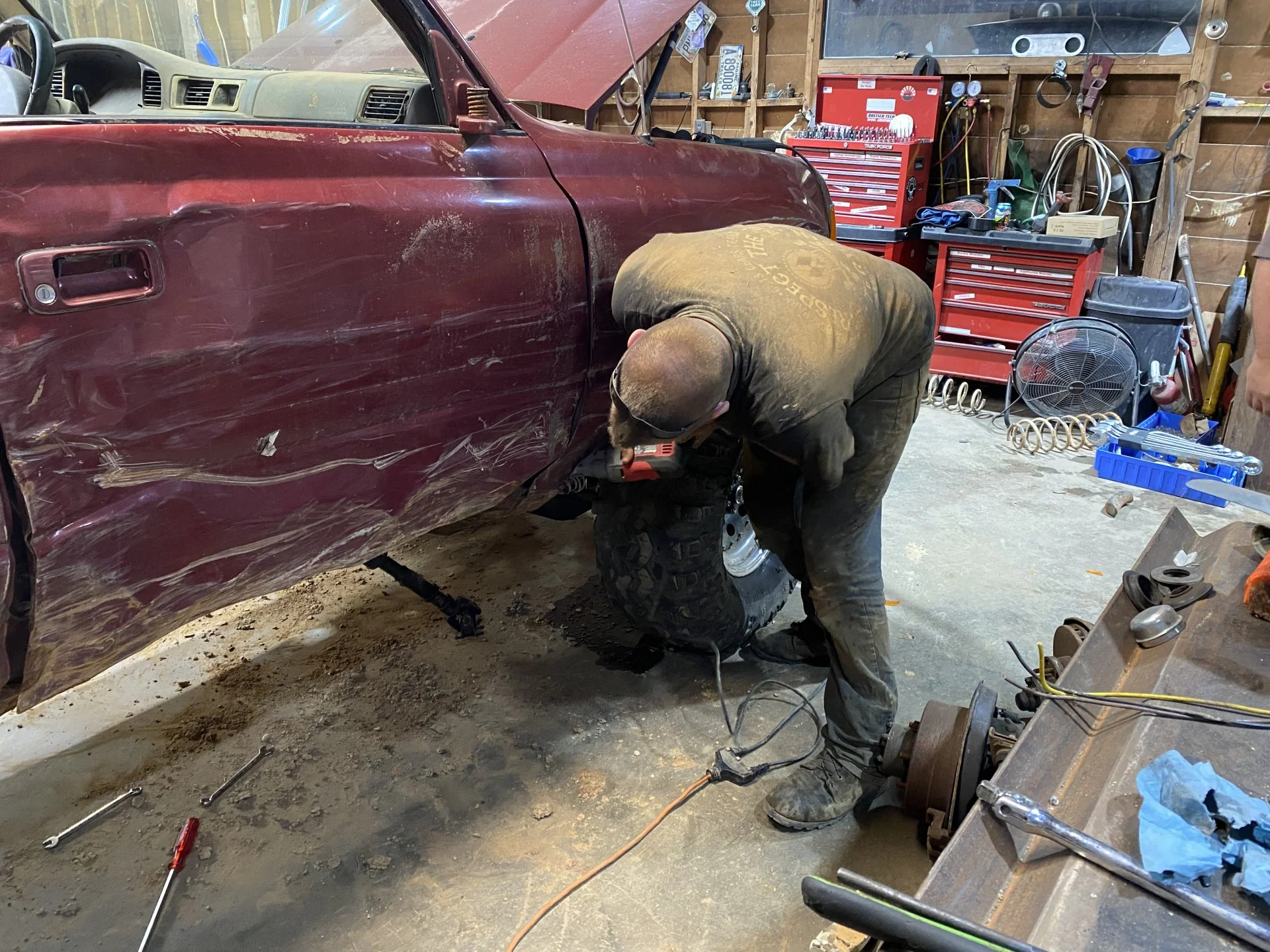

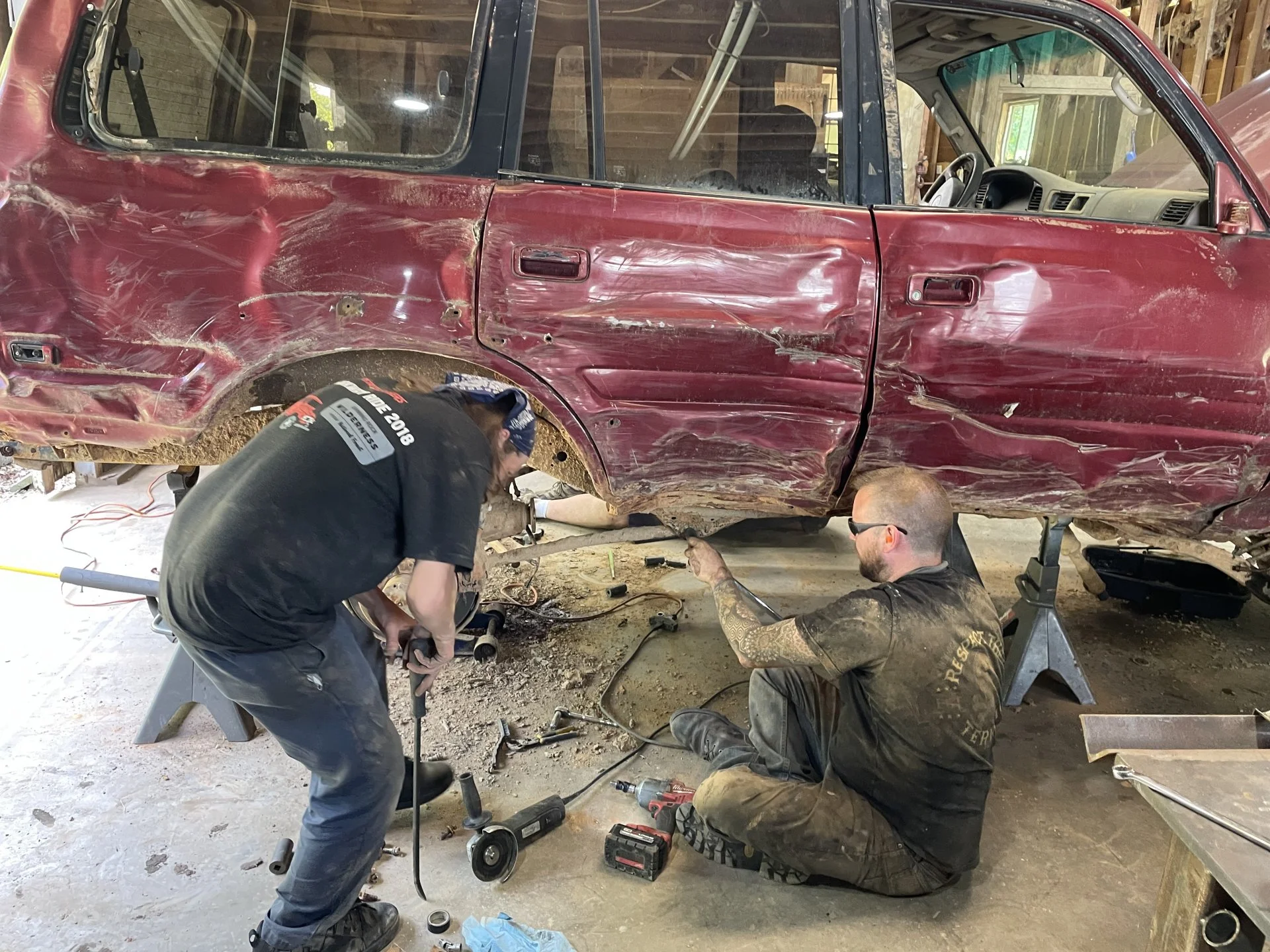

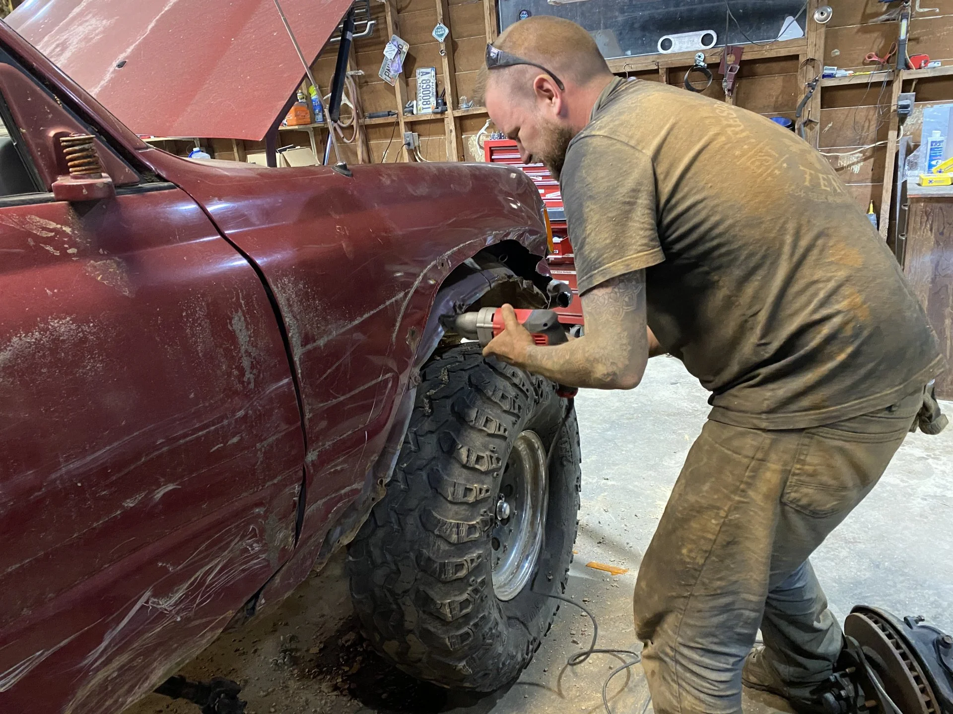

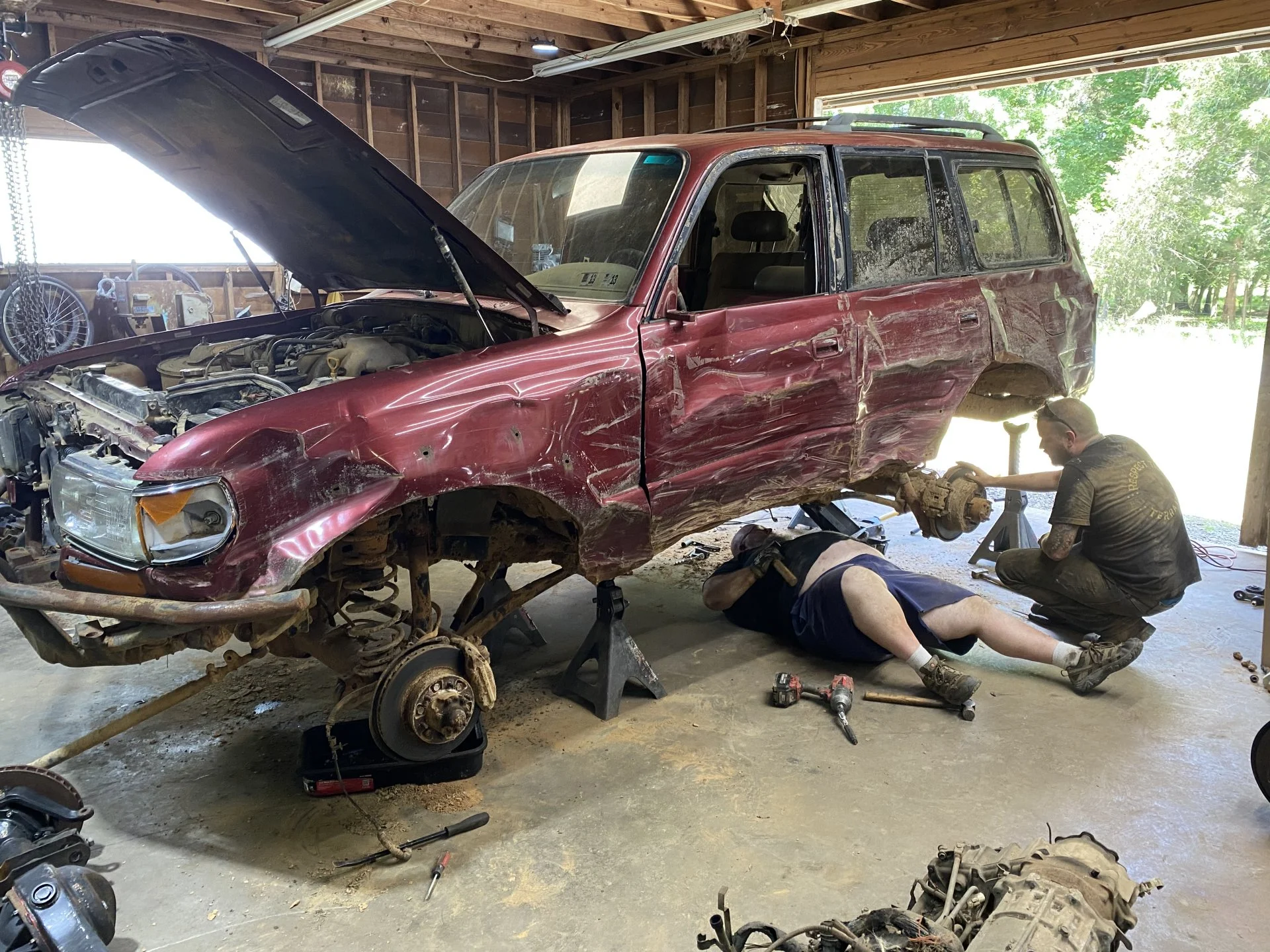

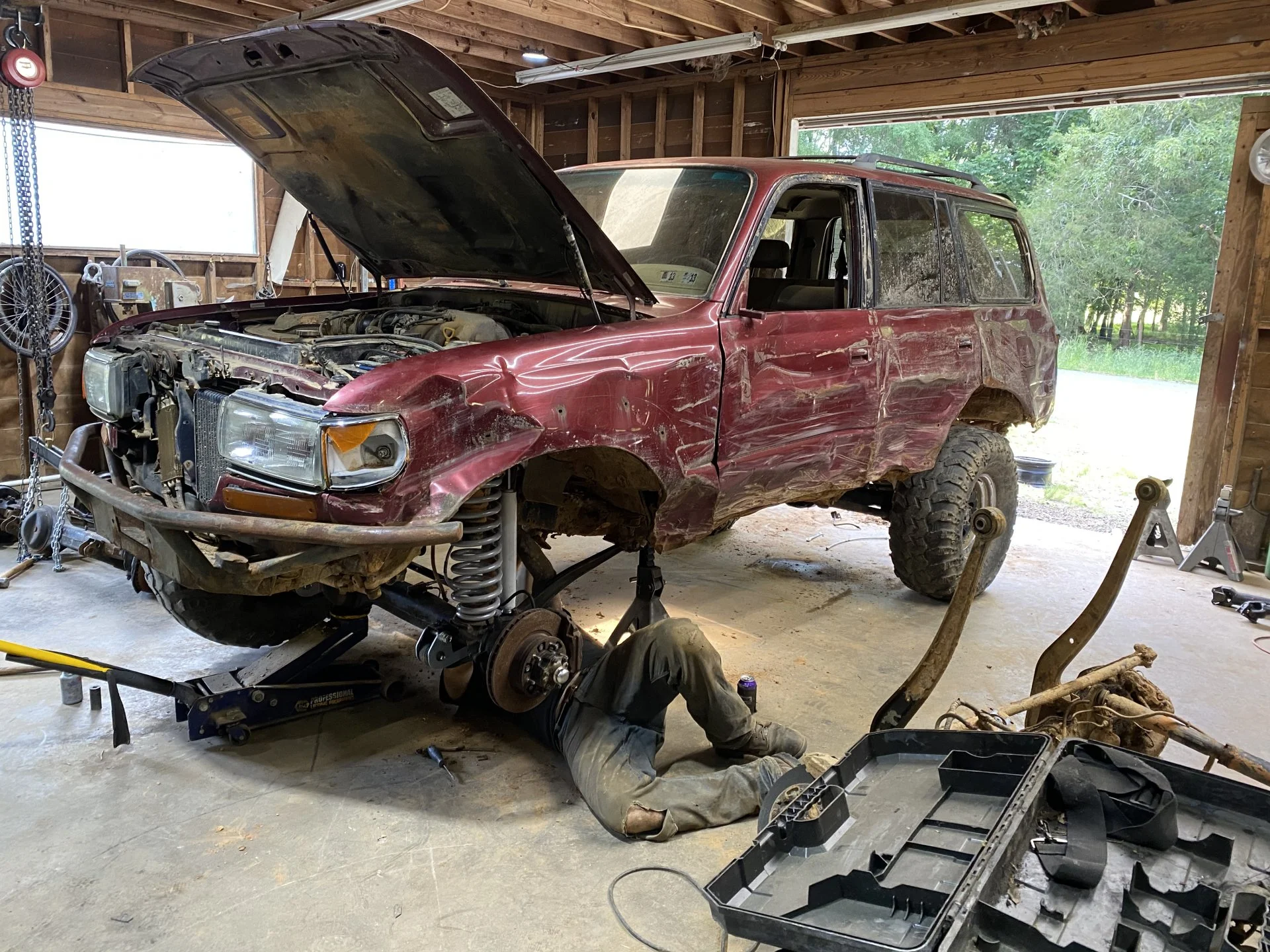

It was a fun time, glad to have everyone over. We were able to get the rear of Hatchet done, and the steering rods built. Looks like I still have a good bit of work left before GSMTR.
I took the Hellfire knuckles off again after everyone left, turns out this first version of these knuckles has to be put on after the birf and axle are in, the birf won’t fit through the hole behind the spindle. Good time to paint them I guess. I’m ordering a couple misalignment spacers to finish the steering, then welding on the sliders, modify the panhard bar, put on shocks and I’m ready to roll ( I think).
Thanks everyone for the help and fun times.

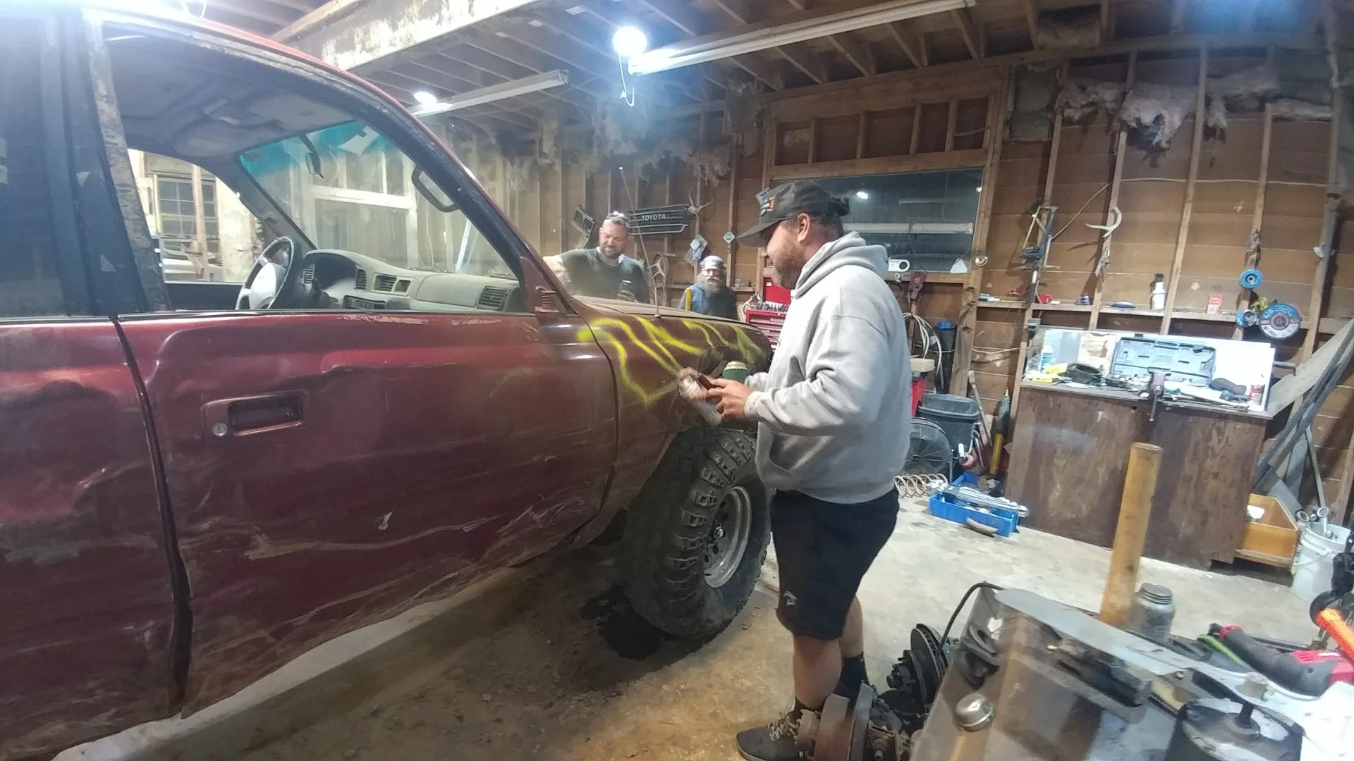

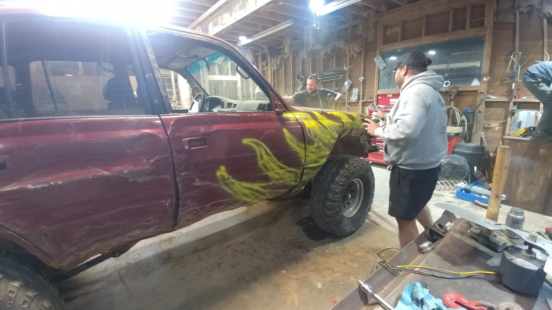

Glass?! For what, lol
Actually, I was thinking about this question a little more... the answer should be obvious. Glass for breaking of course!
It's a mystery to me how there's still glass in it to begin with!
Looks like I left a little too early. I missed out on the painting party!
