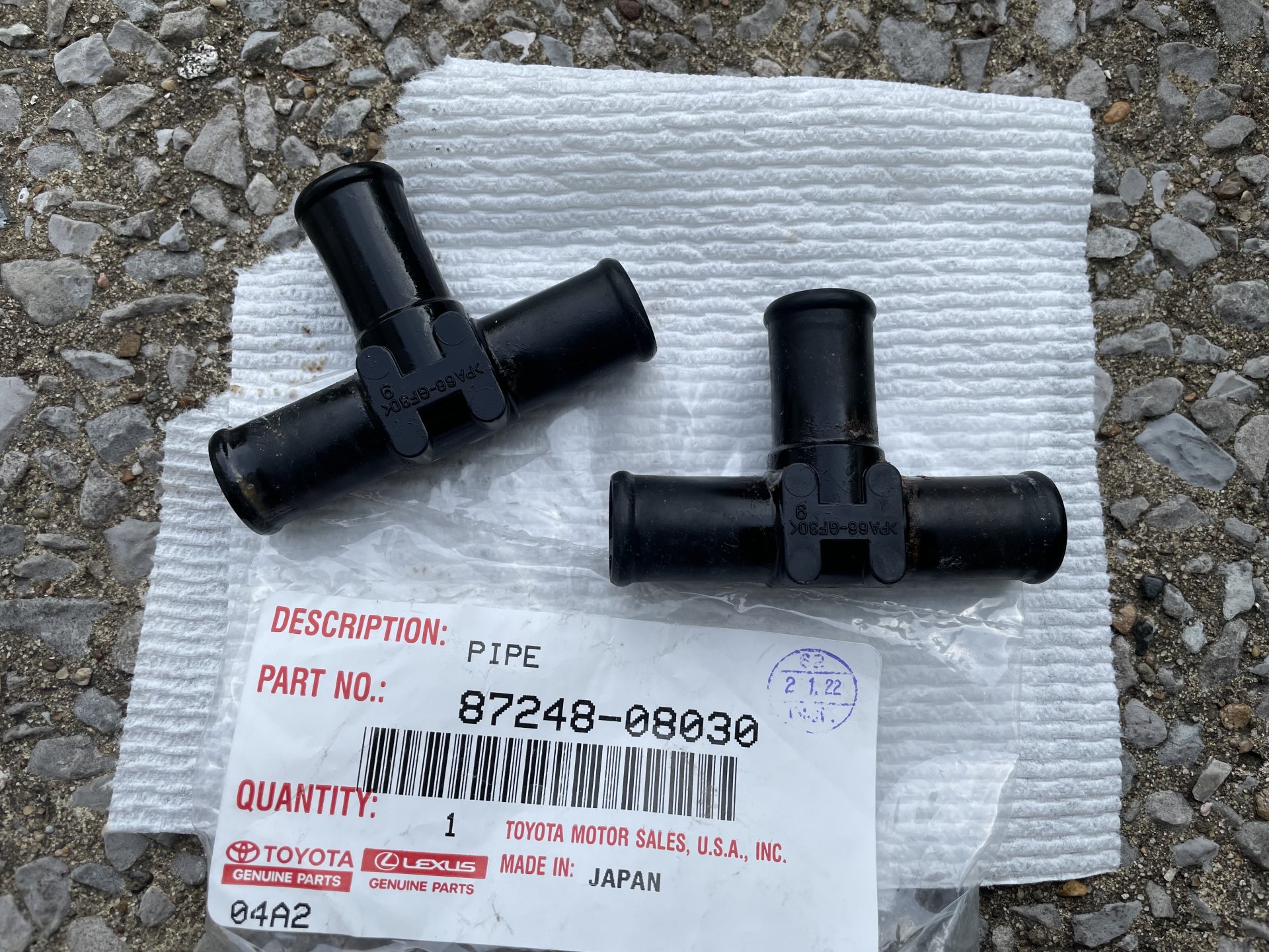

Replaced the Heater T's. They were original to my May 2008 built LX. Honestly they felt just a solid as the new ones I replaced them with.
One note: When putting the hose clamps back on, make sure to align the hose clamps with the indentations on the old hoses. I had one hose clamp fully seated, but rotated 90% from where it was previously. I got a slow drip leak on the exhaust. It went away when I rotated it back to the original position.

Nice. I ordered the complete T and hose kit during the recent sale, hopefully it gets in soon.

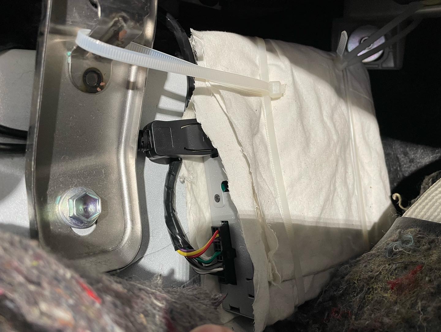

Installed the GROM VLine2 after the most recent group buy.
Since there are at least 3 head unit options for 2008-2011 LX, mine is a 2008 Mark Levinson w/ 6 disc CD-changer & hard drive based NAV. With this head unit, following the install process linked here, I had no hanging cords left over.
Overall: Highly recommended for those in the Apple ecosystem. If you're in Android ecosytem, there may be better options.
  • Wired CarPlay works flawlessly
  • Wireless CarPlay works 98% of the time (Toggle phone's wifi on/off if you have issues)
  • From car start to screen is about 10 seconds (Not bad, given you should probably let your engine settle down a bit before putting into gear)
  • "Swipe" functionality isn't great; you'll like things better if you use the arrows (This is a result of older capacitive screen)
  • Hit the "Disc/Aux" button 1-2 times to show CarPlay
  • Sound quality is just as good as from CD; better than bluetooth
  • Hit "Scan" button 3 times to switch screen from CarPlay to sound settings (Bass, Mid, Treble, Fader) --> Adjust to your liking --> Hit "Scan" button 3 times to return back to CarPlay
    • This is probably my #1 tip if you have crappy sound
    • Remember that sound settings are specific to each input, so make sure to adjust the settings for this input

Shoot GROM a message via their support page. Looks like they need to update their manual for the LEX6 (your 2010), as they show the "Scan" button on page 12 of their manual. They probably have a special sequence for it.
On the 2013+, you hold down the "Menu" button.

There is a "Shortcut" that says "Factory UI". You do it from the GROM Android launcher (If you are in Carplay mode, click the widget that says "GROM" to get back to the Android launcher). Hit the + button in one of the open fields and then select the "Shortcuts" tab and find the one called "Factory UI". Use that button to get you back to the OEM interface. If when you click it, it goes to Maps, or whatever your screen normally goes to, click the "Audio" button directly under the screen and you should be on the "USB" audio input and the title/artist/album fields will all say VLINE. You can hit "Sound" from there to adjust the USB input. After you are done, hit the "Aux/USB" button twice to get back to GROM screen.
Just added the shortcut on my GROM as well. Thanks for the tip @lx200inAR!
