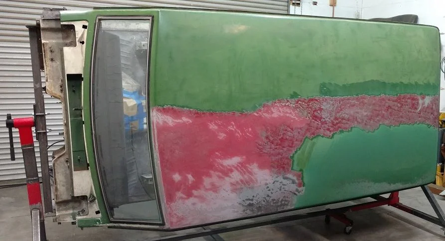

Two year update, lol. Finally finished the body support rust repair and sprayed with 3M undercoating. Working on painting the roof while the body is on the rotisserie. Hoping to get this on the road before winter, we'll see. Going to prime and paint after getting down to the factory paint/primer with some spots of bare metal. Not sure how well that will work but would prefer not to take it all the way down to bare metal.

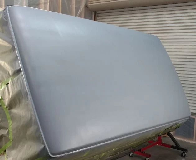

Before epoxy primer:
After a couple coats of epoxy primer:

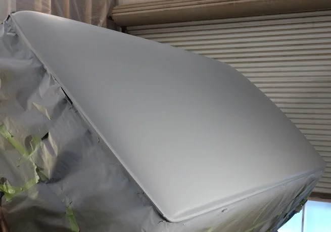

After a couple coats of high build primer:

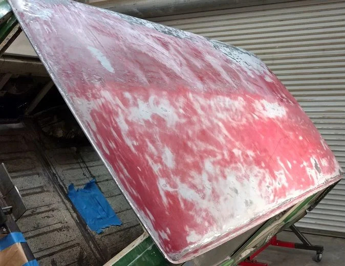

After sanding the high build primer. You can see some orange peel and the downside of not going down to bare metal:

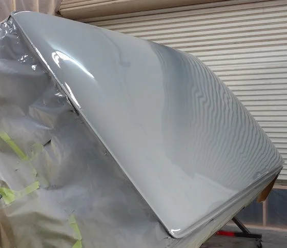

Finished roof, still need to wet sand. Had some sags/runs after the first two coats. Waited a day then sanded the roof with 400 grit and sprayed a few more coats this evening. Other than a nat that stuck itself in the middle of the roof, it looks ok.

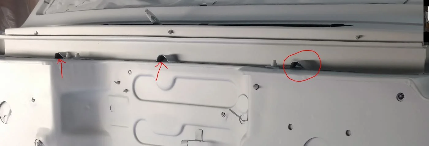

The spot circled has the seam sealer going across the opening while the spots with the arrow do not. I don't remember if the spots used to have the seam sealer and I wiped it out with the wire wheel. Any chance someone could look at those spots and let me know if those openings should have seam sealer going across the front? I would think they need to be completely open for water to drain but not sure why the one spot has it, the line of sealer goes back a little bit so the wire wheel could not remove.
I would want the openings open and the rest of it sealed .hth.
