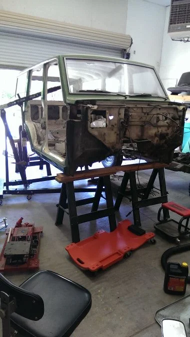

Hello, Ian's dad here. Here are some pictures of our progress so far. Running into a lot of rust on the bottom half of the pig. So glad we have the parts rig because we'll probably end up using the frame and front clip. Ian has a salvage title for the 77 parts rig and a clean title on the 78. If we use the frame and front clip from the 77 and everything else from the 78, what are we left with as far as title? We might just put the rear cross member from the 77 frame into the 78 to avoid any problems with getting a clean title.

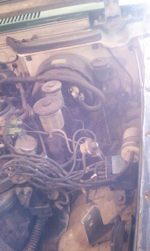

We have finally started working on the cruiser after a move and remodel. Here are a couple of pics and I'm sure we'll be bugging you all with a lot of questions over the next few months. :) The original plan was to have this project done by the end of October but that's going to tough to meet at this point.
Thanks, the plan right now is to keep everything stock. We are going to get everything cleaned up and try to repair all the rust. Bobm will be getting an order from us in the near future. Engine was running okay so we'll just replace all the seals/gaskets and possibly send the carb out for a rebuild. The only thing done at this point are the wheels/tires, which we had blasted and powder coated.

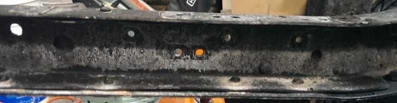

I'm hoping to get some opinions on what to do with this rear section of the frame. I'm worried about the areas where the inner part is separated from the frame. We will be taking the frame in to get sandblasted. Would you take the time to remove all of those rivets to get that section out and cleaned up? Thanks.
Hmm, I'd only take the rivets out if I was certain I had a way to replace them. That said, looks like that Pig has led a rugged life. You had a lot of rust to start with, but you're there and a better judge than me looking at the pic. Yeah, they look worrisome, but if the frame is basically solid, not sure I'd want to start with those rivets, either.
It looks like the upper piece is just bent up, not rusted and flaking away. If just bent, maybe leave it alone and treat for rust.
Hard to tell from here.
The metal is pretty solid. Here is how it looks after a pressure wash and spray down with phosphoric acid. Local powder coating shop quoted $75 - $100 to blast the frame so we'll do that and see how everything looks. Ron, what did you use to paint your frame? Your build looks great, we're going to attempt to copy some of the stuff you've done. Thanks.
