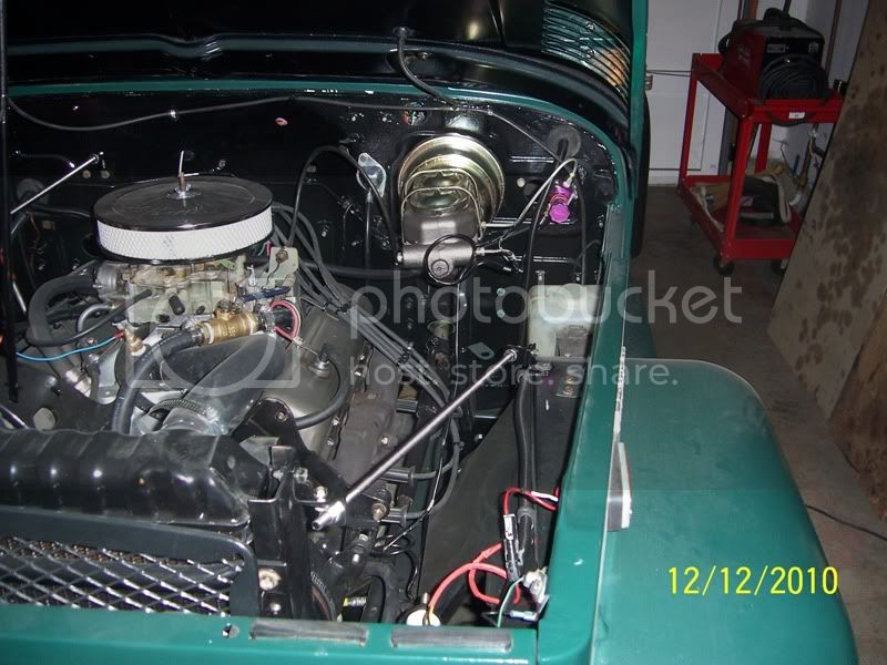

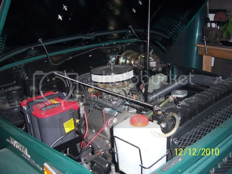

Added radiator support rods

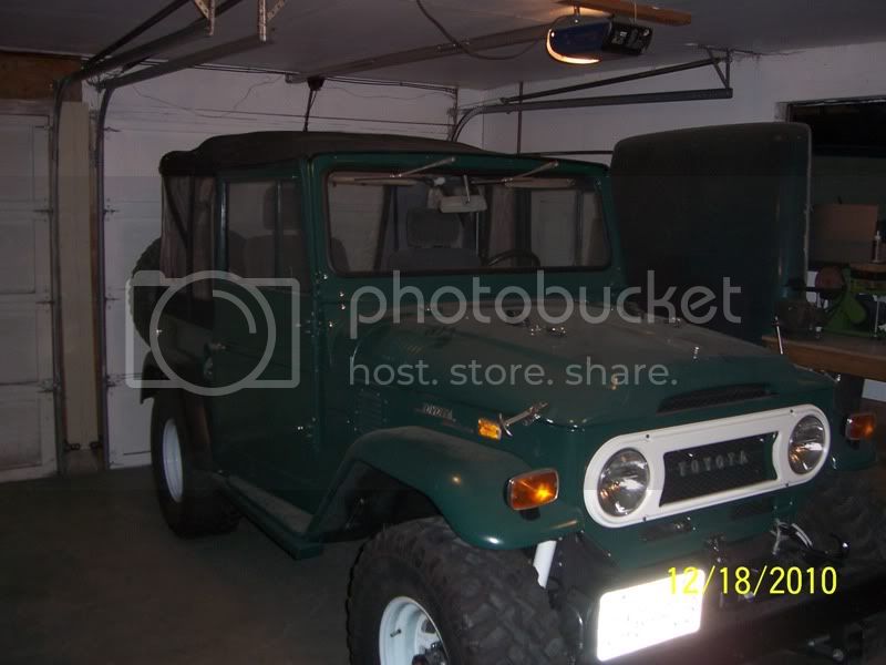

Not much else to report. Received new weatherstripping from SOR for the Windshield and rear sides. I was then able to install the soft top. I also received and installed new window regulators.
Repainted the bezel the correct color (it looks whiter than it is).

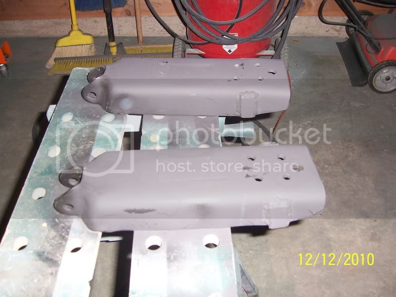

great build.. lots of good info ... where did u get that booster\master setup ? one more question. not trying to bash your skills cause i really like the build. "but" i noticed the welds on the motor mounts did not look like they had enough penetration as it could have. that being said i noticed the small lincoln welder in the back of a picture, also saw there was no gas tank.. flux cored wire maybe? again just trying to input and not bash... my build up should be coming up soon and i would like all the input as possible ... :cheers:
Thanks Nick. It was great driving it finally.
77TPIFJ, yes I was using flux core wire since I don't have a bottle. Thanks for the input on the welds, I'll keep an eye on them. I'm not the greatest welder. Good luck with your build. It seems to take forever, but it's worth it.
