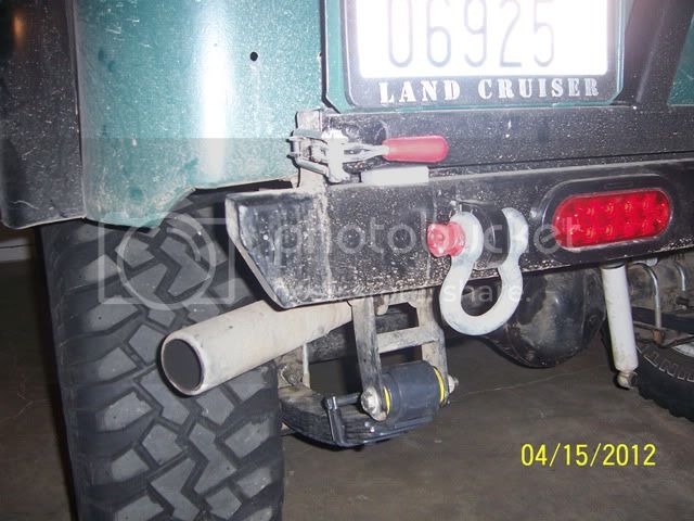

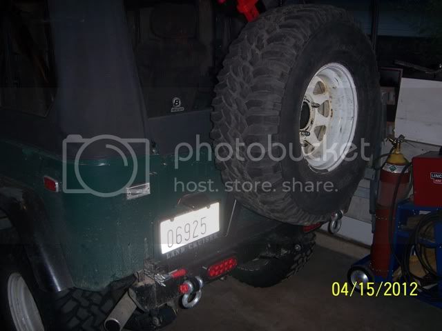

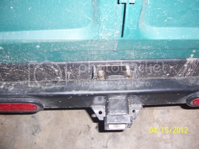

First is my tire carrier. I didn't take pics while building and it's dirty now. Oh well, you can tell how I made it.
Here is from the back
Carrier swung out.
My latch.
Hinge side.
How it's mounted.

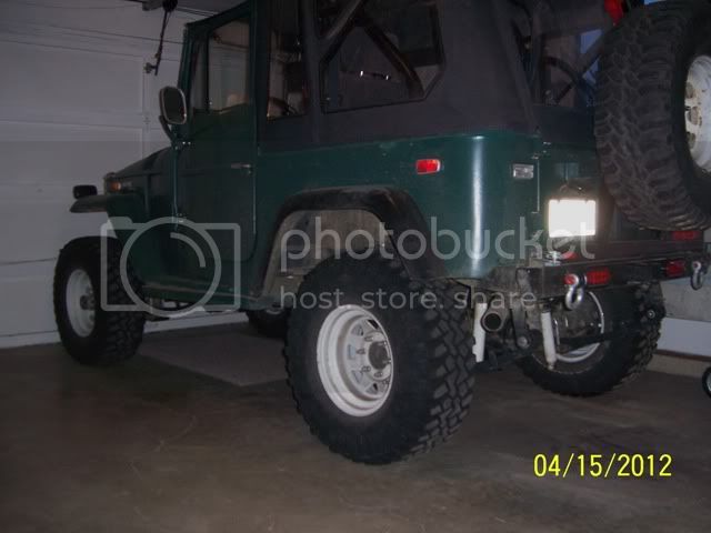

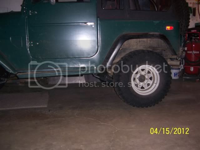

You may have read a previous post about the issues I had with OME springs I bought from Man-a-fre. I fabbed new fixed mounts up front to resolve the lack of lift from the springs. I gained just about 3", but I'm sure it will settle out a bit. In the rear I used 4" OME rear 60 springs. The actual lift was more like 3".
I still have some work to go. The rear shocks still fit. Both drive shafts are fine. The brake lines are fine as I made them long to begin with because I new I was going to get a lift. In front the shocks are 1/2" too short. I previously installed Ford towers and bolted them on because I figured I may have to move them. Next weekend I'll take them off, weld up the holes and redrill 1" higher to lower the tower an inch. I also need to put my shims back in. I thought I might be able to get away without them, but I am at 0*. I have some 4* shims I will put back on Saturday.
I am worried about shackle inversion front and rear. I'll have to keep an eye on them. I do plan to fab new shackles so I might make some boomerang shackles. We'll see.

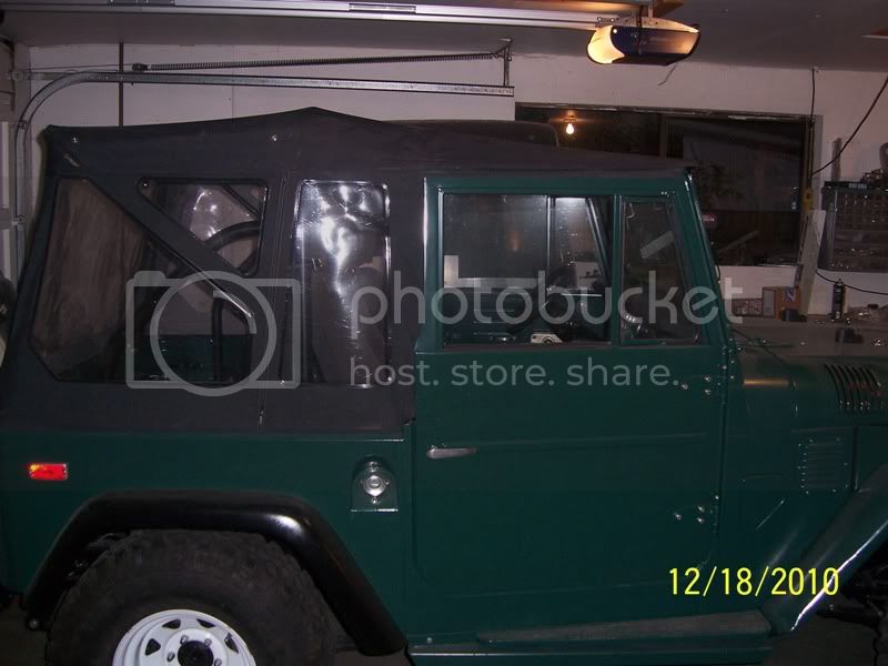

Here is a before shot I took a while back.
Ane here are some quick shots of the lift.
In case anyone is wondering, no I can't get out of the garage. At least with the soft top on. I am going to lower it and measure to the top of the roll bar to see if I can get out of the garage. If not them I may air down, or at worst unbolt the roll bar and drop the windshield. :meh:
