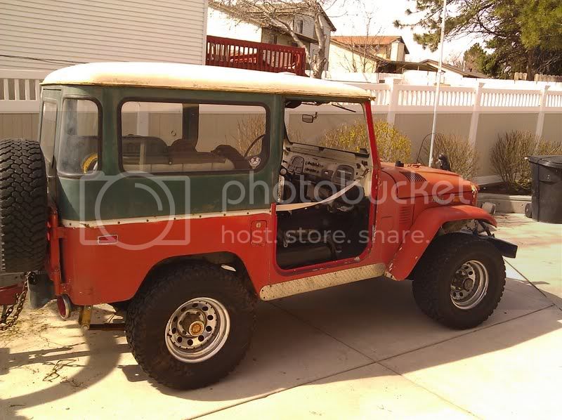

We decided to put it to work, but of course we needed to take the doors off!

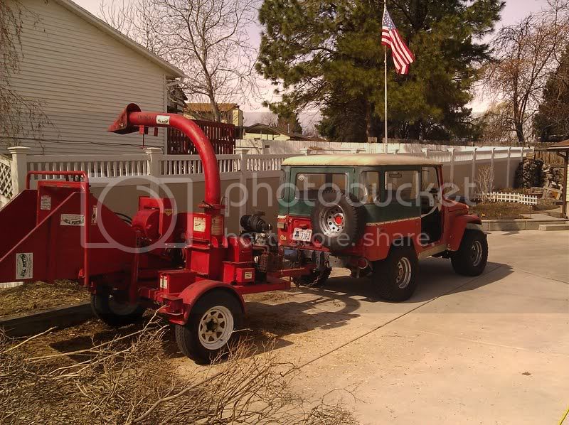

We used it to pull out a bunch of old bushes in my parents front yard, Good practice for when I need to pull out all those jeeps here in Utah.:)
We then had to rent a chipper and get all the bushes mulched up. So we went down to Dill's rental and got a bunch of funny looks pulling out with this hooked on behind!:cool:

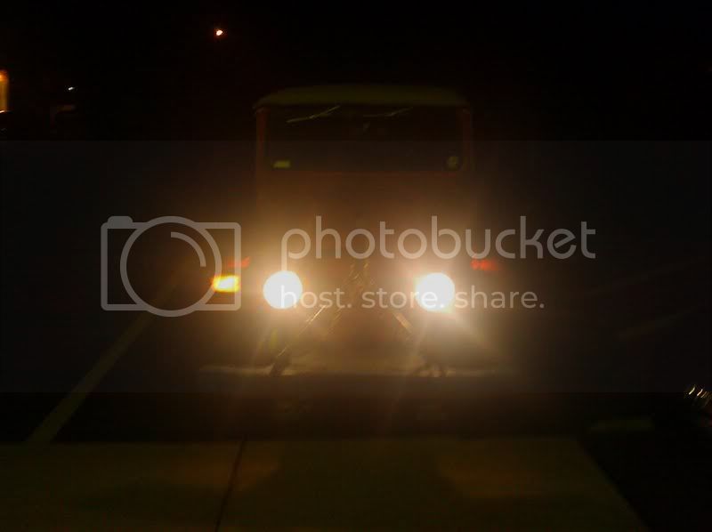

So my headlights are a little dim. They don't get too dark at idle
thanks to a new alternator and voltage regulator.
So I of course called up Kurt at cruiser outfitters to see
what he had. So here is the write up.
So IPF inserts with new lights. Here we go.
Its pretty simple just like replacing the stock sealed beams.
Plug new lights in and all set!
Here it is in the dark.... Or should I say not in the dark ha ha.
Don't worry I made sure my bezel was fat side up!

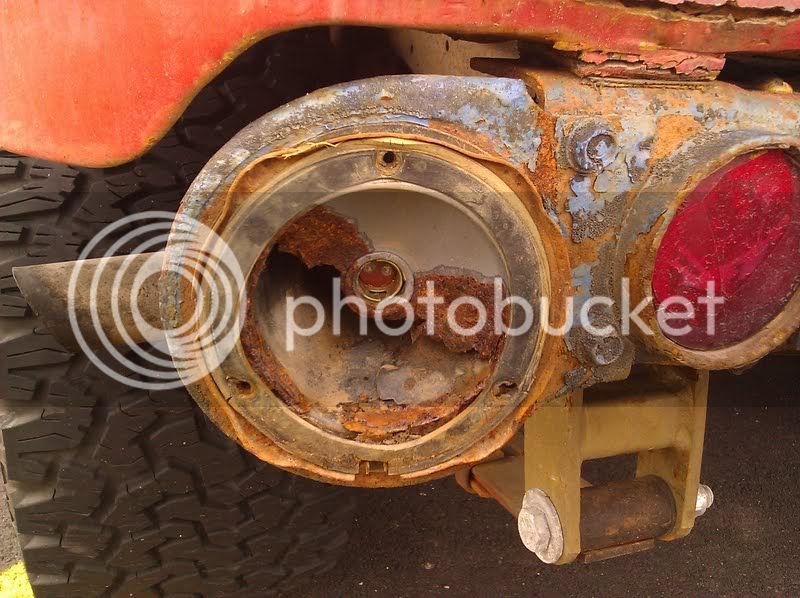

So after this I had a light that was out, so I checked inside to see what was up.
This is what I found :frown: The joys of owning a 40 right!
SO again! Kurt to the rescue. New OE replacements.
Just had to hack away and get the old ones out of there.

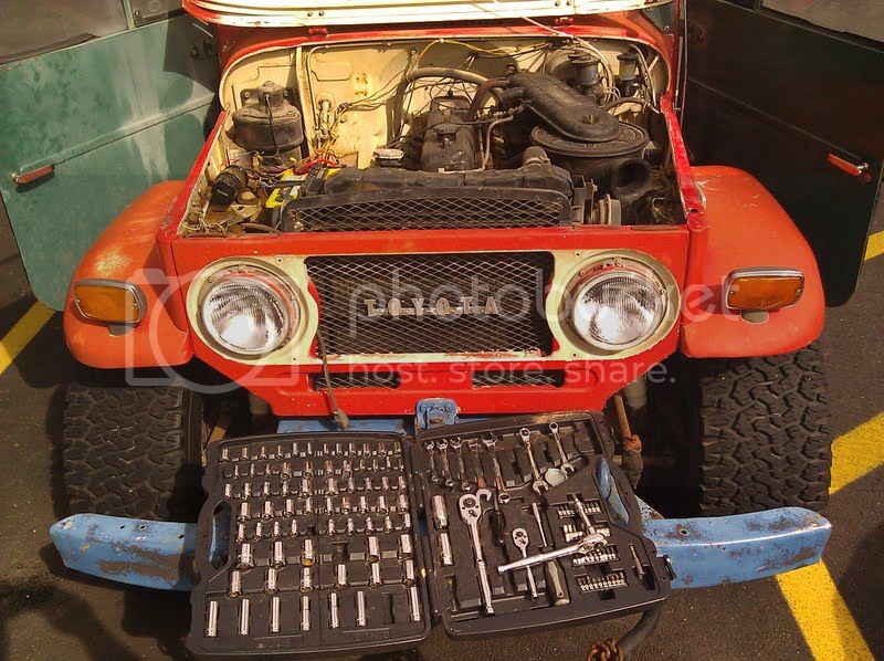

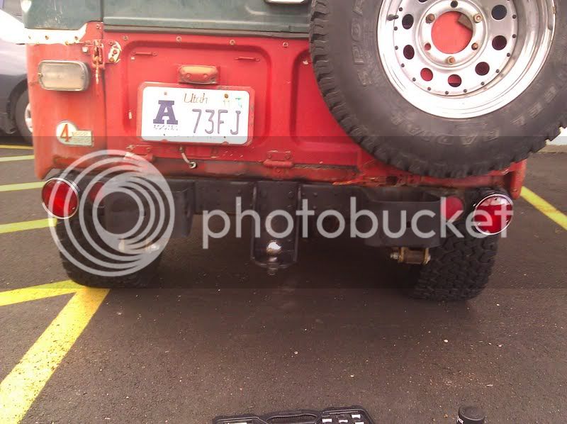

So a $10 dollar flasher replacement turned into a decent
project, But then again thats why we have a 40!!

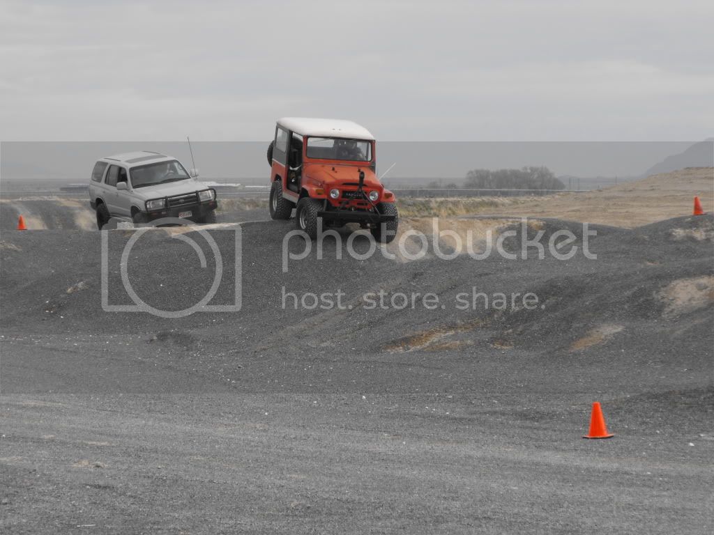

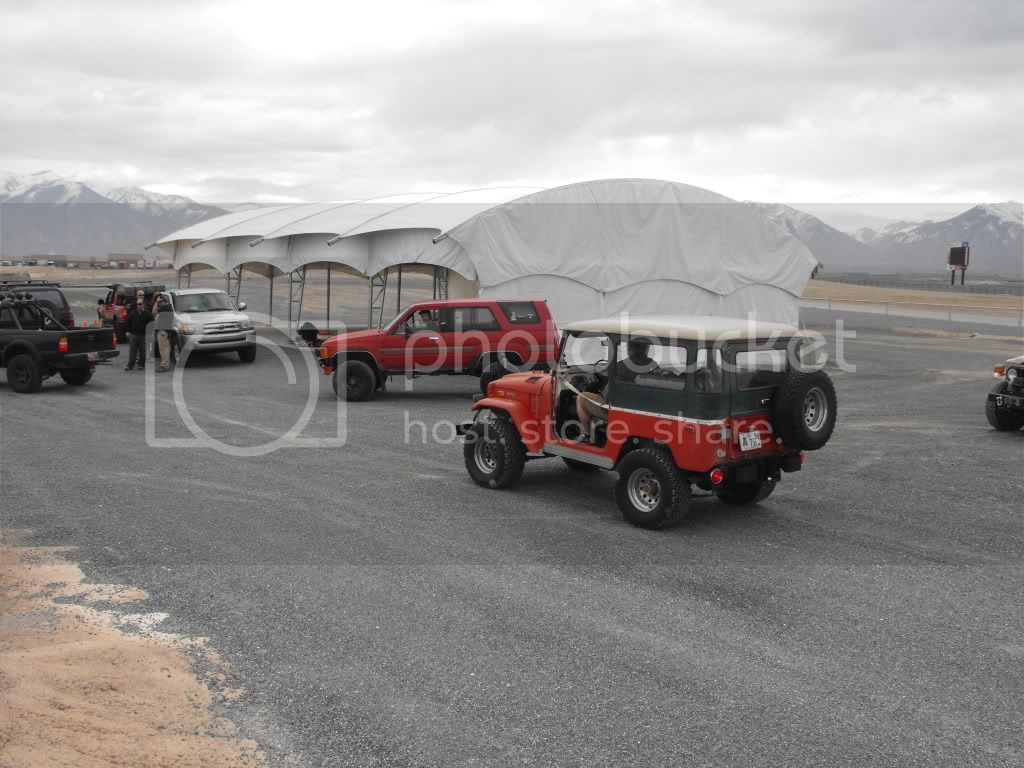

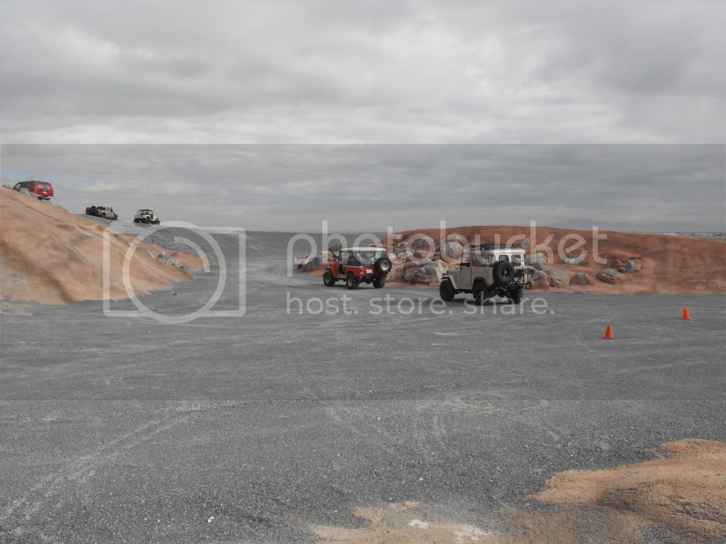

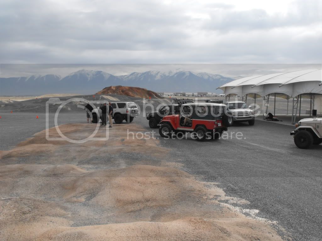

So I thought I'd post some of the pictures and Carnage that was had. We have a place called Miller Motorsports Park in Utah. They have ton's there from midget racing to drifting courses. I was completely unaware of all that they have out at the park. It was Awesome.
Kurt is one of their Driving Instructors and he and CruiserDave set up a Local Club Run.
Wasatch Cruisers Representing well!
Me with the Coyote
Pops getting Ready
Gang Gets Going
This got a little tricky

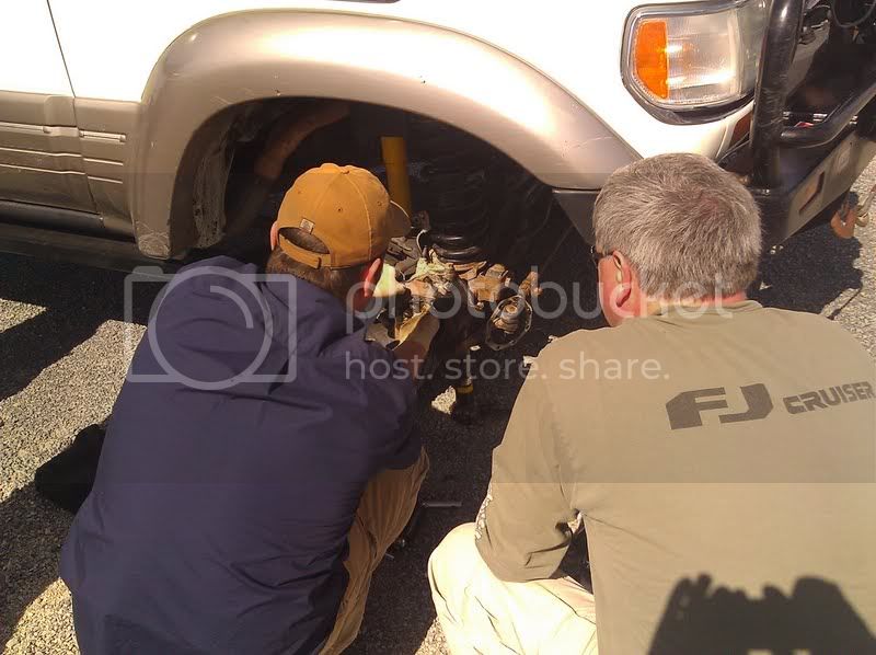

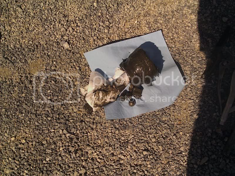

There was a casualty though. Troy's Lexus had some really good runs, but then there was a pop and grinding. This is what had happened
Ever seen the inside of a Birf that is not happy
Good thing there was an overabundance of knowledge on hand. My dad and I were no help so we sat on our ammo can seats and ate lunch.

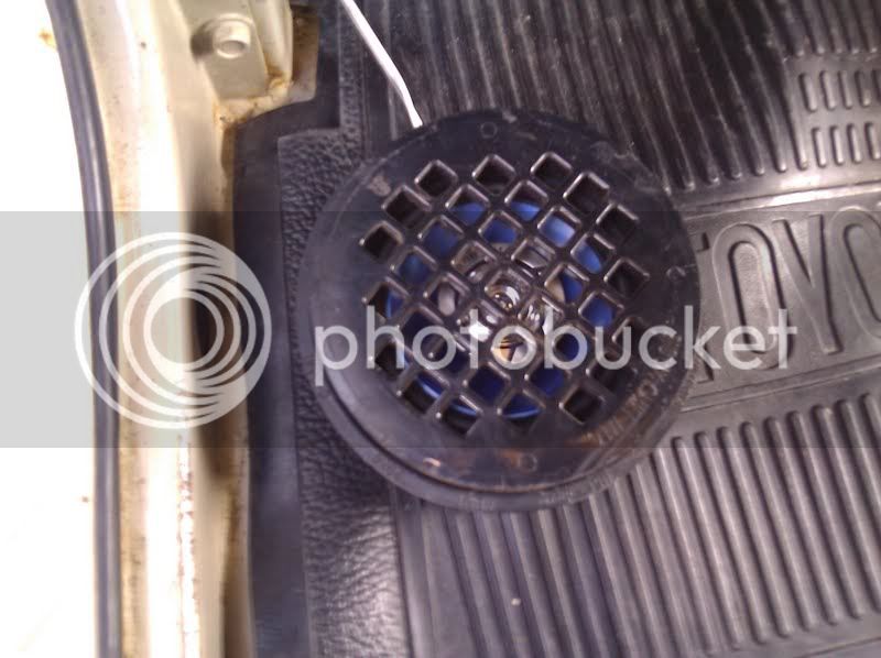

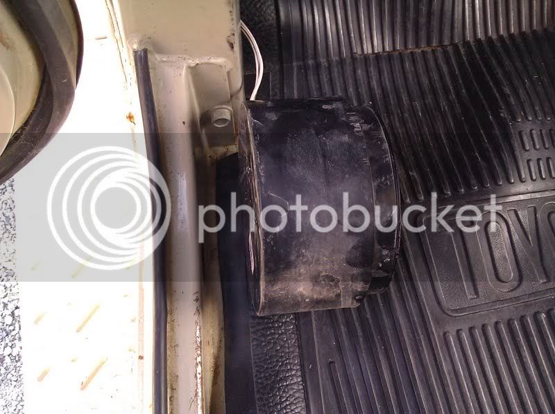

Thanks to everyone for setting this up and coming we had a blast. Dave's Cruiser makes me Jealous. The Tacos flew. Jason I hope to get me a 4runner like yours for everyday. Scott your 40 is inspiring. I know I can get my looking like that soon. Good luck with the new motor and let me know about the pump and bracket. Next week I'll start installing my stereo with the Drain Plug speaker boxes. This is an Idea from Scott in the club. The 4 inch PVC caps are the perfect size for a speaker and they fit in the cavity by the kick vent. Completely out of the way letting the vent still work. They just sit in there and are removable!
