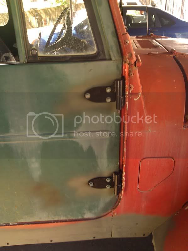

So I finally got an hour to work on my hinges.
I am so excited the install was quick and easy
even with the quirks of my cruiser,
but these are awesom and work great!
Step 1, Get you stuff together.
Order the hinges and I painted them
and set everything out.
I also purchased this stubby wrench
with a ratcheting box end
that was very helpful.
So i opened up as much room as possible.
Undid the battery removed the fuse panel
took the guage cluster out did all i could
to get my mits in there.
Then the only hard part. Getting the four
bolts out. This was made more difficult as
my cruiser had been in a crash and has some
weird pieces of metal and bolts all over.
Anyway about 30 minutes later I got them all out.
Old Stuf that wobbled.
Install was a breez. The hinges bolted up real easy.
I did break one bolt taking off the door
hinge piece:doh:, but the other two came out
fine. I haven't tightened everything down yet as
of course I need to adjust the door so i hits the
catch easy and smooth. But this was a cakewalk
and totally worth getting. They slide in and out
super easy and are a great product.

I never considered removing the gauge cluster to gain access to the top left hinge. Nice work! Where did you get the stubby wrench?
Just went to sears and got it. It cost 11 dollars. If you get an angle adjust head its 22.

You're going to love the hinges, they are stronger, better design, quick and easy to take off or change out your doors, no more messing with the windshield. I have been using a set for a few months now and they have saved me so much time when I switch between my full doors and tube doors. Looking forward to seeing more quality products from MC Offroad Designs. :cheers:

Finally GOt Time
So I finally got thirty minutes to work on the Toy and
I put the hinges on the passenger side. This was awesome
because this side wasn't bent up from the roll
over a few years ago.
This side went in much easier. and took all of maybe 15 minutes.
Slid right in.Almost don't need weather stripping
as it adjusted up so great.

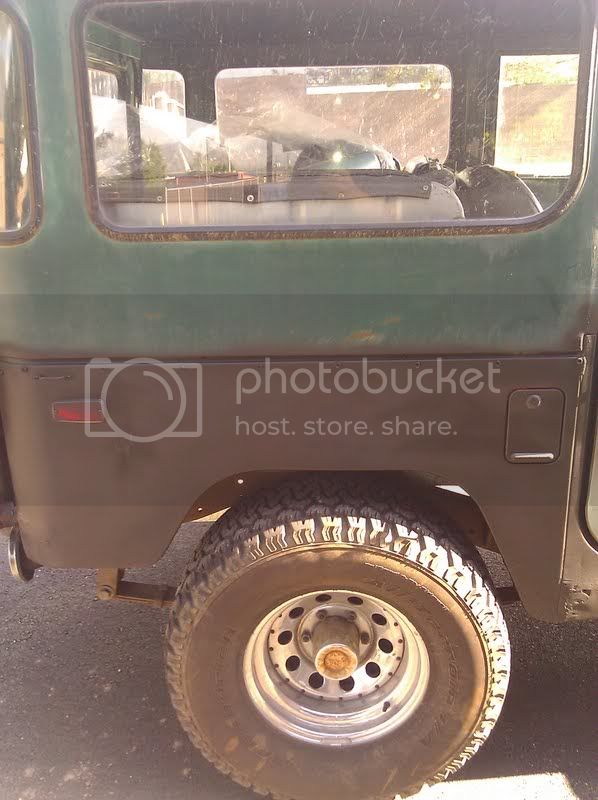

Then I got a little crazy and scuffed up the rear quarter
panel to see what it would look like black. I think this
is what I'm gonna do. Black on bottom rhinolined and
then green on top.
Thanks Matt this looks great.
