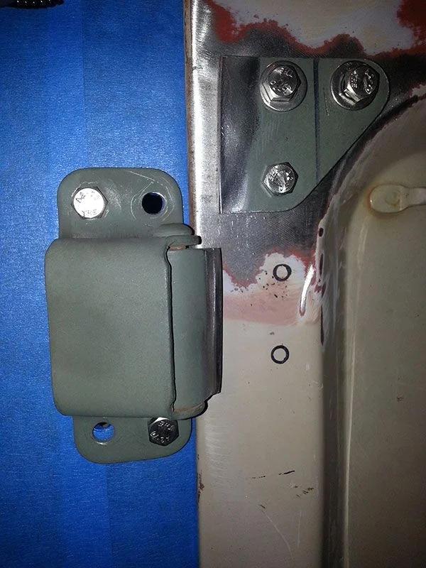

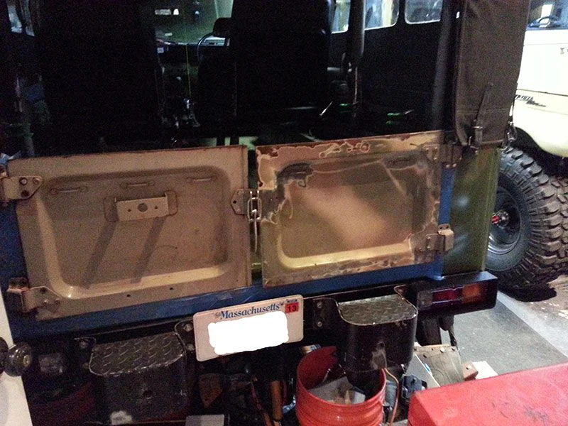

Barn doors are on. Thanks KY Longhunter. These took some work to fit the late model tub. Added an inch of steel on the right door to take up the gap, added an inch to the curved door catch, cut and welded the top hinge to fit the stock door holes, rather than drilling into the tub.

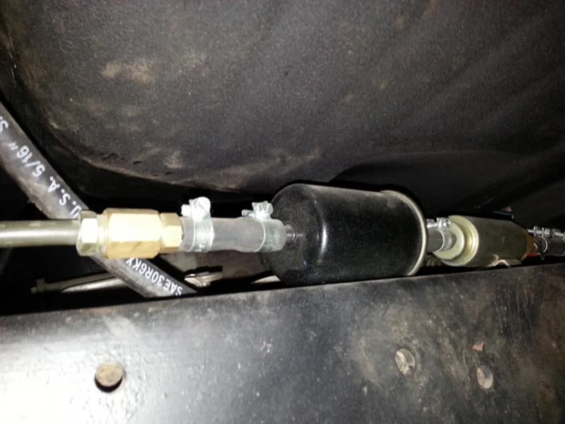

I have a fuel cavitation issue that I'm trying solve and would appreciate your input. Currently running an e2000 external pump, Howell pressure regulator with return line to the tank, with the oem tank. The pump is located on top of the frame rail and sits a few inches higher than the bottom of the tank.
Talked to Howell FI and they recommended an in-tank fuel pump w/ fuel cell. I thought that the regulator might be part of the problem but Howell and Aeromotive said that there's no way it's the regulator. They explained that the external pump is having to "pull" fuel too much which is overheating the pump and when combined with warm fuel, cavitation happens. They also recommended their Phantom $ystem specifically designed for nearly any oem tank.

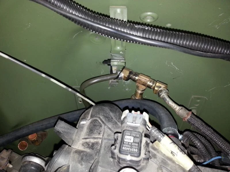

I've wrapped the headers in DEI wrap, covered the fuel lines in heat suppression wrap (not in pics), and have the pressure regulator covered as well, trying to reduce under hood temps.
Pics: 1=brass Howell supplied regulator. 2=filter and pump. 3= Phantom system
