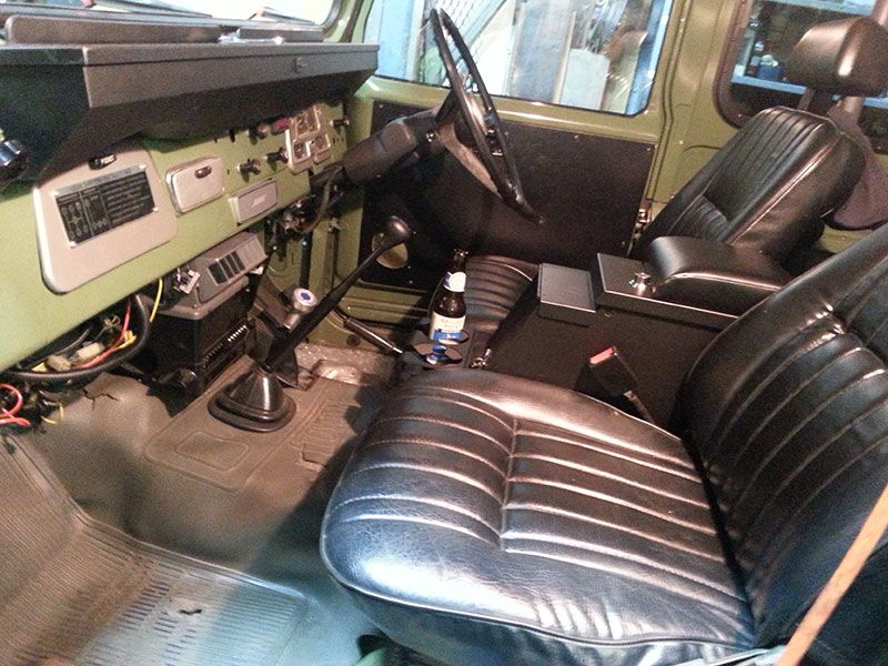

Installed the Tuffy console for the stereo. After many complicated systems over the years, I wasn't looking forward to all the wiring, battery requirement, expense, and the liability of nice equipment in an open topped rig. I've been trying to come up with a simplified stereo using a headless system run from a phone, which would at least eliminate the head unit.
I tried a Bose Mini Soundlink in the dash and it fit...system done! The PO cut the radio slot larger to 7.2" and the Bose is 7.1" long, so that was lucky. Currently looking for some type of stick-on plastic to cover the metal edges of the radio slot opening. Let me know if you know of anything that would work there.
Thanks Nick.
Scratch my last post. Can't hear it enough on the highway, so back to the drawing board. Should have seen that coming.

That sure is looking good. What is the max speed she will do?
Might want to take the beer out of the right side cradle before your next drive.
Nice!
Ron - I talked to Restomod Air and they said they are a sister company to Classic Auto Air who makes their units. Curious why you think the Restomod is a better unit than the Old Air Hurricane. I'm considering the Hurricane due to it's small footprint and the fact the TLC uses them. I'm not sure I could fit the Restomod unit in the 47 due to it's size. Have you already installed yours in the 55? I'll check out your thread again. Thanks for the suggestion.
love2fly - Thanks! I've had her up to 75 which is fast enough for me. Could go much faster but I'm not pressing my luck. No driving with beer...that's there for install support.
I bought the Old Air system, first and it's shorter in length than the Restomod, but the width is bigger. I'm using the twin stick shifters for the transfer case and they hit the Old Air. Remember though, I have a 55.
In my opinion, the Restomod unit is just built better. The controls, vents, etc. all are of higher quality.
With yours being a right hand drive, might be problems mounting?
