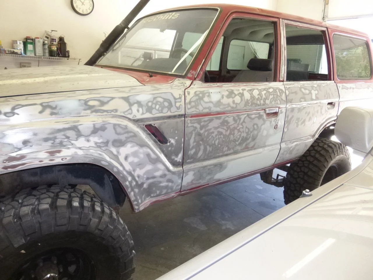

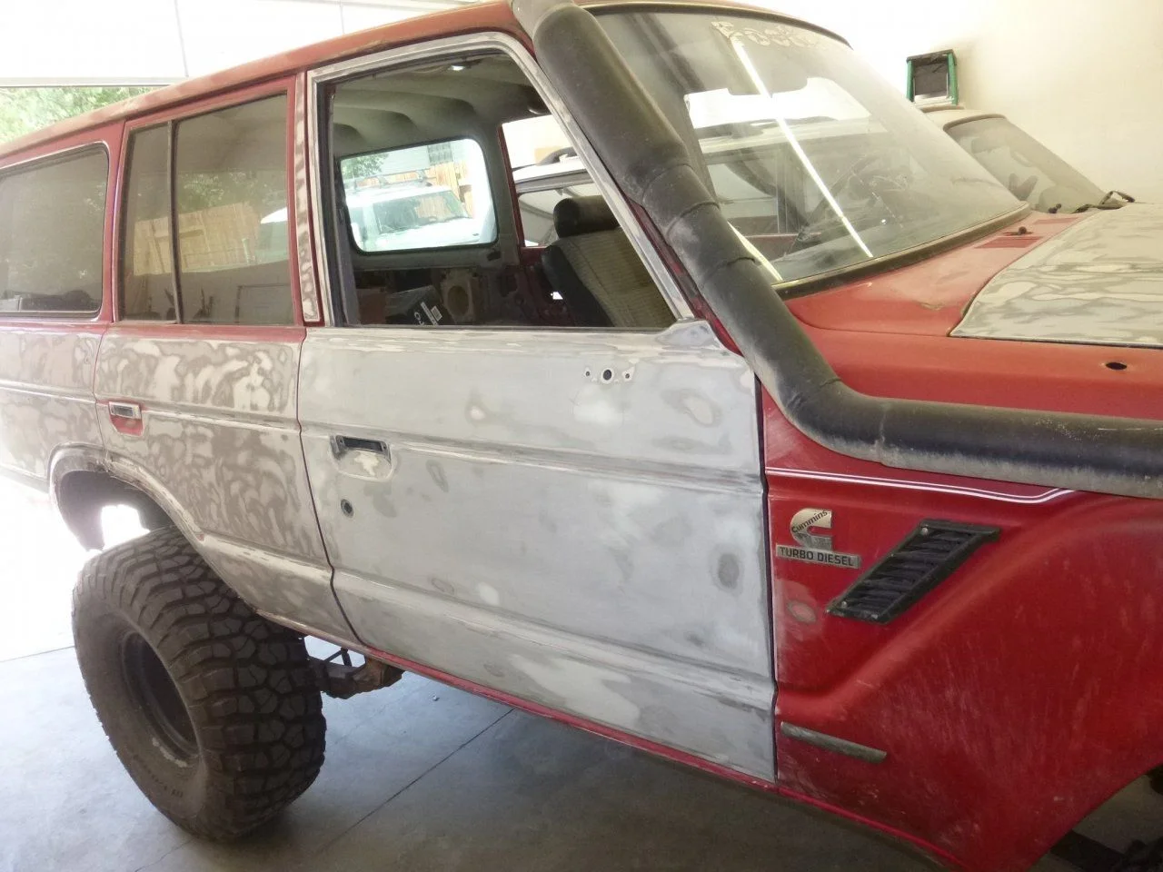

I'm doing body work on Goss today...
J

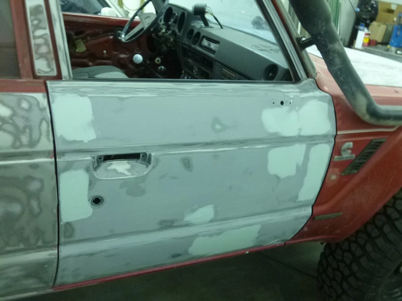

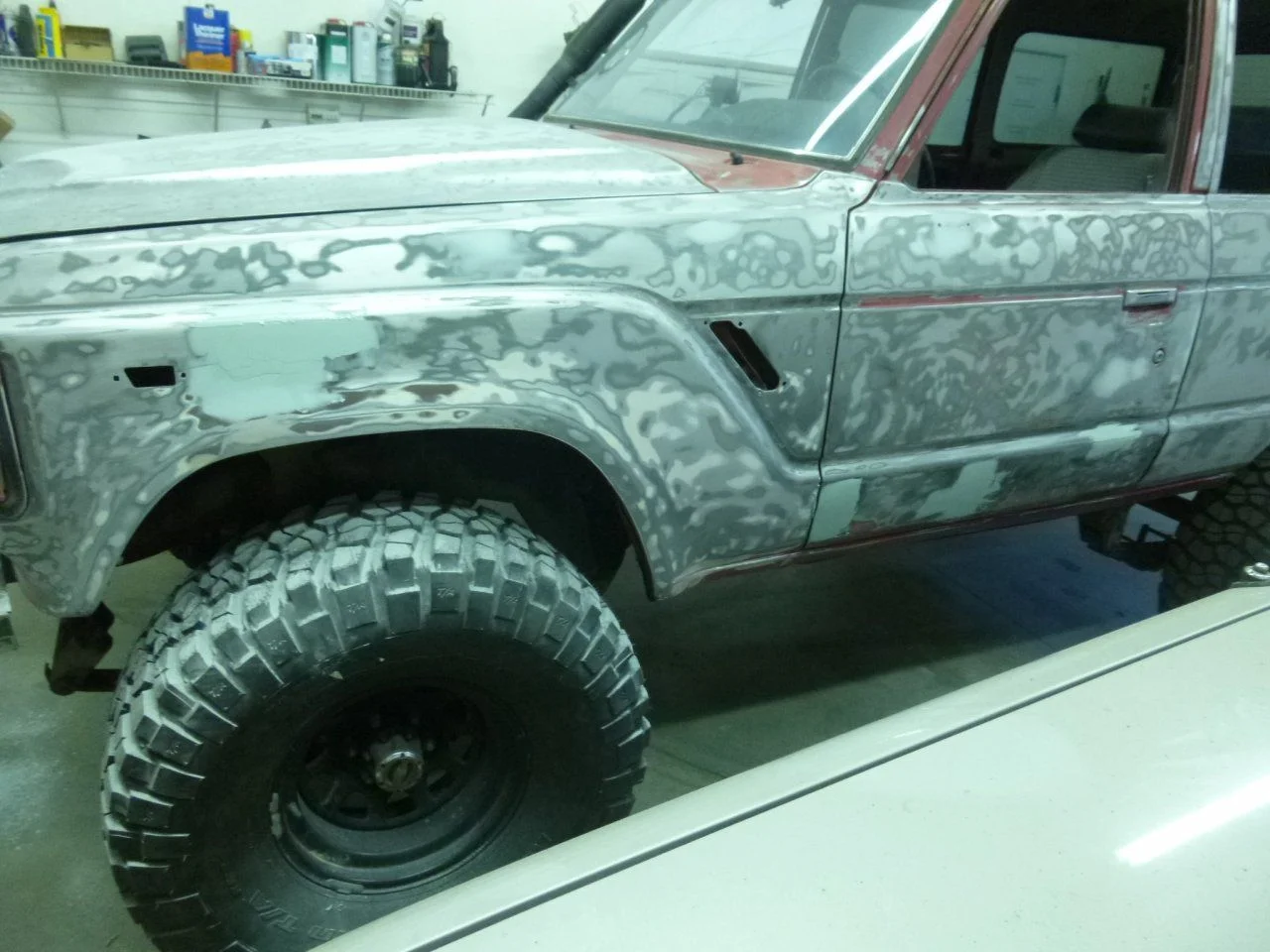

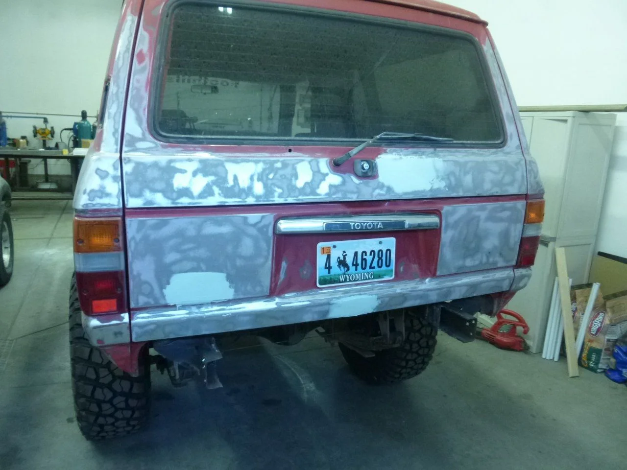

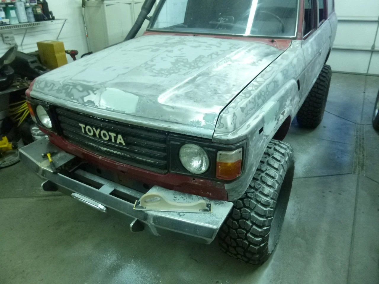

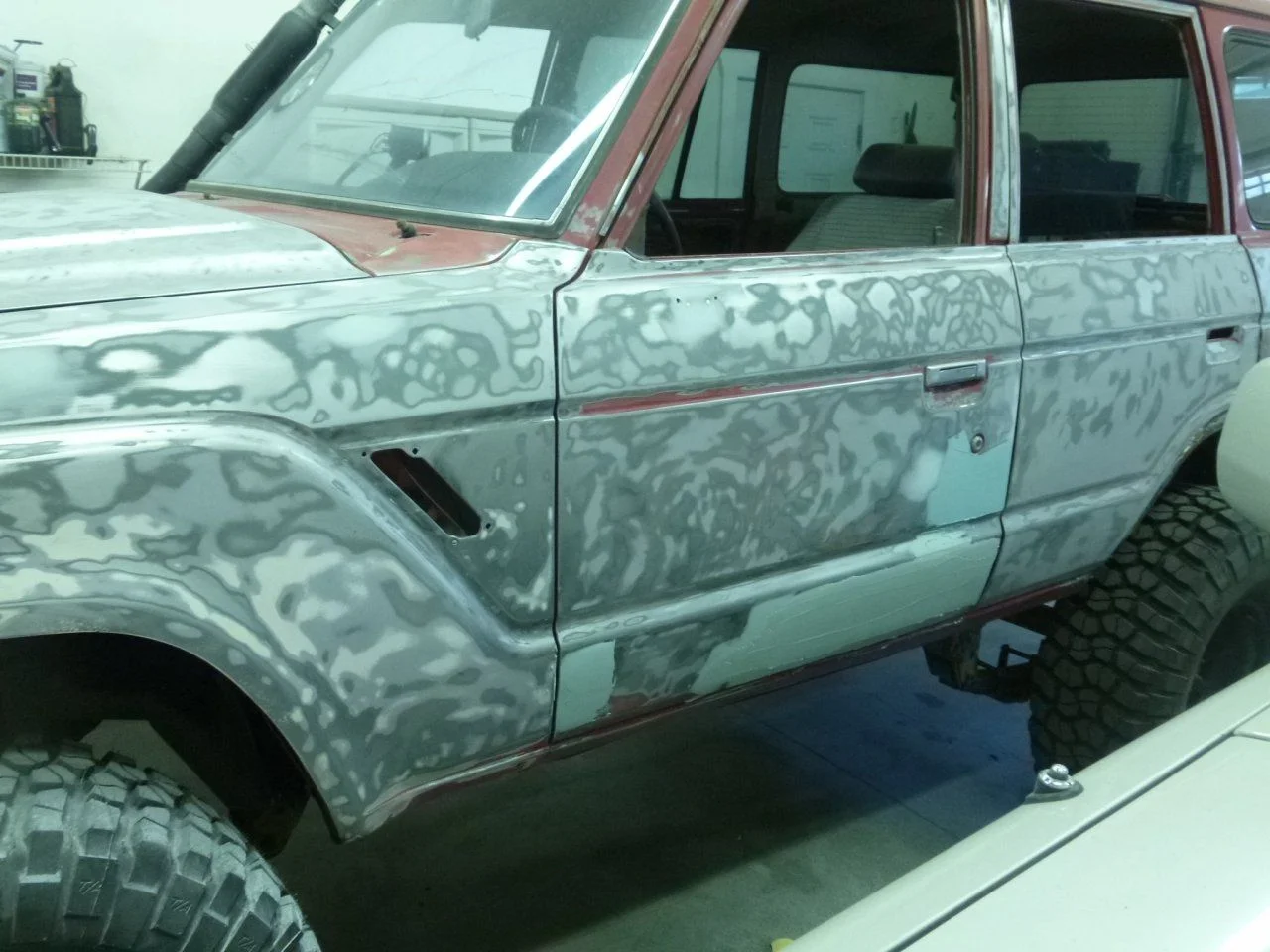

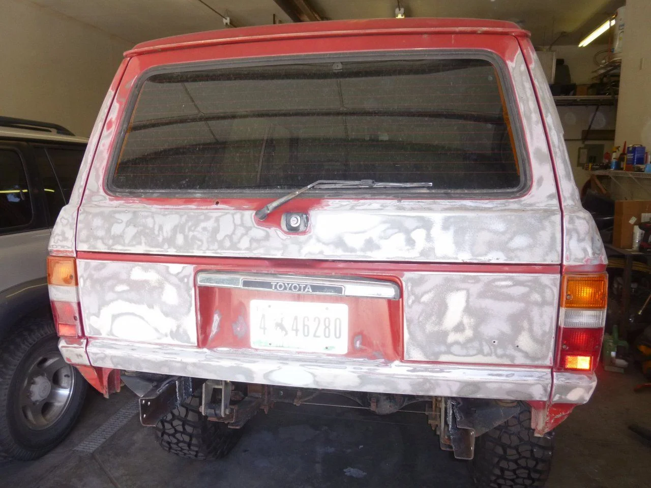

Got started witht he filler today. Eveerything from the rear doors forward and the back gates are ready for primer. Next weekend I'll start on the rust repair on the rear quarters, wheel wells, rockers and inside floor pans...
I'll probably order the Monstaliner kits so they are here on stand-by when I'm ready to go.
