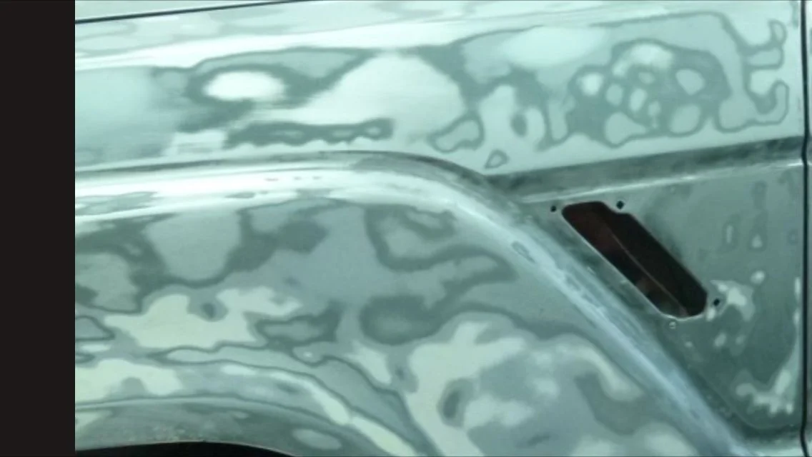

Im liking that morning wood camo lol. Were going with the line right above the door handles for maximum pin striping protection!
This is some ballin' camo right here...

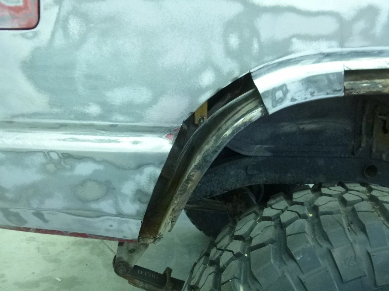

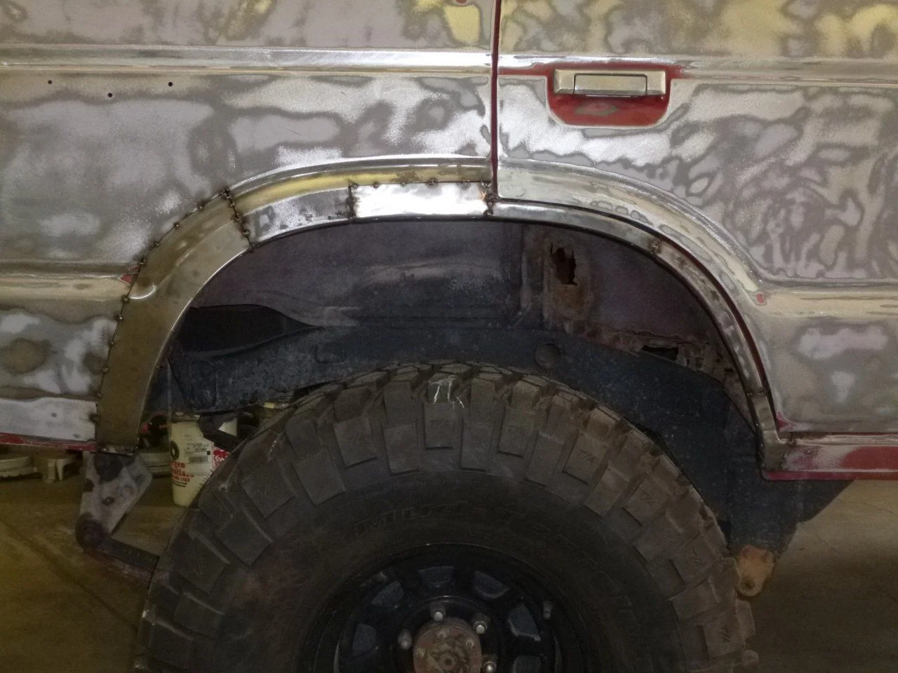

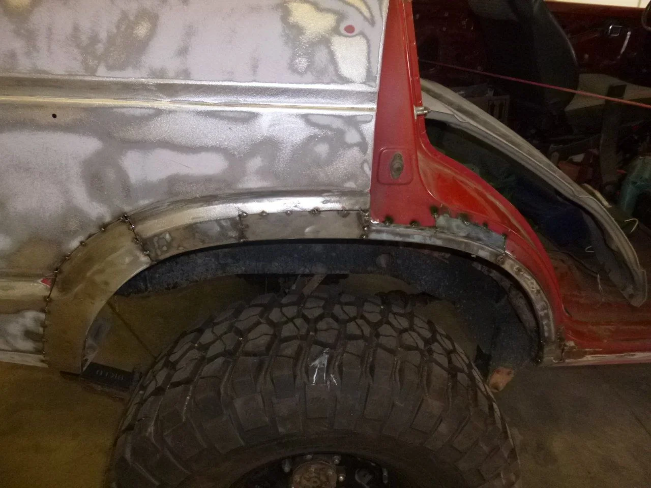

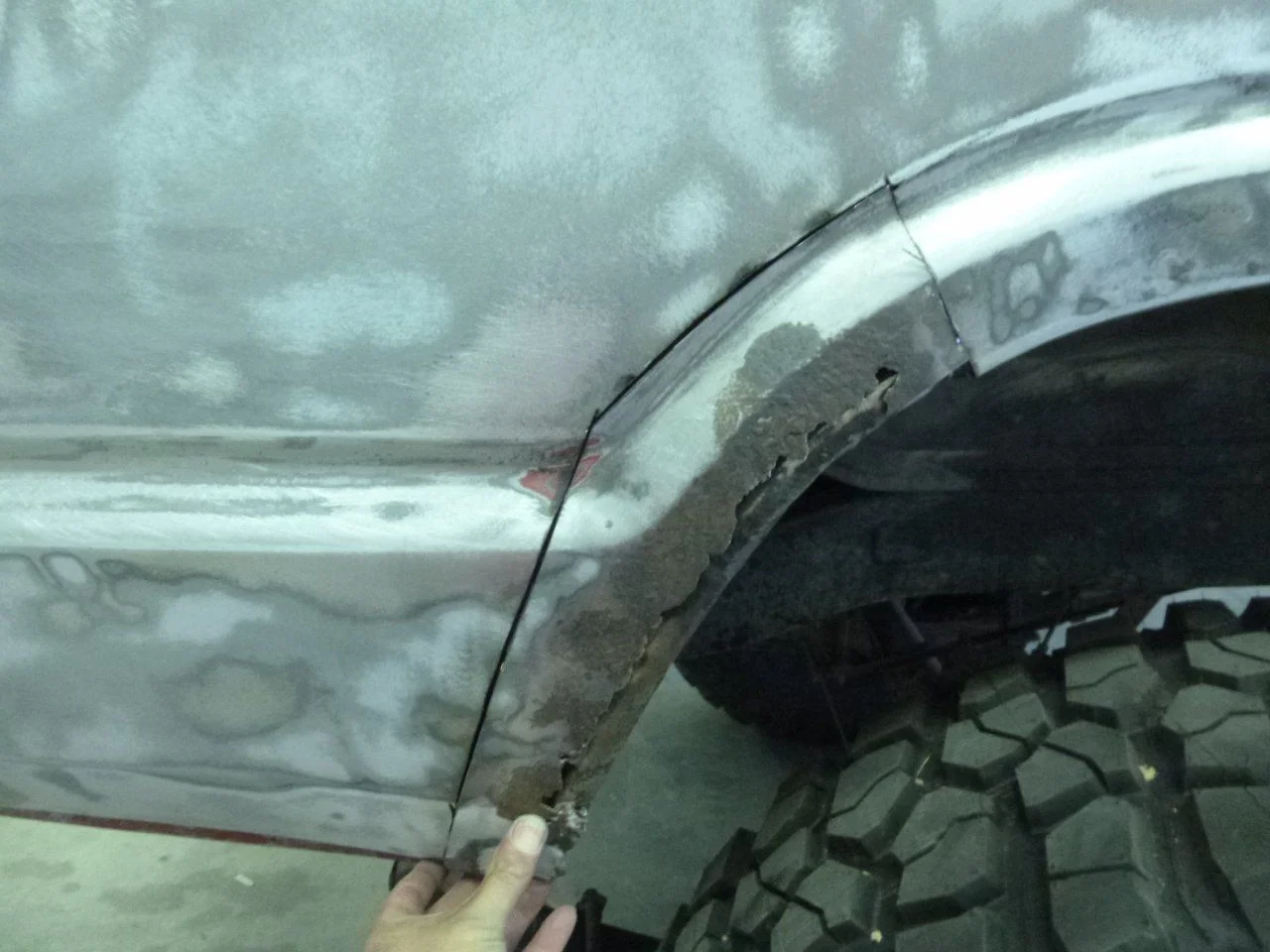

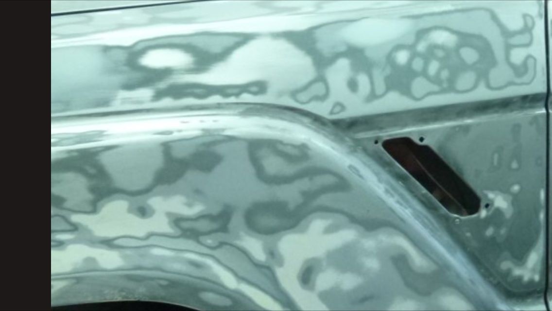

This afternoon I didn't feel like fabricating much.. I started on the PS rust repair on Goss.
Got the quarter, inside/outside dogleg and rocker cut out and patched in. I had .045" wire in the machine so a few spot welds to keep evrything in place until this weekend. I'll changeout wire and finish the PS up and get started on the DS and interior pans.

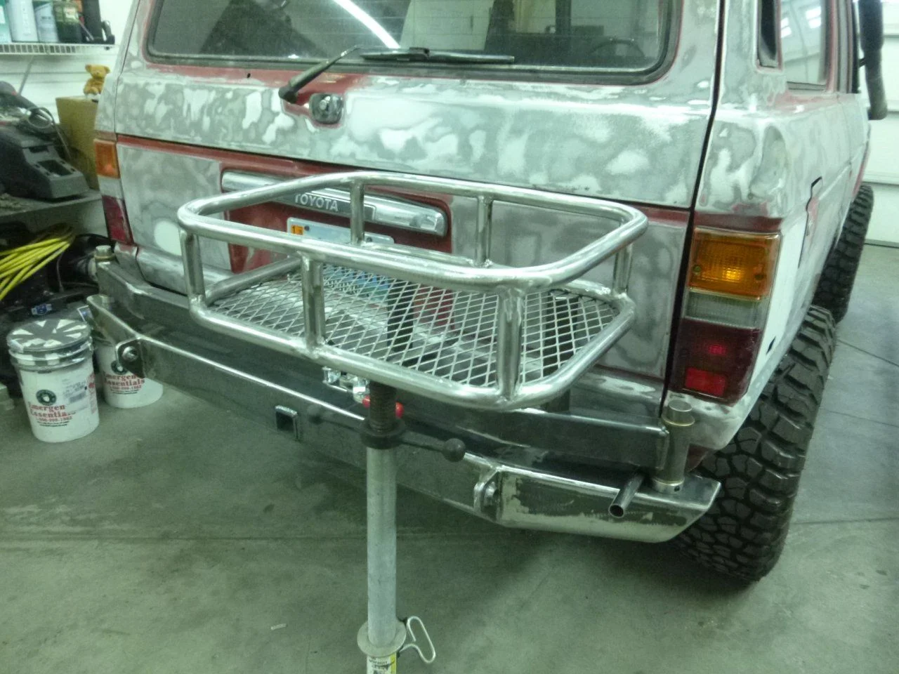

I like how that basket is looking. Are you going to offer the option of quarter panel protection for your rear bumpers?
Very nice derustification. I have a little spot right above my tailpipe that i want to take cut out and repair like that!
And the basket looks awesome, very well done!
Yes, after I get done with mine, I plan on doing the next one with 1/4 armor.
Gonna b a real nice bumper J !!!

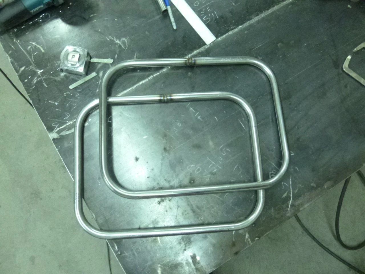

Thanks P, just take your time and measure twice... HA! I love the new bender, took me a few bends to get the geometry figures right..

I'm still about +/- 3/8" off... Need to go back to SKOOL and figure it out.. HA!
J
Better than me, mind you i have not done much with it YET, but…….
Start with the "cheaper" tubing.. It gets expensive quick... thankfully by the 5th bend I had it pretty well figured out.. :slap:
I threw the JD Squared "directions/how to measure" away, too confusing..
