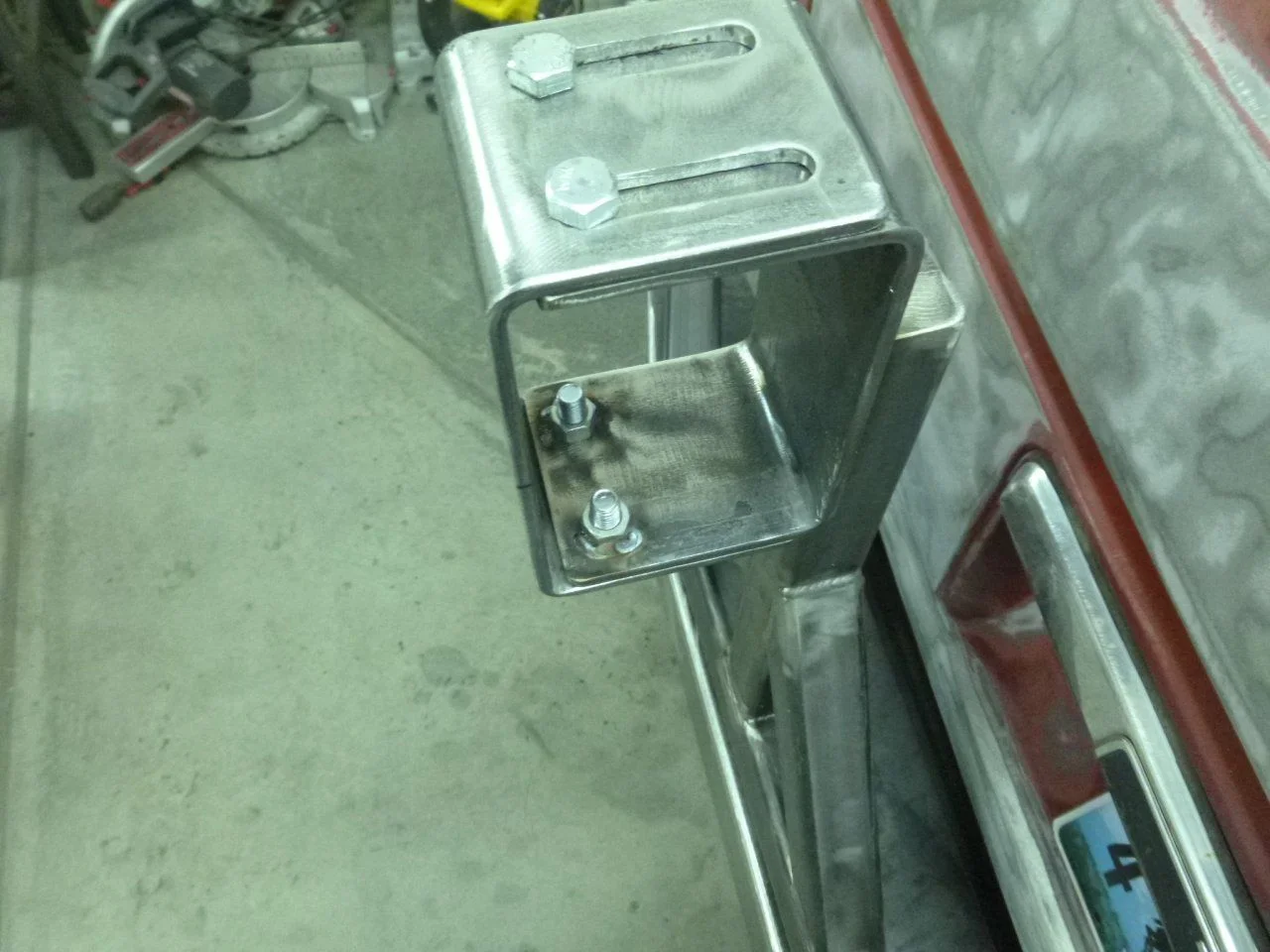

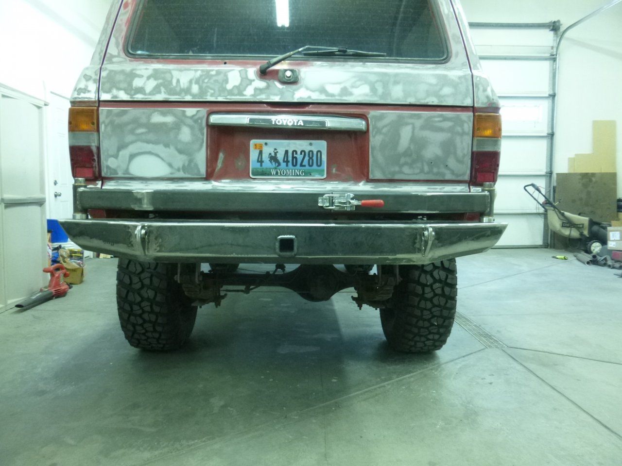

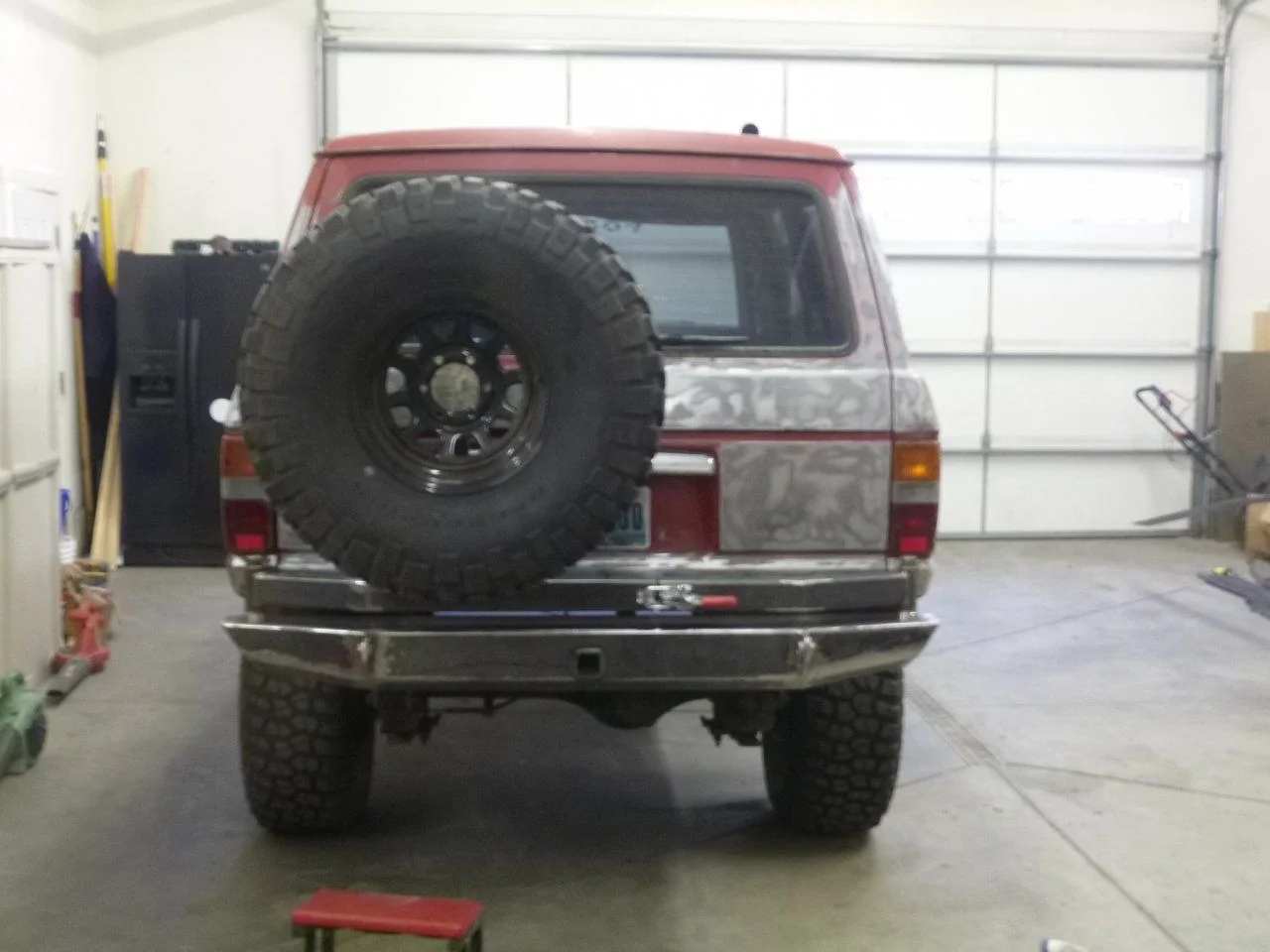

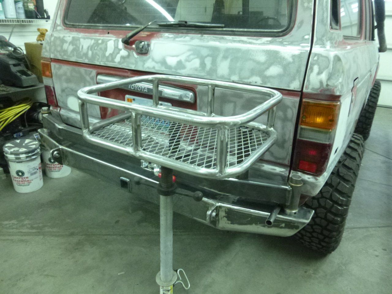

Back to the rear bumper fab. I can see again.... Having your eyes dilated SUCKS!
Finished the tire carrier, swing out stops and the tube is cut for the basket supports. Decided to make an adjustable mount.
Hope to get this completed tomorrow and off to another project.
J

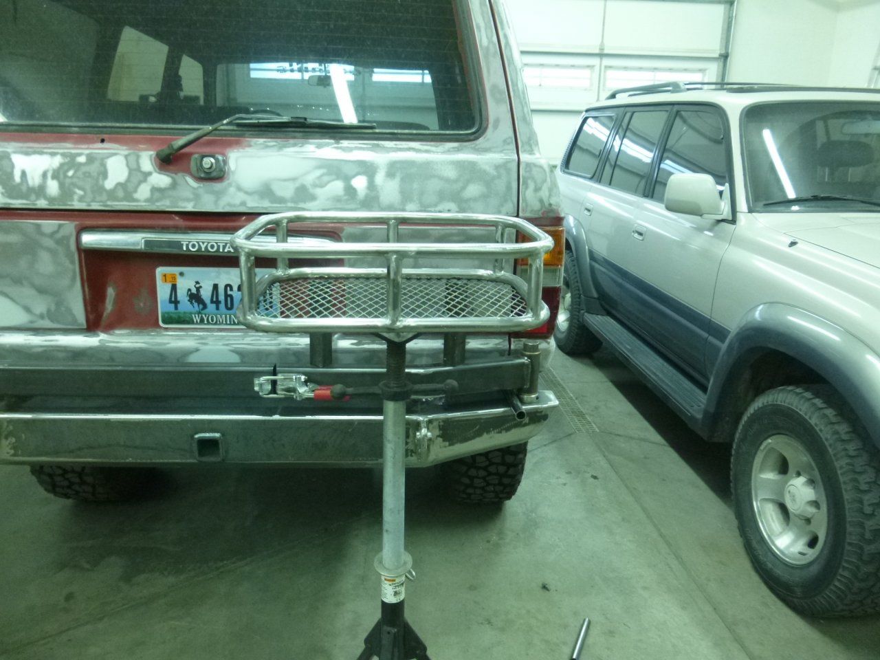

Yep, got a few ideas for the new bumper.. :idea: Tomorrow the 3 jerry can/cooler basket will be done.
