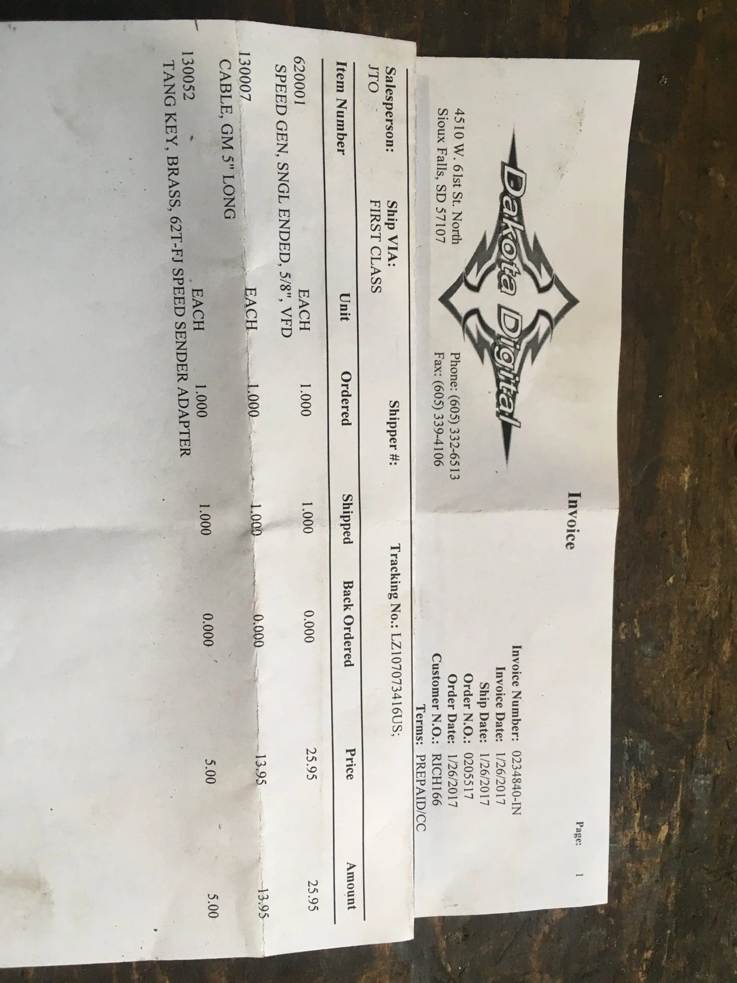

Here is a copy paste from my build thread, it seams pretty relevant:
A little info about the VSS: As you likely know, these gen 3/4 GM engines need a vss even if you are running a manual or a old auto like I am. I guess the ecu needs to know if the vehicle is coming to a stop so it can switch fuel maps, or something like that. If you skip it they say the engine will stumble coming to a stop or leaving. My original plan was to stick a 40 toothreluctor in the tail housing of the th350 but the governor gear made that a pain (there is lots more room in a 4l60e tail housing fyi). Then I was going to build a mount to mount the same 40 toothreluctor on the back of the T case wherethe trans out put comes through the Tcaseon all cruiser T cases. But given this is asplit case that shaft is a little shorter thanthe older T cases so that became a paintoo. I settled on the simplest solution of all, although it was hard to find. Dakota Digital makes an 8k pulse generator that goes into a gm speedo coupler, and an adaptor to make it go into a toyota speed cable coupler. I just needed to get my ecu reflashed to know the new 8k pulses per mile rather than the 128k pluses per mile the 40 tooth reluctor ring gives off. The guy doing the tuning said this will work fine given I’m not attempting to shift an electronic 4l60e, just manage the idle. I searched the net a lot on this topic, it seams the combo of lq4 LS, TH350 andsplit case is not that common, hopefully this works and anyone looking for info on this type of set up in the future will find this when they are searching.
