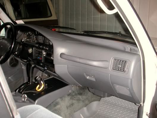

I got my bar and nuts in my hands :grinpimp:
I won't get a chance to mount it before xmas though, as I'll be flying home.
One thing I did notice, on the pre-95 bars, it does not have the little metal tab like the 95+'s have. Also there is no arrow to show up or down. I don't remember this being mentioned before, so for us guys without airbags, it should be a tad easier to mount.

Got mine too -
Just wanted to say thanks Mot! Apparently the early dash is quite a bit easier than the later since you don't have to remove the air duct - had mine installed in half an hour. The bar is side neutral, which was my biggest concern, so it can be flipped and installed on either side ....
:cheers:
Tucker
'94 and earlier is quick and easy. A small screw driver to poke a hole in the dash from the back, a razor blade, 1/4" ratchet and 10mm socket + 20min = grab bar installed. Like Tucker, I was glad to see the bar was symmetric top/bottom so it can be flipped without issue.
