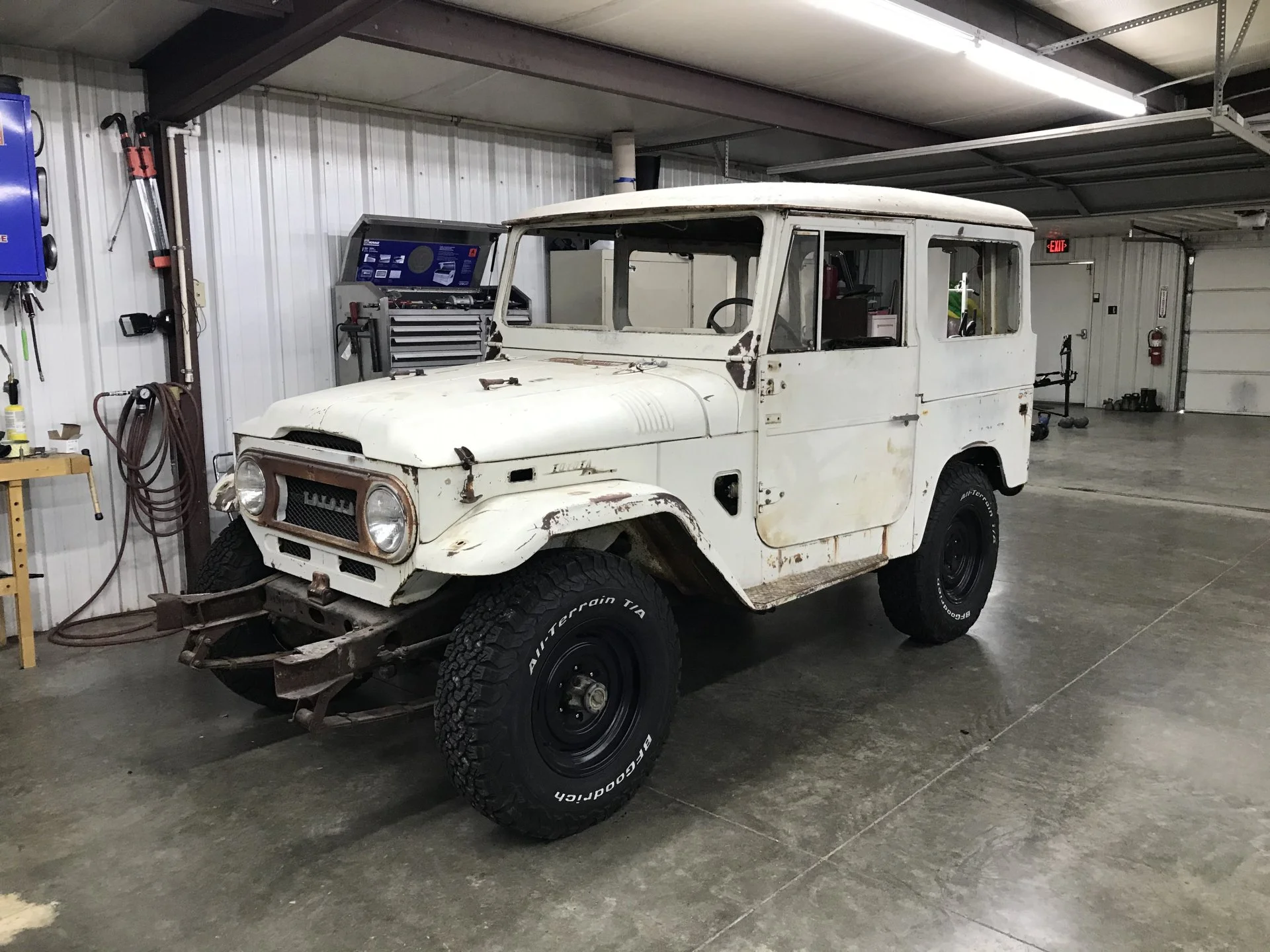

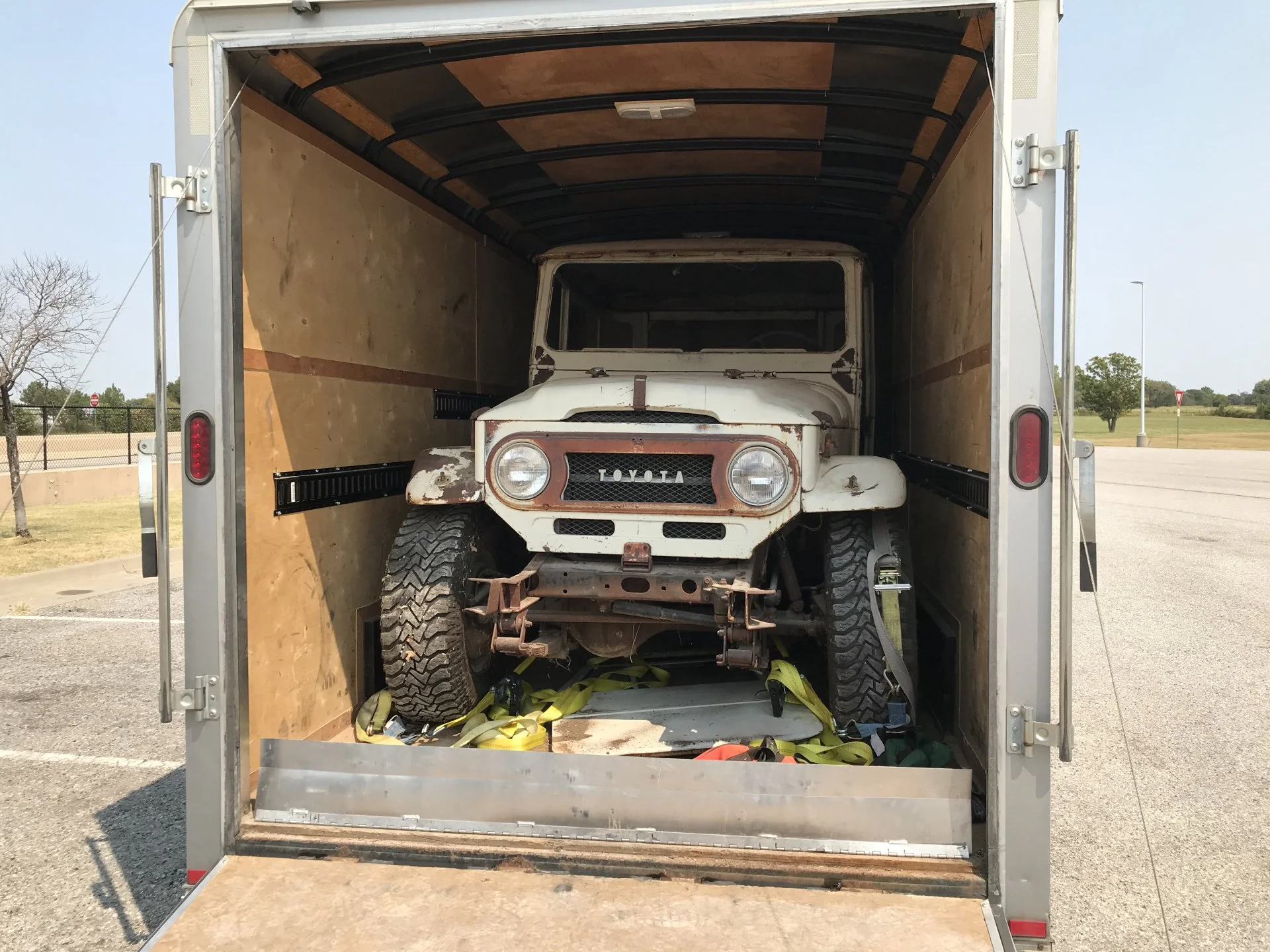

Hello all! I've been lurking here for awhile gathering information and decided I'd finally make an account. Earlier this year my father and I drove out to Oklahoma to pick up a 1971 FJ40 that wasn't completely rusted out. Living in the rust belt has made us wary of anything local.
Still a little rusty but not nearly as bad as some we've seen. The 1F is seized up so I'm planning on doing an engine swap.

Wow it looks great! Great looking patina. Preserving the rust and paint is also an option too, there is a thread on rust preservation here:
It’s your truck, not mine so do what you want with it, but in my opinion, it looks absolutely amazing the way it is, especially the bezel.
Thanks! I do agree, I also love a 40 with patina. Unfortunately my passenger side rocker is pretty much gone so I feel a really clean steel replacement panel might clash haha
I'll probably order a new bezel and hang this one on the wall since it's so solid.

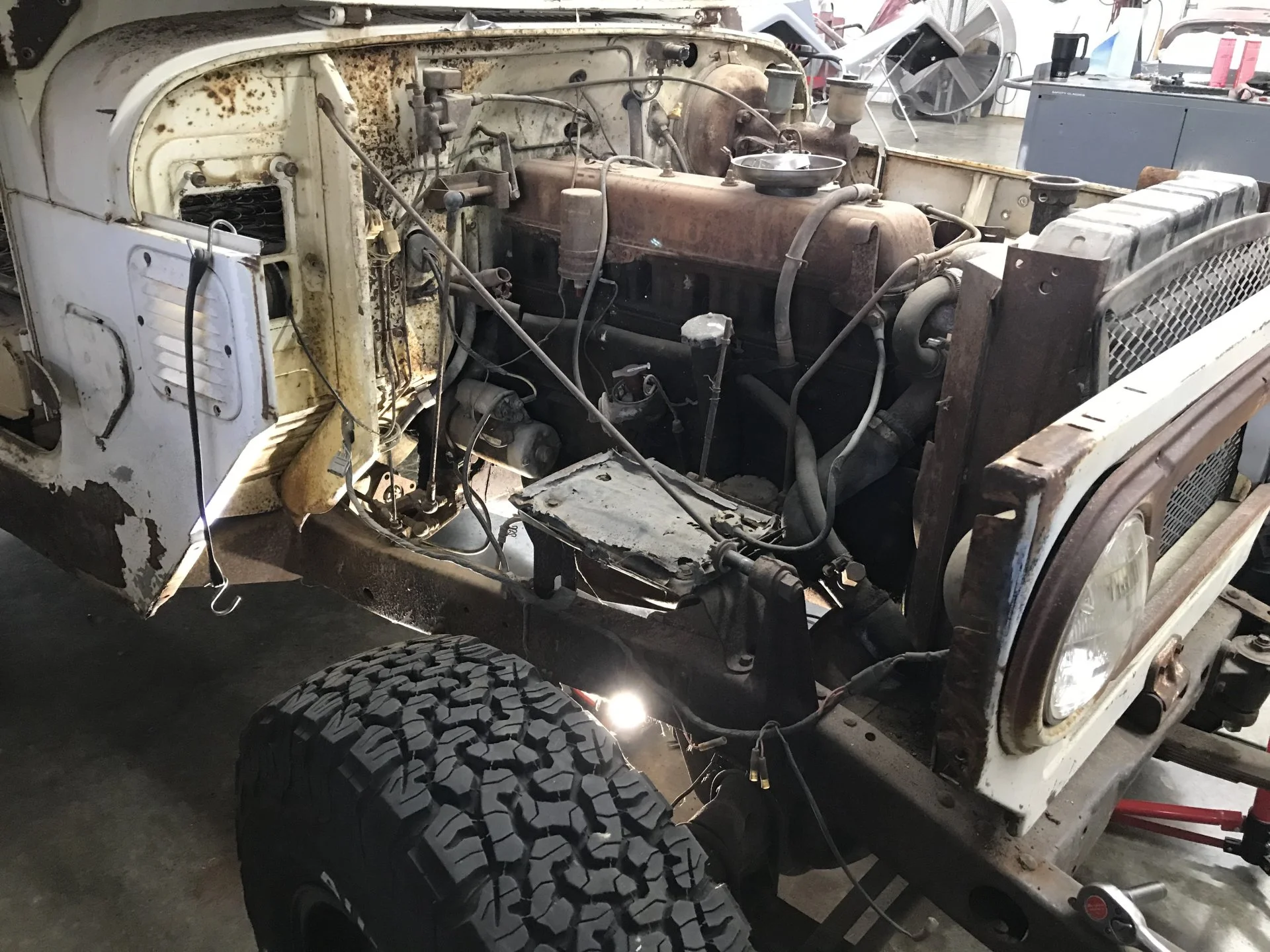

Looks nice. My first 40 series was seized when I got it. Pulled the plugs and squirted ATF on all the cylinders then let it sit for a few days. After that it rolled over by hand. Put a new battery in it, rebuilt the carb and replaced the fuel and all fluids. Drove it like that for many years.
That's awesome! These I6s are built pretty darn tough!

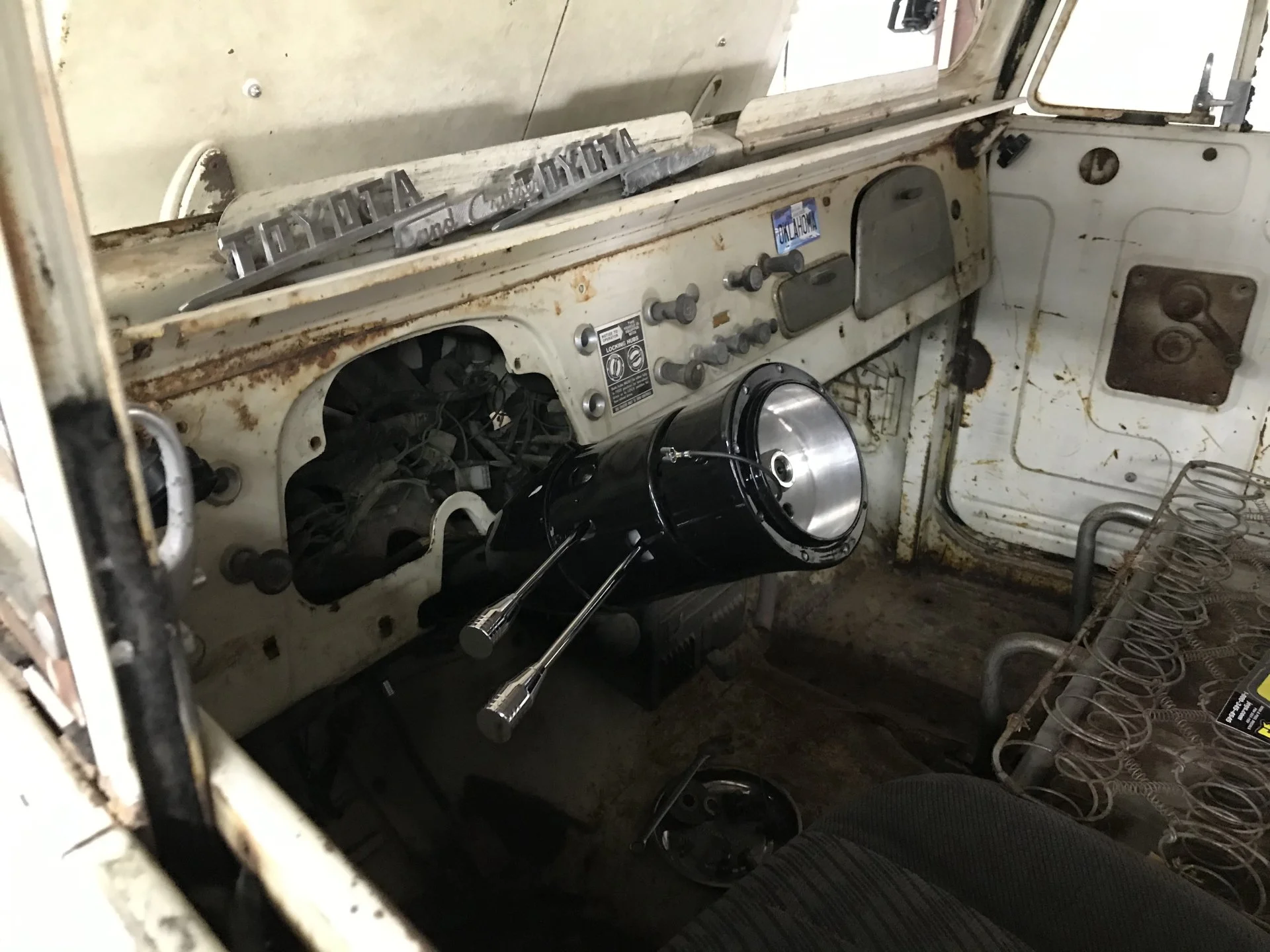

Got the steering column mocked up. I'm using a JEGS column shift steering column with a Heep steering wheel. Used a teq horn button insert from ReefMonkey to try and make it look a little less Heep-y lol
View attachment 2851065 View attachment 2851066

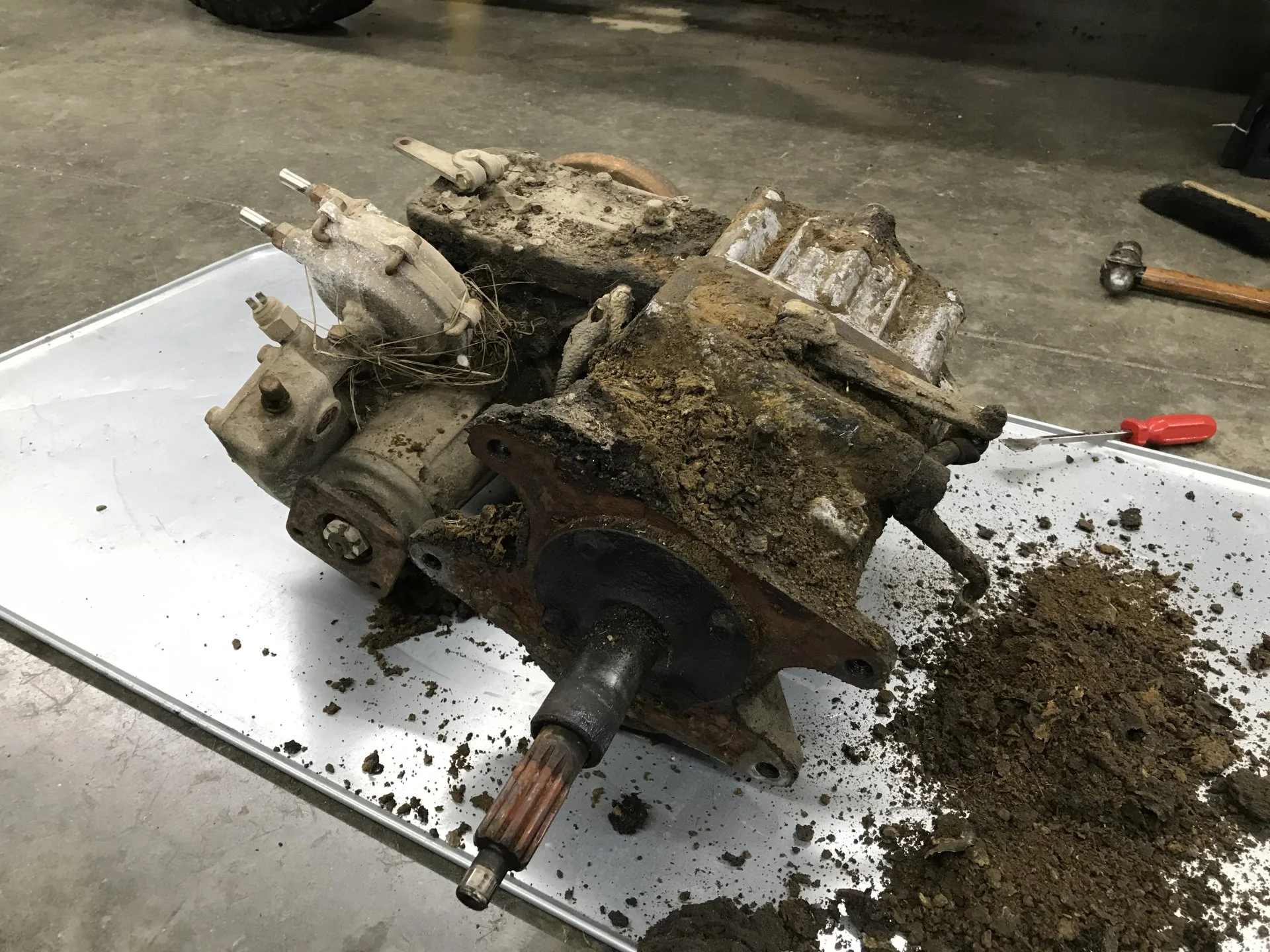

Also unearthed the transmission and transfer case. Darn thing was absolutely caked in mud.

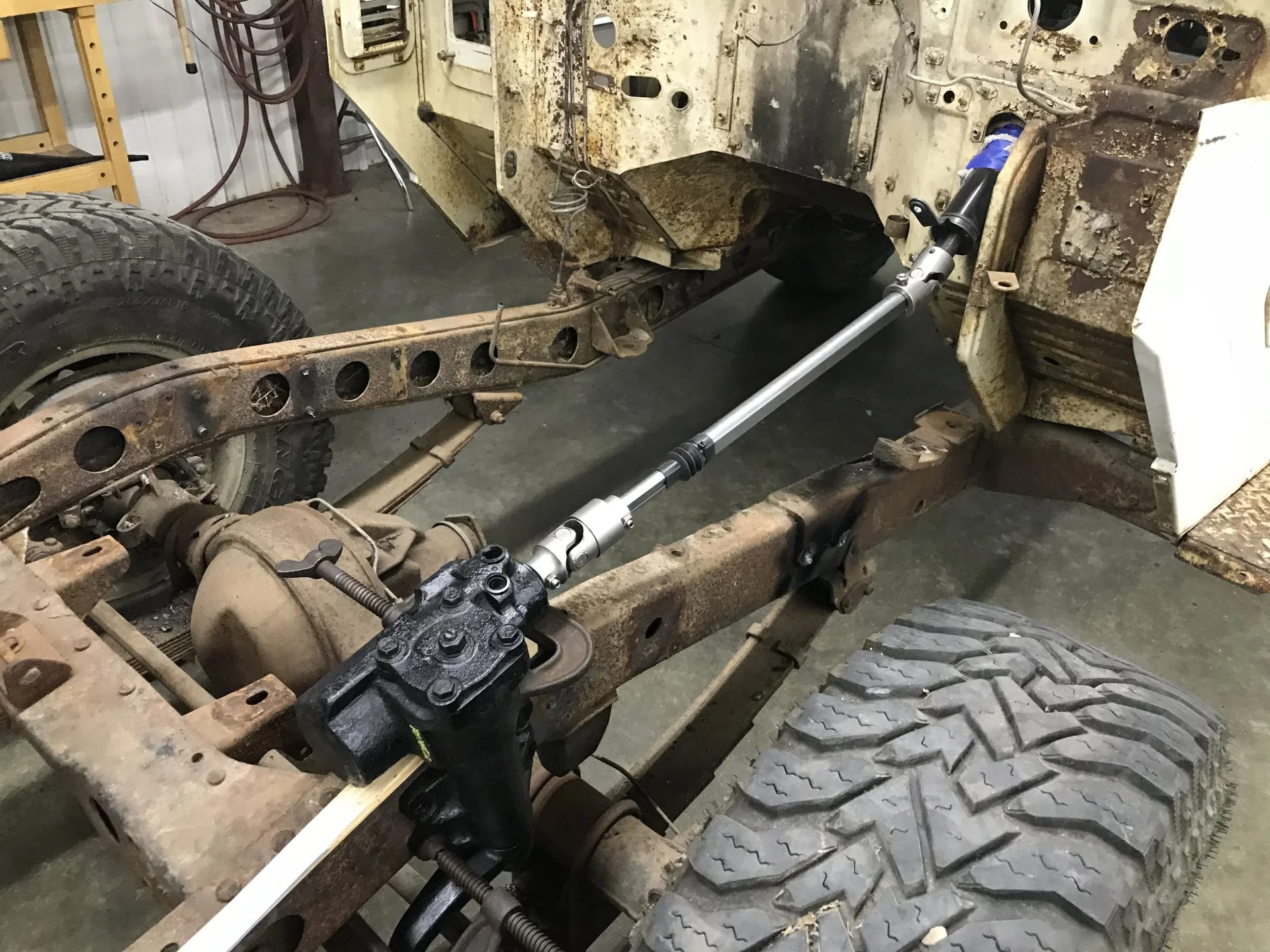

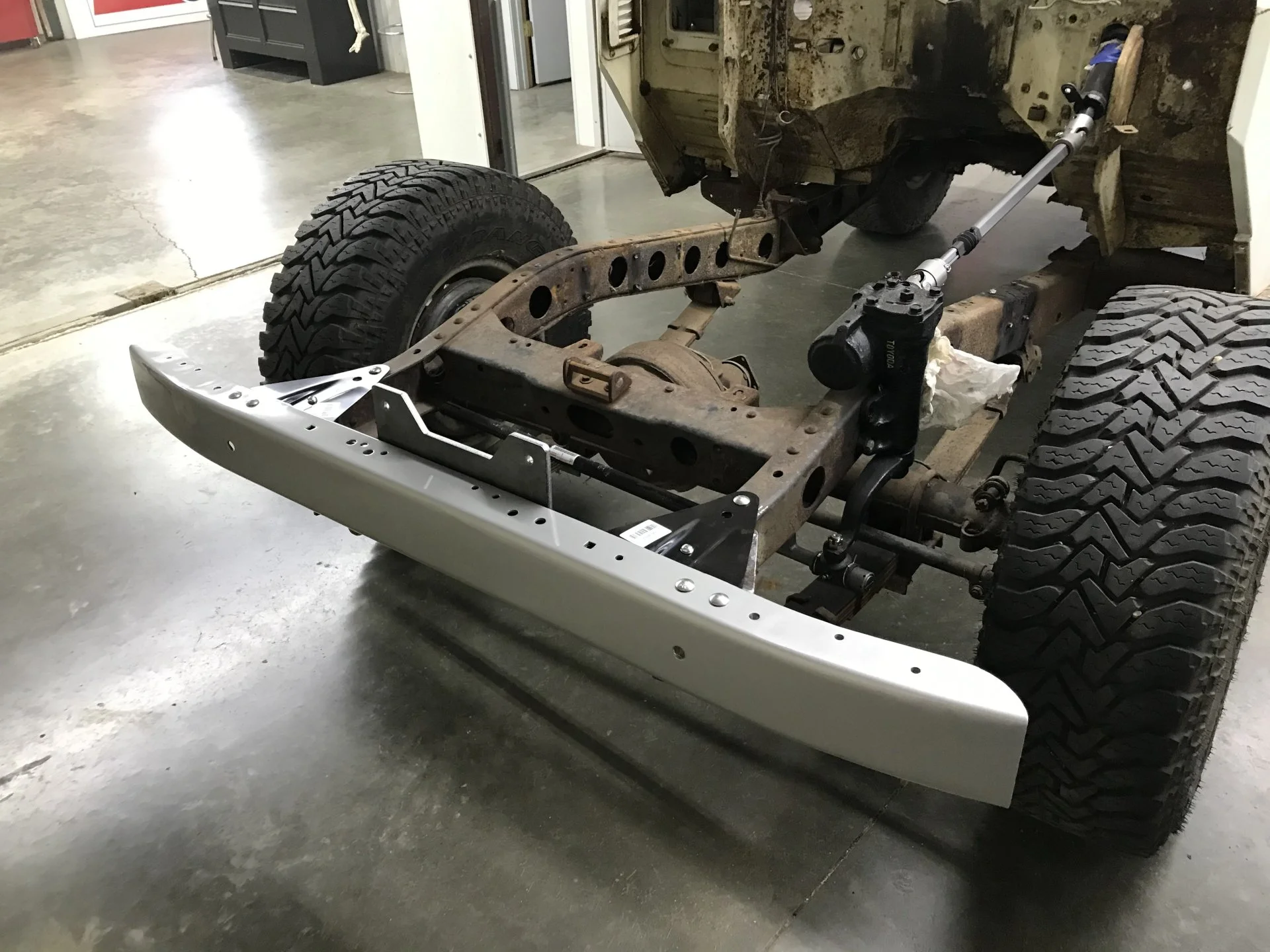

It's been a busy weekend in the shop. Got the whole front clip off and the engine removed. Chopped the shock towers to make way for some F250 shock towers. Also got the FJ60 box mocked up. Waiting on more parts to get the steering setup finished.

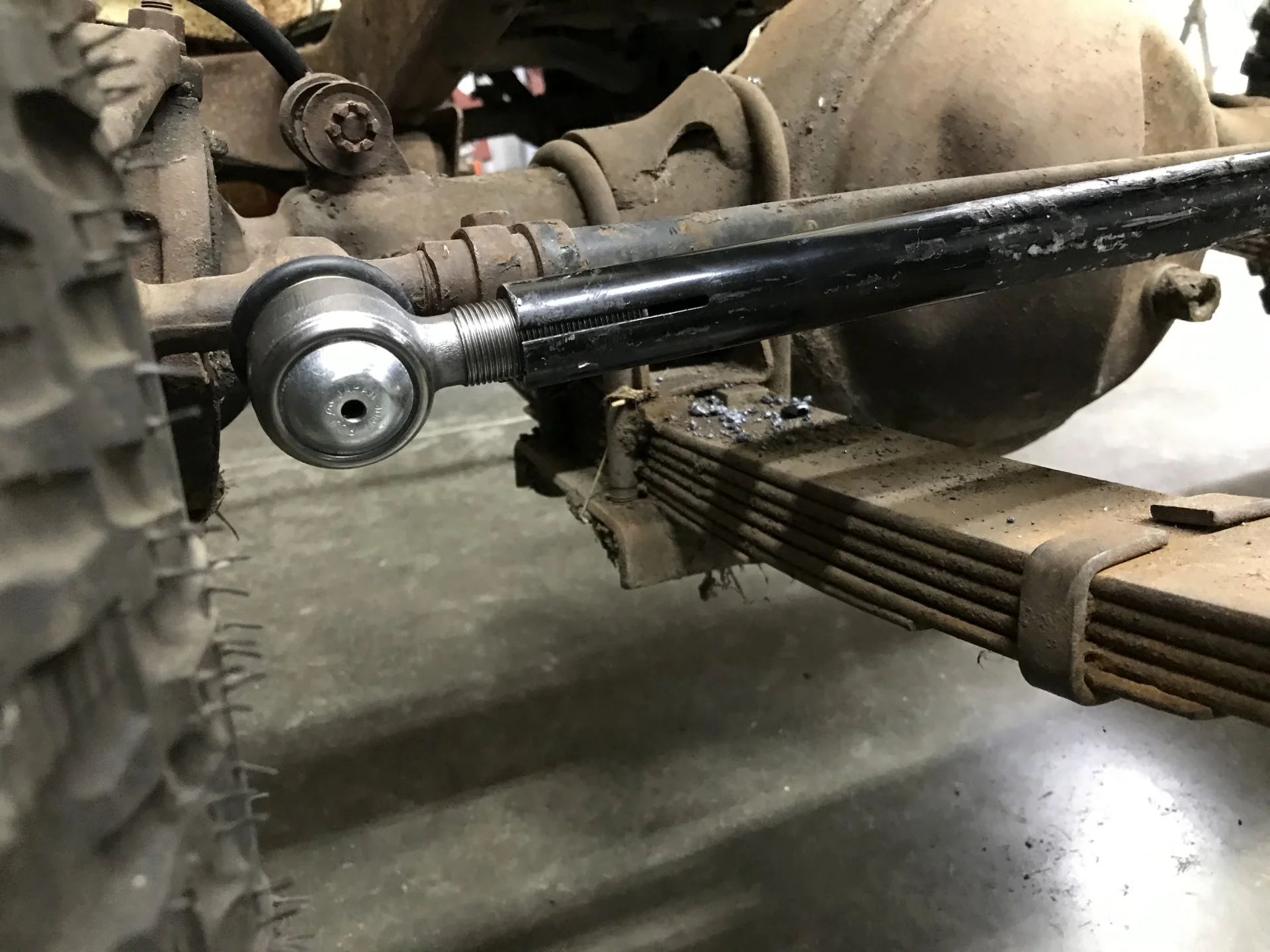

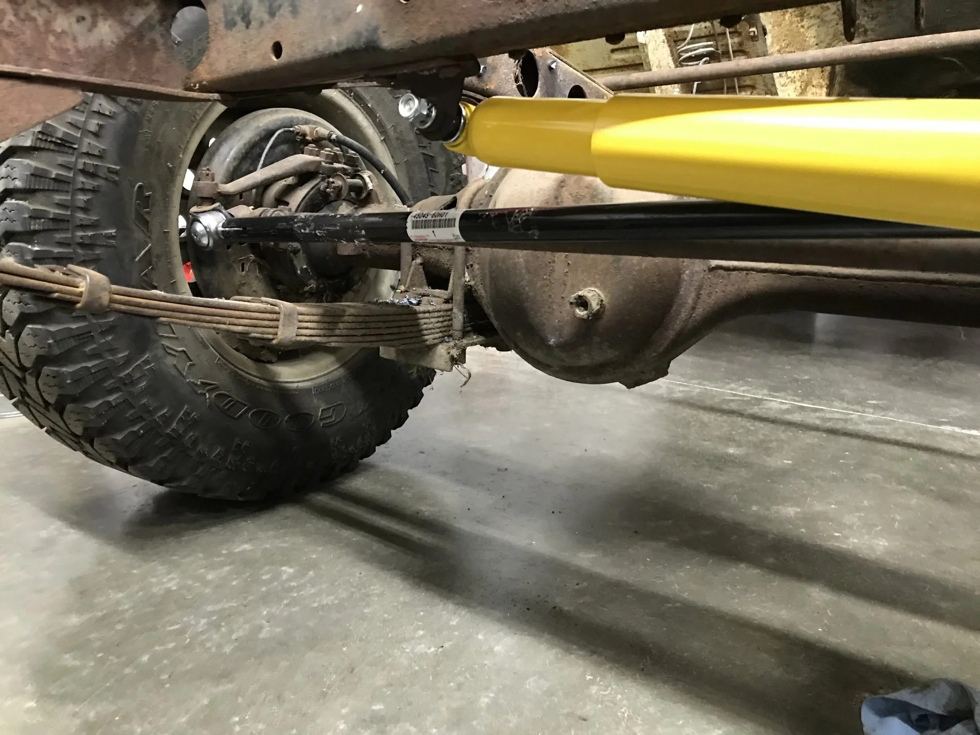

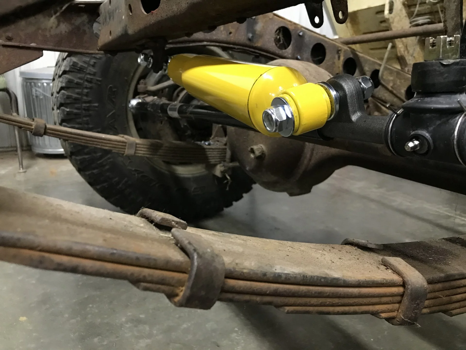

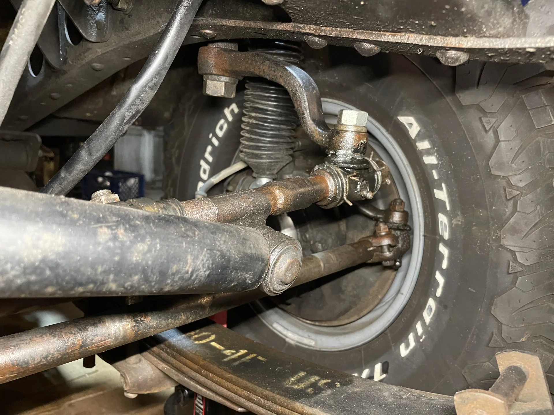

Firstly, almost finished up on the power steering setup. Just need to flip the stabilizer mount around and move it to the passenger side a few inches and get some clamps, but otherwise everything else is lining up pretty good. Running a 70 series drag link, relay rod, and steering stabilizer with an FJ40 driver side tie rod end.

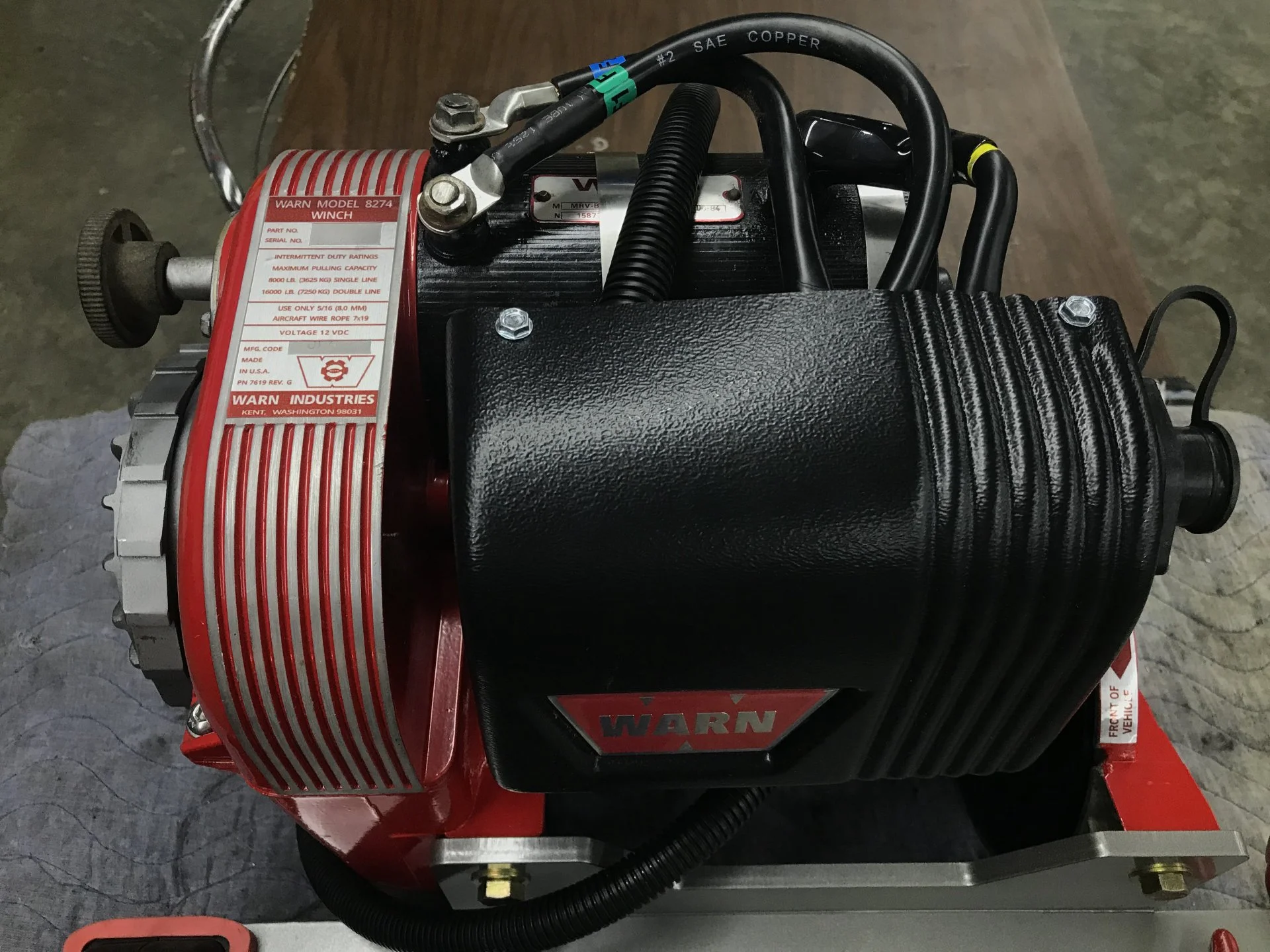

Also getting @powthief19's 8274 plate mocked up. Absolutely beautiful fitment on this thing.
View attachment 2864632View attachment 2864613
View attachment 2864648View attachment 2864649
Great work. Can you share some more details on the steering linkages you used up front? Is that a 60 series drag link and original 40 series tie rod? I can almost make out the part number in it. And I guess you used 60 drag link ends and 40 tie rod ends?
Basically looks like a simpler approach to the PO fab work I’m trying to sort out now.
Thanks! I’m away from the 40 at the moment so I can’t take a look at the exact part numbers, but for the tie rod its 100% untouched oem. For the drag link it’s comprised of: 1 LHD 70 series drag link, 1 LHD 70 series relay rod, and 1 LHD FJ40 Driver Side tie rod end. The 70 series drag link has the same taper as the 60 series so it fits the 60 series power steering pitman arm. It’s also shorter than a 60 series drag link from what I’ve seen. No cutting required so far. Only problem is where the the tie rod end connects to the long tie rod end with eye on the passenger side, there’s not enough thread for the castle nut to fully go on. Still trying to work that out. If you want I can get some more pics of this set up tomorrow.
