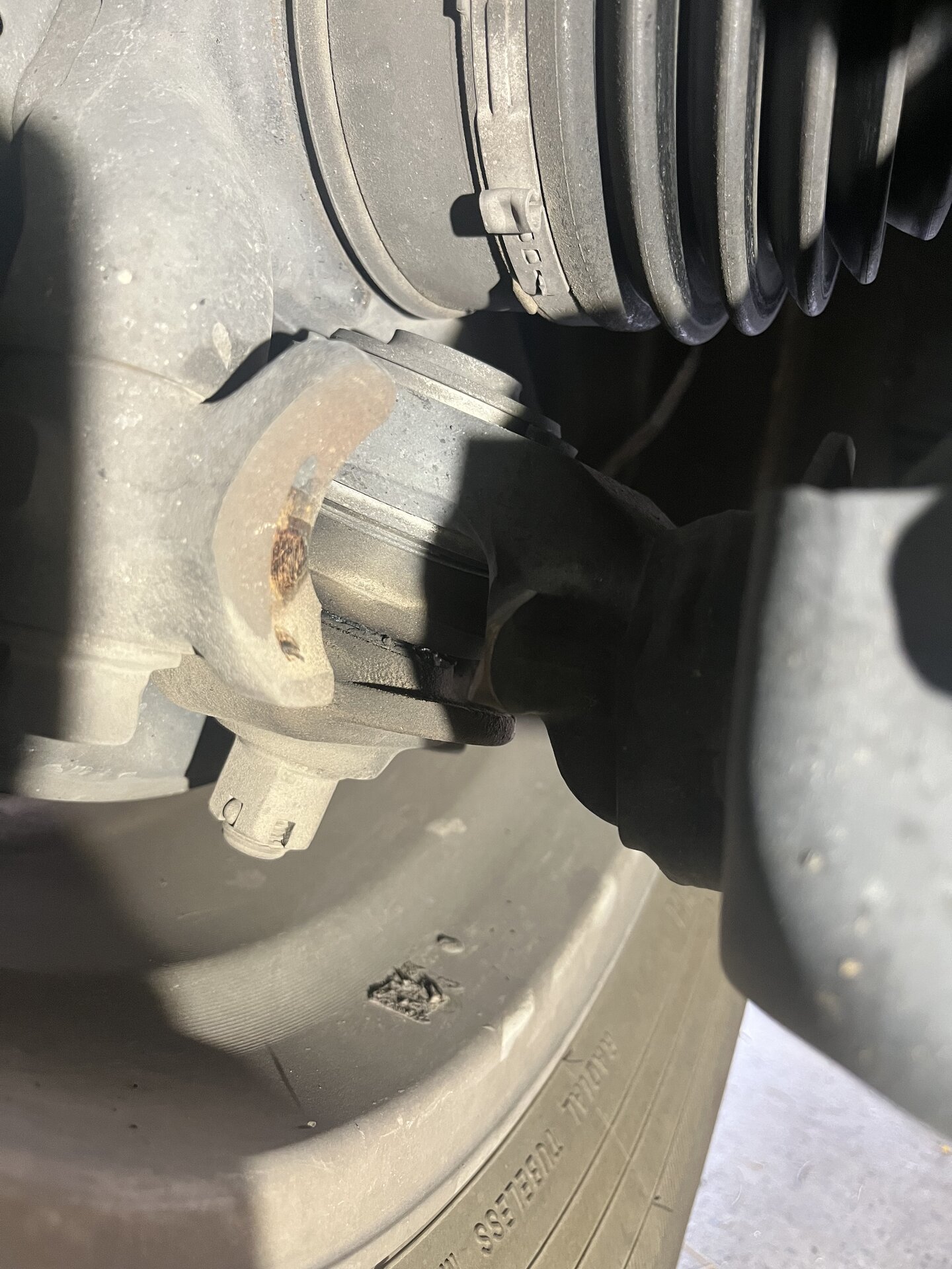

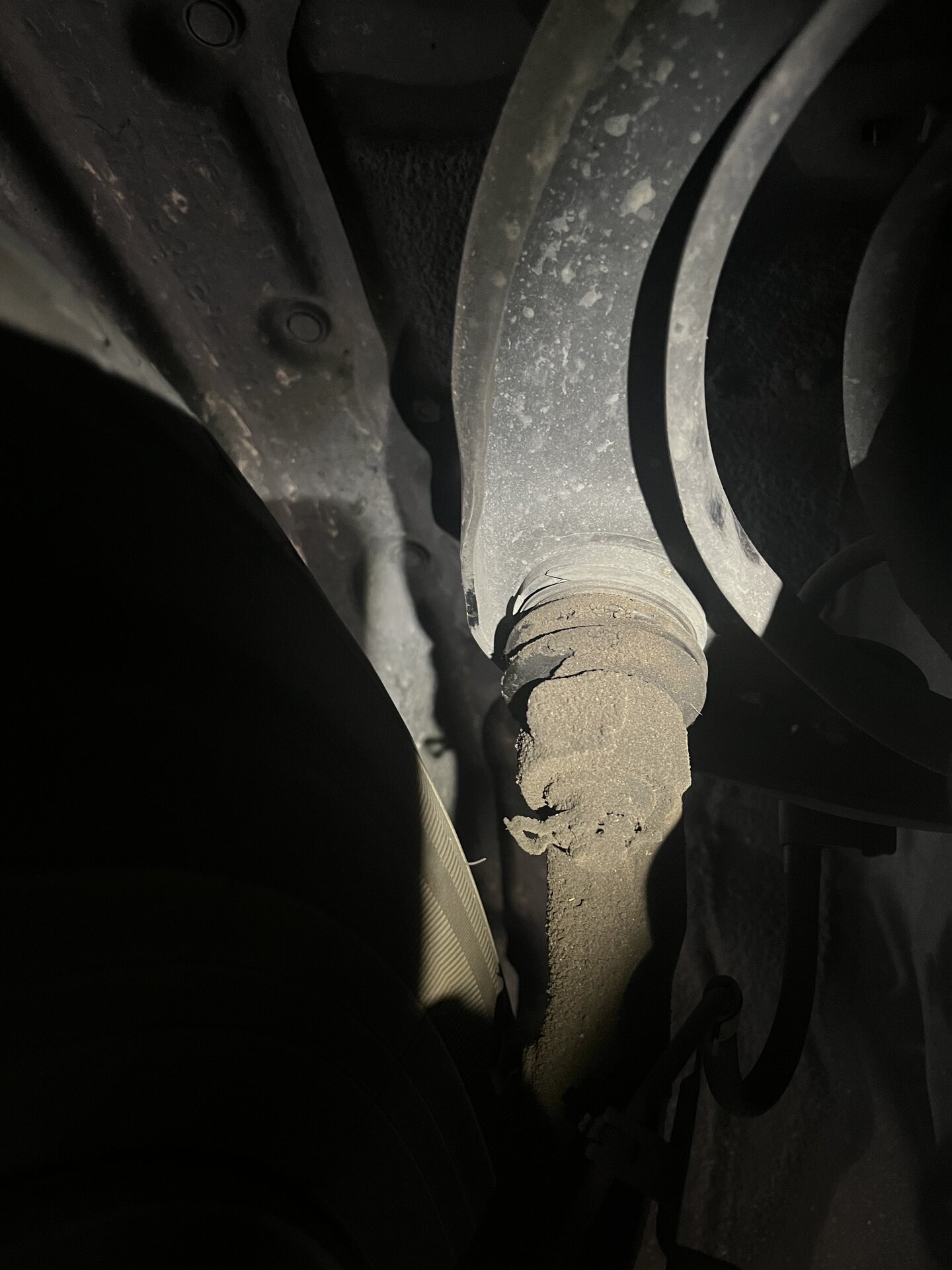

I’m in the same boat on my 2015 LC. I was noticing that the ball joint boots look like the grease has seeped out. I’m trying to decide if I should replace them when I install the new Eibach springs and shocks I just received.
Absolute waste of money, time, and perfectly good parts. Ball joints just do that, especially ones that are as solid and long lasting as ours. 200k on mine and tight as a drum.

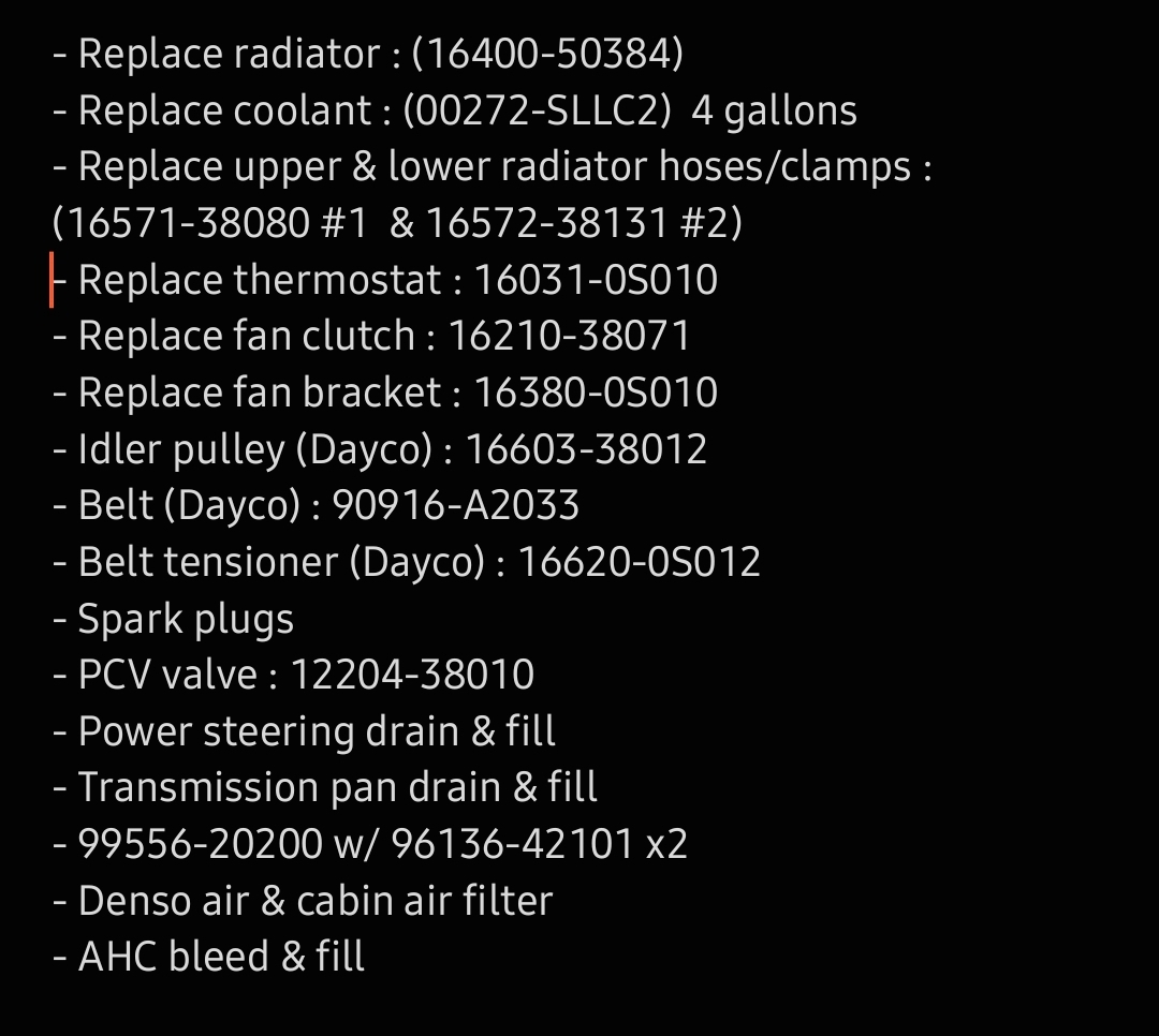

Here is the PM I plan to do on my 2015 LX570 when I hit the 115-125,000 mileage mark. The water pump was replaced at around 89,000 miles by the P.O. but since I'm going to be in there I'm just going to replace it just so all the parts are on the same maintenance schedule.
I did all of this PM on my previous 2011 L.C. that I had. With the exclusion of the transmission drain and fill, and the AHC bleed, the job is around 6-8hrs if you have all the tools and no distraction. Hardest part of the job is getting the radiator out. Once that is out, it's smooth sailing!
