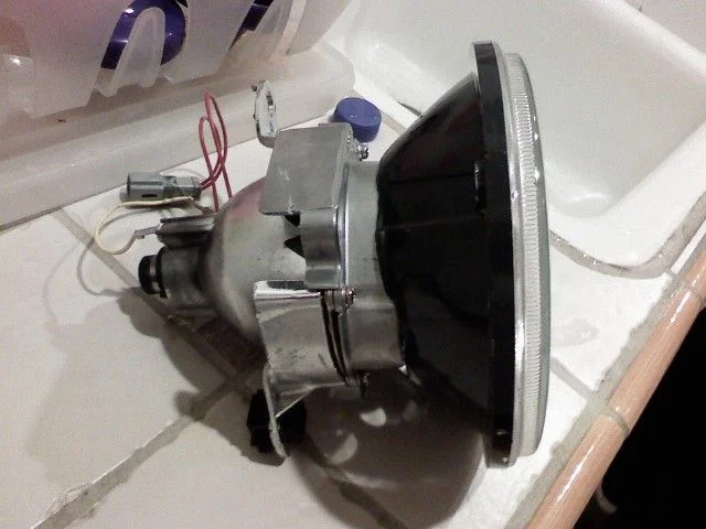

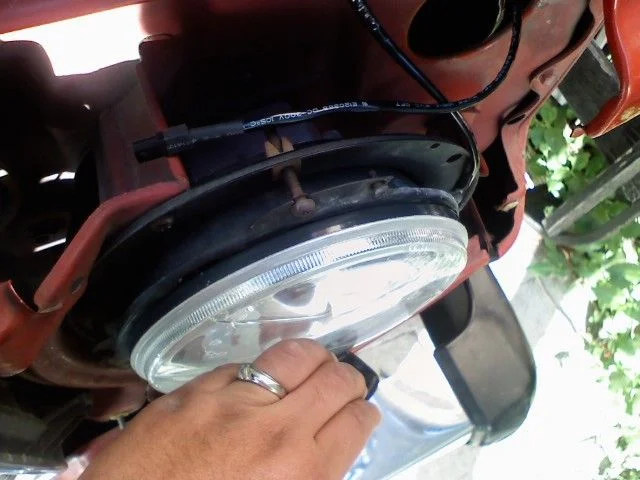

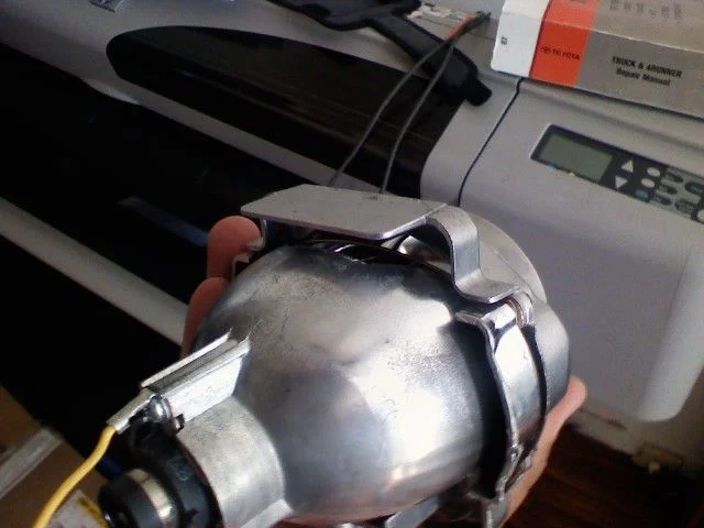

I got tired of the sealed beam look... "so 80's":p. Anyways... I bit the bullet and went with the bi-xenon retro... Don't want no rice rocket bling! Want the real thing. started with a bixenon from an acura... and ordered them ebay cheapo h4 headlinghts (should have paid more for the DOT approved ones... less police ussues...LOL) grabbed the dremel got too it.

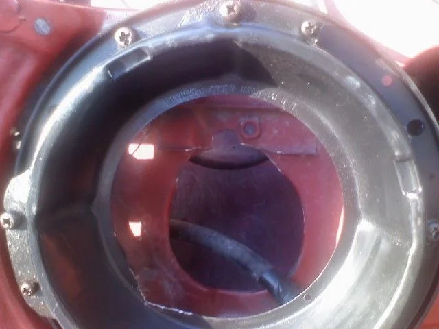

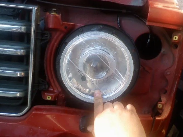

These are the issues that I need help on. I'm looking for something to seal both the housing with the projector. It needs to resist heat. I can easily use epoxy or JB weld. But there are gaps over 1/4" wide on the projector housing that I need sealing. I have limited room behind the headlight housing. Need some suggestions. oh AND all the trim on both sides have been removed...

I can hold one with my bare hands for about 15min... as it warms up a bit. then I could only hold from the trim.... I'm guessing no more than a halogen.... Mostly all of the oem housings that hold the projectors are acrilic/pvc/plastic? and dont have any issues. I'm thinking no more than 140F? when we bake the oem housing to soften the seal, I was told to be careful not to over bake because the reflector housing in the projector will get bubbles. And the cheapo ebay h4 lights were overbaked w/out any issues... I guess I can use JB weld even for the big cracks?

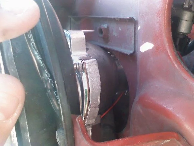

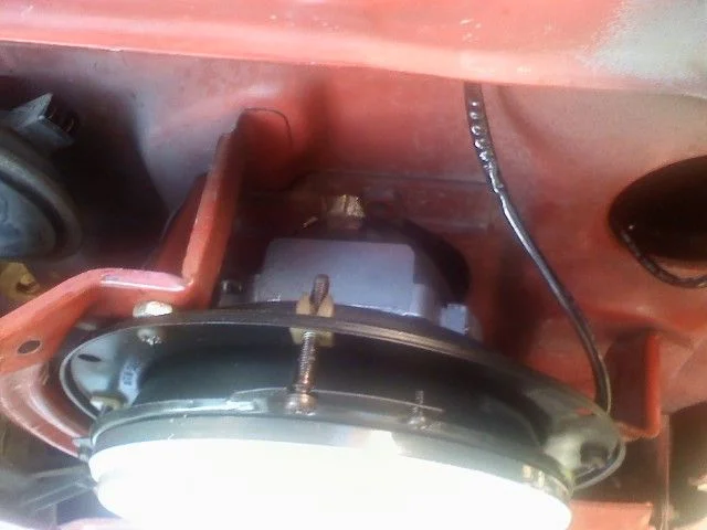

looks like it needs about an 1/8 or a 1/4 more for a fit... with aiming though.... I will have to cut:crybaby:. looks like it will just miss the battery tray. Would it mess up the strength of the nut that holds the battery tray?

Tapage.... YES!!! IT will be a killer improvement. I finally made it... I was able to put 3 nuts at each screw as spacers..about 1/8" I think. That was able to give me a little wiggle room. I will see how level it is tonight.:cool:

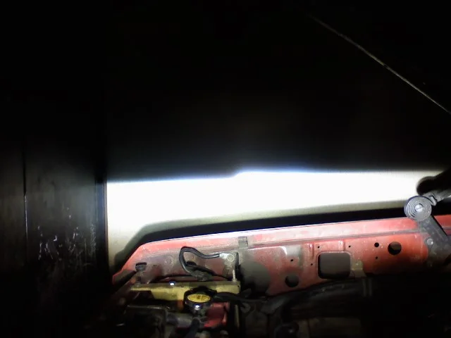

I ended up using alot of epoxy 500F resistant. I'm waiting for it 2 cure and.... OH YES! their will be light! on the driver only for now....

it will be a bit.... I will be busy for 2 days... but will do! you will not belive your eyes.... OH YEAH!!!!! I will have to finish both first. cuzz I will have to use my church's parking lot. It's large/open with brick walls where you can really see the pattern. Unfortunately, my drive ways is small and full of cars... so I don't have any room for light patterns and I don't want to bother the neighbors across the street.:D
but I will be done. I'm in a hurry 2 finish because well... I miss my 60. Got the powerstering pump installed and ready.... soooo... I cant wait to see the looks on peoples faces when they think its a honda s2000 but when I pull up, they will see my :hillbilly:60:hillbilly:
