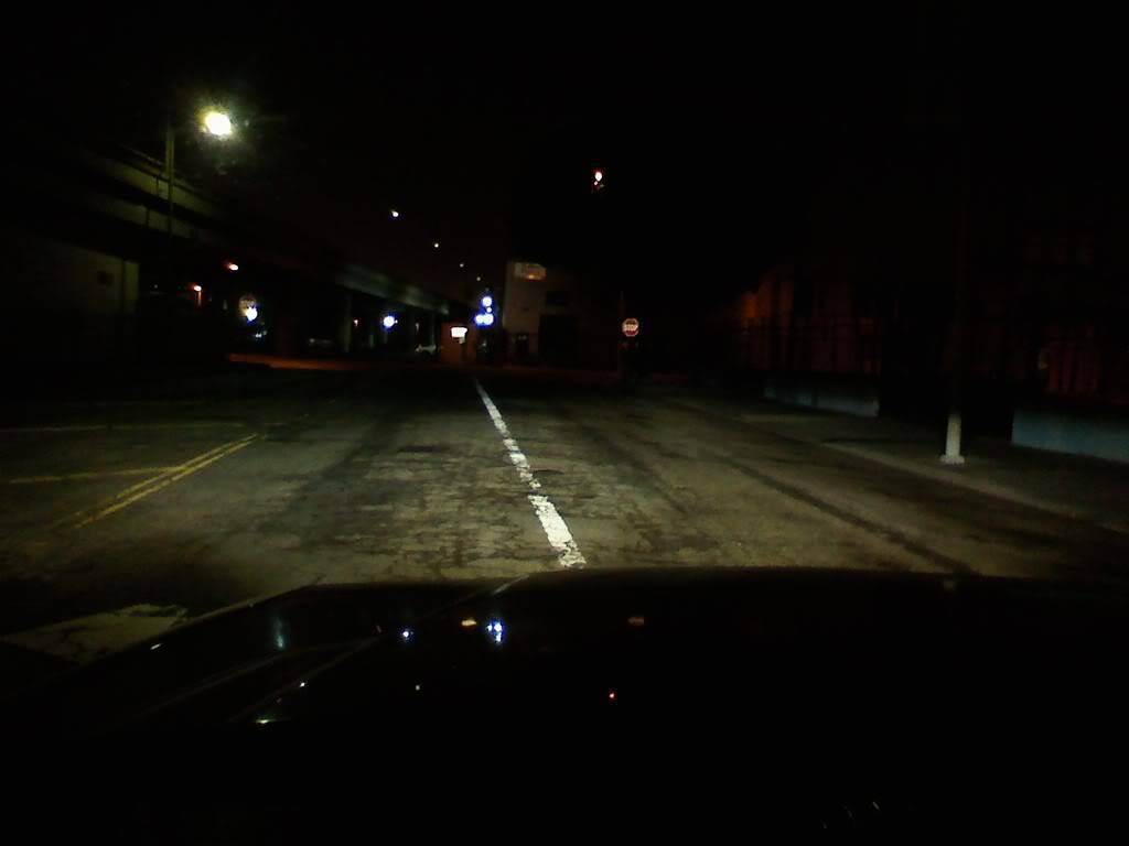

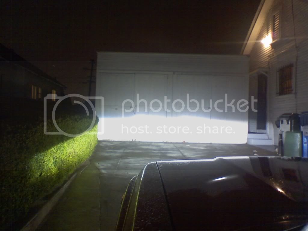

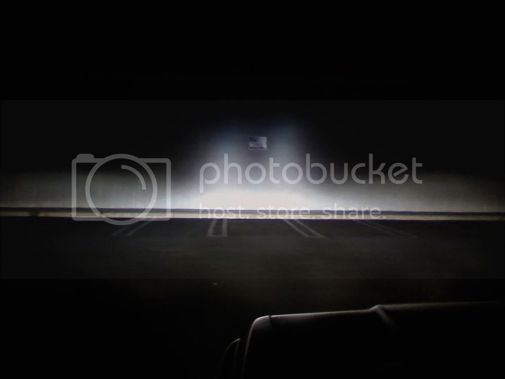

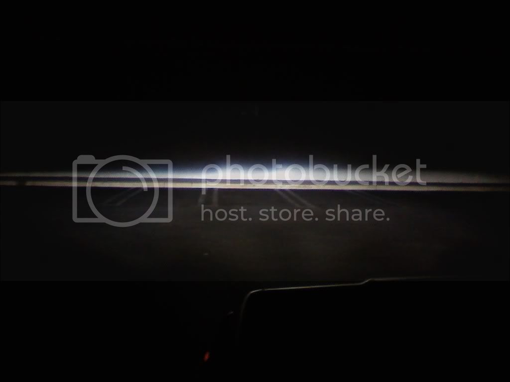

Here they are..... night pics..... WARNING... these were taken with camera phones so the quality is not up to par. And the beams are aimed low for now... Trial period... I will adjust/aim as time progresses.
@ church

Great project and WAY awesome on the results.
