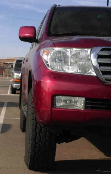

The front tires will rub on the back of the wheel well. with 34s all you have to do is trim the plastic mud flap. Not sure if you used the SPC uppper control arms if you could adjust the set up forward enough to avoid cutting more than plastic with 35s.
Stock wheels have 60mm offset, RWs have 50mm. the 10 mm helps clear the upper arms, without sticking the wheels outside the fenders. if you run a narrow tire! The added width of the Tundra arms helps clear the KDSS, no need for relocation brackets.
pic of tundra front with Rock warrior wheels and 285/75/17 Toyo ATIIs.
