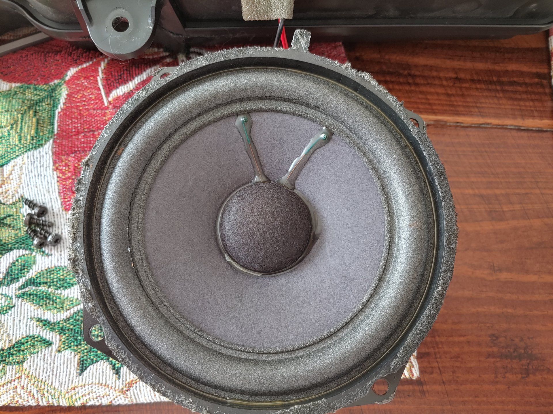

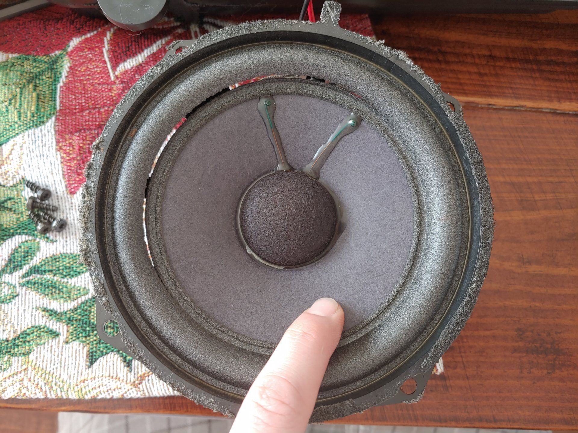

So before leaving, I had the Simply Speakers re-foam kit sent to my parents' place and got it knocked out this week. Easy enough process, though trimming the old foam and adhesive from the cone is very tedious. Be careful you don't end up slicing the cone itself. Also worth noting, there is a compression ring that sits around the perimeter of the speaker that must be removed to fully remove the old foam. It's adhered on and will need to razor-bladed away. Once done, you can scrape the old foam from the outer surface of the speaker. I installed the new foam, then new glue to the ring and set it upside-down with some weight to hold it down a bit. Drying time is 1 hour per the instruction.
For $20, 20 minutes to remove, and about 30 minutes to do the job, it was well worth it. Eventually I'd like to revamp the whole system, but it's low priority made lower by the fact that getting new components into the ML-equipped trucks is a pain in the ass and not inexpensive. For now, this works great. Now I've noticed one or two other door speakers that may want some new foam as well.

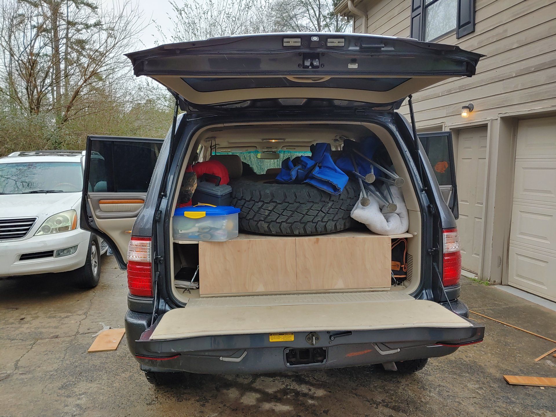

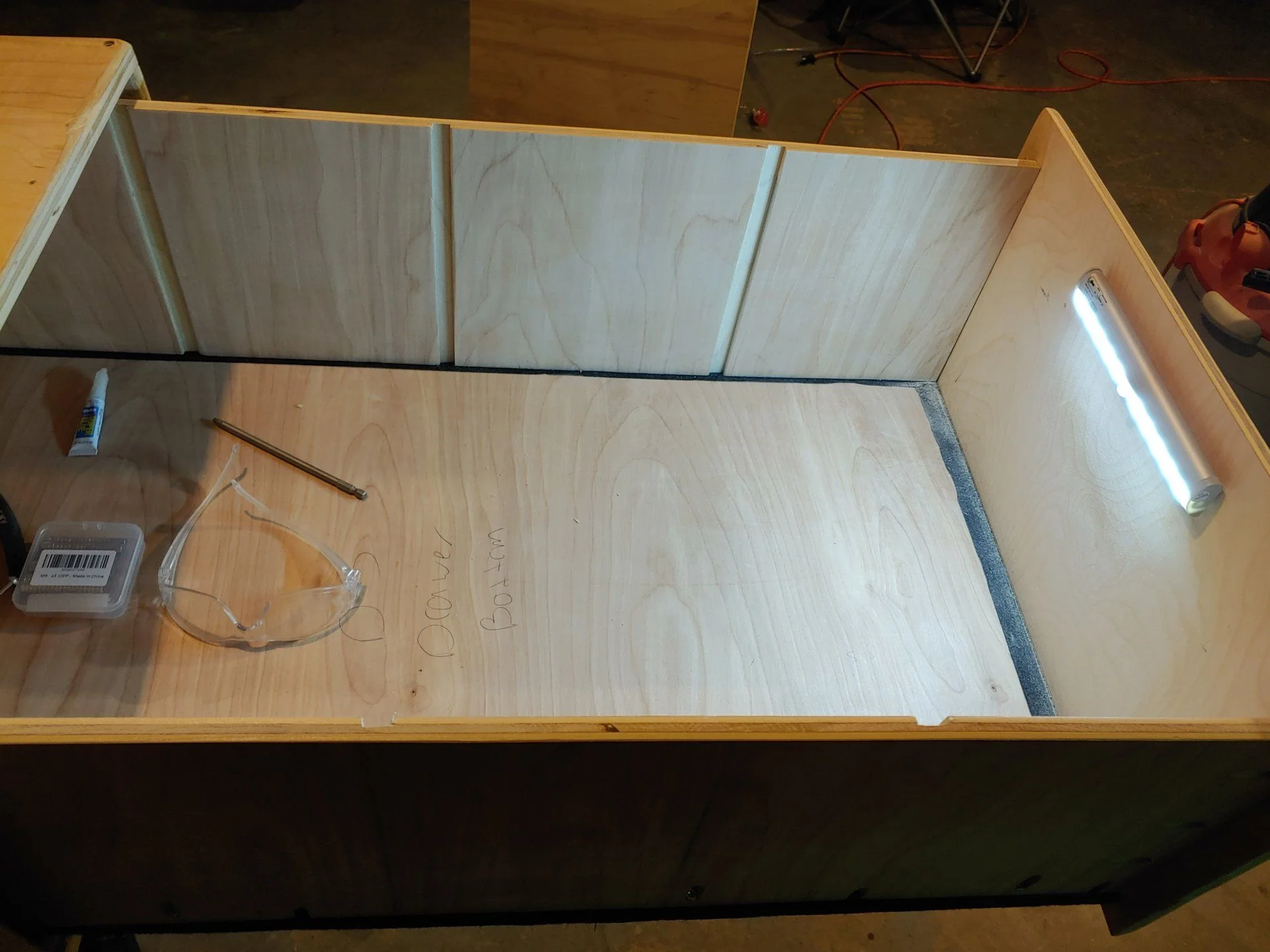

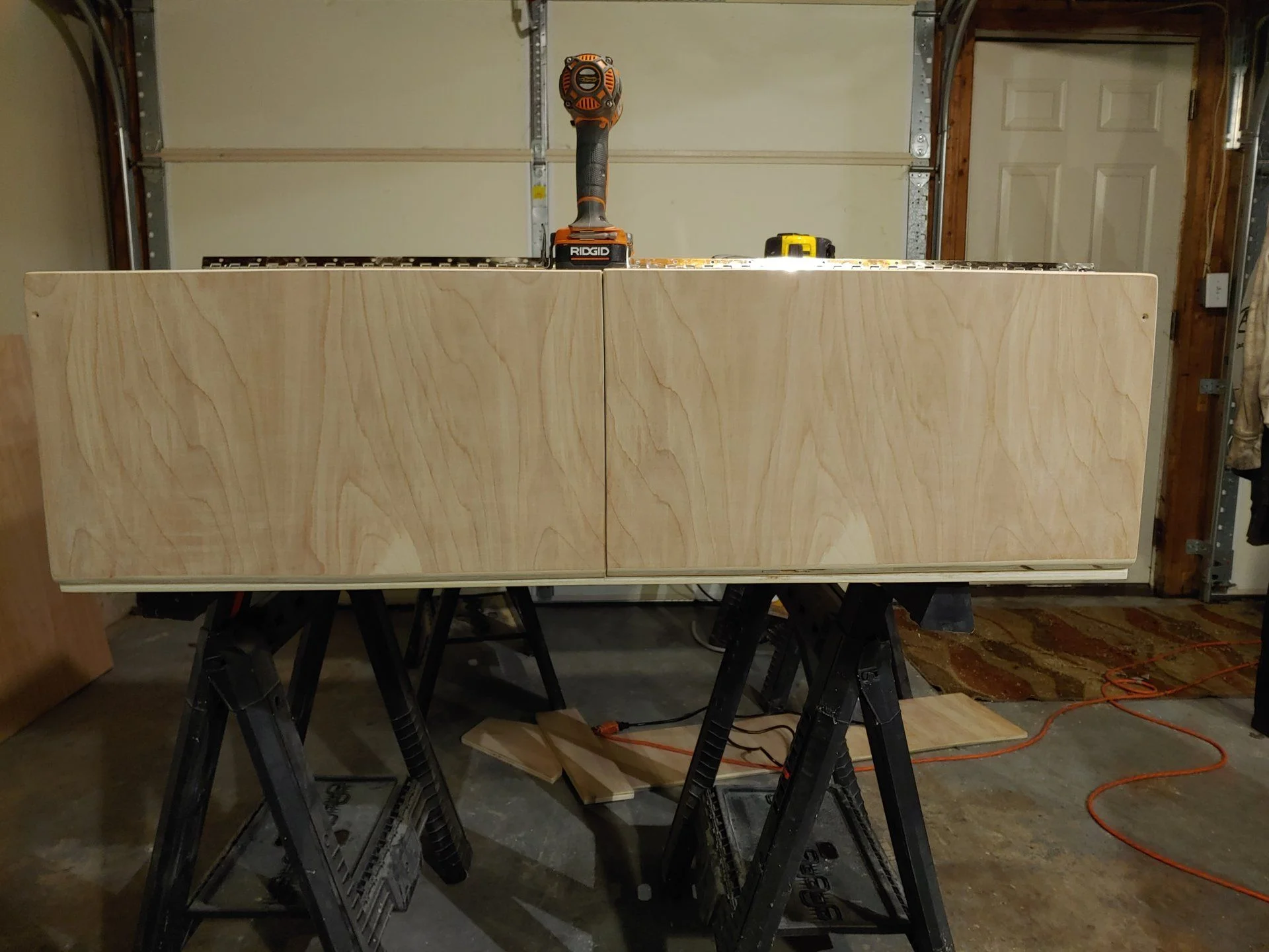

I've been planning and putting off drawers for basically ever. I debating buying a KISS system, but had some other ideas I thought would be cool. Ultimately I decided to build my own and I'm happy with how they're turning out. They're about 90% done, not including staining or eventual carpeting.
The goal for me was to make a sleeping platform with storage for things I carry every day (some fluids, tools, gloves, emergency stuff, jumper cables, etc) plus recovery gear for wheeling trips. I also built this with the intent of semi-permanently mounting my air compressor in the unit, with a quick connect fitting and remote power switch built into one side, just inside the tailgate. No more lugging the compressor around the truck and having to connect to the battery.

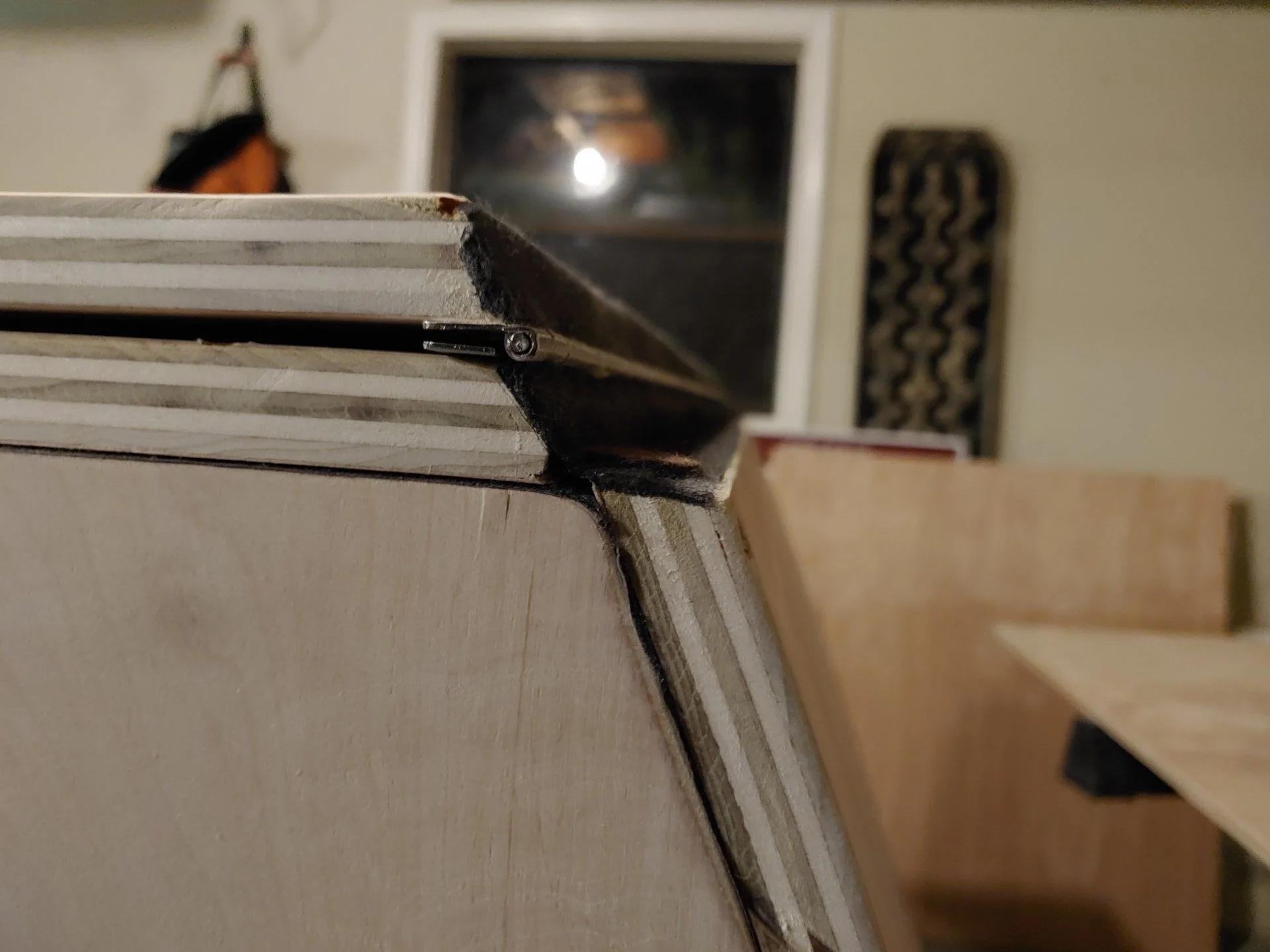

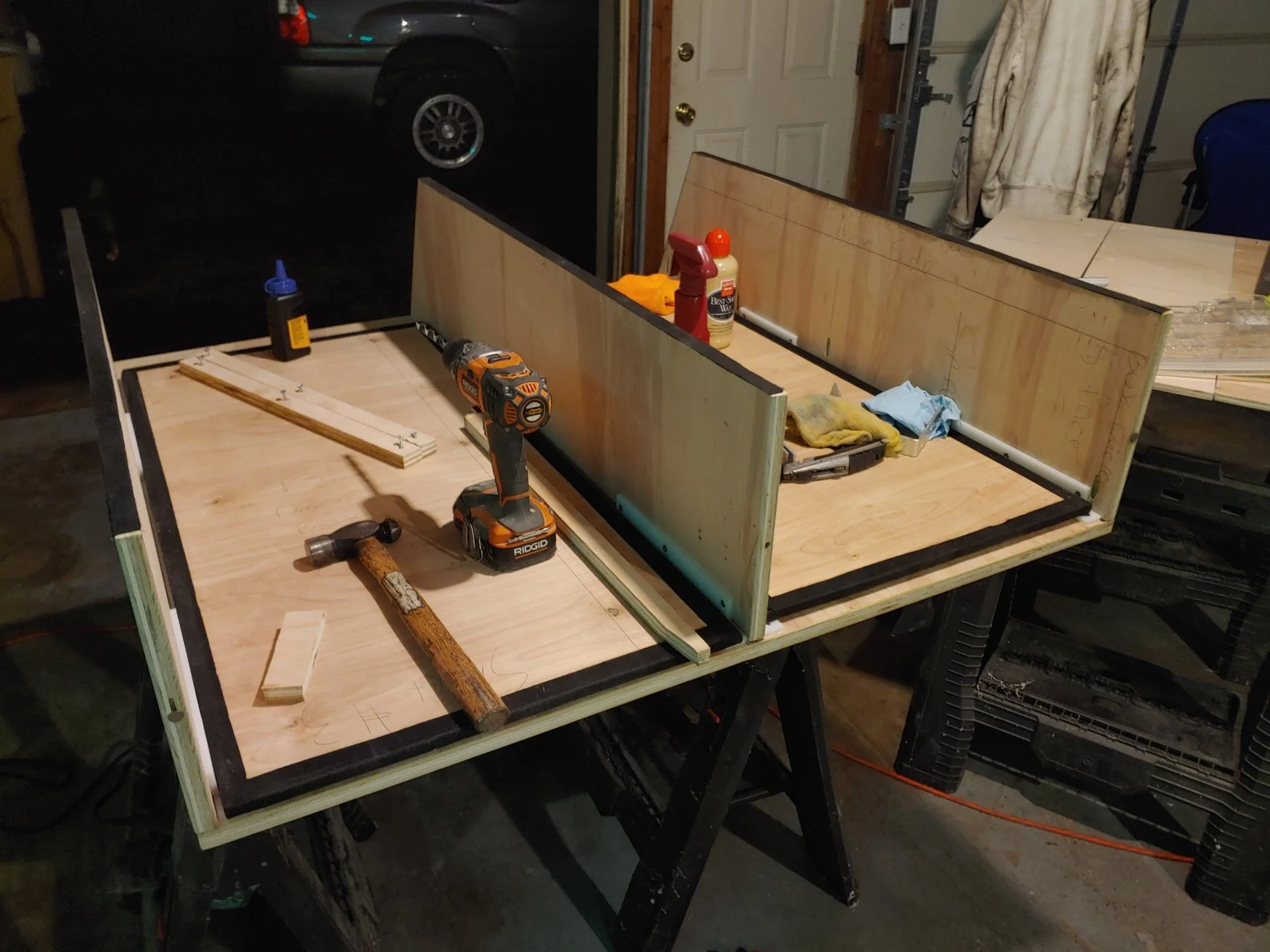

For the main box, I used 3/4" birch ply. It's heavy, solid, and makes a very strong main box. I also used pocket hole screws for everything except the very top panel. These are very strong and help a little aesthetically. The fold-out sleeping panels are also 3/4" and are affixed with full-width piano hinge. For the drawers themselves, I used 1/2" birch. This is mainly to save some weight, because this sucker is heavy. Inside the box I used UHMW strips from McMaster Carr and lined the bottom and just up the sides. My drawers were cut a little narrow for the space (I'm no expert carpenter) so they had a little side-to-side movement. To remedy this, I added a strip of adhesive foam on the interior face of the box, one on each side of each box. These keep the drawer boxes smoothly snug without adding much resistance.
Rattling and random noises are huge pet peeves of mine so I wanted to do all I could to alleviate them. I used felt tape between every single wood-to-wood joint so if there's any movement at all, it'll be silent. This also got added to the notch where the sleeping panel rests when folded out. I intentionally notched/angled/wizarded the panels here so that when I fold out the intermediate panel, it rests flat on a 3/4" lip to give the piano hinge a little extra support.
In the back of the unit (against the back of the 2nd row), the box is angled to match the seats. This means the boxes don't run all the way back, so I'll be adding some marine hatch type doors to that panel to take advantage of that little cubby space. It's not big, but enough to put some sensitive items or however much cash you'd expect to get from a bank robbery. In the front (against the tail gate), I wanted as clean a look as possible. In my design, I opted to let the front face cover up the top panel. Meaning, the drawers don't slide 'under' the top, they cap it. I used one single panel for this, fit it to the box itself first, then cut in half before attaching to the drawer boxes with pocket hole screws. This means no holes or hardware, just one single clean piece of wood. There are also magnets recessed into the vertical supports of the main box, with a corresponding piece of steel on the inside of each drawer face.
Inside the drawers, I've got some motion-activated LED lights that are battery powered. They're magnetic and come with an adhesive strip of metal, so I can stick the metal to the drawer and the lights can be removed to double as flashlights. I also used a 1/2" router bit to cut some channels in the drawer sides. I'll be able to smoothly slide some dividers in there and section off areas of the drawers. I'll also add some sort of foam floor to keep noise and sliding down.
Still to be done- I need to trim the end sleeping panel, sand it, and attach. I need to put the box in the truck to measure for the side wings. Those need to be cut, shaped sanded, and attached. I also need side panels for either side of the drawers, beneath the wings. Lastly, I need to measure for the tie-downs when it's in the truck next. My intent for this whole thing was to save money vs buying one of the kits. Unfortunately, I didn't really factor for some of the accessories I wanted so all in all, I have more in this build than I have in my actual camper with plumbing and HVAC :doh:

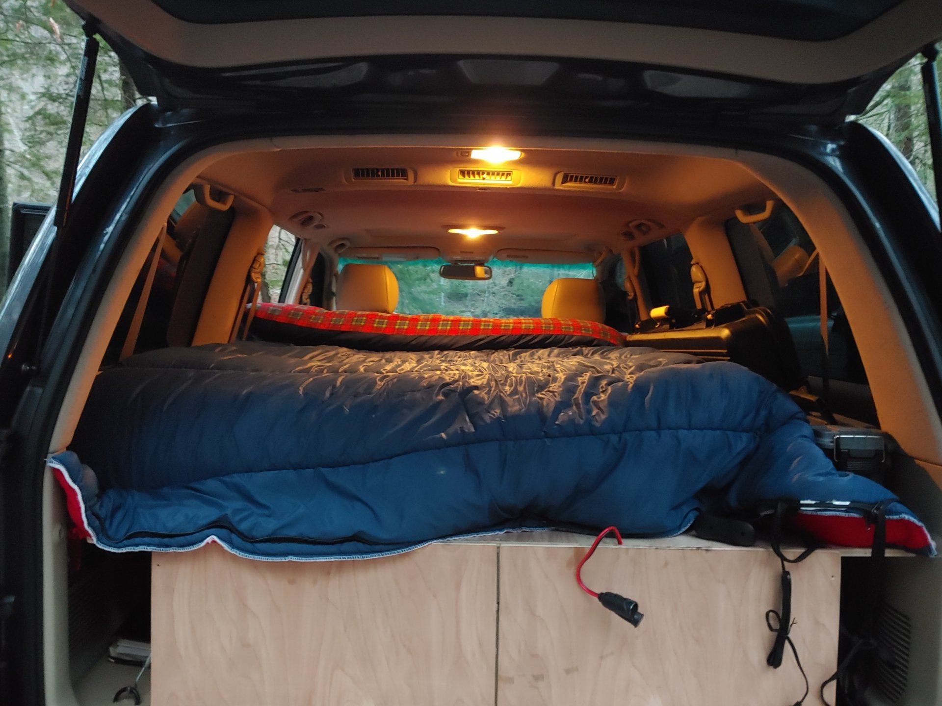

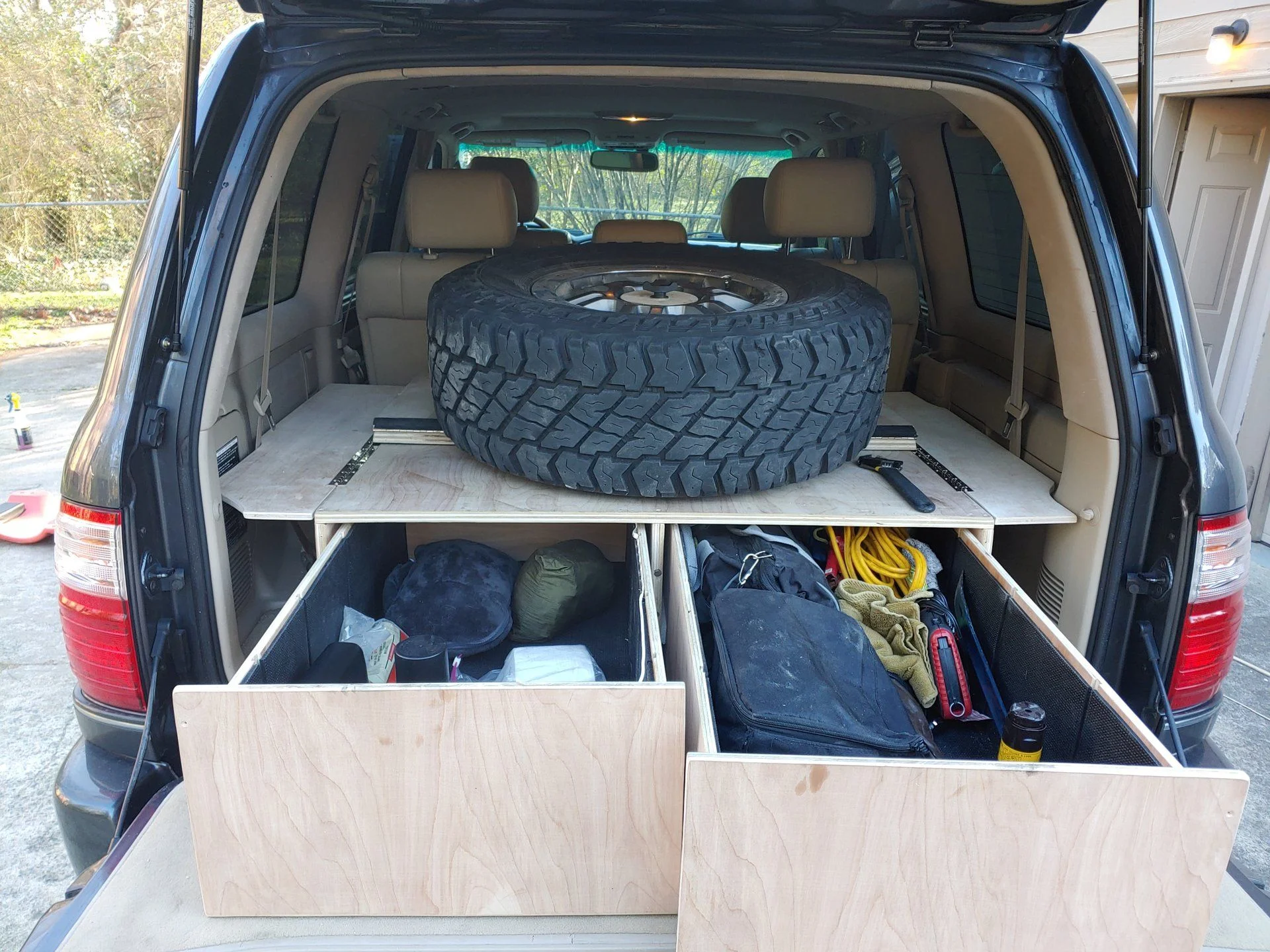

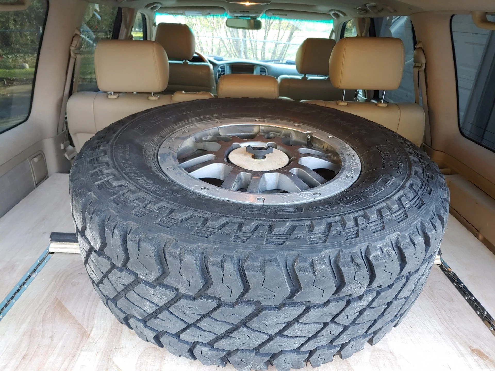

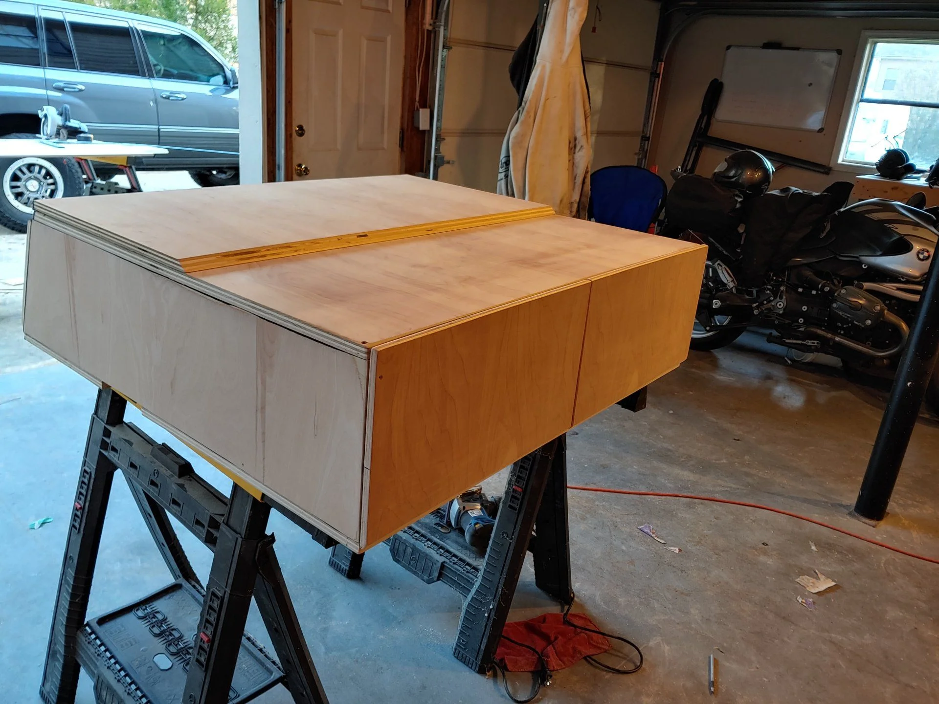

The drawers/platform were 'prototype' level finished in time for a camping/wheeling trip over the weekend. The task was to pack all recovery gear for remote wheeling, plus spare tire, enough food, clothes, and warmth for me and the dog while sleeping in the truck in freezing rainy weather for a weekend. Mission accomplished!
Ultimately I still want to stain/carpet everything, and there are a few additions I've got in mind as well. Because reasons, I'm unable to mount my spare under the truck, and haven't dropped the coin for a back bumper yet. For now, it goes inside. For this, I recess-mounted (flush mounted?) a big tie down point directly in the center of where the wheel would sit on the box. From there, I make a 6" cookie to anchor the wheel and some turn buckles to keep it snug. It works for now, but it's really not ideal.
I also ditched the lights I did have in favor of some with an LED strip. Also motion activated, but these actually work. Happy with them, just need some staples to help the adhesive. Drawer boxes were lined with yoga mat material to keep things from sliding or rattling.

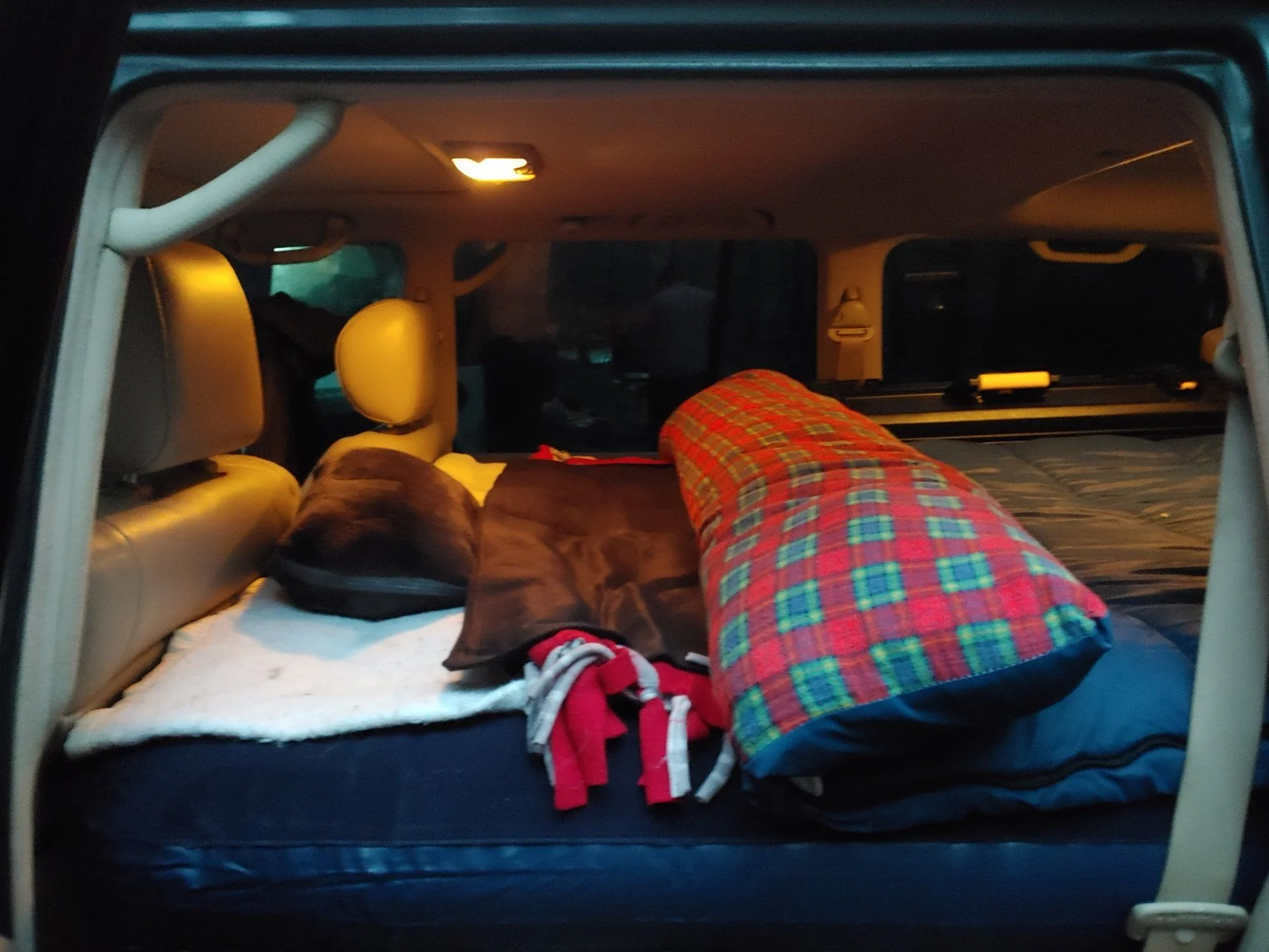

Snagged some crazy mileage on the drive up to the trails. We had a TJ in our group who needed to keep his speed down, so we held about 60-65mph the whole time. I was blown away here. I usually show 15-17mpg at the scan gauge just running 75-80mph.
Truck loaded to the gills. We (Norman and I) carried an air mattress and a handful of blankets, extra battery, full recovery gear, cooler plus dry foods, cooking equipment, extra clothes, an EZ-up, rifle in a hard case plus second ammo box, spare tire, water, tools, 2 chairs... Luckily the guys I camped with all had their own s***, so I didn't have to unpack most of mine.
We found a sweet camping spot right off the trail up against the river. It's been a wet month so the water was moving really well. Had a great chilli dinner by @sammybones and a killer camp fire by the Jeep brothers.

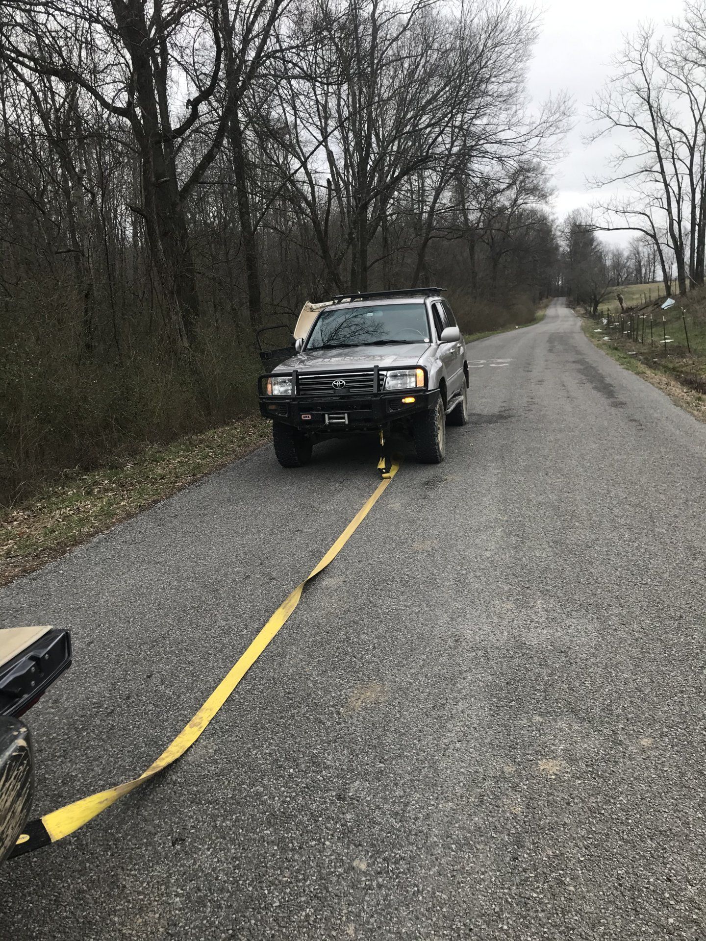

@MongooseGA didn't get very good gas mileage pulling my heavy ass off the trail when my serpentine belt broke😬. The winching did help out the gas mileage a little. Hell, even @bencallaway had to join in, it took two trucks at one point. We had a land cruiser train going for a little while.
Still bummed we didn’t meet up with @Wermz and co. As always @MongooseGA pushed his clean ass truck harder than he should have and it did not disappoint.
Winched my 80 out of a pickle and towed @sammybones like 20 miles.
This was a trip for the books and I’m ok with the lack of photographic evidence. We were too busy pushing and rock stacking and winching and whateverthefuckelse.
Ha! I only had to winch you back out because I wouldn't have had the balls to try that section first :rofl:

Great drawers and great trip report - you are really using the LX the way it was intended! Just one question, where did the spare go when you camp in it at night?
Ditch work and go get it. You will love it once you get it all going. Obviously it will need to be regeared to 4.1 to match your front. Or you could just regear both front and rear to 4.88 nitro gears :cool:
Took it out and leaned it against a tree nearby. Definitely not ideal.

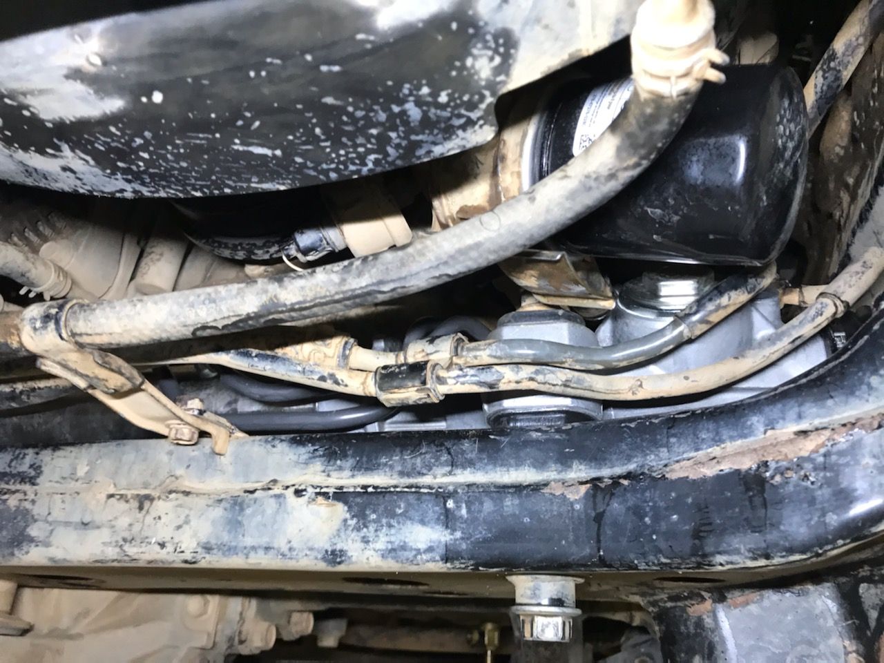

This week Gerry got oil/filter/lube, 5 tire rotation, had resistors wired in for the rear brake lights, did trans and power steering fluid exchanges, and replaced the cylinder #5 coil. Mileage is 255k.

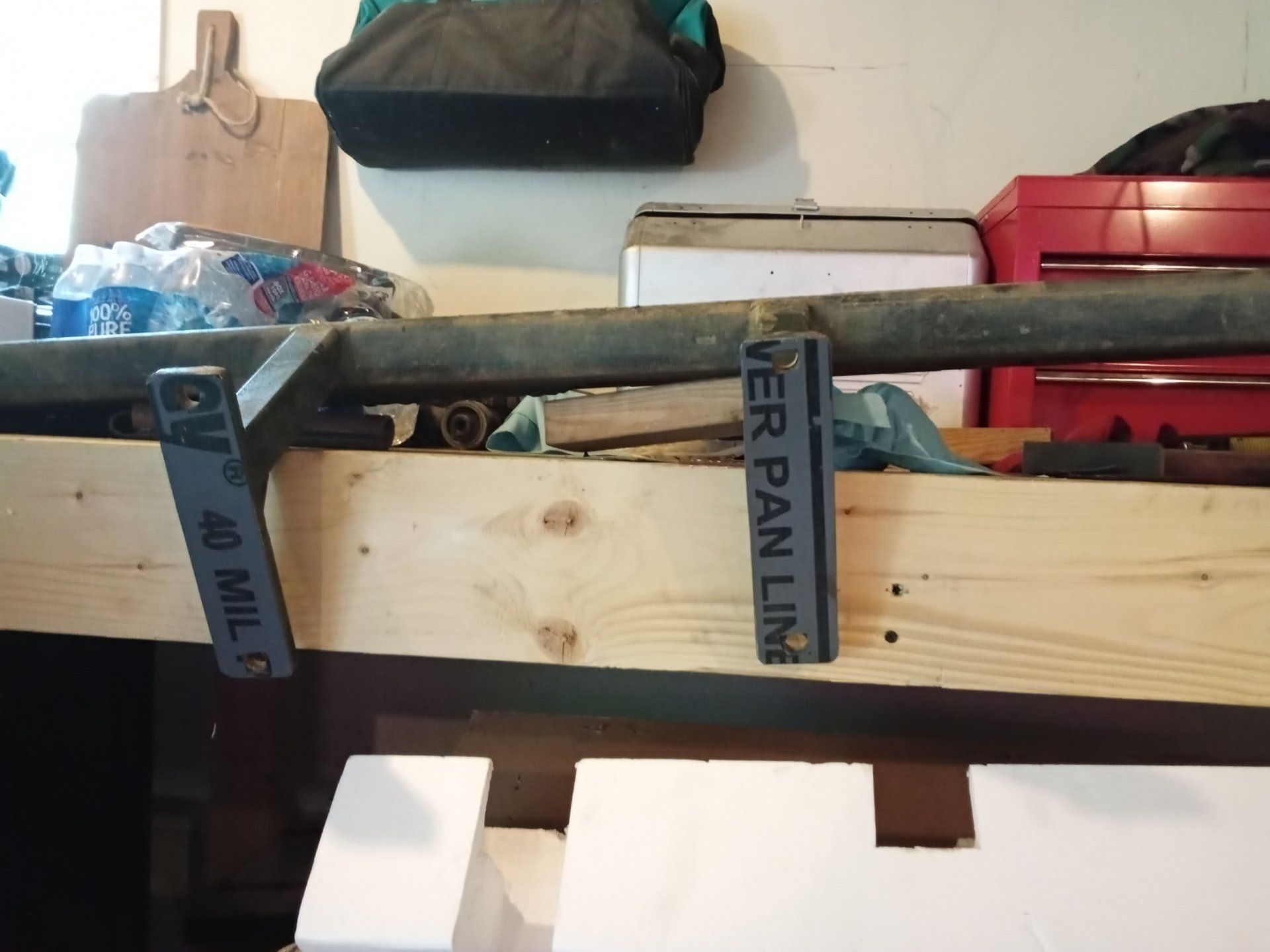

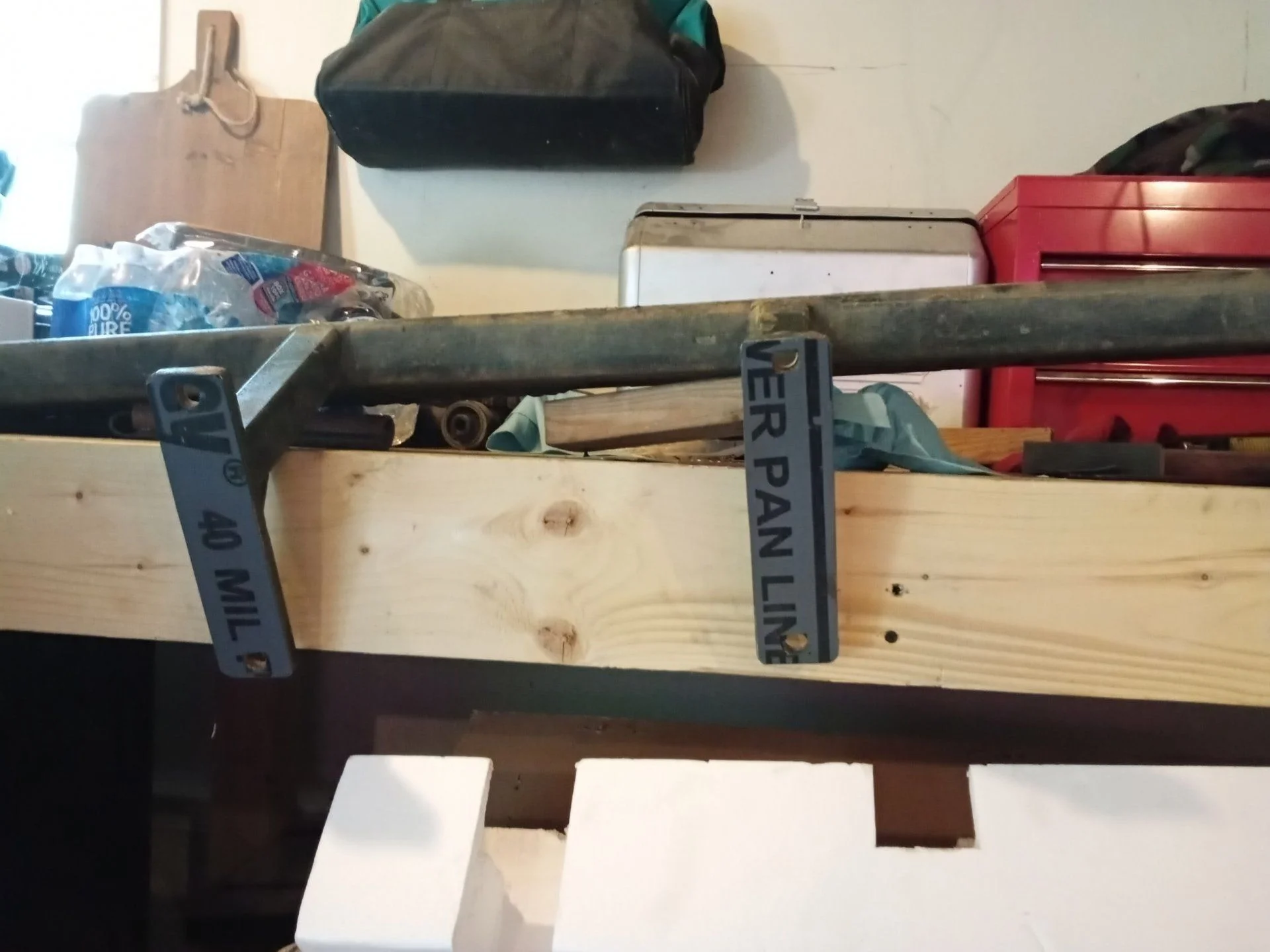

Lastly, I reinstalled my sliders today to get ready for a trip this weekend. I've been having all kinds of God-awful creaking from my WKORs for a while, and I might be the only idiot who has that problem. So I devised a plan to cut that s*** out.
Under-the-tub liner on the feet of both sliders, and wrapped from the top,inside, to the bottom edge of the frame rails. Now the sliders have insulation, as do the U-bolts. My short test drive yielded good results. $5 for one 1'x4' section with plenty leftover.
I've got some movement/groaning in something in the suspension. Hard to consistently duplicate, but annoying considering EVERY FRIGGIN PIECE OF SUSPENSION IS NEW. I suspect it could be my SPC UCAs. Greasing them didn't seem to improve, so maybe I'm chasing the wrong thing.
