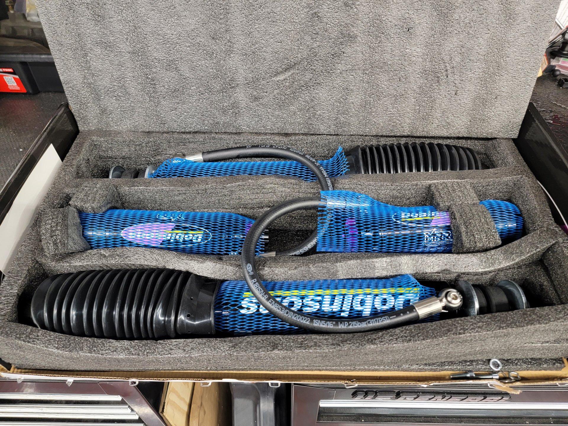

So after our last wheeling trip, I made the decision that after about 90k hard and heavy miles, my shocks have seen their better days. With only more weight eventually going in to the truck, and the trail obstacles only getting more difficult (thanks to my friends with 80s and their big ass tires), it was time for new tubes. I went balls to the wall here, I think. Also looking forward to seeing how the new bump stops improve the feel of the truck. I'll install those first.

I'm thinking I may look in to new springs as well. I have the (I think) dual rate Tough Dog red coils for med to heavy. It might be time for heavies.

Heck yeah! Looks like a major upgrade to your TD shocks!
Have ever weighed your truck when fully loaded? TDs on my truck worked better with a little weight on the truck! Curious how you like them (once installed), compared to your well worn TDs.

I haven't, but I would like to get it weighed. Even just in road mode for a base line.
I'll keep you posted.
