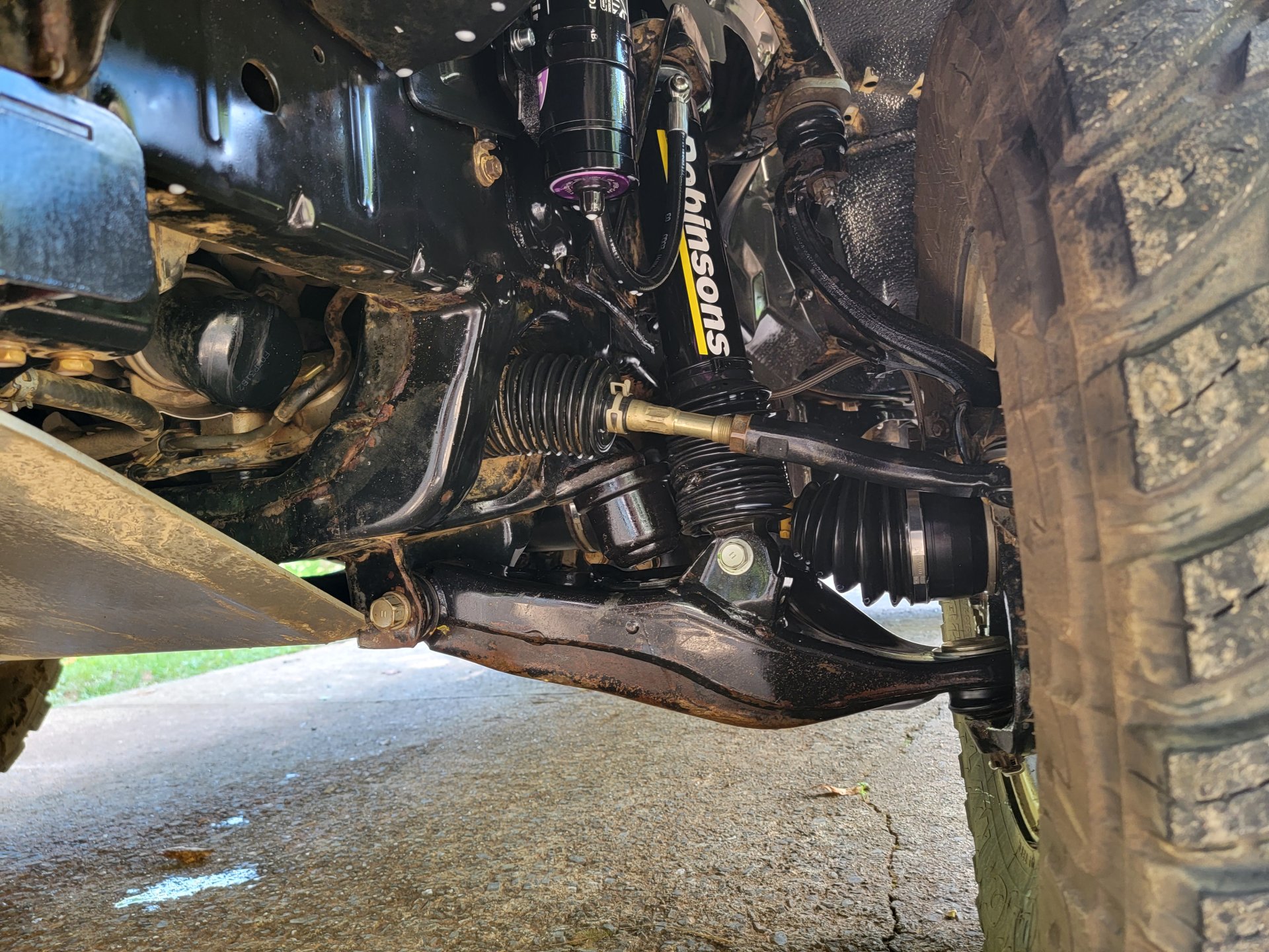

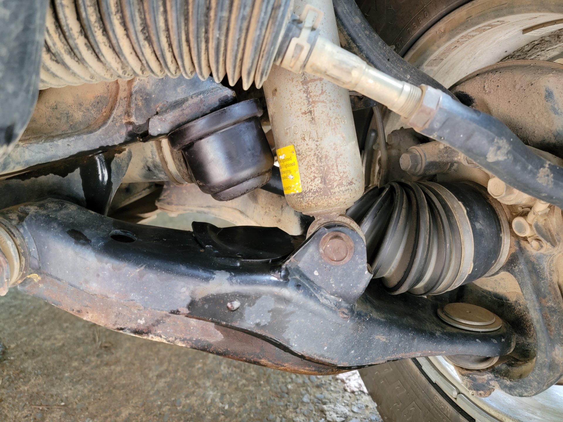

Added Wheeler's super bumps to the front control arms. I only did the 1 pair for now to see how I like them. I installed them in the forward position. So far I think they helped a lot with some 'jarring' over moderate bumps, such as the little rain gutter across the entrance to my driveway.

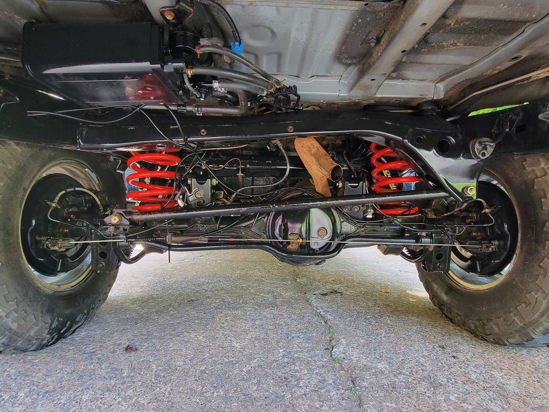

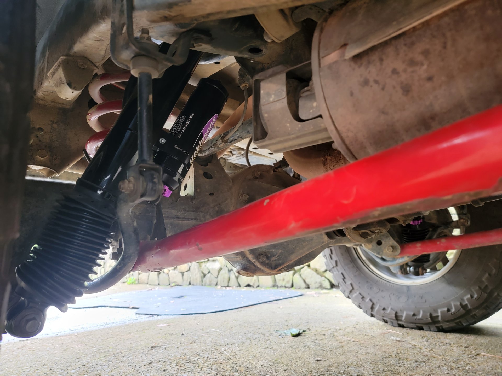

Next up were the shocks. I installed the fronts earlier this week and wrapped up the rears earlier today. Dobinson's MRA all around, the fronts being the extended length flavor. I really like the ride so far, but I'll be playing with the knobs for a while getting it just right. I also removed the AirLift bags from the rear springs as I just don't ever use them. Ziptied the air lines securely so I can put them back in pretty easily in the future if need-be.
Install of the shocks was straight forward. I spent about an hour messing with the top nut on the rear shocks before I decided that cutting them off was best. So out came the Ultra-Tool and within a few minutes, they were both out. Note to self, don't cut these Dobinson's out before sending out to rebuild in the future.

Muffler is still there, but the resonator behind the axle is gone. I chopped it off when I installed the rear bumper. IMO, I love how the truck sounds. Throaty down low, no drone on the highway. I attribute the throatiness to the small hole in the muffler, though, and less so the lack of resonator.

Goosey, did you make any further adjustments to the shock?
I have. I've bumped the HSC up to about 6-7 and the rebound I've got at 4 currently. I think LSC is around 2 still. With the truck loaded up over the weekend, adjusting up was helpful.
It's still not quite as tight as I'd like it yet, a little extra roll in the turns, but still very comfy.
