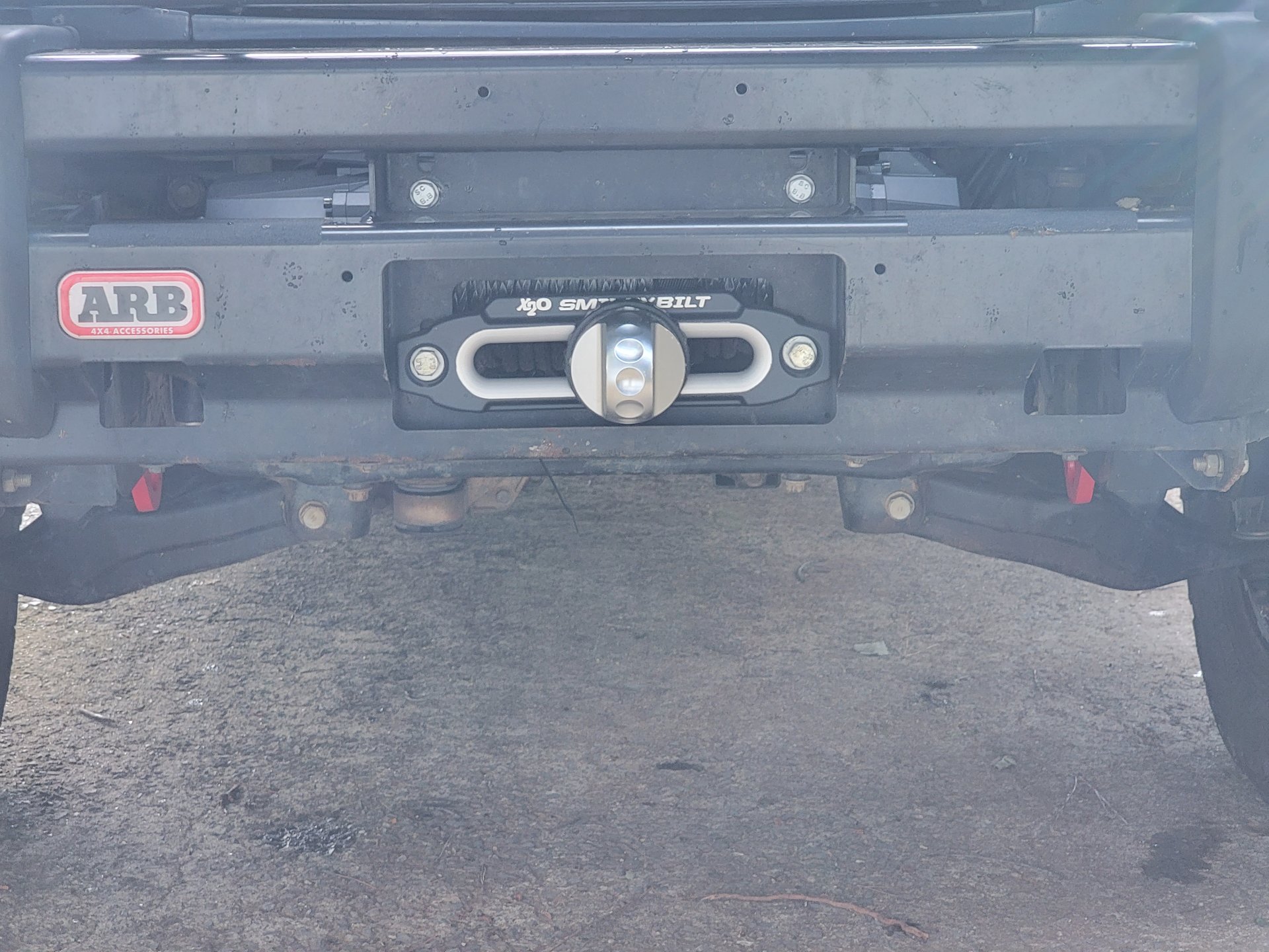

@Wermz came by today and helped me get the bumper put back on. I got to break out the welder to repair a broken captured nut. Was fun.

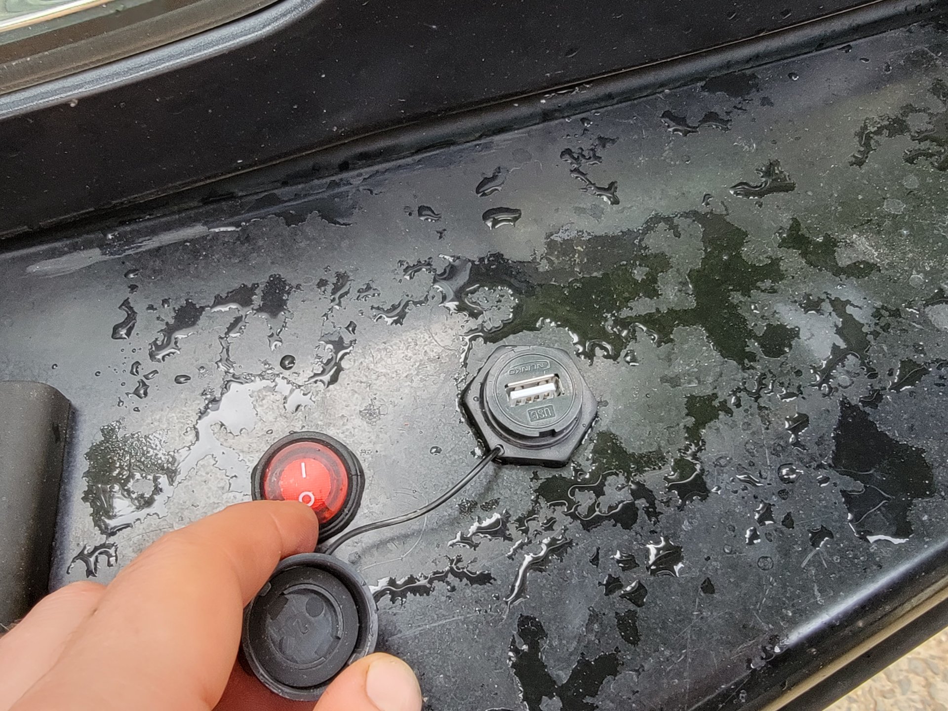

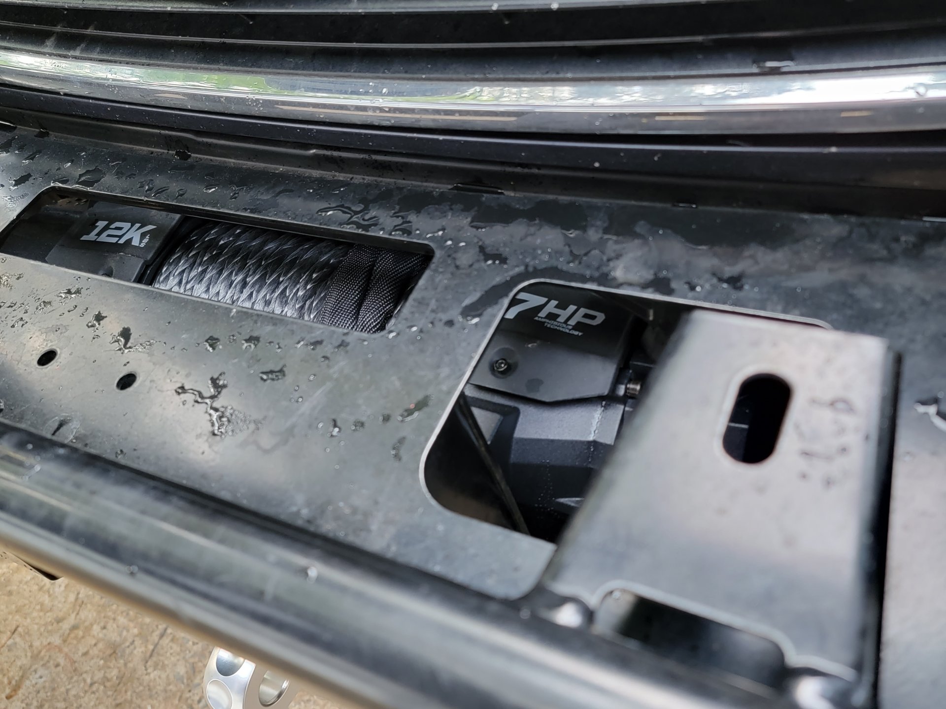

The new winch and prolink are in and my remote mount stuff is pretty cool. On/ off switch on the bumper to turn on my wireless receiver. Waterproof USB port if I want to plug in the controller to use it that way. I was thrilled that the whole 12k winch fit inside the bumper with the control box mounted on the original location. I also installed the @TRAIL TAILOR recovery points I've been sitting on for at least a year. In red below.

Skids are back on, tidied some remaining wiring for the bumper, tightened up the bearings on my swing arms. My diff drop also had a broken captured nut so I got to play with the welder again. Idk how I've gone 30+ years without one of these.

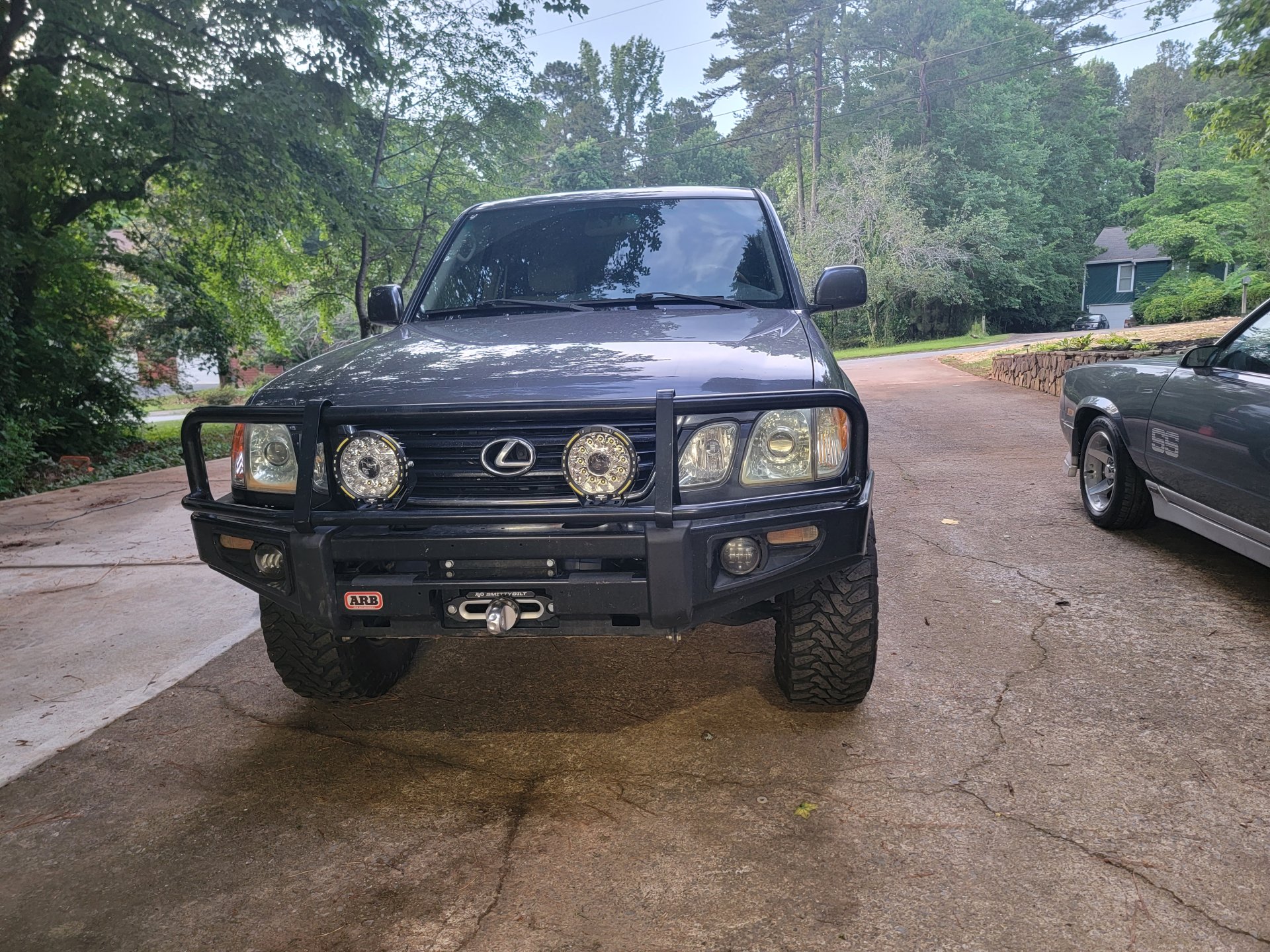

I bought a set of 9" round lights, but they look so big and comically goofy. There's also a little interference accessing my winch lever with these on. Not impossible, just not as nice as it is without them. I've ordered the same pair in 7" to compare. They're set to arrive tomorrow.
Thoughts?
Thoughts?
If you can try them both out on a trail-like stretch...maybe do that.
I've got a set of 8" on an ARB like you have in the picture, and they're nothing short of amazing in open desert. But they're so bright that as quick as I'm on a trail with "sides" (brush, trees, whatever) I usually turn them off. It's weird to describe, but the abundance of reflected light just makes your eyes tired.
Yup, I know what you mean. Do you have any colored lens on them? I've read a few posts that an amber diffuser helps with that a lot.

I have amber lenses for them, but have historically been too dumb to remember to put them on :bang:. I'll have to try that someday—mostly I just switch to the roof-mounted (amber) light bar. It's an el-cheapo brand, so the output is nowhere near impressive, but good enough.

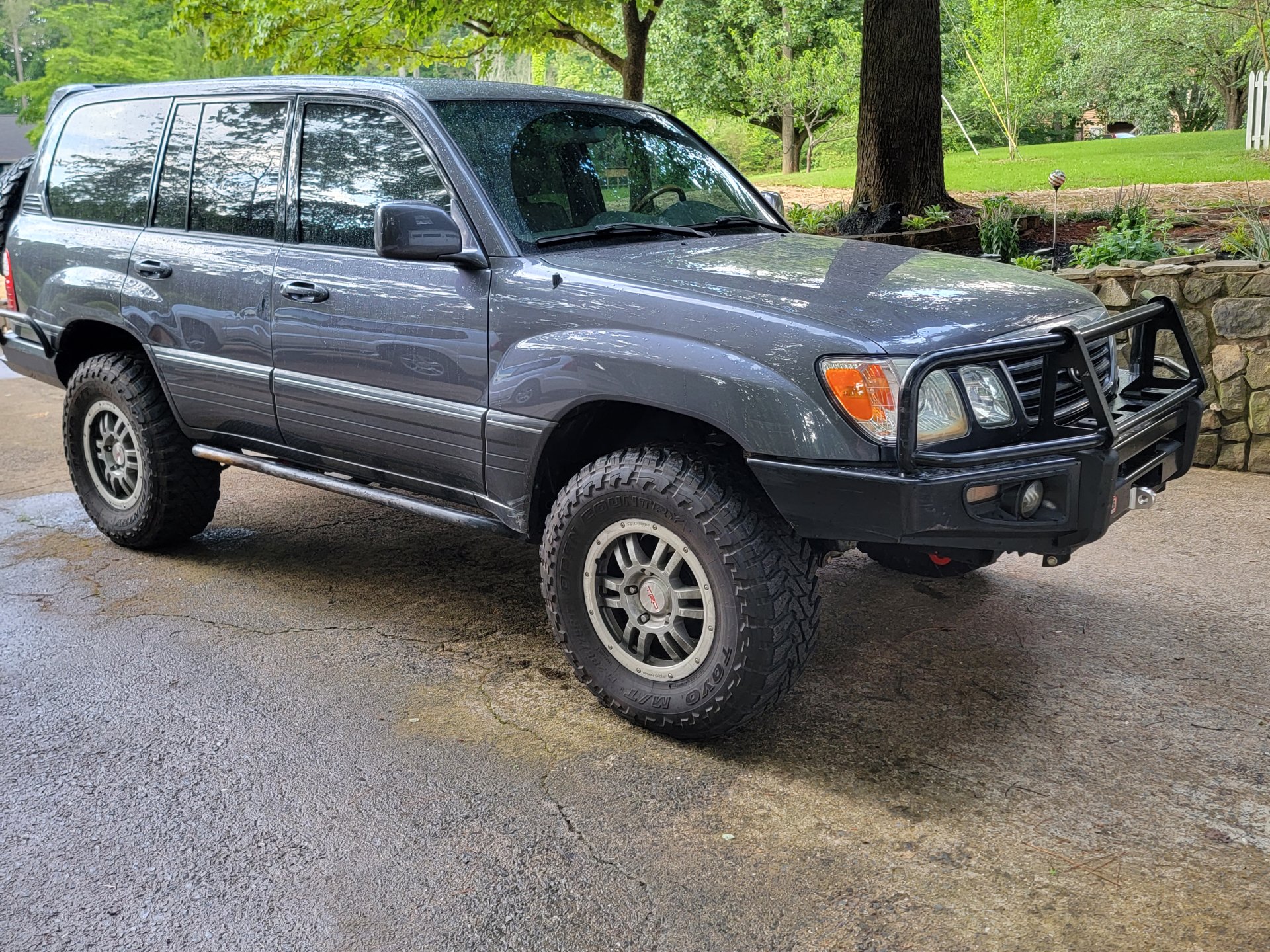

So when you posted earlier about buying 9", I wanted to say that I didn't like how they sat on my ARB front on the Golden. I think for all practical reasons 7" and 9" would put out equivalent amount of light, the 7" just fits better on our bumpers. Mine were Amazon special (Nilight or Auxbeam or somesuch) and came with clear lens covers. I applied a yellow tint sheet to the clear lens and that made a huge improvement in foggy/rainy/snowy conditions. Most cheap LED light emit a blueish white light that doesn't do a great job of illuminating road surfaces and tend to wash out a lot of contrast in the field of vision
This time around, for my "new" truck I chose to go with 8.5" "laser" lights. They are strictly for off road use (aren't they all, being non-DOT approved!). Since I am running an Ironman bumper which doesn't have the additional horizontal bar, the 8.5" fit great. The laser part is great at projecting lights farther than any LED lights I have seen, including some big name/big $$ ones. They also make removable amber covers!
If you are up to spending a little more, I think these CO-Light branded laser lights are a great bang for buck. A few of us here are running them and have been happy with them. Just be careful to not use them when there is traffic because they can seriously blind others!

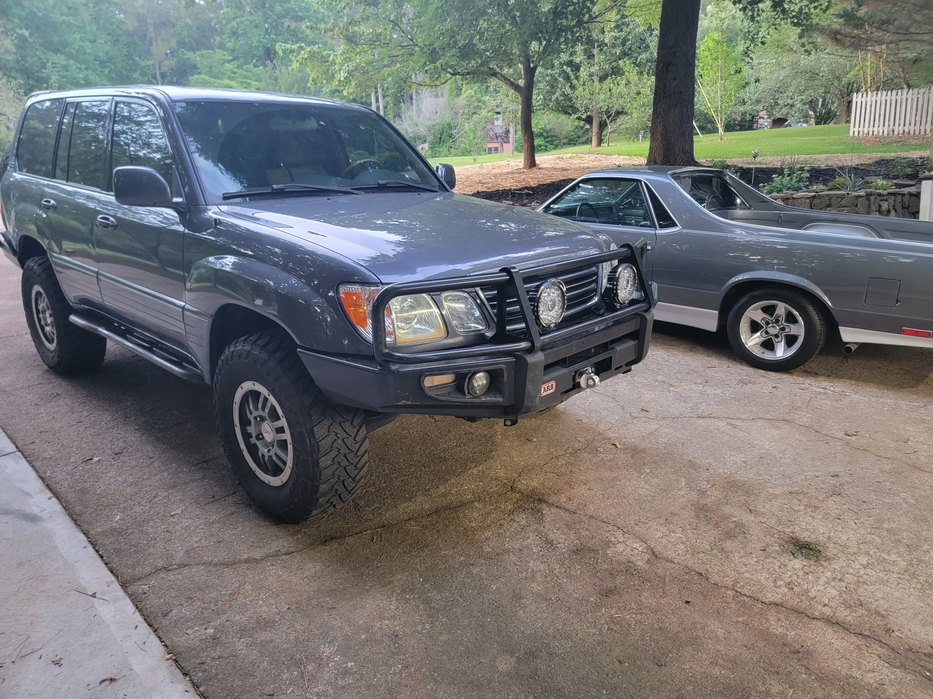

New 7" lights are in and wired up. A 10mm, a 12mm, a 19mm, a crescent, and some zip ties were all that was needed. The provided harness is nice, with a built in relay and fuse. I couldn't find an easy place to screw in the relay with the wiring length given, but I'll get creative in the future. For now it's zip tied to another thick portion of harness behind the battery.
Originally I wanted to wire these directly to the high beams, but ultimately have decided not to. Eventually I will run the switch up to a BenCC button mount in the overhead console. For now I'll just use the provided switch and run it in to the cabin and tuck it somewhere.
