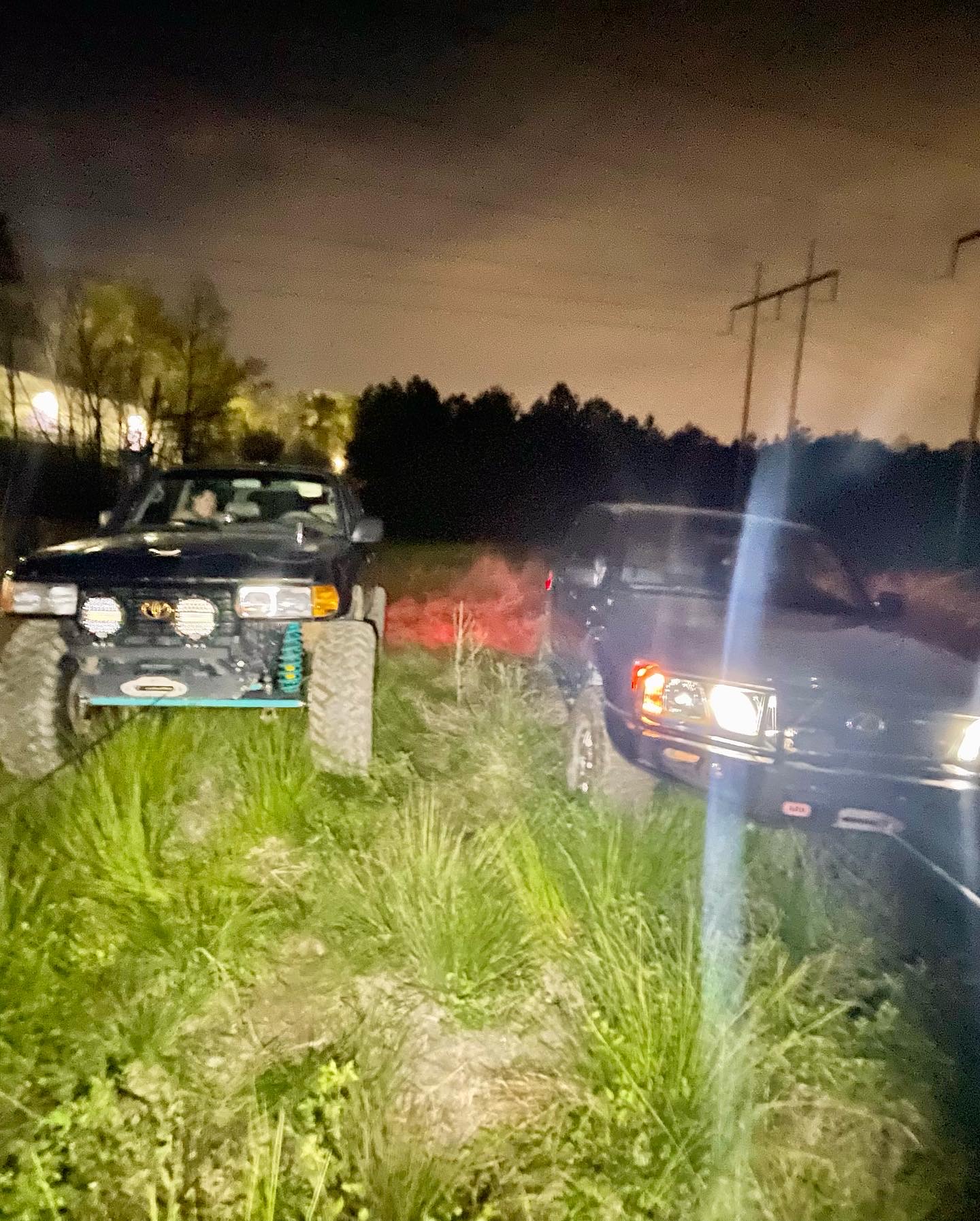

Last Tuesday I get a call from another mudder who got himself stuck in a ditch. No problem, I thought. This'll be easy. Nope. I was wrong. Don't listen to me, I learn lessons the hard way...
My 9500lb winch just didn't have the guts to get him out of the suck-hole he was in, and eventually my line ended up snapping. I couldn't snatch or tow him out because we were driving on a somewhat dry layer of dirt on top of 3 soft' of mud. Check the ruts.
A few hours later we were calling a few other mudders to help us both out of a ditch. Fortunately the Toyota community is ****ing awesome and everyone got home with nothing broken other than ego. @hotdiggitydamn and @Wermz saved the day, ended up requiring 2 winches pulling simultaneously. I won't out the original guy, I'll let @cruiserpatch do that ( :rofl: ) Lessons learned? Don't wheel alone!

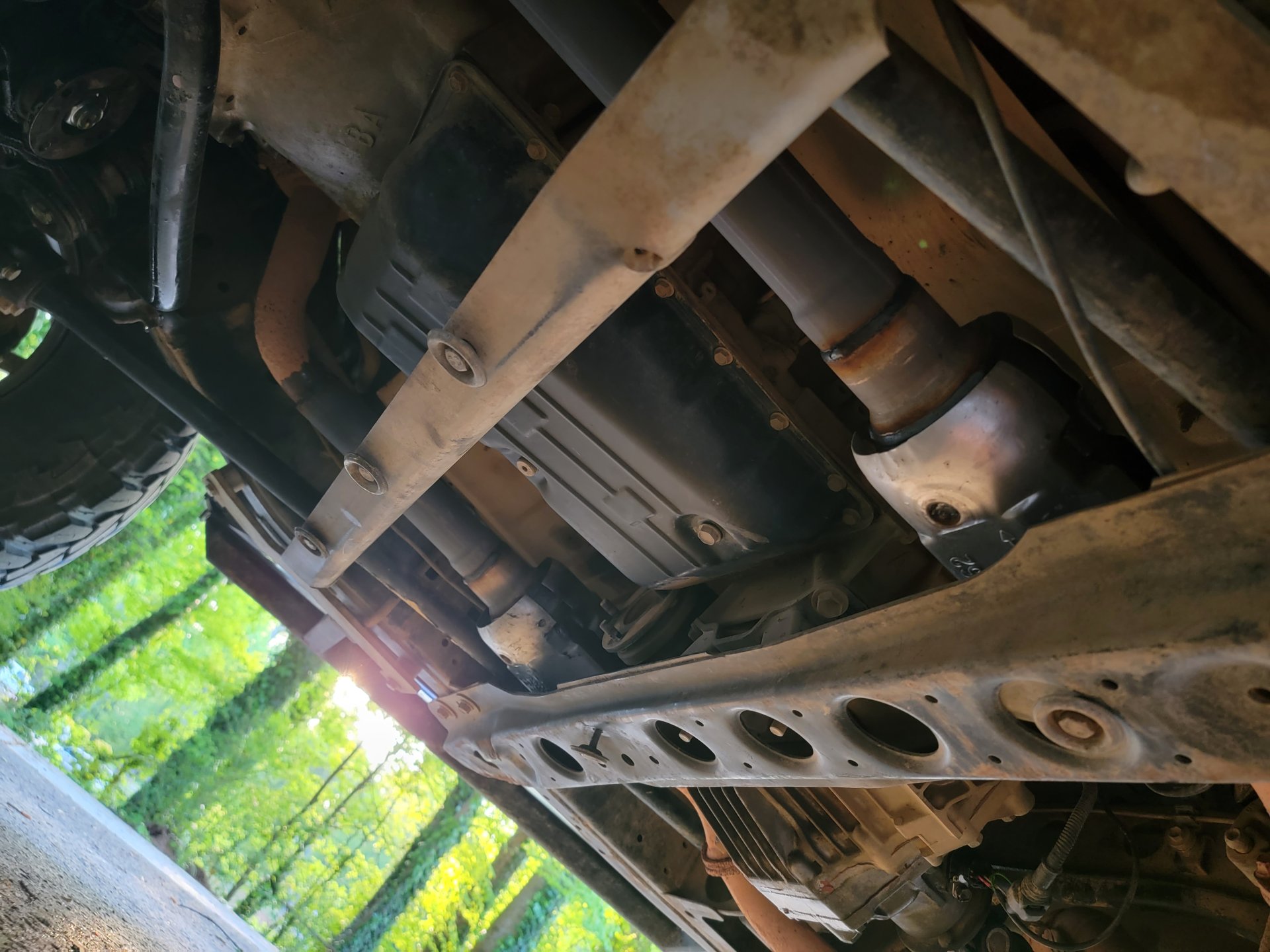

Well the thing was, I had an appointment the following day to have my cats replaced. I'd promised the guy the truck would NOT be caked in mud. So, I got it cleaned up that night, dropped off at 6AM for service.
Ended up replacing both cats as I've been throwing codes on just about every key cycle. It got old. I also replaced all 4 of my 02 sensors with Denso from Rock Auto. FWIW, I paid $1k for both cats installed, and like $130 for all 4 sensors. I noticed a big disparity in numbers when I was searching here, maybe that's helpful to someone.

Yes, mud ain't anyone's friend! Looks like your rope was the weakest link and couldn't bear 9500lbs!
With a stronger rope you can double the pulling force by using a snatch block.
Glad everyone made home.
Truck mired to the frame rails in mud is a force multiplier- like 50% greater load- then the incline out of the hole adds even more + 25% and prob why the line snapped in short order.
Once my winch started to bog down, I pulled out my snatchblock. That was when the line snapped. You can see we improvised with some strap soft shackled to the end of my line. We were able to securely reattach the hook to the line remaining so it wasn't totally worthless.
@Wermz @MongooseGA @hotdiggitydamn
Thanks for the rescue guys. I was in over my head. Owe you all big time. Certainly learned some "pointed" lessons, haha.
Especially you, G.A. You put your neck out there for me and lost some sleep because of it. Much appreciation, fellas.

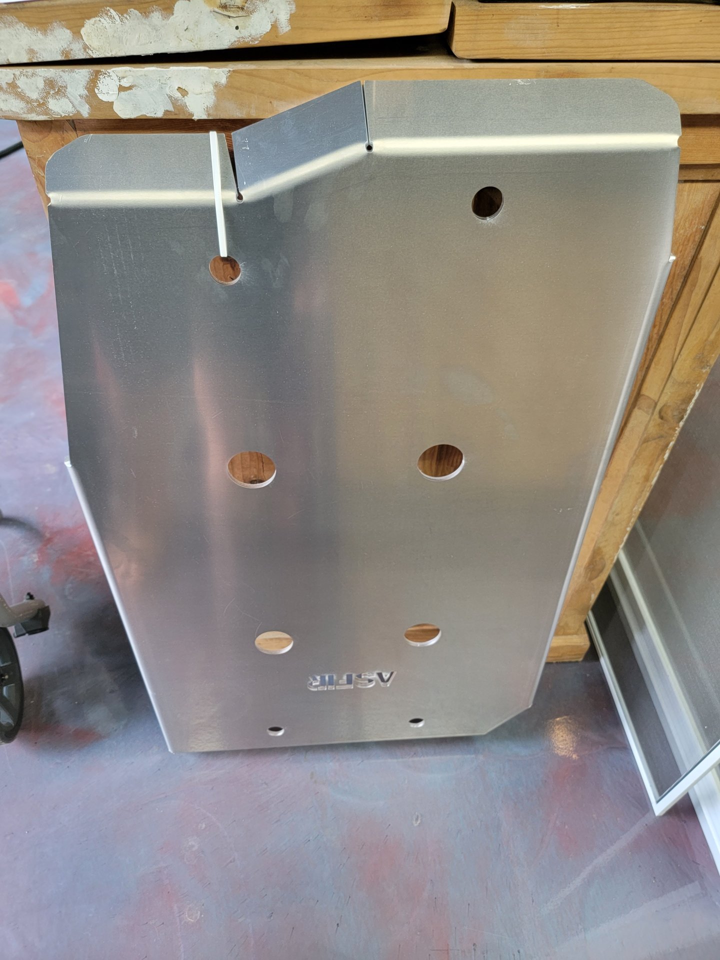

Found a good deal on a used fuel tank thanks to @YezusLX down in Florida. Finally, I'll be able to replace the concave one in the truck now. I suspect that the dent is good for about 50 miles on each tank.
After I ordered the new tank, I decided it was a good time to open up my @ASFIR 4X4 fuel tank skid. It looks like jewelry. Can't wait to get it on!
