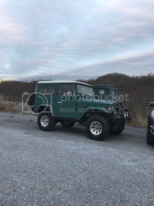

This is how it starts. Just a picture:
Nice! Congratulations
Gerold was owned by a friend of my brother's. The engine was rebuilt in 2012 along with the front and rear end. The ARB lockers were installed then also. The engine has less than 100 miles on it, and is getting water in the oil. The PO got fed up with it and his wife told him to get rid of it. This is where I come in. I have a yellow FJ40 sitting in my back yard that belongs to a friend of mine that I will be rebuilding for him. This is why I got the text message (or my wifegotit first). He priced it and. I could not pass it up. This is the second 40 that I have owned. More on that at a later date.

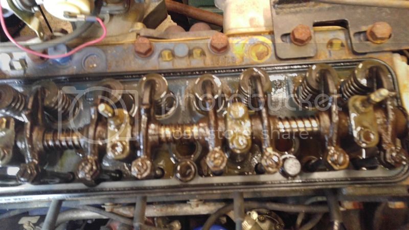

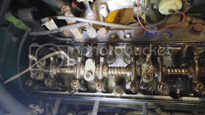

My plan was to pull the valve cover first and then do a compression check on it. If the problem is not found under the valve cover I will have to go deeper.

It's a long shot....but were the head bolts re-torqued after the engine was initially warmed up the first time. FSM says they should be
There is a chance that they were not. I will check the torque on them before I take the head off. I got a coolant system pressure tester and put 15 lbs on the system. It may have dropped 1lb in the hour that I had the pressure on it. When I pulled the plugs all were black (rich mixture) and none indicated coolant leaking into the cylinder.
