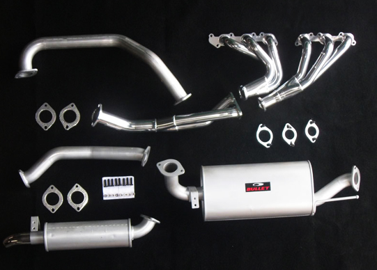

I was just looking around for systems and the Bullet system looks interesting. Looks like its more a late 80 or 100 system as that image looks like it runs inside the chassis... I do like the twin header system though...
I'm not sure about the large rear muffler also as I'm running a LongRanger fuel tank... I don't think there is allot or space under there.
Post a link for this ad?
Its got to many shsrp bends for my liking, but without seeing the whole system laid out, hard to tell
All 80s had the exhaust cross over the frame rail, and back again.
105s it runs inside the frame. Theres some differences in the exhaust hanger brackets on the chassis between 80 and 105
