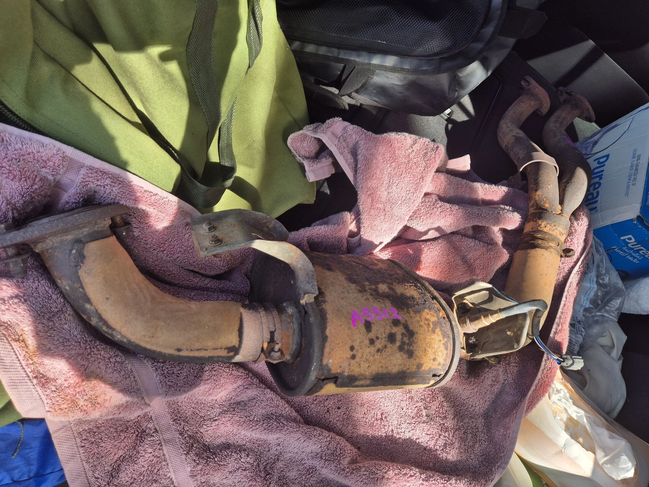

Hey Eric,
I'm facing the same issue as you, and had the exact same question regarding the part numbers. I too have a 94 model, so while is says 17410-66010 is NLA, I saw pics of the 17410-61261 and they look identical... at least from what I can tell.. I cannot see why this wouldn't fit, and trying to work out what the difference is without having the pipe in front of me is challenging. What did you end up doing to solve this? I used an aftermarket from pipe replacement and the alignment is crap and it leaks.

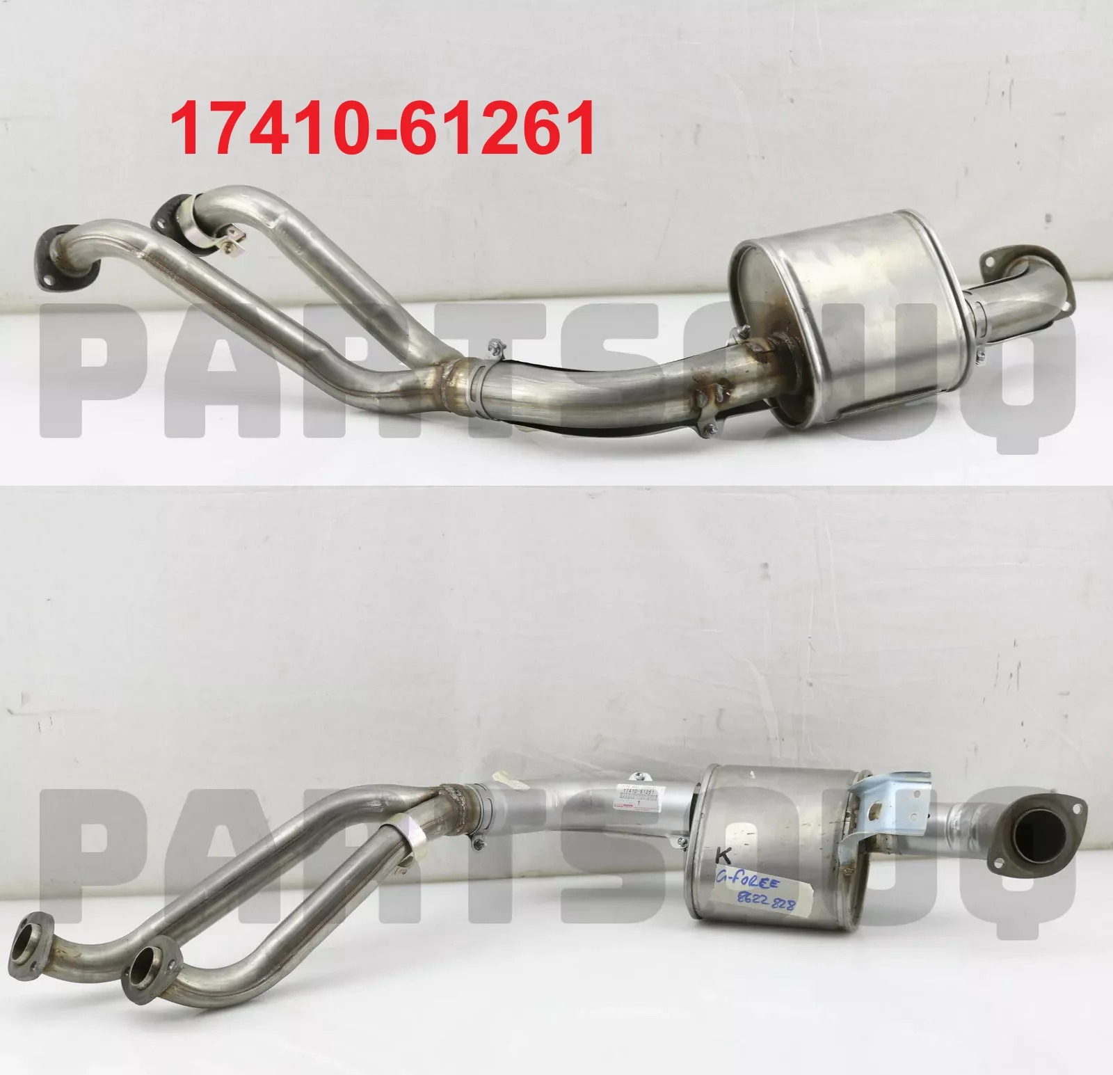

FYI, here is a pic of the 17410-61261 model:
and a pic of an original 17410-66010. The only differences I can see is the o2 sensor shield and flange and it looks like the pipe for the newer model is stainless vs mild steel for ours. So basically you could use the newer pipe, but you'll need to get an o2 bung welded in.
I've just noticed the difference. There is no o2 sensor mount in the 17410-61261 model.

spoke to Toyota this morning, they can get the 95 to 99 pipe for $730 ex Japan. My parts guy agrees that there's a high likelihood they will fit.. you'll just need to get an o2 sensor bung welded in.
