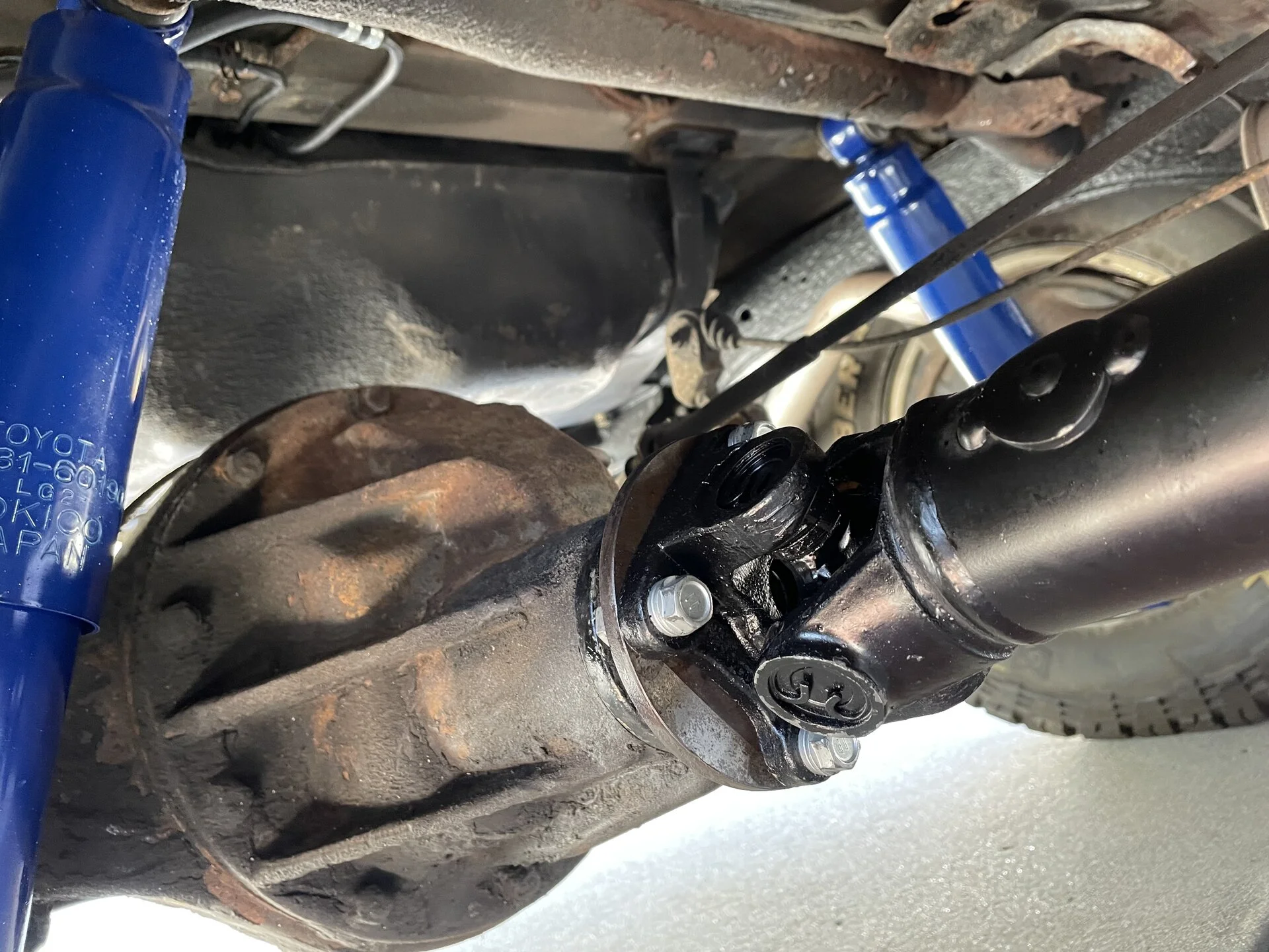

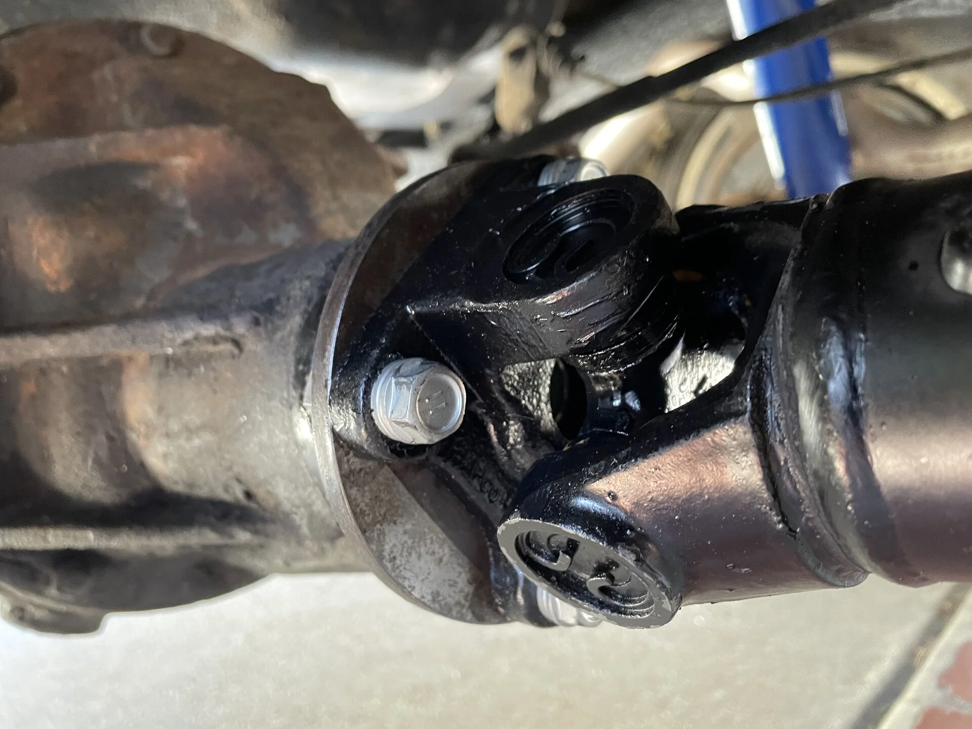

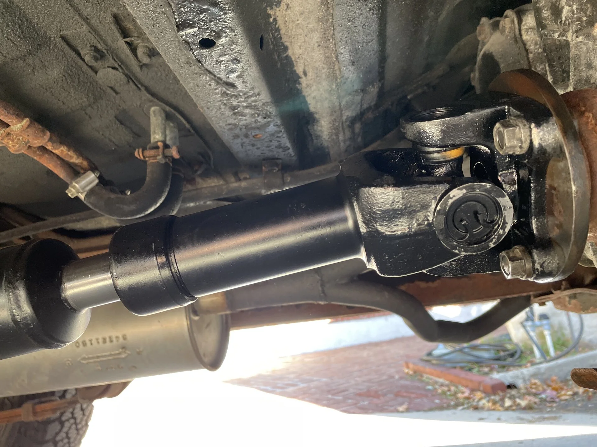

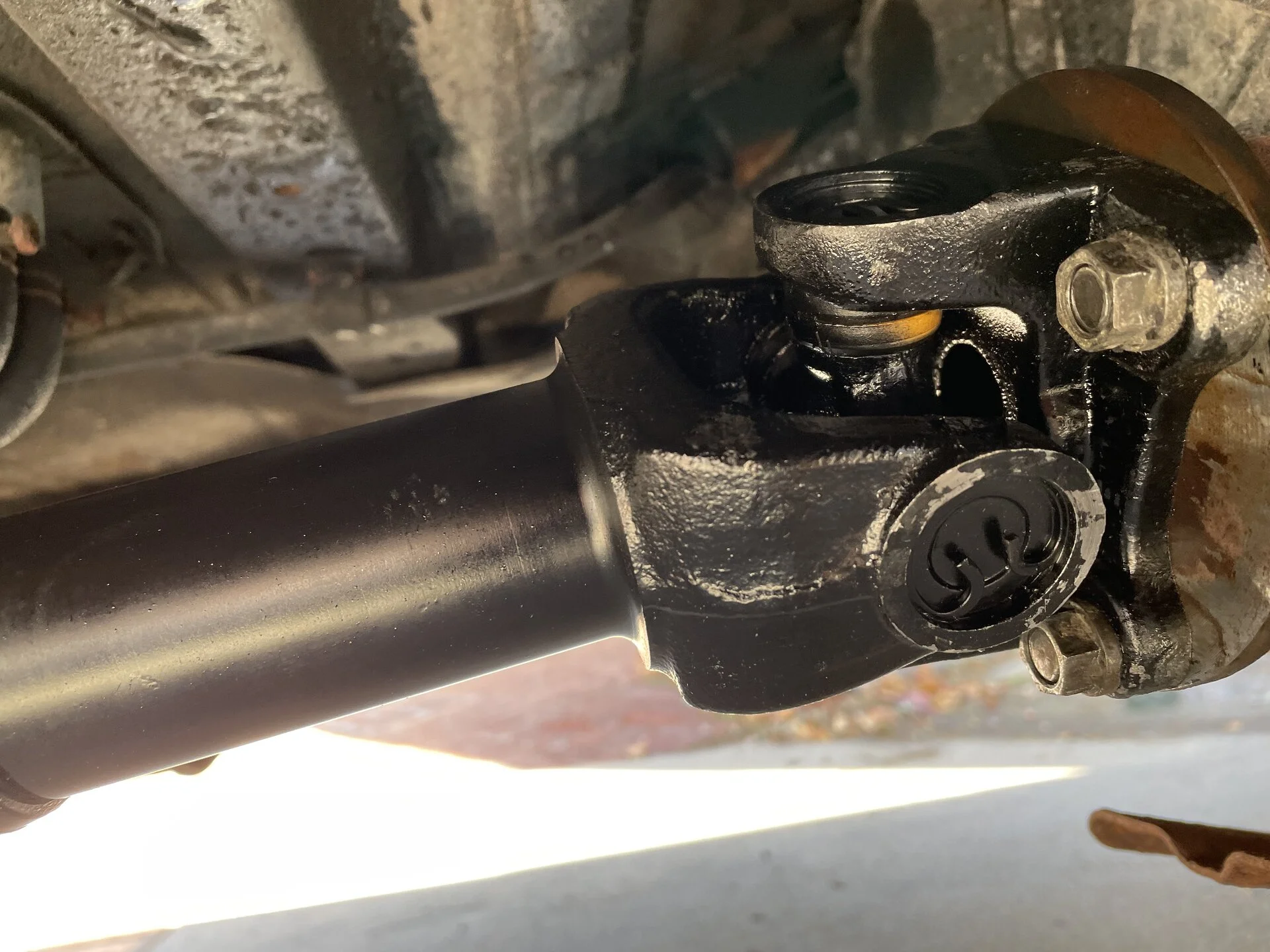

The slip yoke is way beefier than stock. And unlike my rusty pos, it actually moves! I'll get under there with the phone tomorrow and post up more photos.
More glamour shots including some photos of the rear shocks. Makes everything else under there look like trash..
Did you order something specific off the Wood's website or did you call and order to a custom spec?
I used their online form. Wood's puts together a set of general spec's for conventional rear LC driveshafts, but then you need to provide them with a flange-to-flange length, bolt pattern at both ends, and bolt hole size at both ends. There are also a couple of options of joint types and wall thicknesses. I just went with as close to stock replacement as they have, but I'd say that these U-joints are probably much easier to repair than Toyota OEM.
Before I pulled the original one from the rig, I got lazy and called them to see if there was just one set of specs for the 62, but unfortunately there just isn't and to their credit they really prompted me to pull it and measure properly. Perfect fitment as you can see.
There are a TON of options on their site, though. And it looks like they can build just about anything you could want for any application.

$450ish including the ride. Not super cheap but reasonable given the quality, imo. Repair was estimated at a little more than half that, with no guarantee that the slip yoke wasn’t already beyond repair.

So couple of things. The new DS is awesome, and it cleared up a good amount of my rumble at speed, but it's still there off-throttle until the engine starts braking against the wheels. The rest of the time it seems a little vibrate-y at highway speeds. I purchased a new-to-me third from @65swb45 Mark earlier this week, and after cleaning off the gasket surface am planning to install that on the rig after the holiday. That should be fun. Spent a good 45 minutes hanging out with Mark in front of the shop with my son, dodging raindrops and sharing stories gathered around the Karma Cruiser... maybe once the daily driver BMW sells, we'll see...

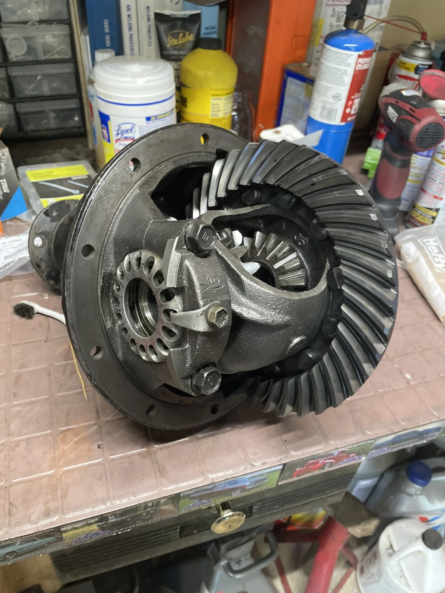

First some glamour shots of the new rear diff. This is actually a front FJ62 differential that Mark @65swb45 picked up on a road trip in the Karma Cruiser. This diff made the trip back from Idaho (Montana?) and was in the shop with a tag just waiting for me to call. Felt lucky to pick this up!

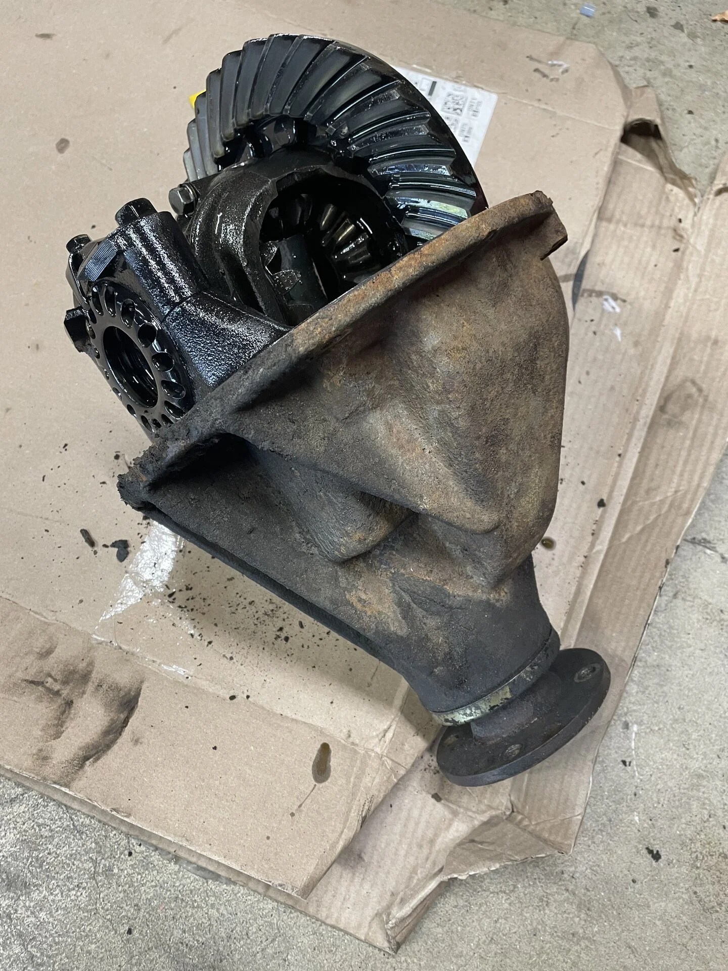

And here's the old one, fresh off the rig. It doesn't look awful, and truth is it probably isn't, except for one thing.

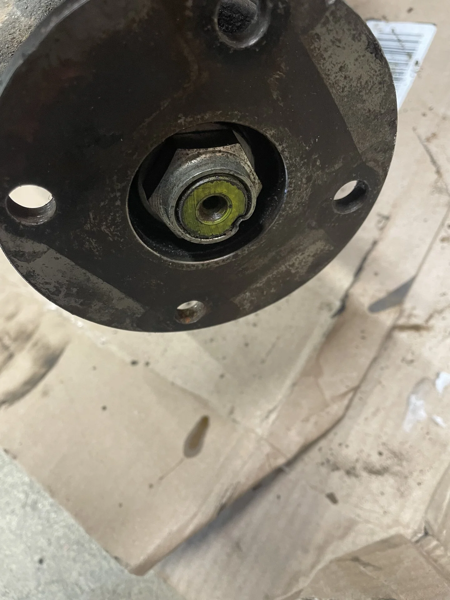

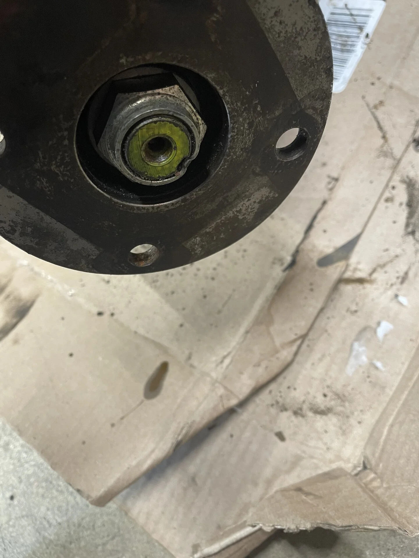

Check out the pinion flange nut at the stake point in this photo:
And compare to this one. It shouldn't move like this. It wasn't even finger tight, and the only thing holding it on was the stake. 😬
I was able to get it all back together, with new gaskets and the axles both reinstalled, in just a few hours. Then, when I went to install the pinion spacer block, it wouldn't fit in the space between the axle ends. It wouldn't even go in - it was just too big. Doing some research in the FSM showed that back in the day, Toyota made multiple widths of the block, and that if the spacing wasn't to spec, to use a smaller or larger block. Mine happened to be 29.8mm, and measuring the space between the axle ends, there was only about 29.4mm of space. They did make a 29.4mm version of the block, along with larger and smaller sizes, but the only one that you can find new is the 29.8mm version that I have now. Damn. And the car is on jack stands in the middle of the garage so I have enough clearance to pull out the long axle shaft, with the BMW 2002 sitting outside, and I need to have it back by eod on Friday to make sure it doesn't get rained on.

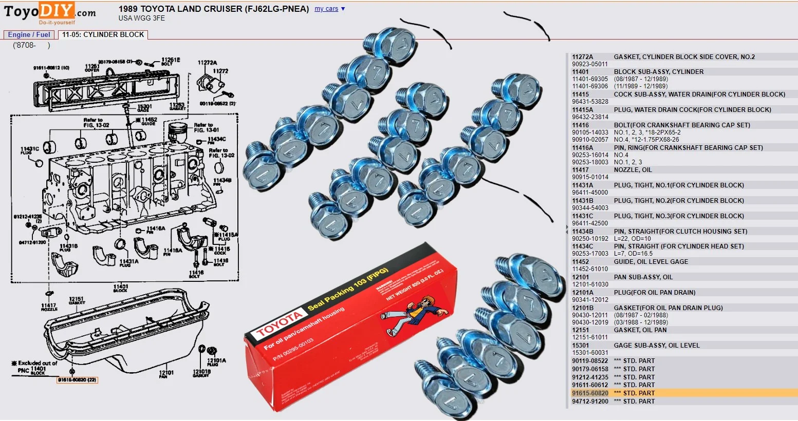

at the end of the day John , your FJ62LG-PNEA & it's qty x 22pcs + 2 spares = 24pcs OEM SEMS hex head JIS 's will be happier too .....:D

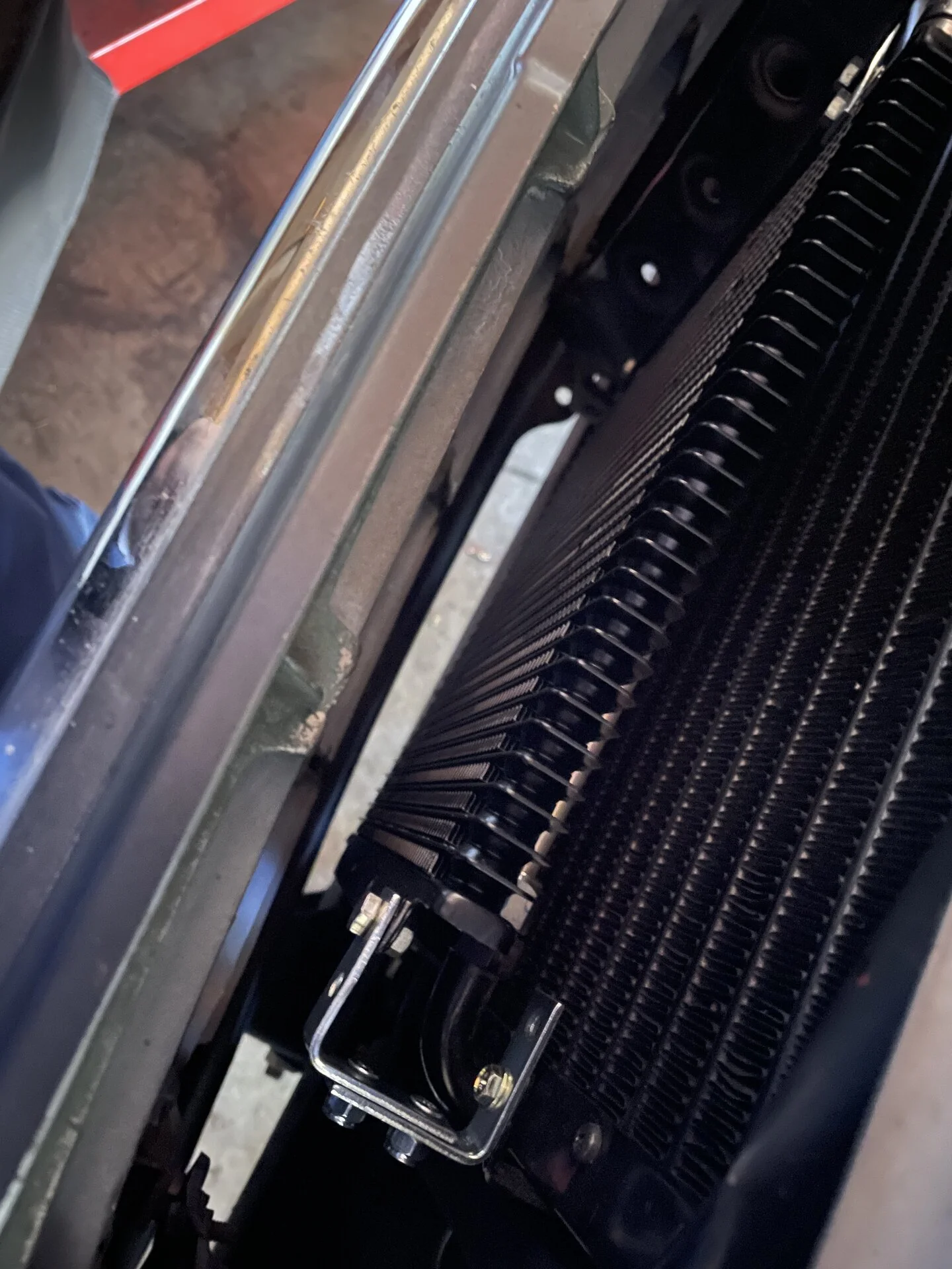

Finished up the external transmission cooler installation this morning. Some tech photos for your viewing pleasure. I followed this procedure, which made it really easy to follow where everything goes. All in, this is not a difficult job, but YMMV depending on your rig. I had the pleasure of finding my PO's mechanic had routed the return line for the condenser across the front of the rig, which is exactly where you want to mount the trans cooler. No matter, some bracket and hackery from Ace Hardware and we were all set.

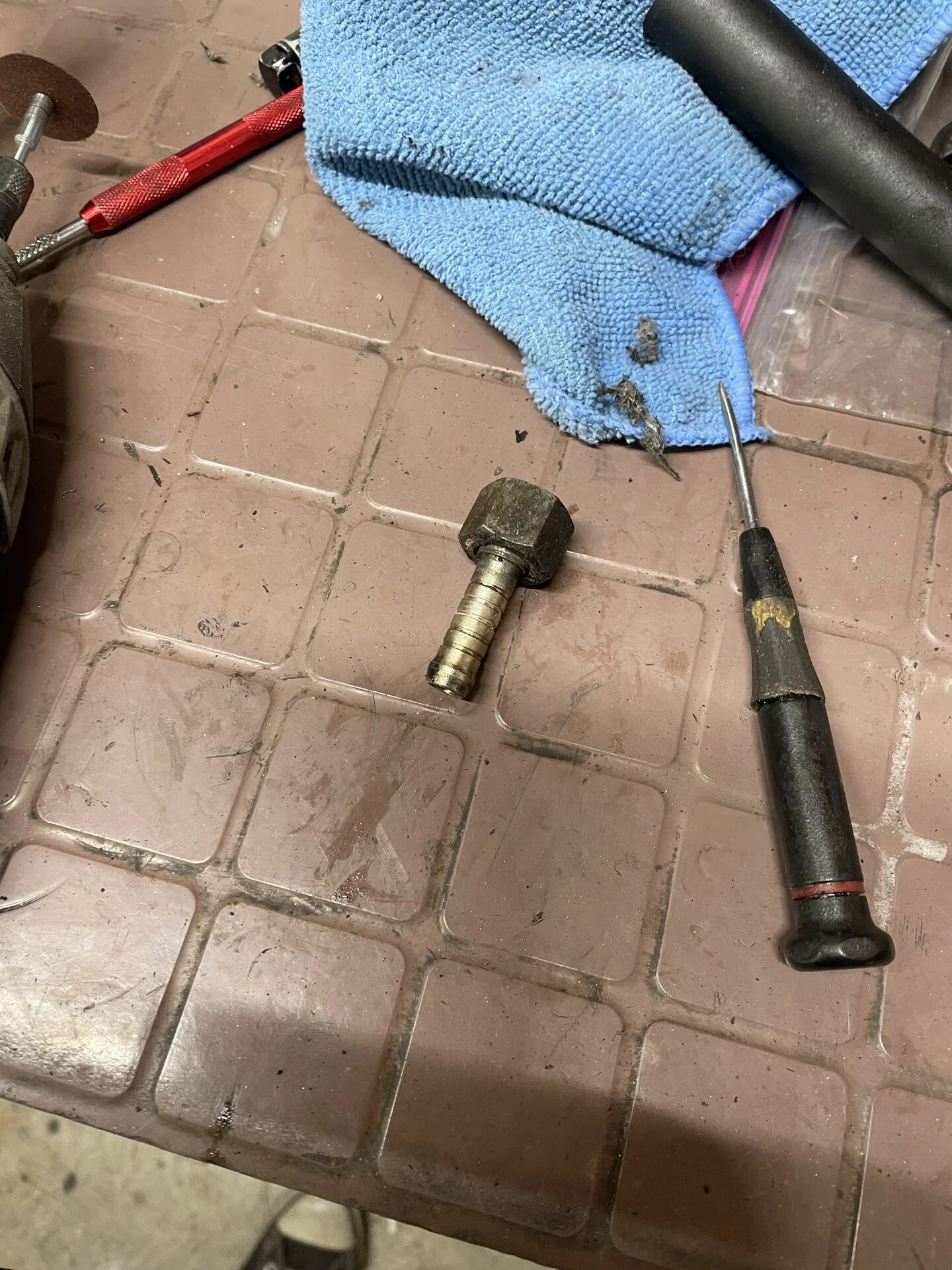

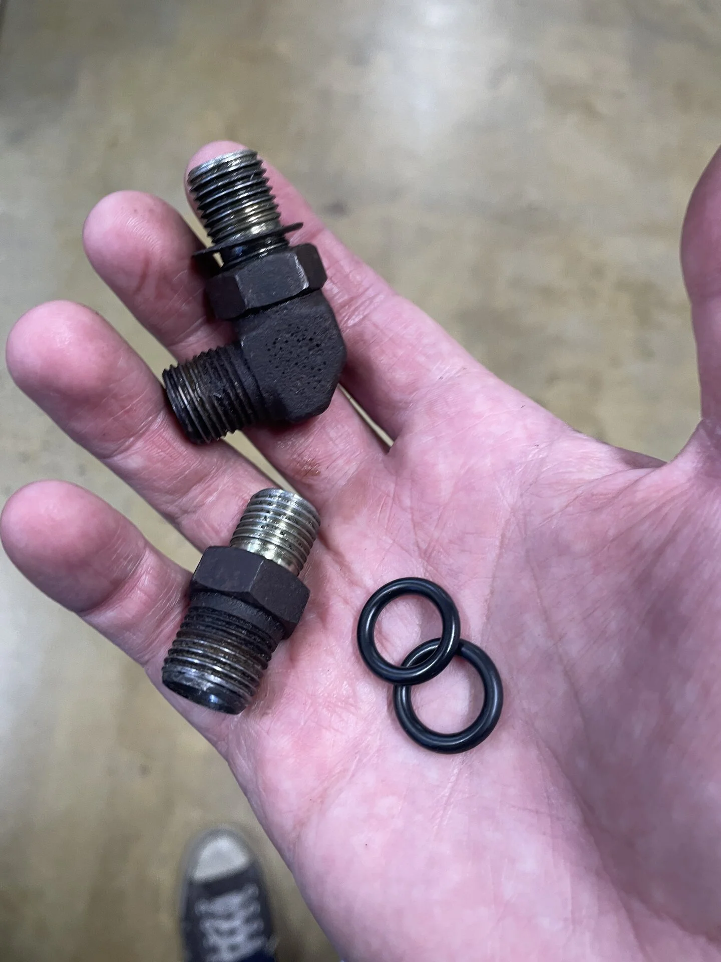

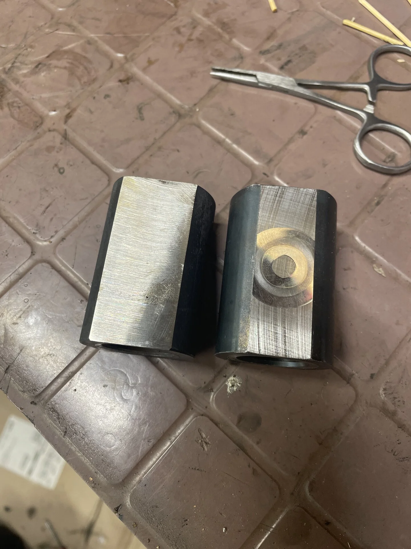

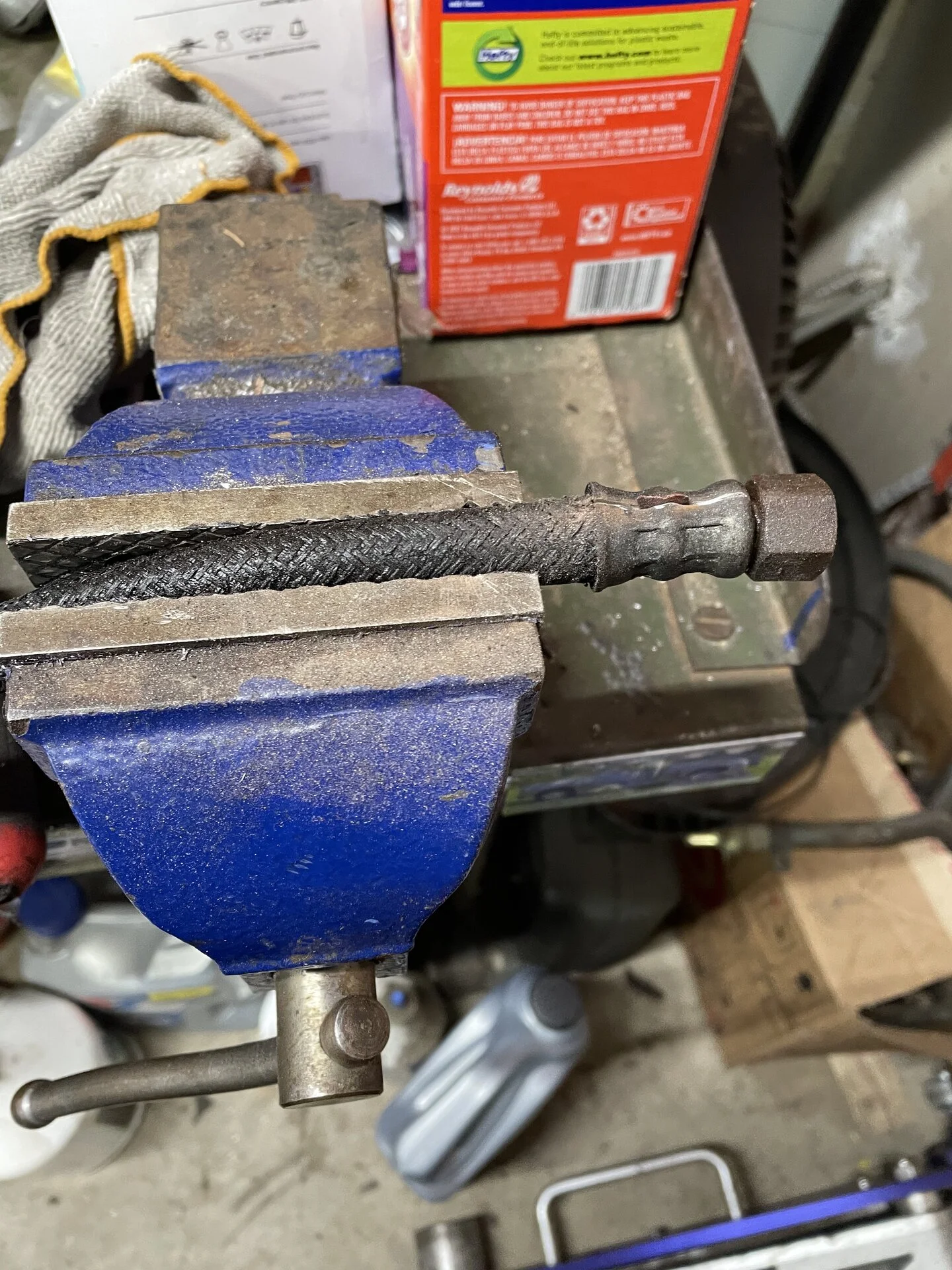

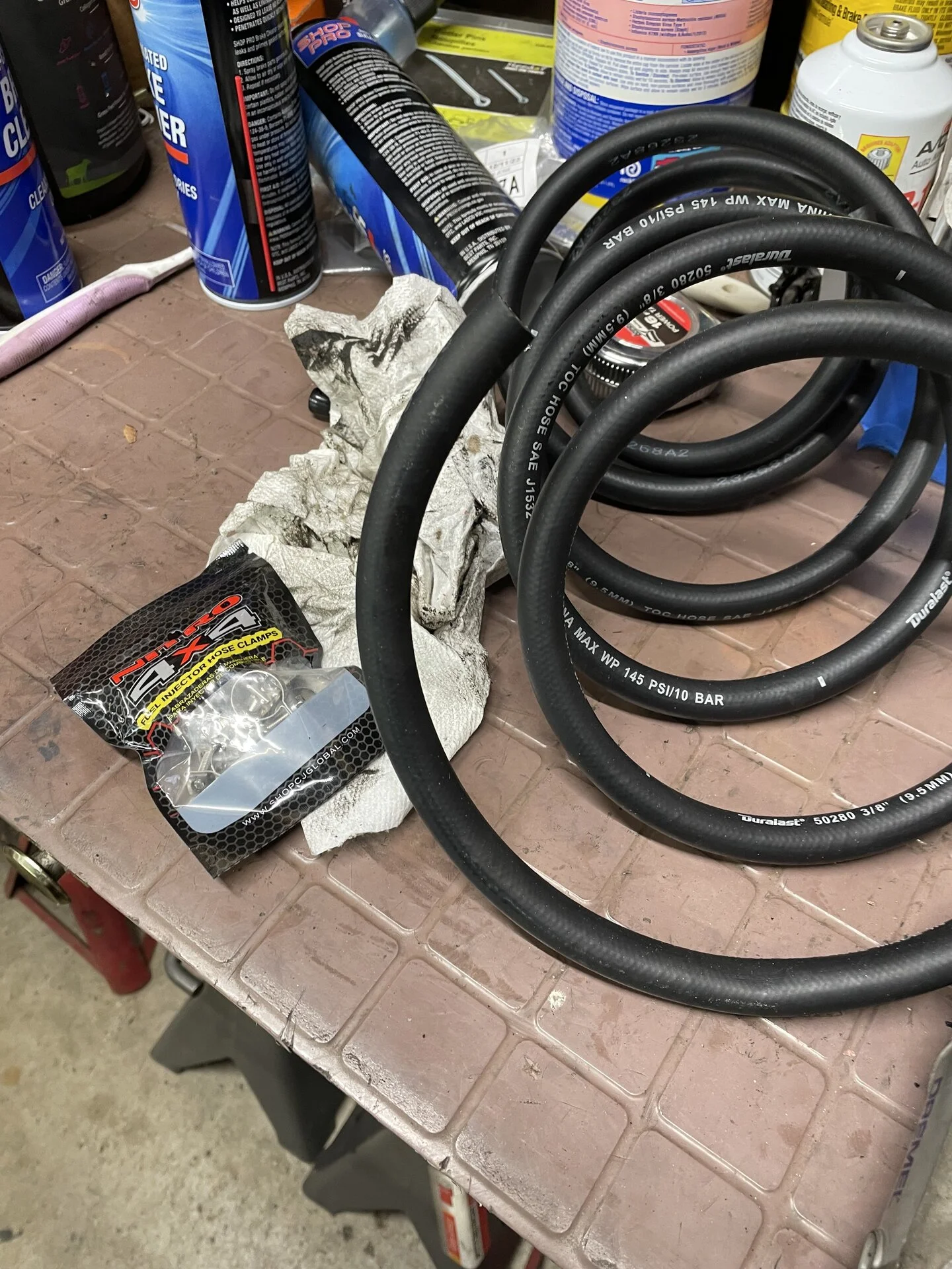

First up is to pull the crimps off the ends of that short return line off the passenger side of the radiator. Mid-Dremel, at least 4 non-reinforced cutting wheels were sacrificed in bringing you this photo. Note that it is lodged in the crimp below...
What isn't obvious from the procedure is what you find when you cut through those crimped connections. Maybe this is obvious to everyone else, but I was kind of at a loss at first. Here's the piece of the fitting you are interested in, DO NOT cut through the hose when Dremeling through the crimp!
Got 10 feet of 3/8 inner diameter trans fluid hose, of course I got the end of the roll from Autozone which made it that much harder to route in tight spaces in the front of the rig. I ended up needing about 9.5' of it.
The rest of the install is documented in the thread I linked to above. Here's what mine looked like finally installed, this is the Hayden 11"x11".
That U-shaped bracket on the driver's side is two angle brackets bolted together with some locknuts. It's attached to the aftermarket condenser on a mount that was just open and hanging out there. I routed the hoses through the firewall in a hole that is behind the driver's side high-beam and under the battery tray. This made it really difficult to find the ends of the hoses, since you're reaching under there blind. I also encased the hose in a protective outer hose / foam that I had left over from when I replaced the interior heater hoses in the FJ40, only in the portion that runs through the firewall, to keep sharp edges from rubbing the hoses.
Anyway, that's done. Now off to Wally-world to buy more oil and more ATF for next week's flushing adventures.

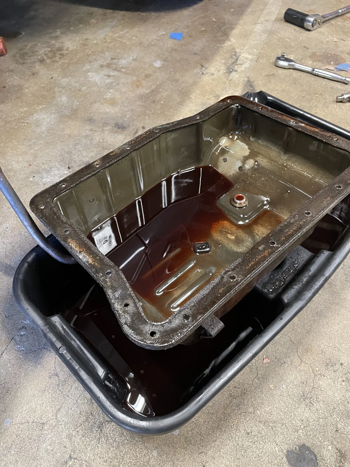

Got after the transmission pan gasket and Rodney flush, along with the oil pan gasket earlier today. Was moving sort of slow today, as I've never done a transmission flush, but ultimately this is a 1-:banana: job that just requires a lot of fresh ATF.
First pulling the trans pan. This didn't seem too horrible, and there weren't a lot of big chunks in the screen, just a fair amount of this silty gray matter that is probably the innards of my transmission. It seemed like someone had been on this before, but probably a long time ago. There was basically no torque on one of the bolts near the rear of the pan, which is where my leak was coming from.

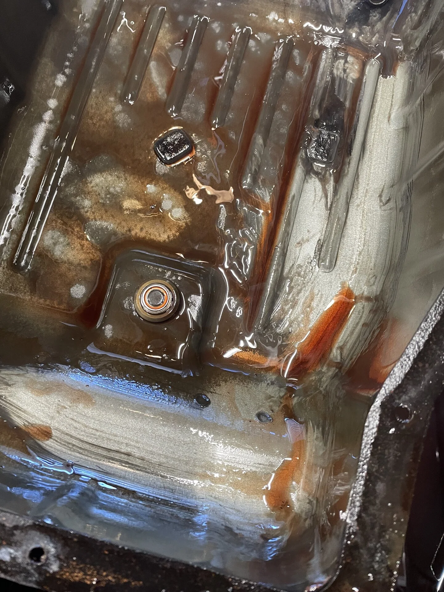

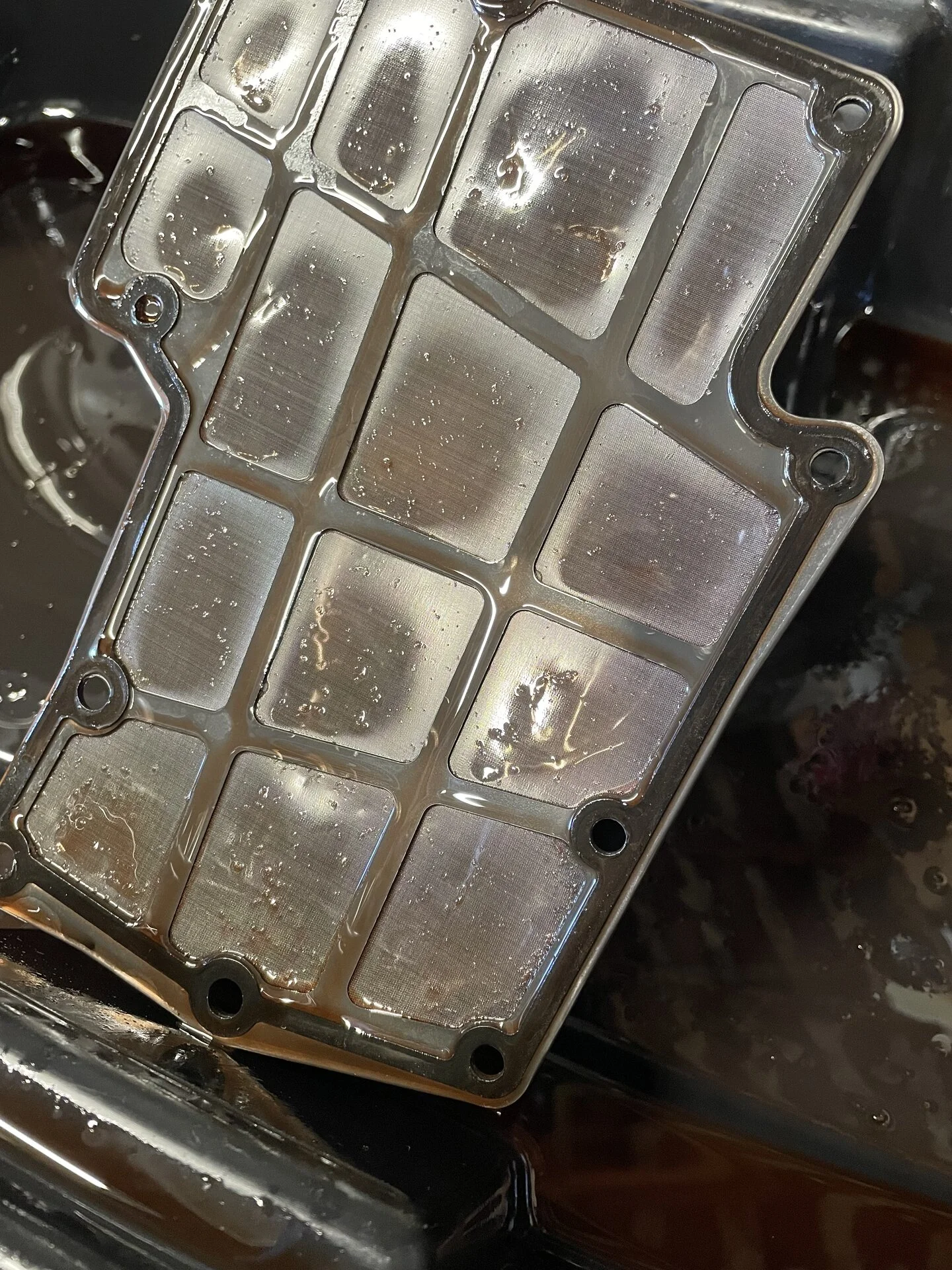

Here's a look at that silty stuff I was talking about. This cleaned up with some brake cleaner and paper towels. The magnets weren't too loaded down with swarf, just about what I'd expect from a trans flush that hadn't been done in a while.
And a look at the screen. There was very little chunkiness inside here, I just cleaned and reinstalled.

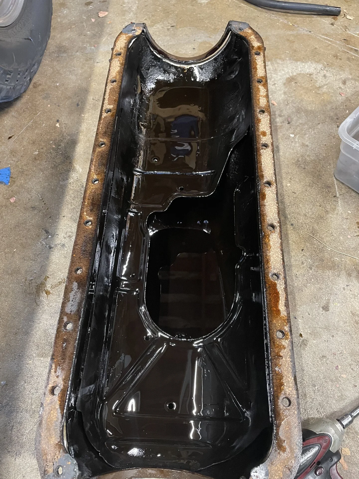

Next was the oil pan gasket, which seemed to be making itself look like a RMS leak. I had the same issue with the FJ40, pulled the trans and transfer case only to find a perfectly good RMS and watch the oil seep out of the readily accessible rear arch. This time, I'm sure it'll be the RMS after I get done. :rolleyes:
Again, someone's been on this before, the gasket surface on the pan was pretty clean, but it looks like they didn't dimple the oil pan and they used just a smear of gray RTV instead of FIPG. And no idea of this was an OEM gasket. It doesn't look horrible, though.
The bottom end looked ok, but kind of carbon'd up. This isn't a total surprise given what I found on the top end, and am trying to think of reasons why it's done this. Maybe bad valve seals allowing a lot of blow-by? Rings? Just old?
I started removal, cleaned and dimpled the pan, replaced the oil filter, and will get back under the rig tomorrow with some Fel-Pro snap ups, FIPG and bolting it all up. Right now it's just sitting with a bunch of drip pans and cardboard to catch any junk that drips down overnight.
