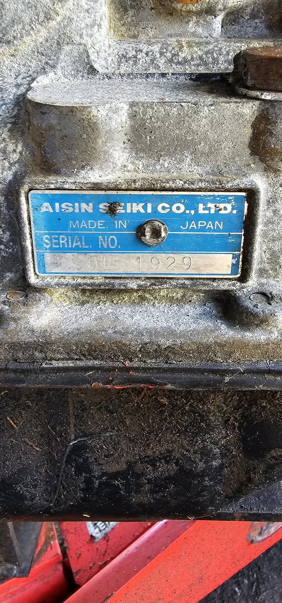

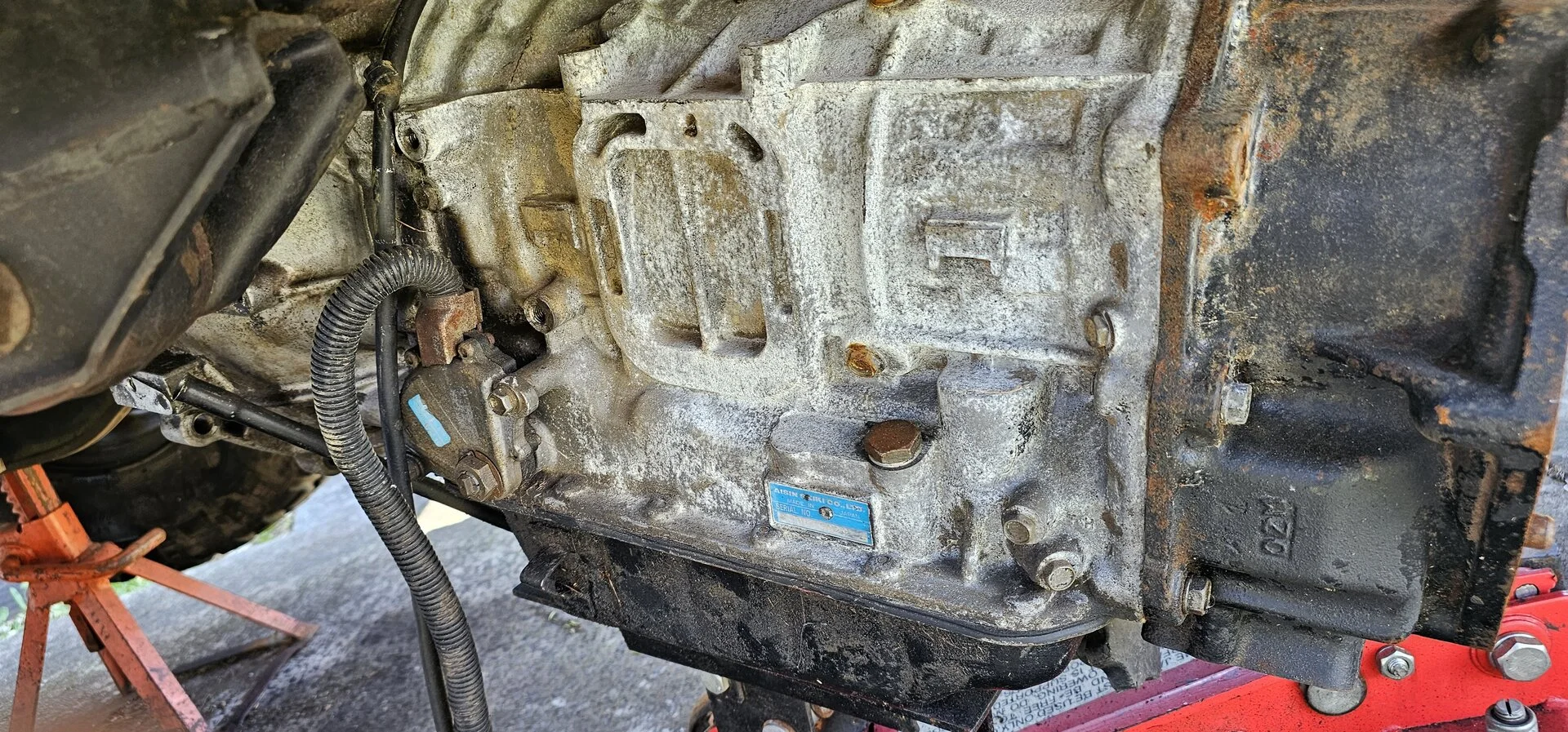

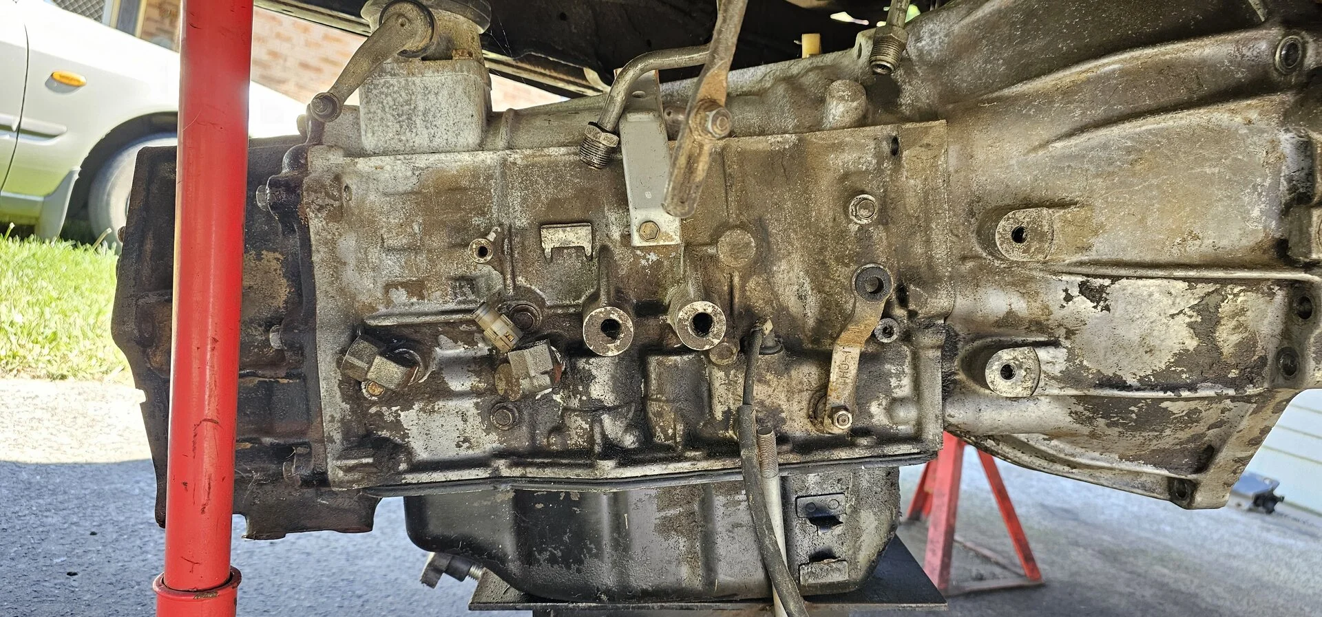

C cowboycoolwhip Joined Oct 13, 2023 Threads 1 Messages 1 Location australia Oct 13, 2023 #1 i need parts so any help would be amazing cheers!
baldilocks Battle Ground, WA GOLD Star 10 Year Joined Jan 29, 2014 Threads 212 Messages 10,035 Location Battle Ground Oct 13, 2023 #2 That would have to be a hydraulically controlled A440 due to the fact that there exists no wire harness connection like the A442 has from the TCM to the transmission solenoids. Upvote 0 Downvote
