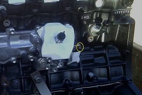

Thanks for the information, you guys. This swap was performed by a reputable shop in Washington State. But, I'll ask for a verification, just in case. I got this picture from the previous owner. I can't see the "HD number" on it. From the shape, can you guys tell if it's a genuine 1HD-T?
You can't tell from the outside except for the stamping on the block. If the swap was performed by Torfab, I'm sure it's all in order.
Yeah, that's who did the swap. Tor told me it was a 1HD-T and had a grunter on it. The rig is all the way across the country from me, so it's hard to get more detailed info right now.

1hz and 1hdt have different style injectors. 1hdt injectors are clamped in, 1hz bolt in. You can see the 1hdt injectors and injector hold down clamps in one of the pics above.
Also, the IP has a boost compensator on it (not that that identifies the engine type )
Besides the stamp you could tell by looking at the turbo oil return and the bolt for the turbo stay. If they are drilled and tapped into a boss, it's a 1HZ block. The factory return is sharply ground and completely flat around the bolt-hole.
The head is undoubtedly a 1HD head-very different from the 1HZ one. But it could still be bolted to a modified 1HZ block.
I was operating under the assumption that it was at the very least a 1HD-T head/manifolds/injectors, etc. No arguments on anything you've said here though.
Yep, true.
Block is essentially the same the crank is the same. About the only difference in the blocks is oil gallery drilled and tapped for turbo oil feed.
The crank cradle is also drilled and tapped for turbo oil return.
