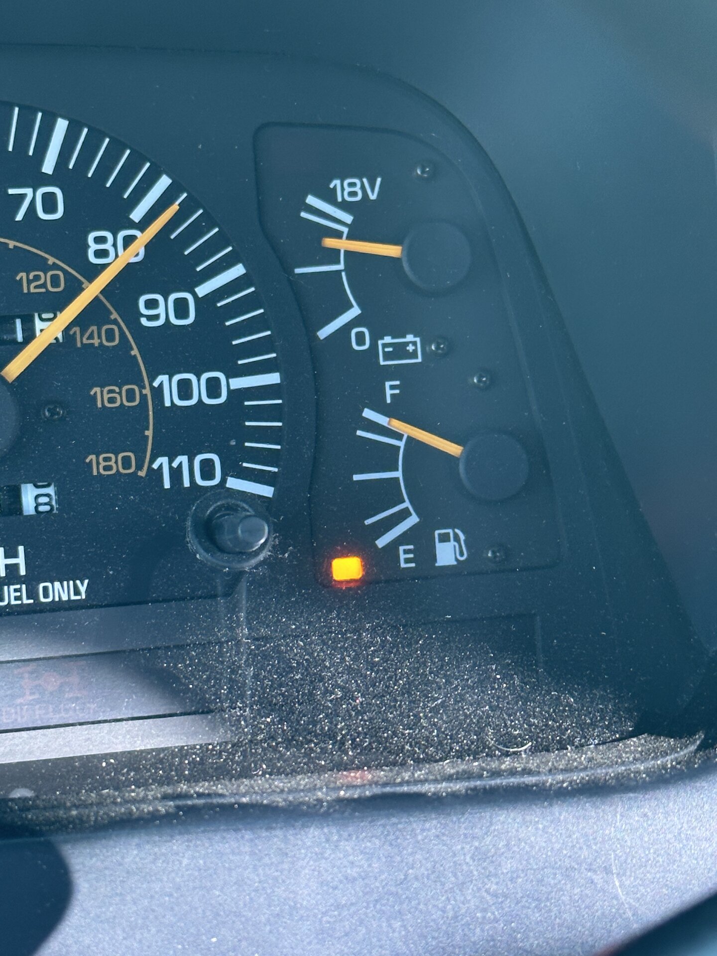

Hey all,
I have a problem with my gas gauge staying stuck at full after a fill up until some inconsistent amount of time when it finally reads correct. As of now, I have done 195 miles on a tank and it says i still have a full tank of gas. I replaced the sending unit in the gas tank and it solved a different problem I had where the low fuel light wasn't working, but the gauge still gets stuck. Sometimes it's stuck for 30 miles, sometimes it's stuck for 195+ like right now. All I can think of is that it's the gauge itself or some funny electrical mystery. Any thoughts?

I'm not sure if it's electrical because I would expect more of an intermittent issue that way.
When i fill up, the gauge needle gets stuck at full for any amount of miles. Once it decides to drop down, it continues going down normally and reads accurately until i do a full fill up again, at which point it is then stuck at Full. It almost makes me think that the gauge just gets stuck once it's at full and it takes just the right road bump to drop it down.... that might be crazy though.
Last time it was stuck at full until 200 miles at which point it dropped to 1/4 tank, and this time it was stuck at full until 140 miles at which point it dropped to 1/2 tank.
There has been a couple of times that the gas gauge got "un-stuck" pretty early into a full fill up, but once i drove up a hill which caused the gauge to read higher than normal (because of fuel slosh, etc.) it gets stuck there again after the hill.

Funny update. Did 500+ miles of driving today, all highway. I believe because there was no city driving behavior and rough road conditions that come with the city, the gas gauge did not drop at all after a fill up, two times. I only knew when to start worrying when the light came on... when the needle showed full. So the sender is definitely working!
well...
not necessarily. The circuit for the light is different than the circuit for the sending of the fuel level. It would/could be very possible that the float is stuck at a "full" level. Of course, it could be the gauge, etc.
Now that's odd, my gas gauge never wants to stay at full even after after a fill up, and after about 40 miles of driving it seems to want to race to empty
Then at 150 miles it's just a tick above empty and stays there until the low fuel light come on
What happens if you only fill to approximately 3/4 tank? Does the gauge still go to full and exhibit the same issues?
Excellent suggestion. If it does stay stuck at 3/4 then I'm voting for the float arm rubbing/sticking on something.
If not :deadhorse: :bang:
I don't know when the next time i'll be able to test that will be. It's been stuck at full for the last 800 miles.
