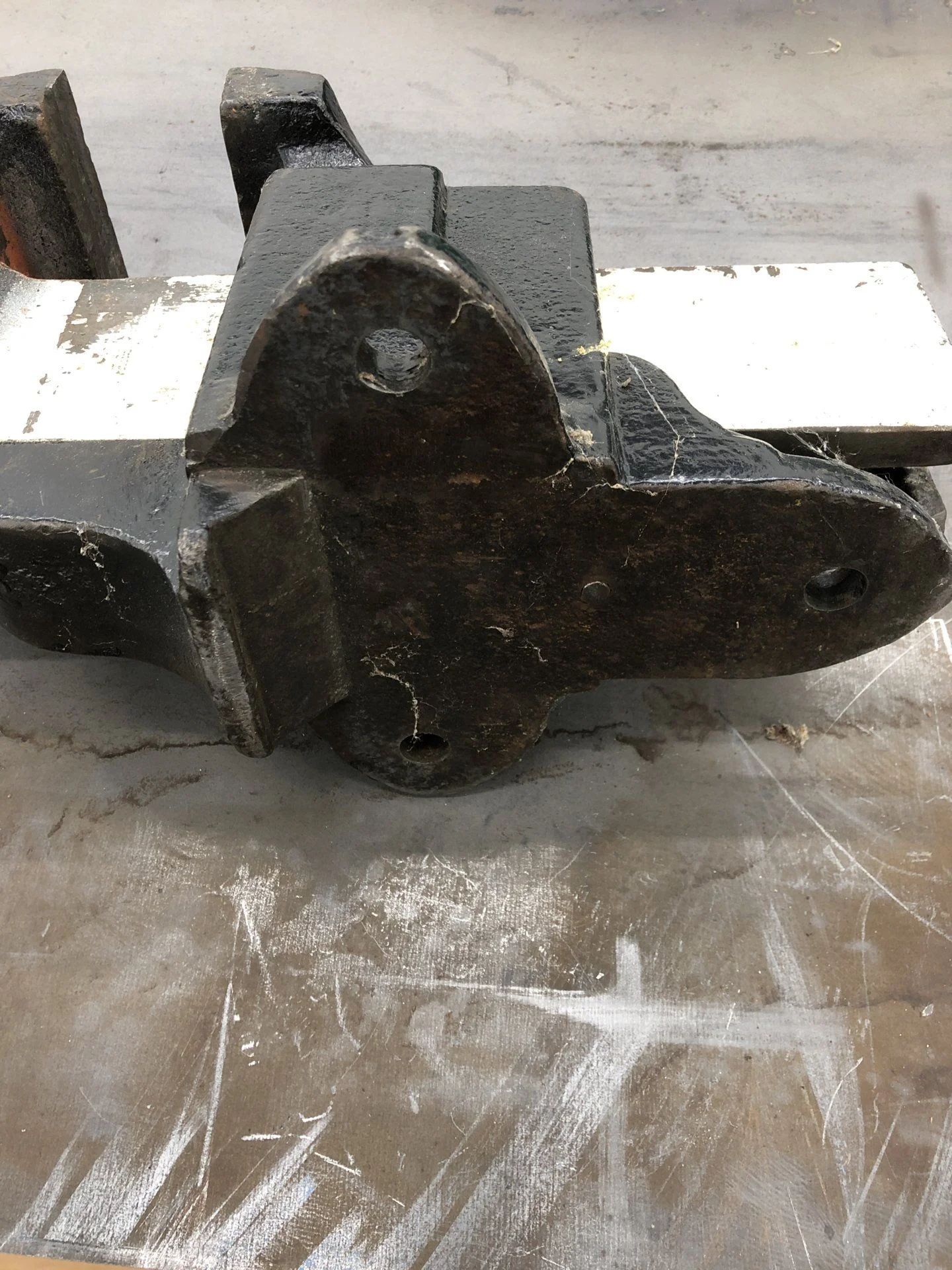

I’m right handed so I’m assuming mount it on the right end of the table on the 3 foot side of the 3x8 table?
The base of the vise has an angled piece that I’m not sure what it's for. Any thoughts?
Right side would be fine, but I had a vise mounted to the left side of my workbench for a long time (I'm right handed). Didn't have any issues./
