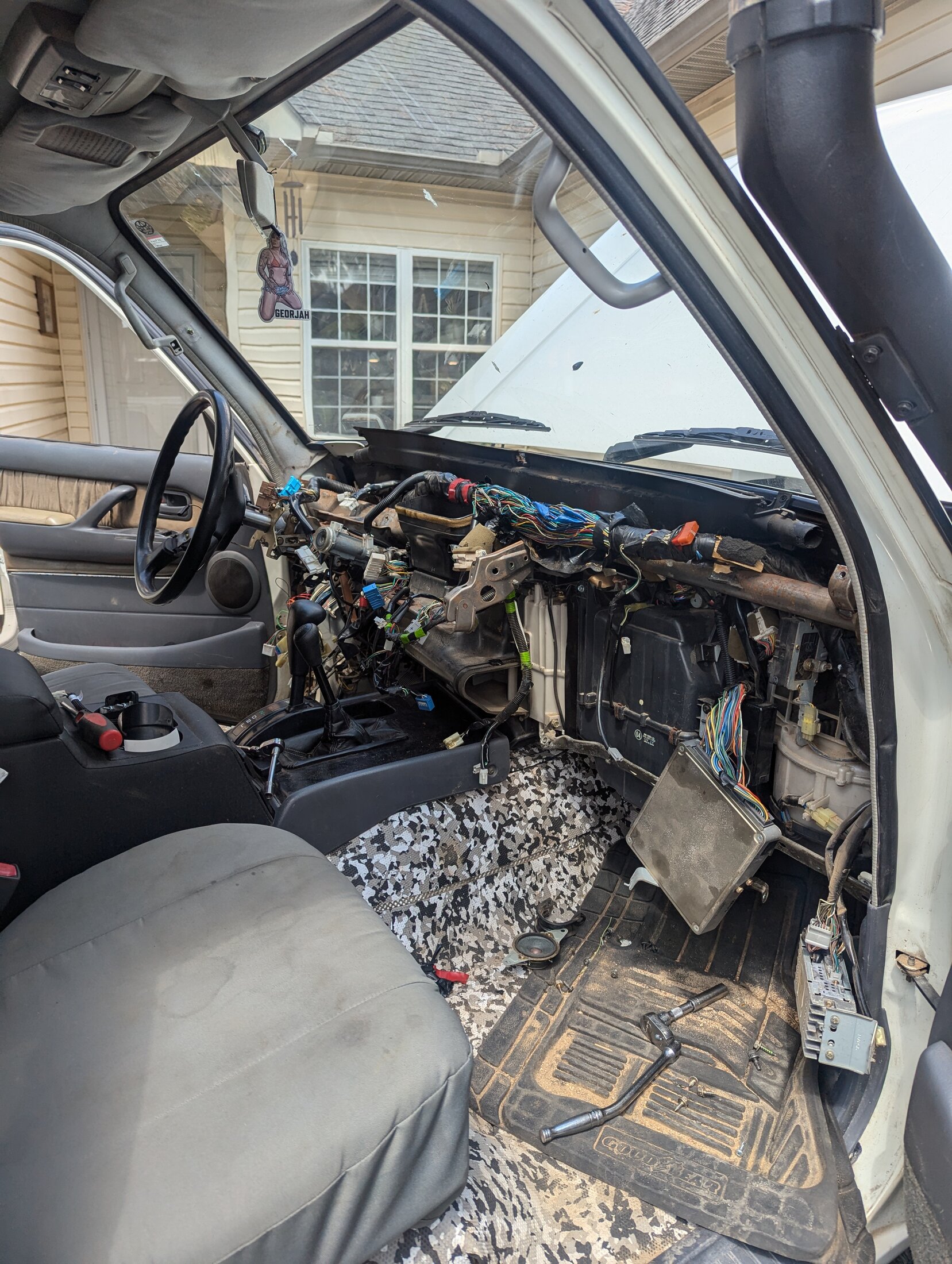

In the meantime I chased an electrical problem that ended up being a connecter that wasn't seated properly after I changed my evaporator last summer.
