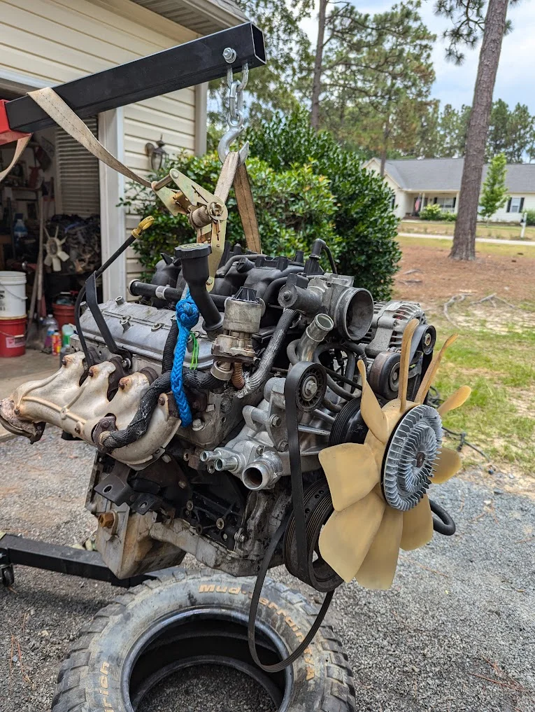

Engine- LM7 5.3l that ran until I pulled the engine. It did not burn oil.
Transmission- 4L60e rebuild in 6/18.
Adapters: Cruiser Matts engine mounts and A/C adapter, Marks 4wd transfer case adapter

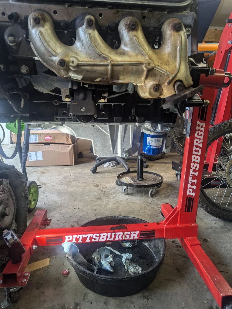

Day 1 was deep clean city with the pressure washer. The valve covers had been leaking.

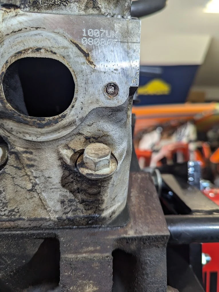

Day 2 consisted of me thinking I would drill out a broken exhaust mainfold bolt. Turned out someone had already broken an easy out in there and not particularly straight. After hours of shenanigans, I got it out and inserted a Heli coil.

Summit Racing Cast Exhaust Manifolds SUM-G9080

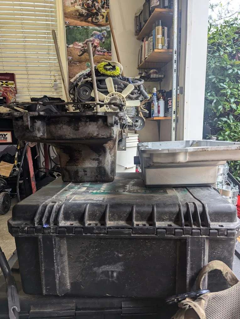

Day 3: It's raining and FedEx showed up at a decent time.
Installed the following parts. Hopefully they are the right ones. I am using parts for a 2001 Camaro.
Windage tray- GM 12558253
Oil pan- Autotecnica GM1415240
Dipstick tube- Autotecnica GM1417160
Dipstick- Autotecnica GM1417155
Oil pickup- Autotecnica GM1417151
Oil filter- PF46E
The only issue I had was on the forward part of the oil pick up. It required to be adjusted because it was tight on the oil pan. It was no big deal.

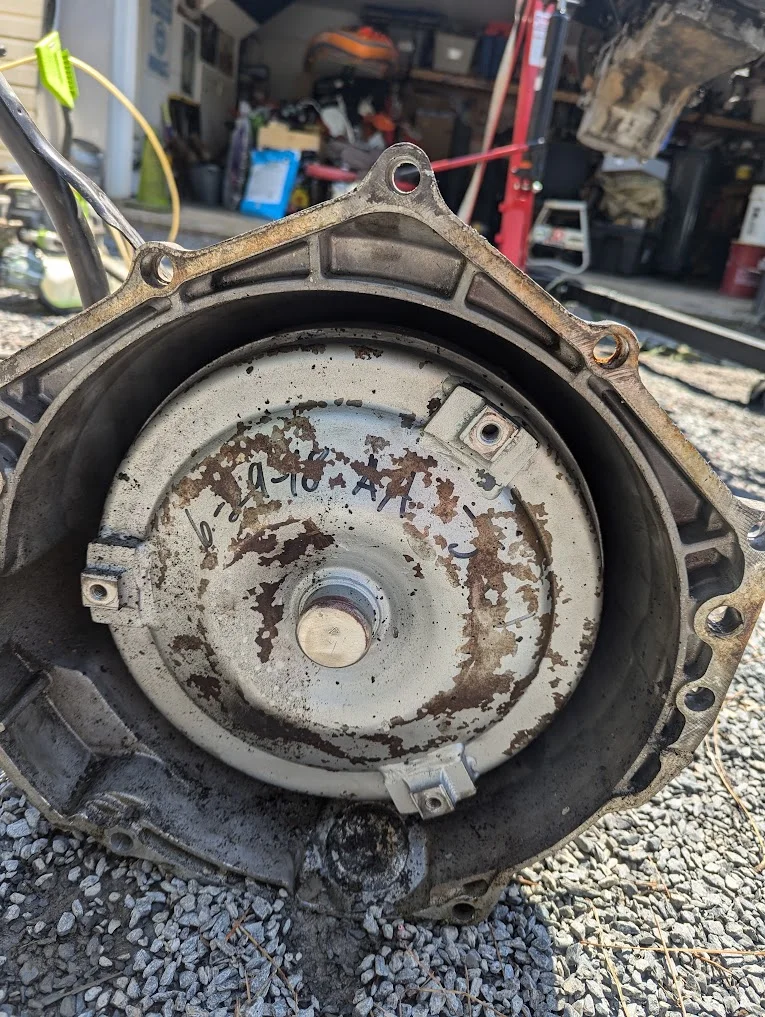

My research is showing that the 4l60e will have a lower 1st gear which is nice for crawling and a taller 4th gear which will keep my RPMs lowe on the highway.
A442
1st Gear: 2.95
2nd Gear: 1.53
3rd Gear: 1.00
OD: .765
Reverse: 2.68
4L60E
1st Gear: 3.06
2nd Gear: 1.63
3rd Gear: 1.00
4th Gear: .70
Reverse: 2.29
