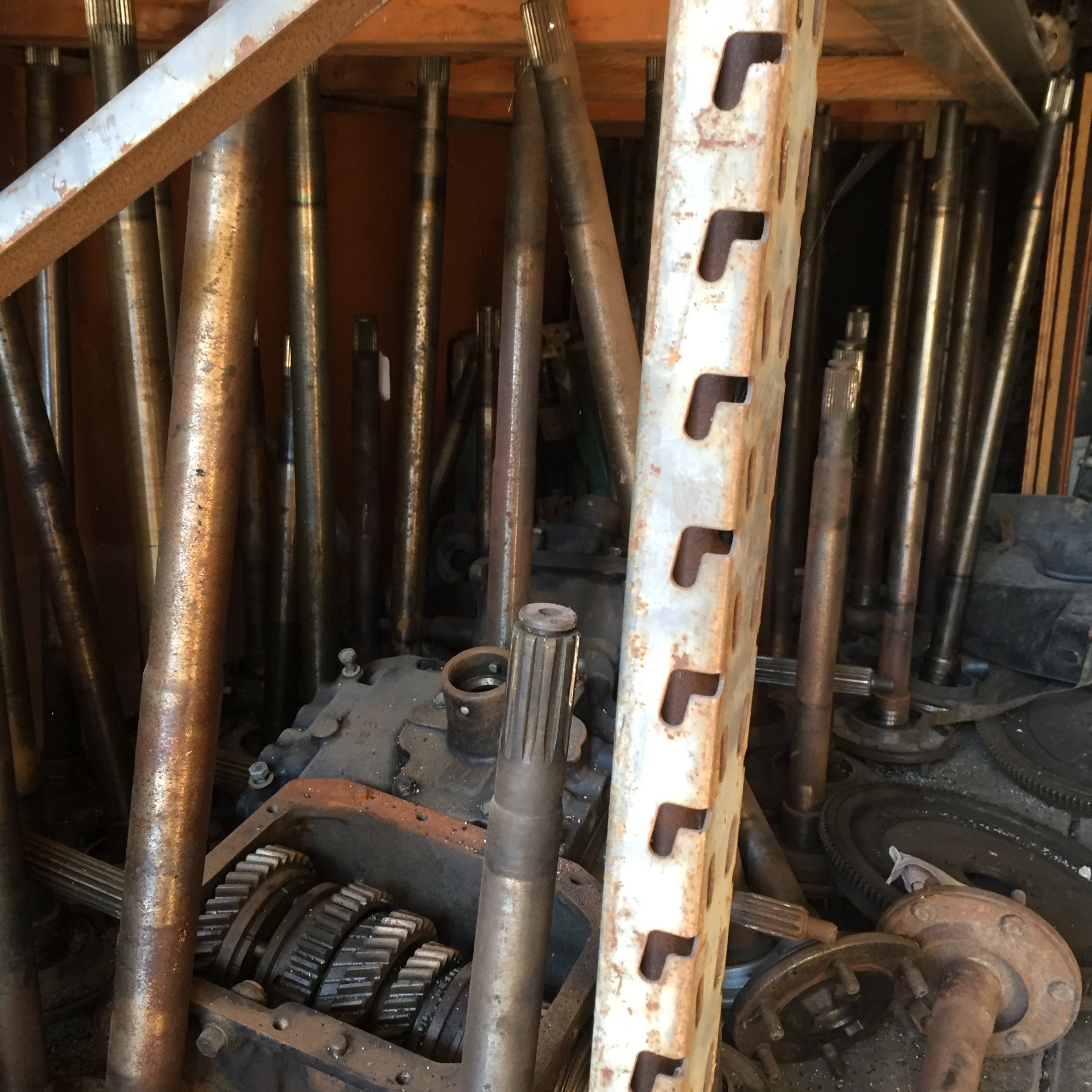

I still have a stack of good, low mileage semi float axleshafts from when I bought out Midwest Landcruiser in 1990. :meh:
This isn’t even a quarter of them.
